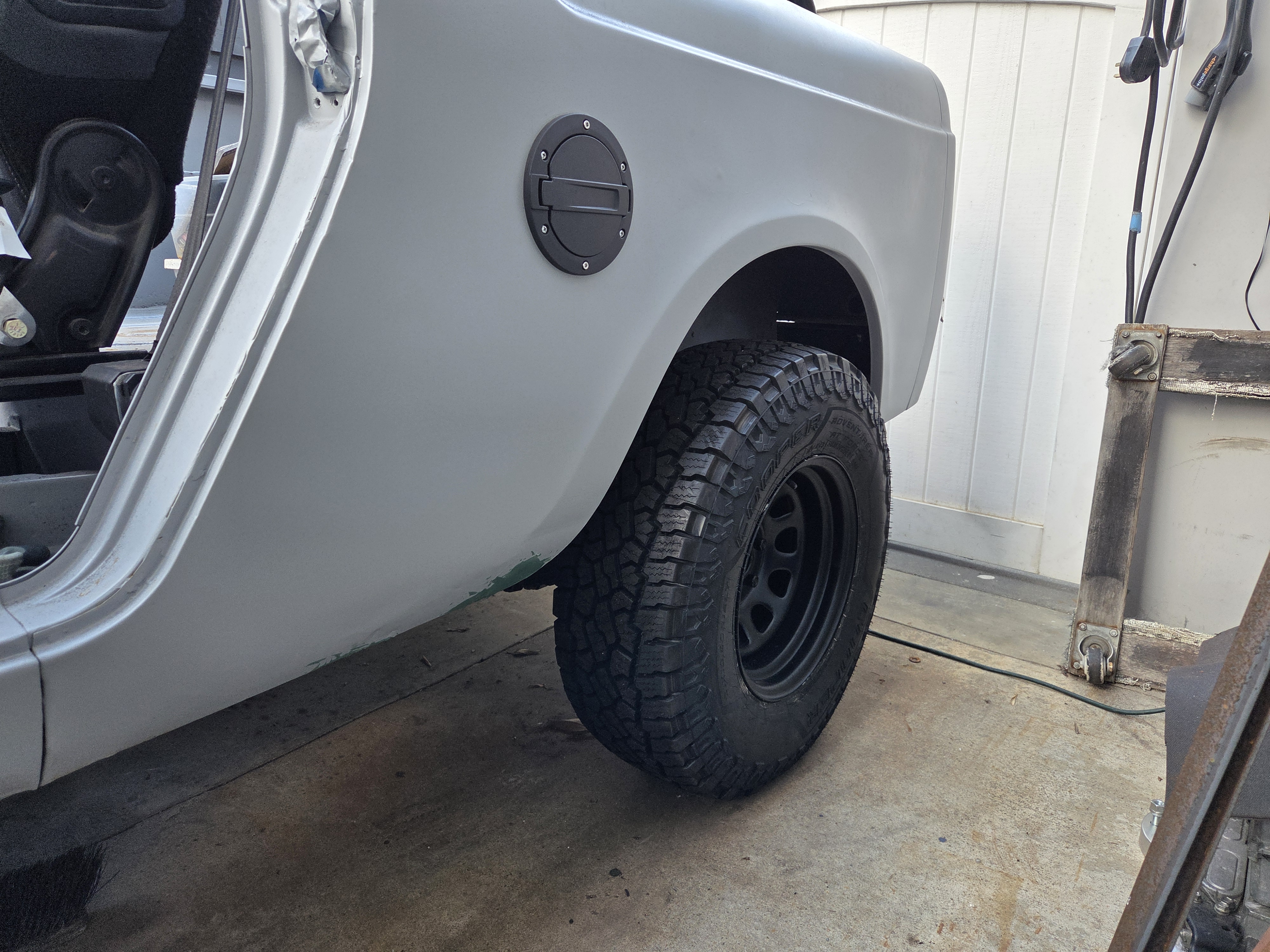

Re: [WIP] 1964 Scout LS600H conversion
Fixed the oil pump noise with a new set of tires
