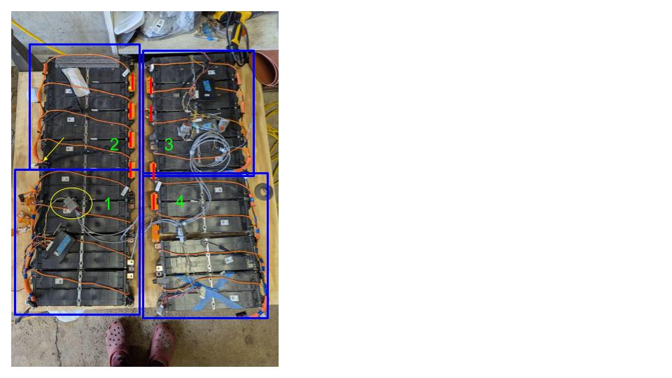

Looking for some advice.
Setting up the WDR Automisering BMS today and it was going great. I downloaded the BusMust CAN GUI to confirm the CAN dongle works. I figured out how to download and open the WDR GUI and it seemed awake. Then i disconnected 12V while i plugged the Ioniq CMUs into the battery modules. First the orange CMU harnesses were plugged into the front and rear of each module then each CMU was connected to the large black connector on the harness in the order of 1-2-3-4. Then i smelled the magic smoke and about 10 seconds later saw a swirl of smoke coming out of the CMU connected to 2 where the yellow arrow is. AHHHHHHH! I frantically managed to unplug all the CMUs in about 10 seconds. The other 3 were cool to the touch and the hot one is smoked as you can see. The modules all measure between 23.84-23.87V.
Possible causes I can think of:
1. My first thought was that somehow HV leaked onto the LV wiring, but i don't think that is the case because i didn't see where anything was touching that that could have happened. The only way i could see that is if the exposed shielding of the twisted and shield pairs touched a battery terminal and somehow brought that into the circuit, but the shield aren't grounded anywhere yet and i would consider this pretty unlikely.
2. I assumed that the CMUs and BMS are inactive until powered on and i press go. After connecting everything up i was going to connect 12V and open up the GUI to read cell voltages and thought there would be a command to balance the cells if i wanted to. Now I'm wondering if the balancing is passive and when i connected the CMUs the balancing process began. I wasn't planning to balance the cells so i didn't reconnect all the modules. I highlighted with red lines which modules are connected and as you can see all 4 modules in the second set are connected AND the bottom module is also connected to the top module of the 1st set. I think the CMU began balancing 3 modules at 24V with one module at 48V.
3. The large grey deutsch connectors i made that made to string the CMUs together were only loosely fitted. For some reason i didn't push the plugs into the receptacles all the way so maybe some pins were only barely touching while other pins weren't touching at all. Only CAN is going through these connectors so idk how that could have caused a failure like this.
4. The CMU harness was connected "backwards". If the module plugs closest to the CMU are connected to the negative side of the string of 4 modules and the plugs furthest from the CMU are connected to the positive side of the string, would it be problematic to connect the harness backwards? Sets 1 and 2 are connected with the CMU closest to the negative module and sets 3 and 4 are connected with the CMU closest to the positive module.
Glad i still have all my fingers, toes, and modules! I wasn't wearing my HV gloves since i wasn't planning to doing HV stuff and that is a lesson learned.
Any help is appreciated!

Then i had a call with Walter of WDR BMS fame and we started to get my BMS set up. It went really well except for realizing i think i killed another Hyundai Ioniq 5 battery module. When i was measuring cell voltages my probe touched two neighboring pins on a voltage sense connector. I didn't know not to do this because the cells are fused and now the module might be bricked
A $200 FAFO. To reduce the timeline i'm going to get the car running with 12 modules (3 packs of 4 modules) instead of all 16. That way i don't have to source 2 more modules or build the 4th pack yet.

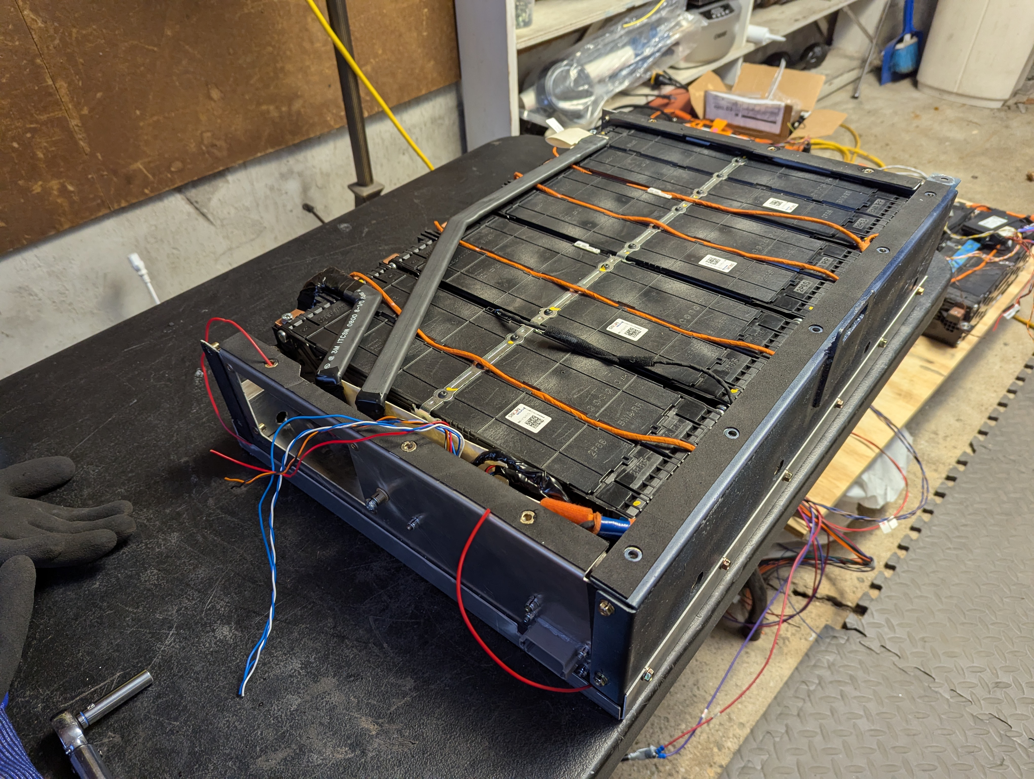

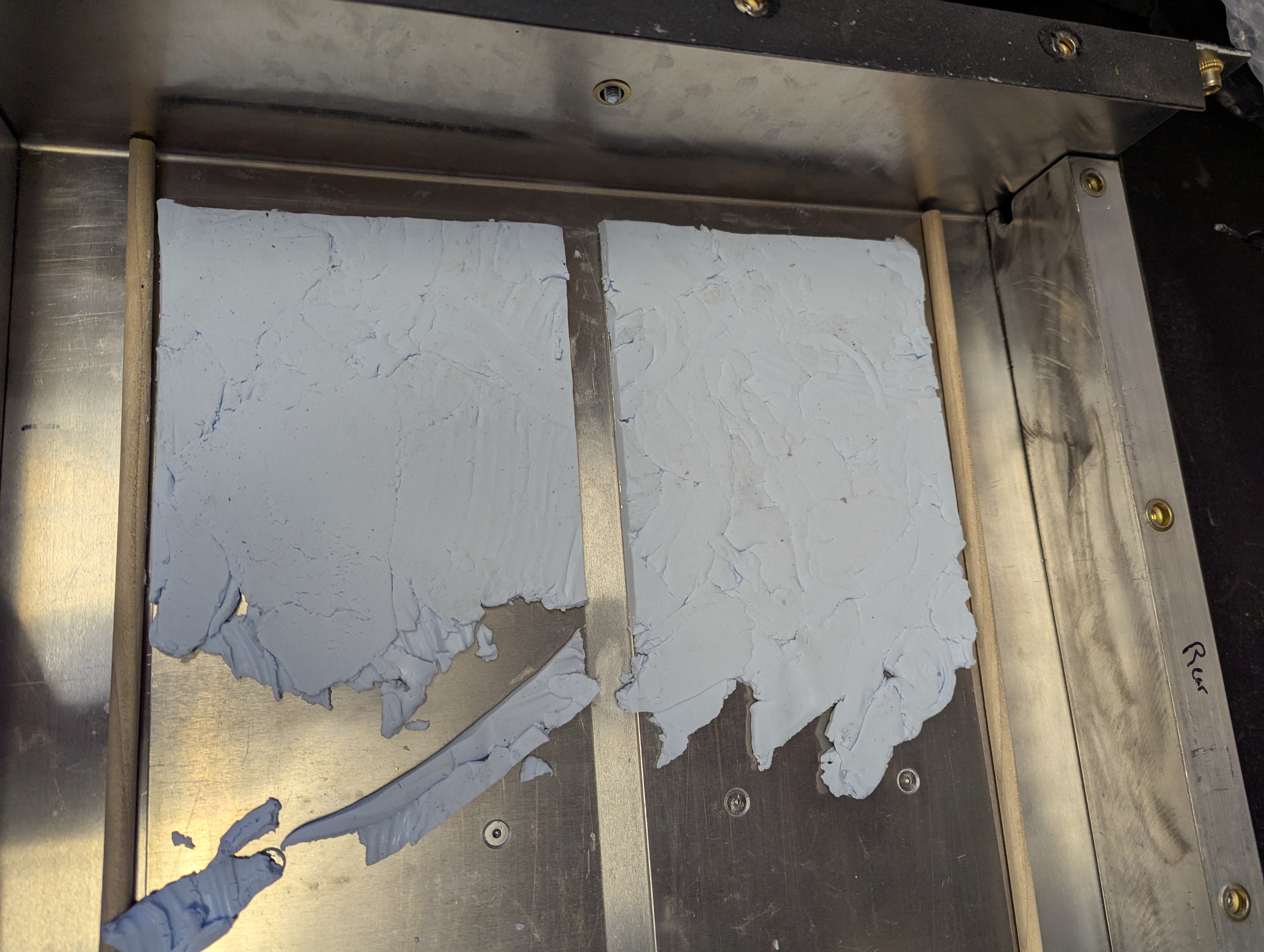

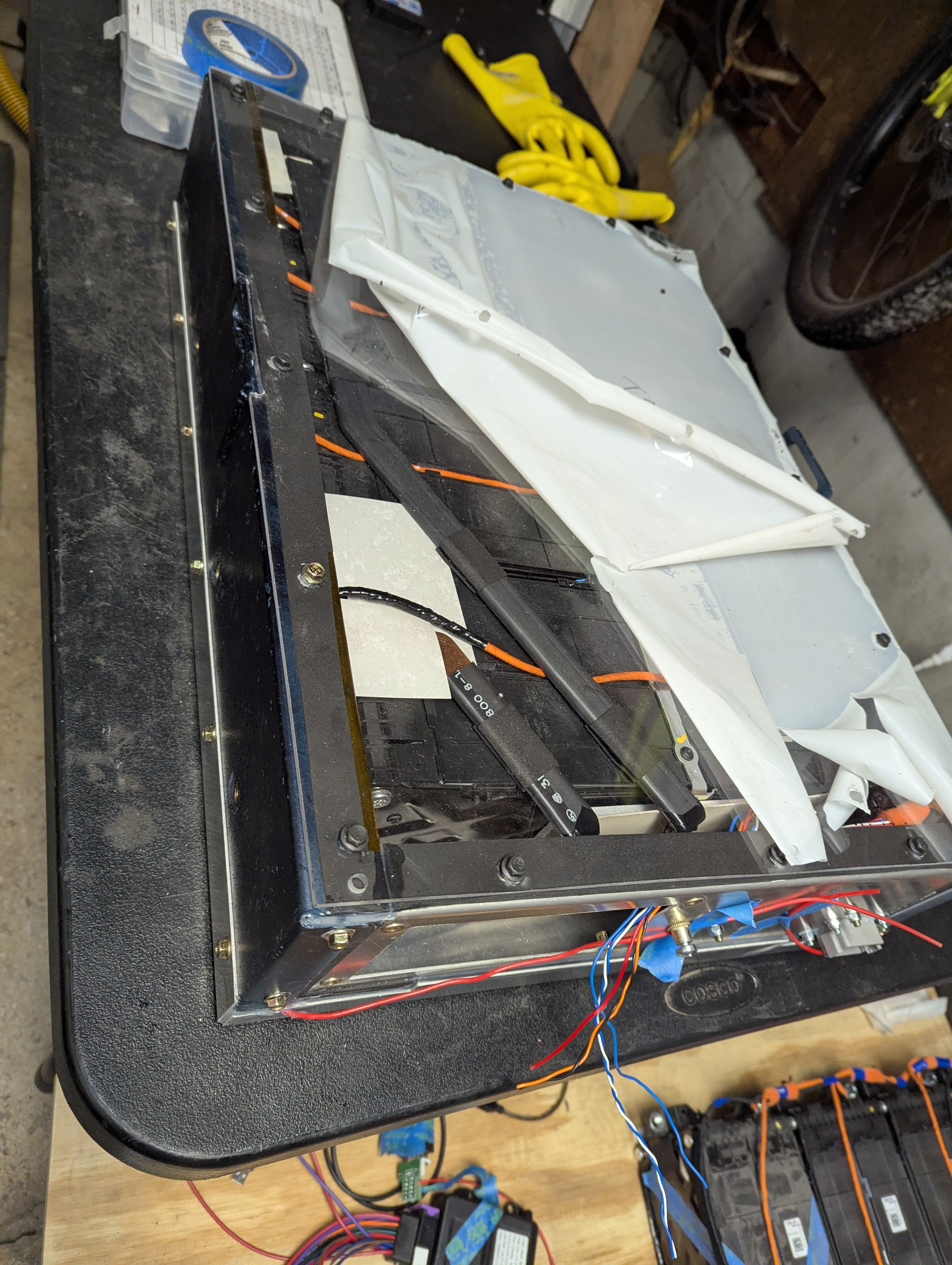

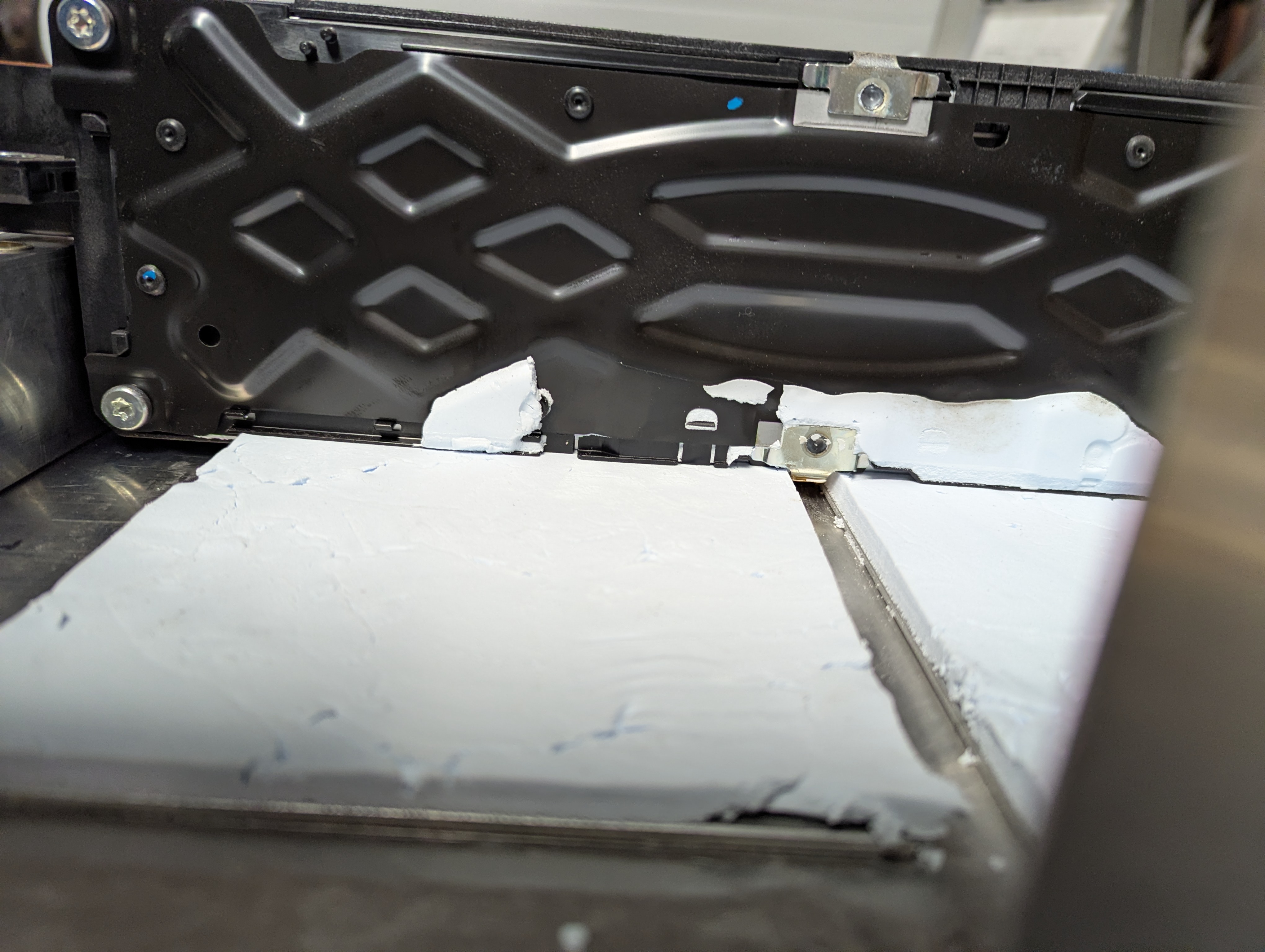

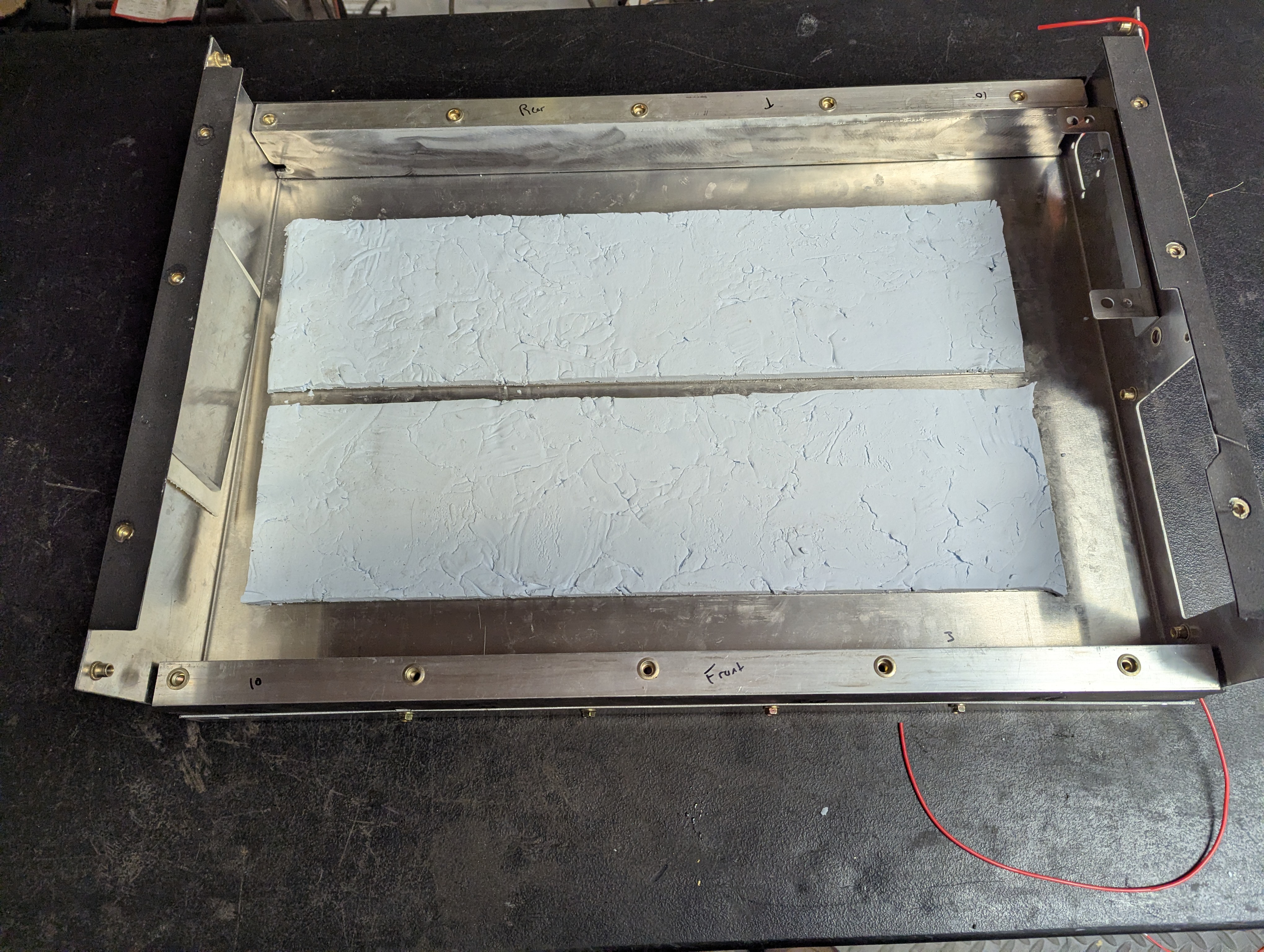

Then i got the first battery box built! I used a rolling pin mathod to get the thermal paste to the right height to barely touch the bottoms of the cells. I think my spacing worked out a well as i could have wanted. When i rest the module on the paste there's a .01-.03" gap between the mounting surface and the module. This gives a teeny bit of pressure on the cells, just enough to make them touch without deforming the pouches i hope. When i lift the module back up you can see a tiny bit of paste stuck to the cells and the very faintest outline of where they touched the thermal paste. I learned from the hyundai technical service manual that this paste gets installed as a 2-part mix, therefore i'm guessing it's much softer when the modules are installed at the factory than it is now. Hope i get some ok heat transfer out of this complex design i've made.
Next i started to install my motor mounts. that's going ok and the motor is now supported in the engine bay without a crane for the first time and that feels gooooooood! Gonna have to take them out for painting before final install.

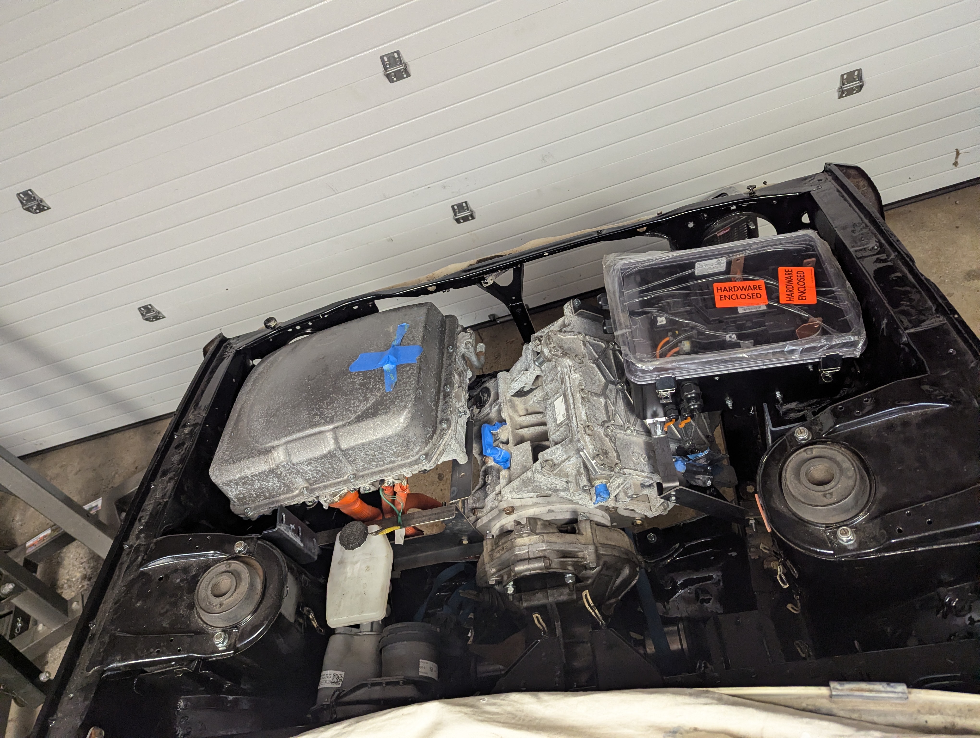

Re: [WIP] 1979 Subaru Wagon: Leaf Stack,Zomb,Ioniq 5 1/2 pack

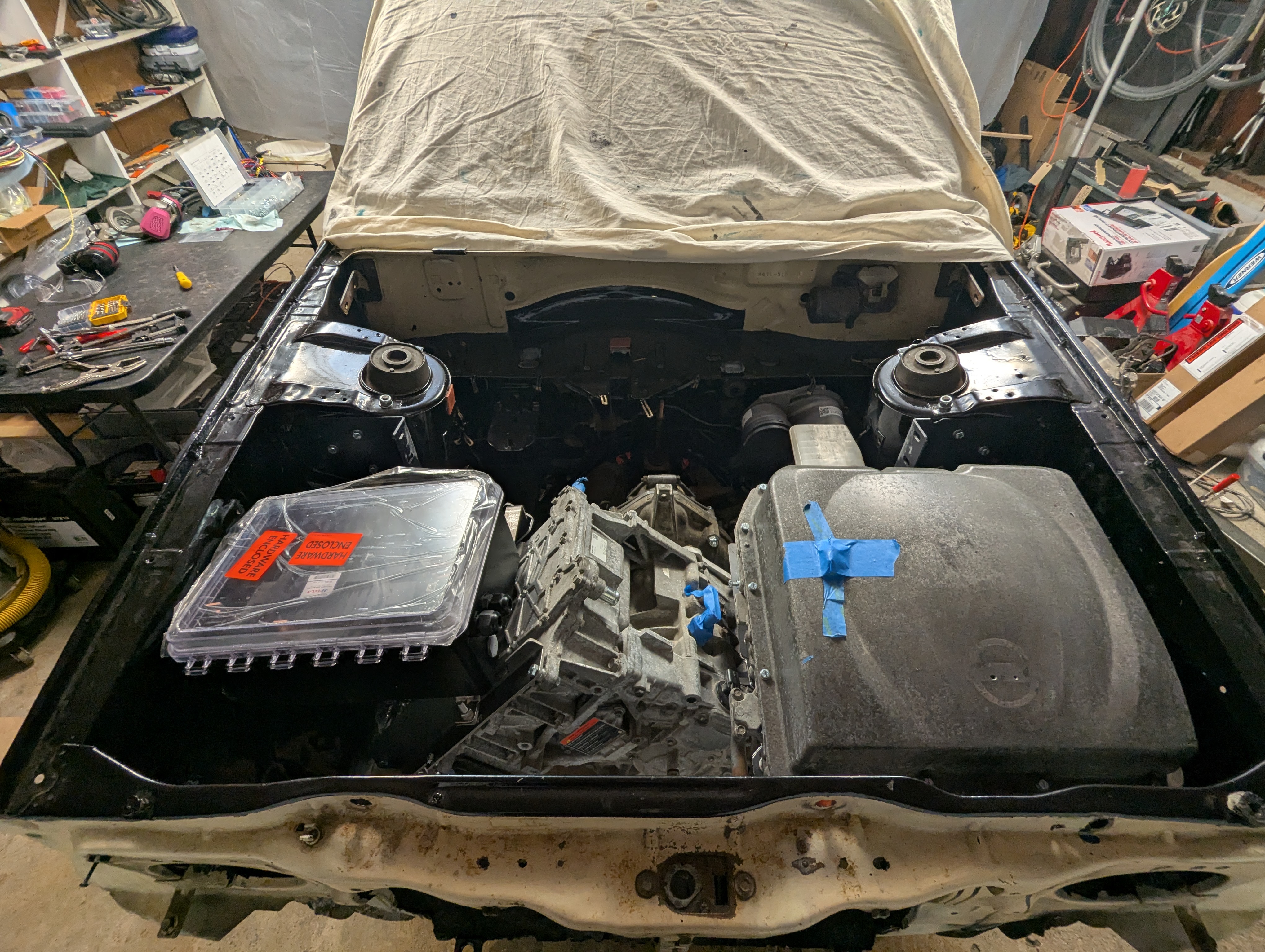

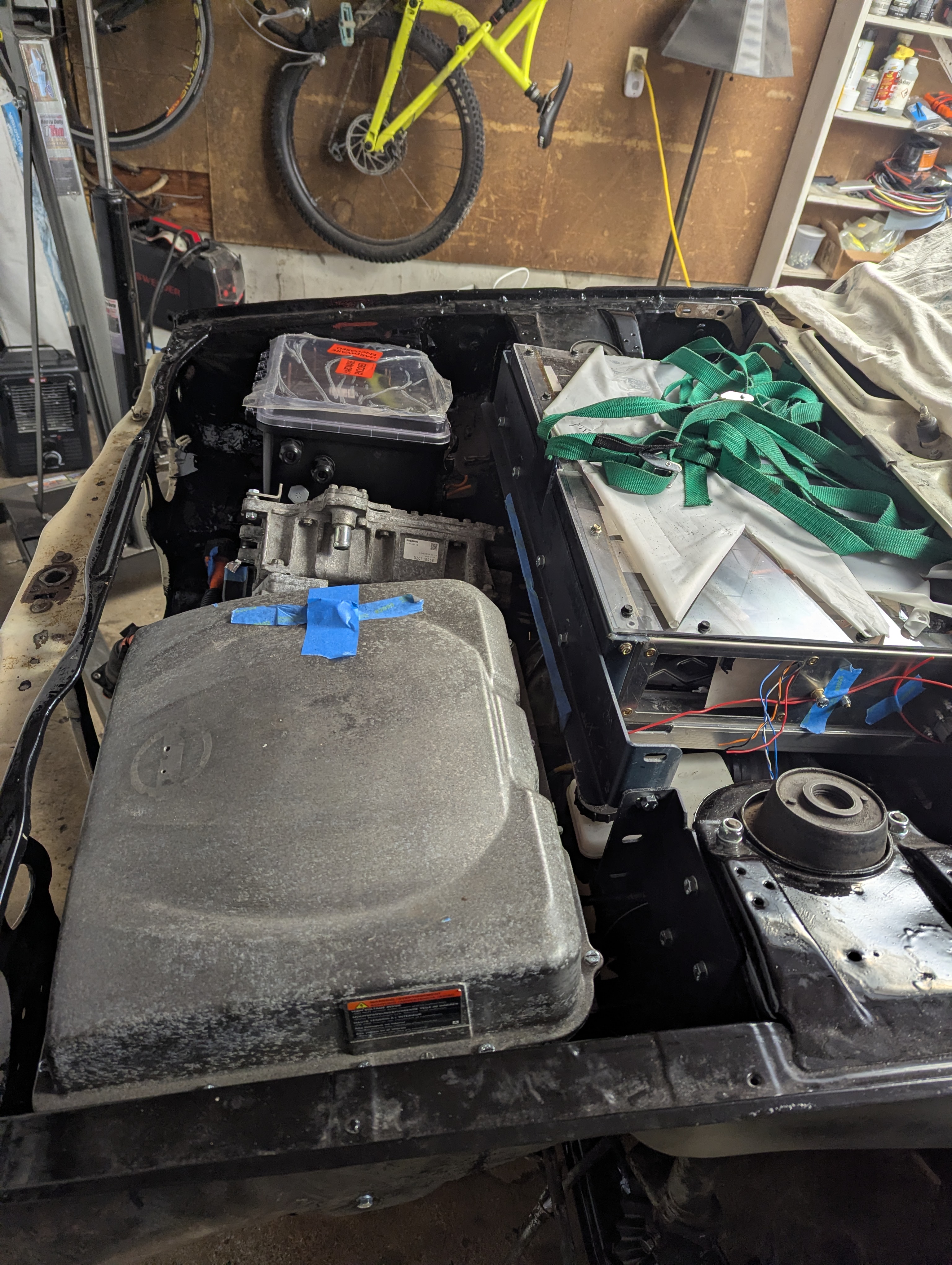

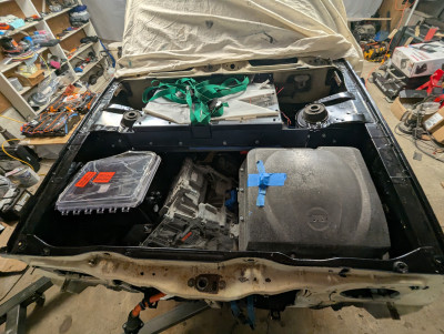

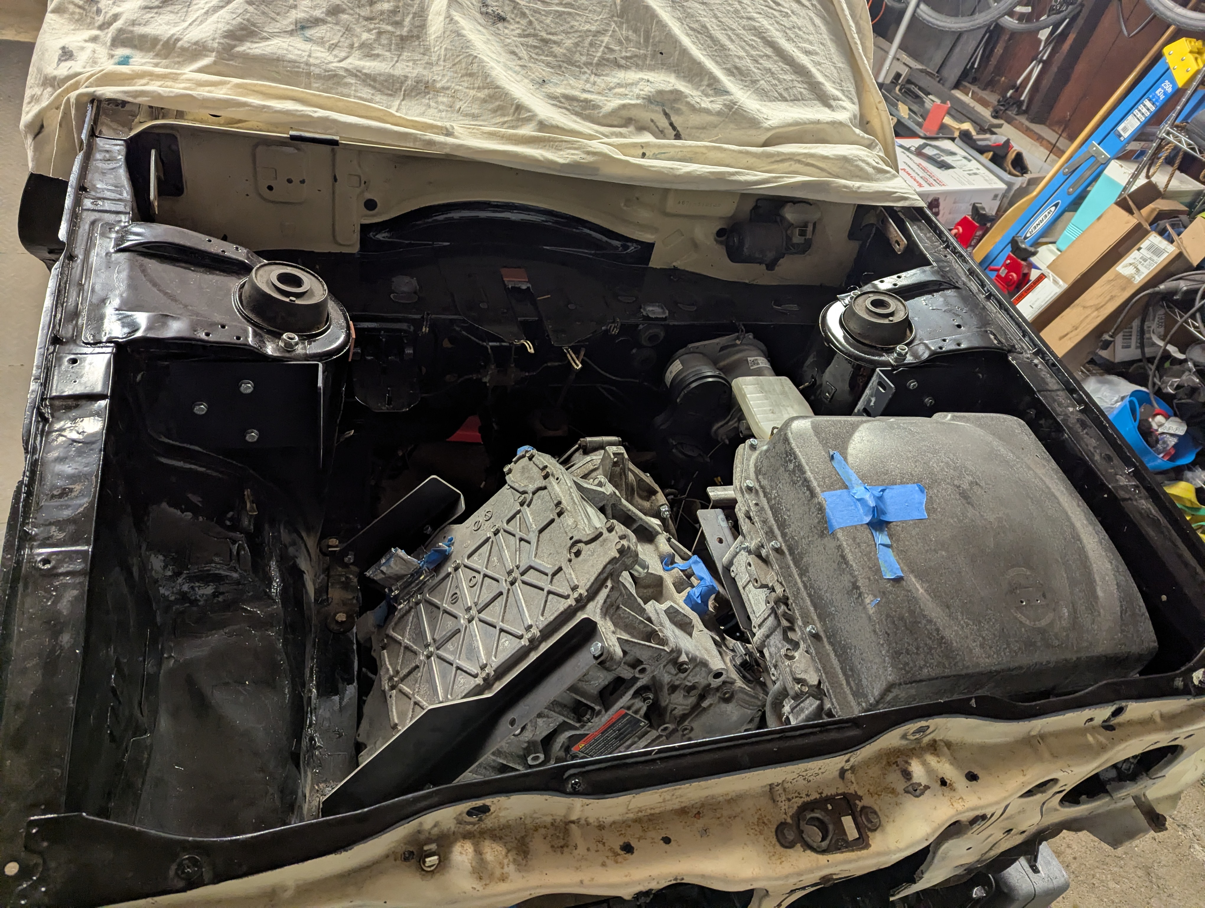

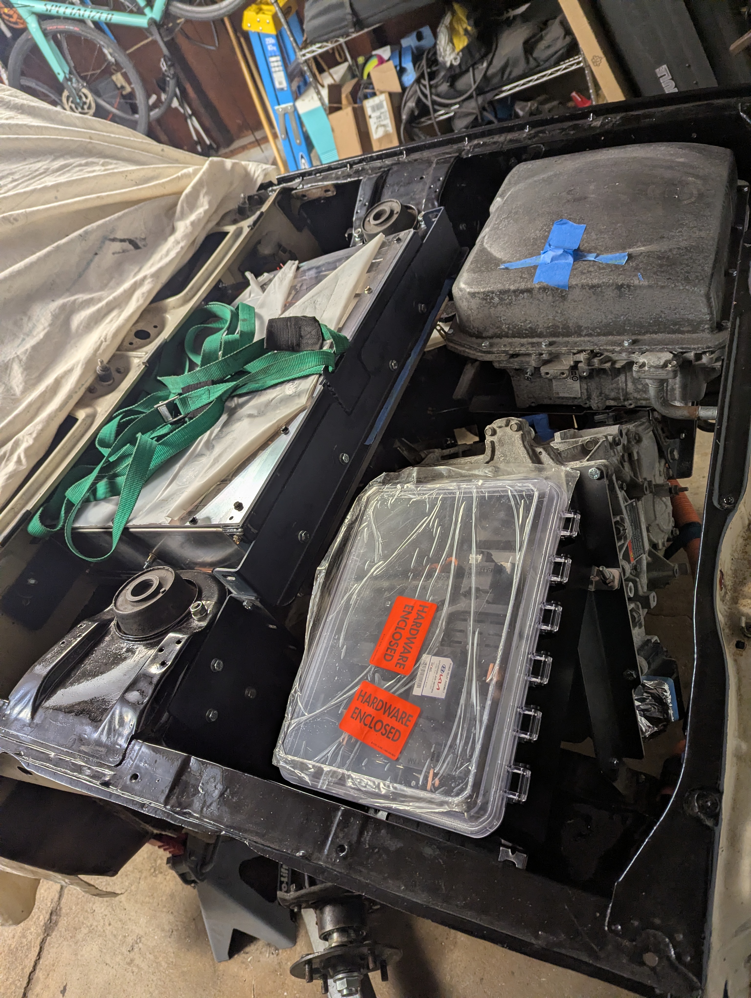

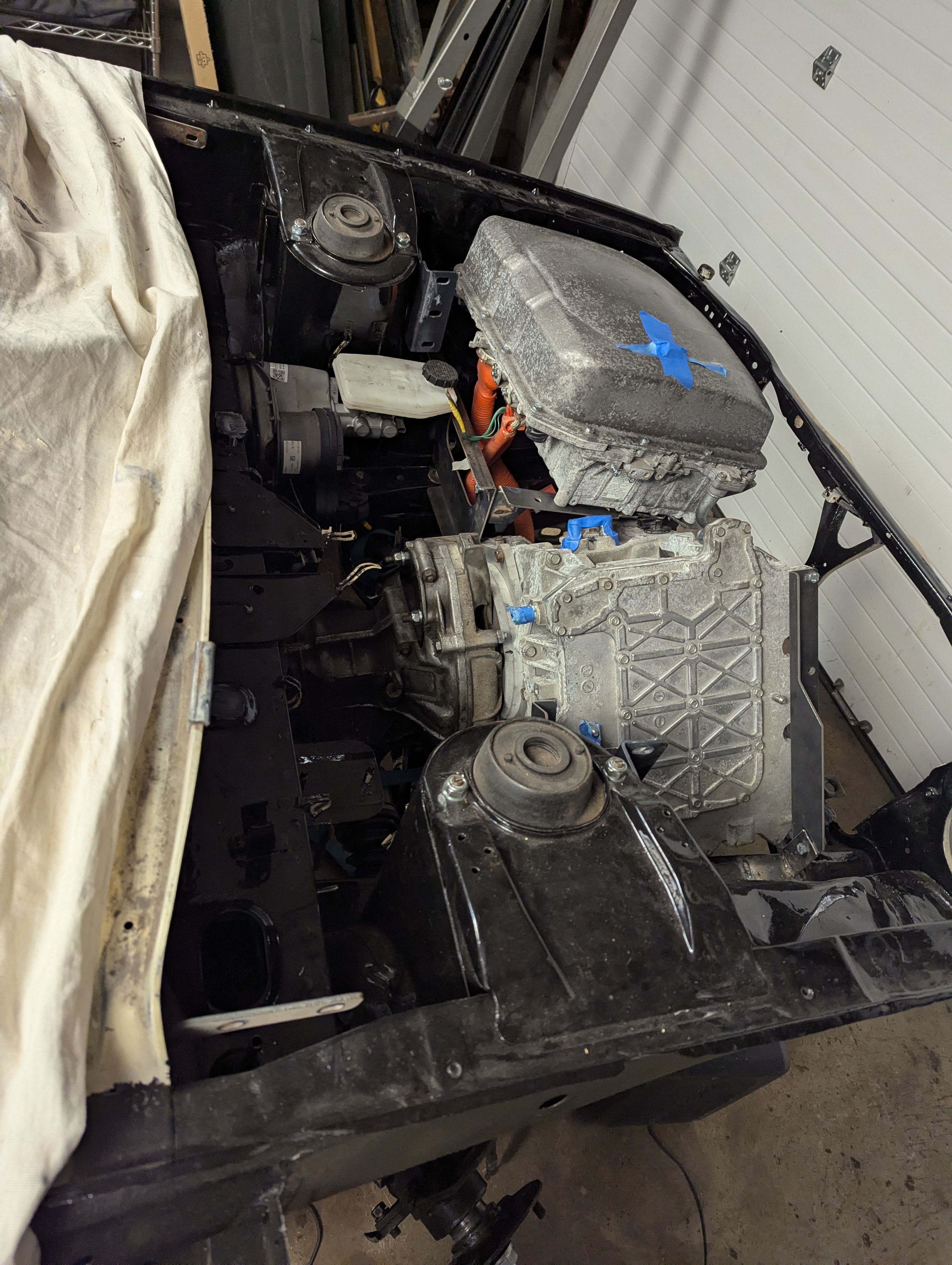

Got everything installed for the first time! This is just temporary for fabricating the motor mounts and getting cable and hose lengths. Now it all has to come back out for painting the motor mounts. It's a bit of a messy look, but so psyched i got it all to fit with 1/4 of the batteries under the hood! The motor is clocked at 45 degrees which makes a lot of odd shapes for fitting everything else in. My 3D scanner lied to me a little bit and I have to mod the battery box mounts to bring it an inch lower and half an inch forward.
motor and PDM
motor, PDM, and PRA
motor, PDM, PRA, and battery box!
motor and PDM
motor, PDM, and PRA

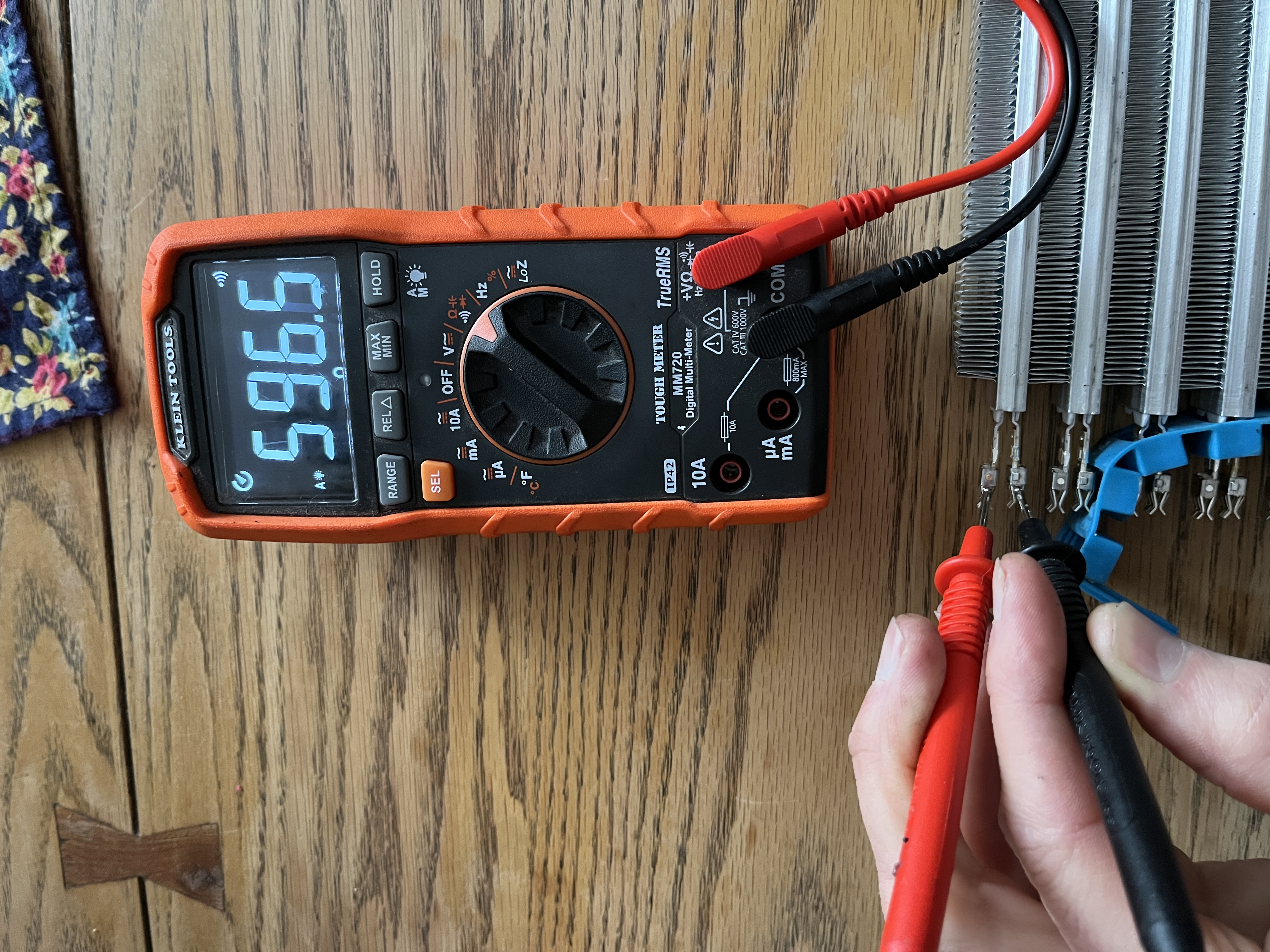

Before i bought anything i checked if the heater was one single core or multiple cores stuck together. Turns out it is made of 8 cores! They measure 600 Ohm across each. They have fast-on-esque tab connections to the OEM controller which is easily removed. I didn't know it came off easily so i tried hacking it off first). Each heating element is a simple strip of resistive material sandwiched to an aluminum plate and fins thru a (assumed) thermally-conductive-electrically-insulating gap pad.
Having 8 different elements gives me slightly different constraints. I now have the option to power a sub set of the cores for lower power heat instead of delivering reduced power to all 8 cores. I will research that tomorrow!
I have some Ohms law questions here.
Based on the OEM numbers i would expect the heater to have a resistance of 32Ohms:
I=P/V=5000W/400V=12.5A
R=V/I=400V/12.5A=32Ohm
600Ohms across each of 8 elements gives 75Ohms
R=600/8=75Ohms
I=V/R=400V/75Ohms=5.3A
P=IV=5.3A*400V=2120W or P=I^2*R=2106W ---> why are these different?
R=600/8=75Ohms
This is confusing to me because as it heats up the resistance will increase and current will decrease and power will decrease. 2kW would be pretty disappointing, does anyone know why the resistance doesn't appear to match OEM claims?

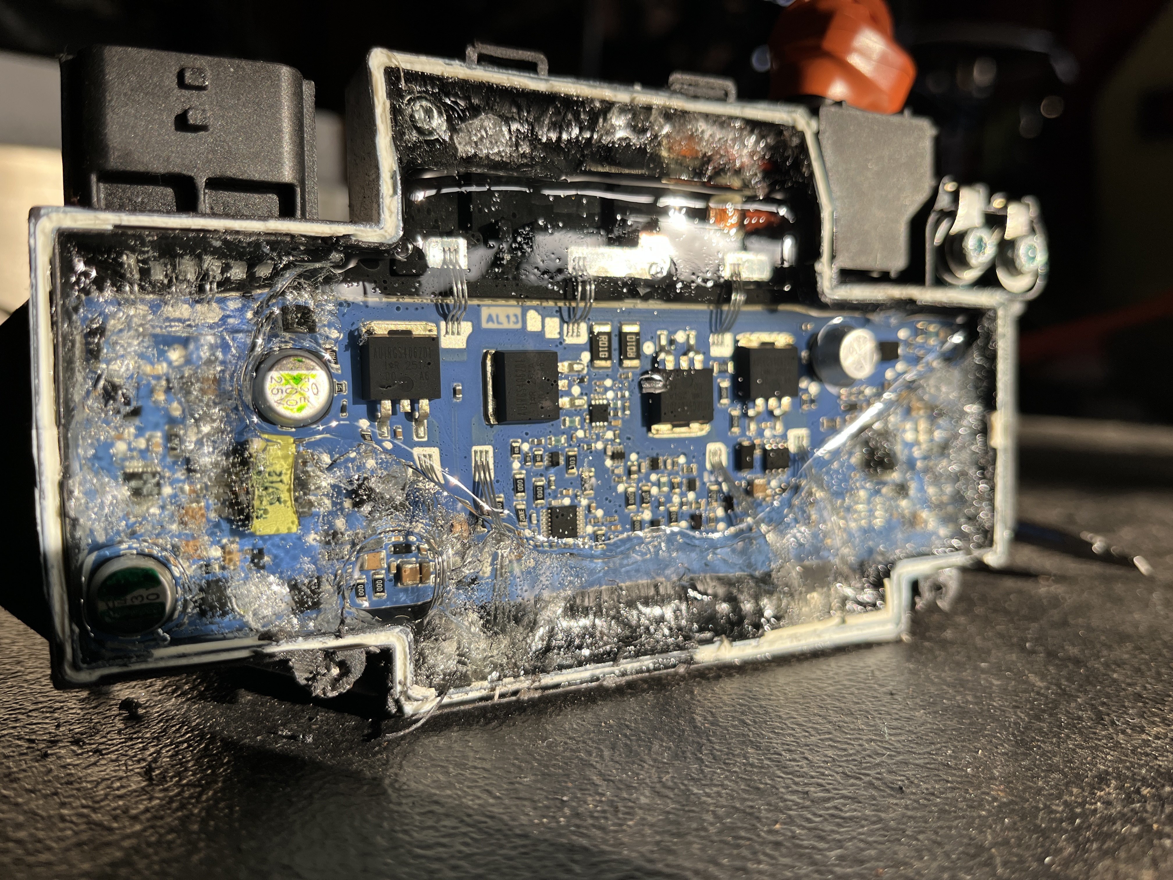

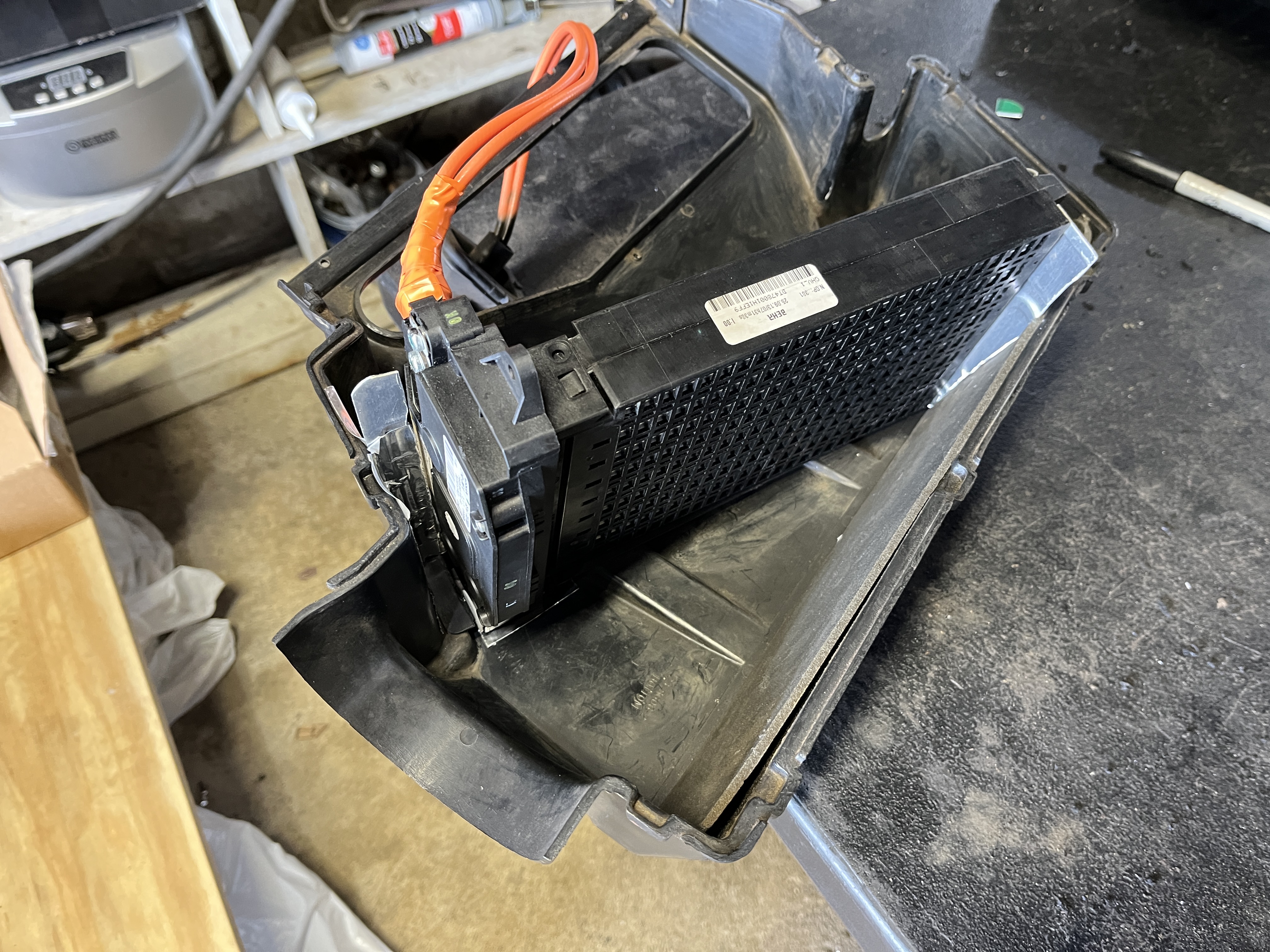

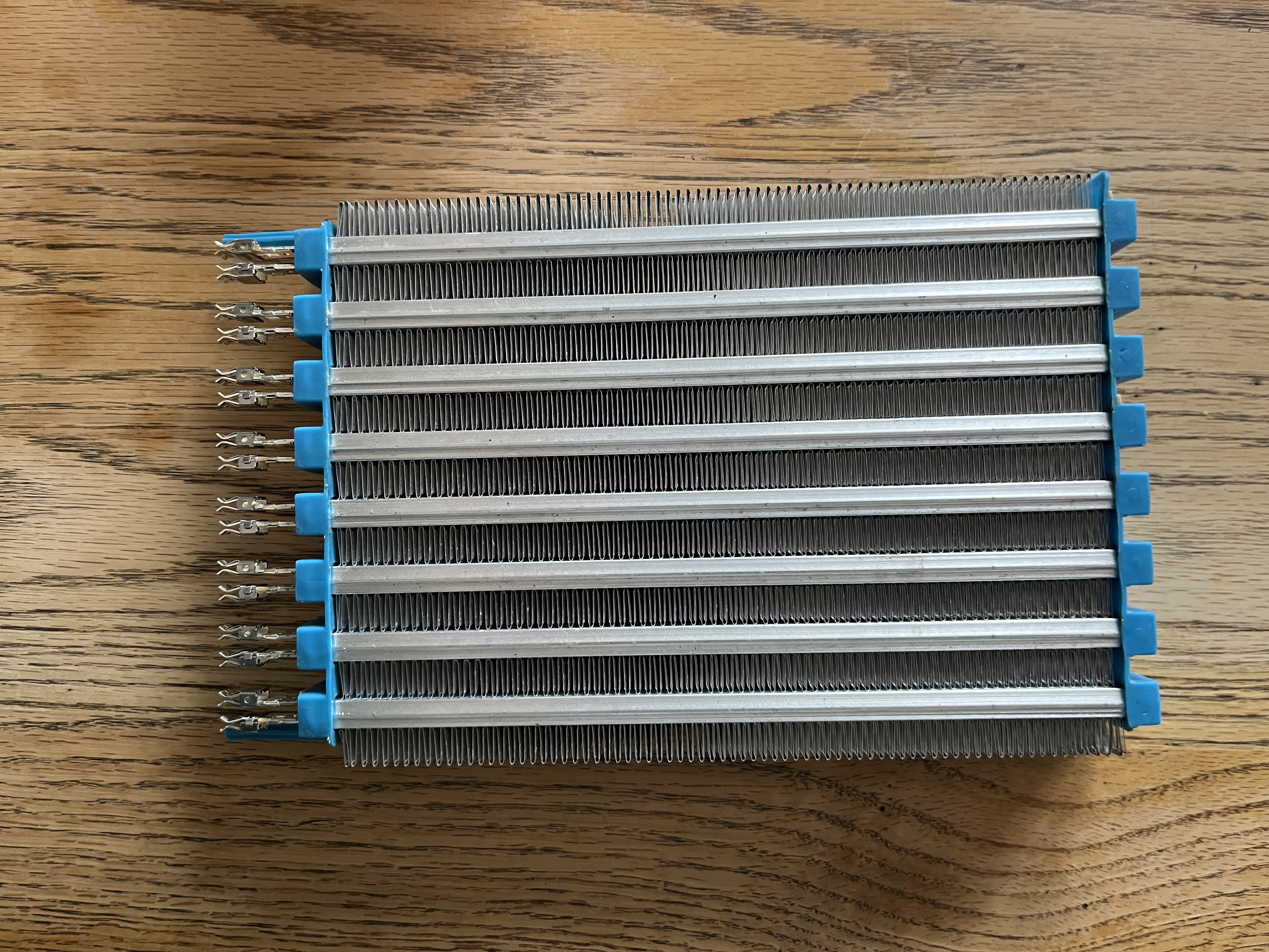

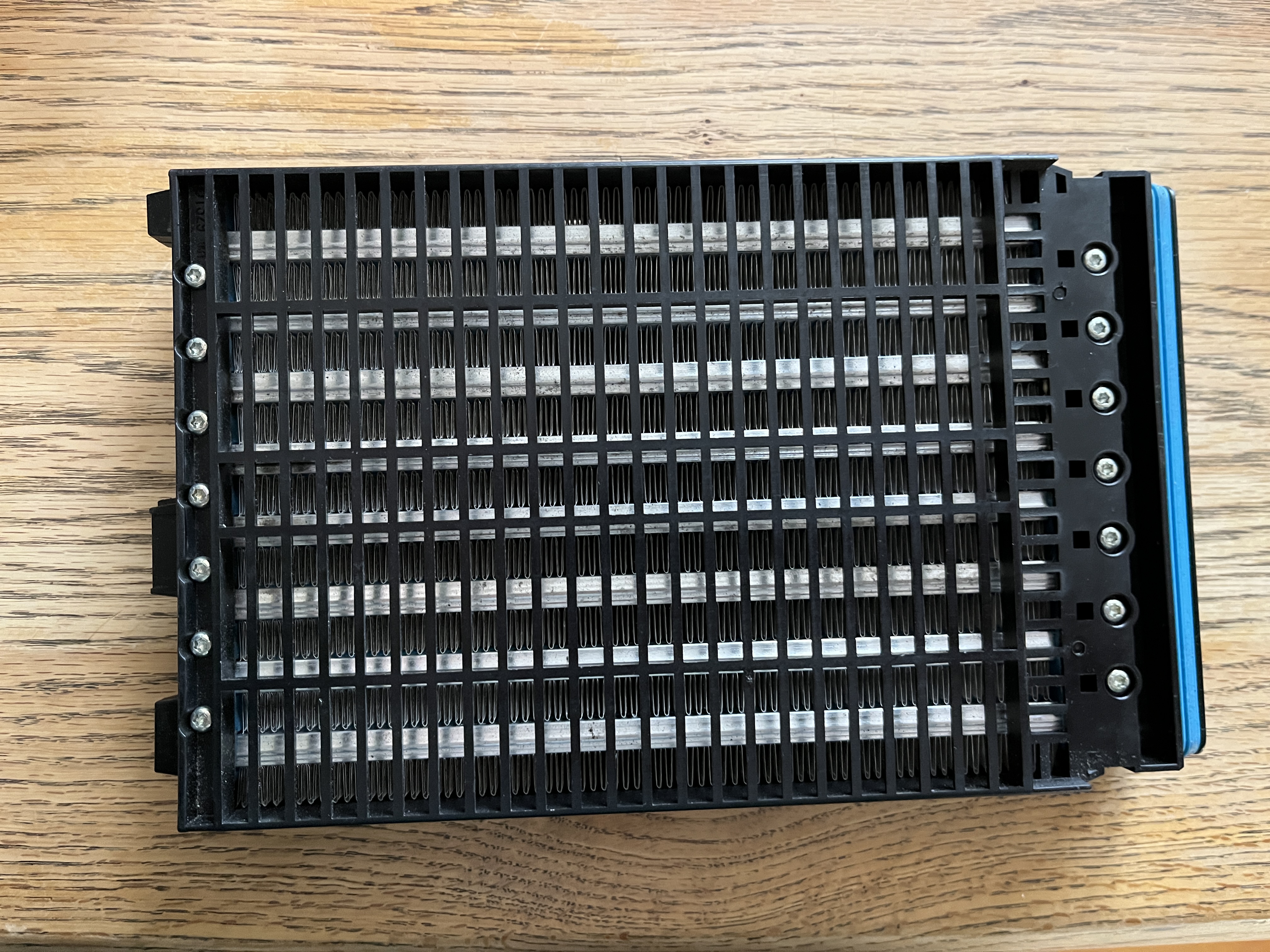

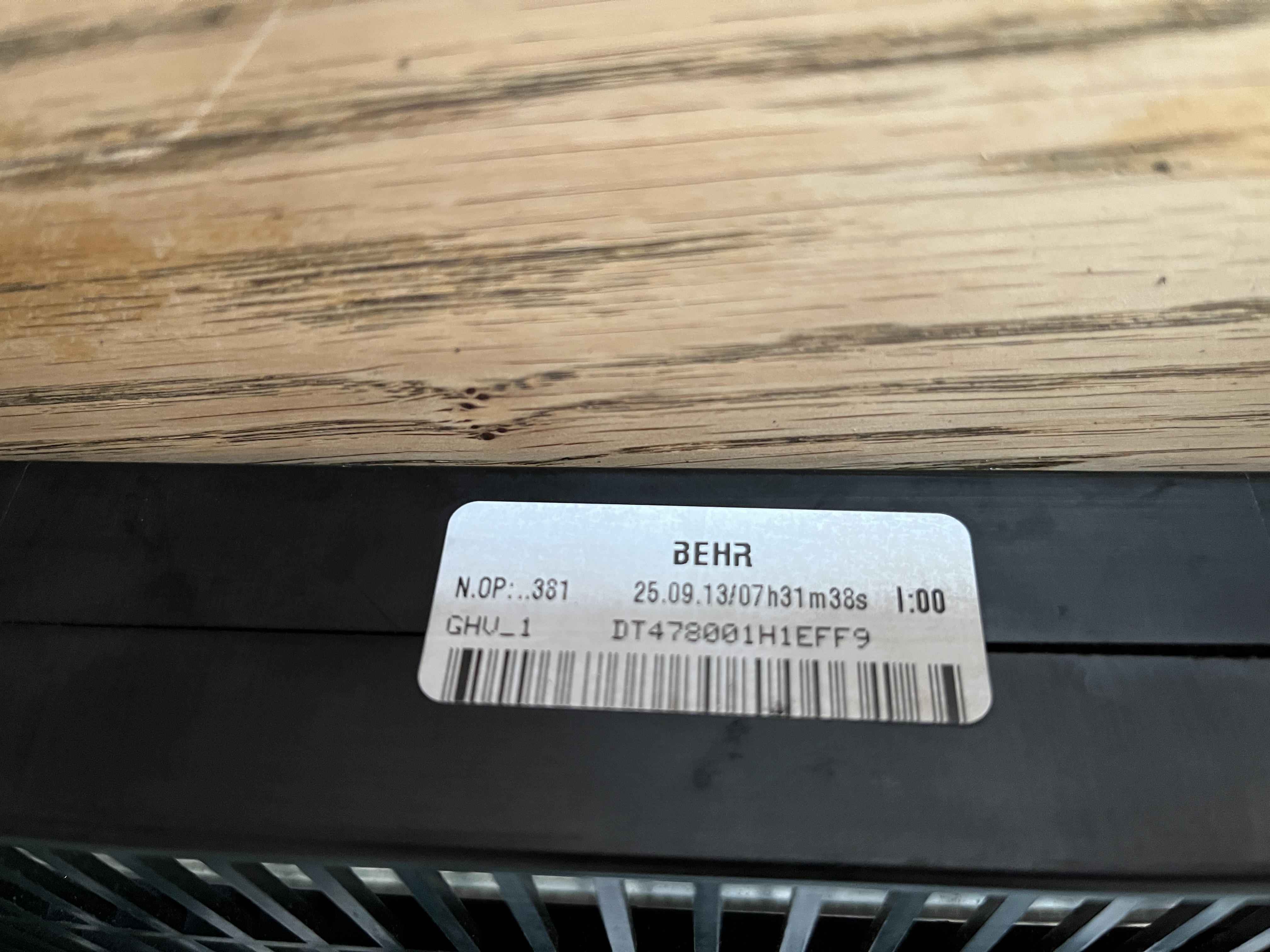

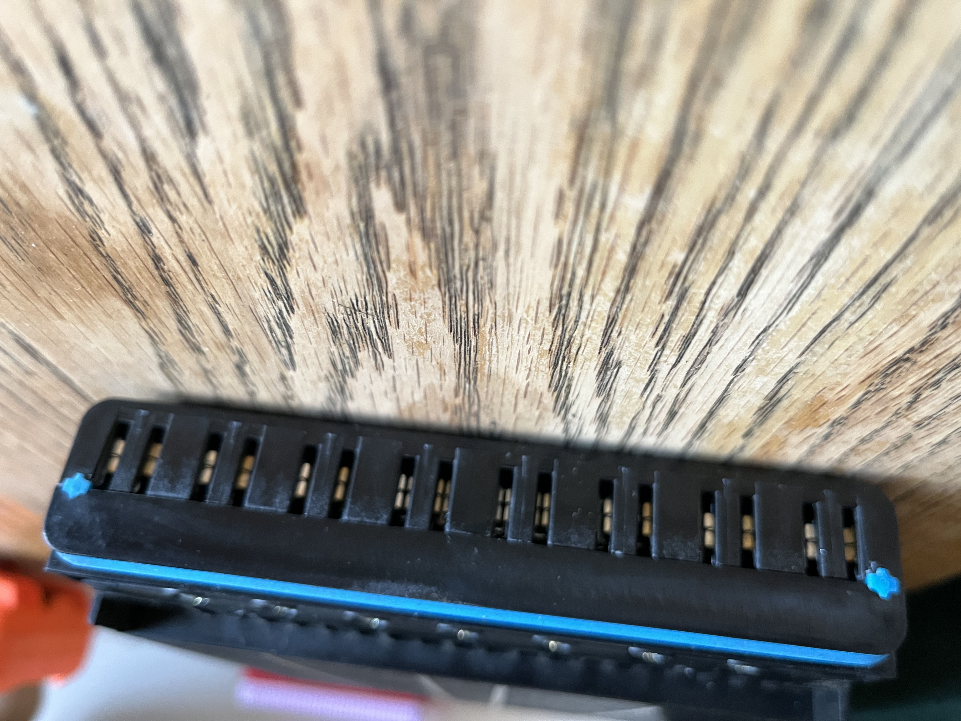

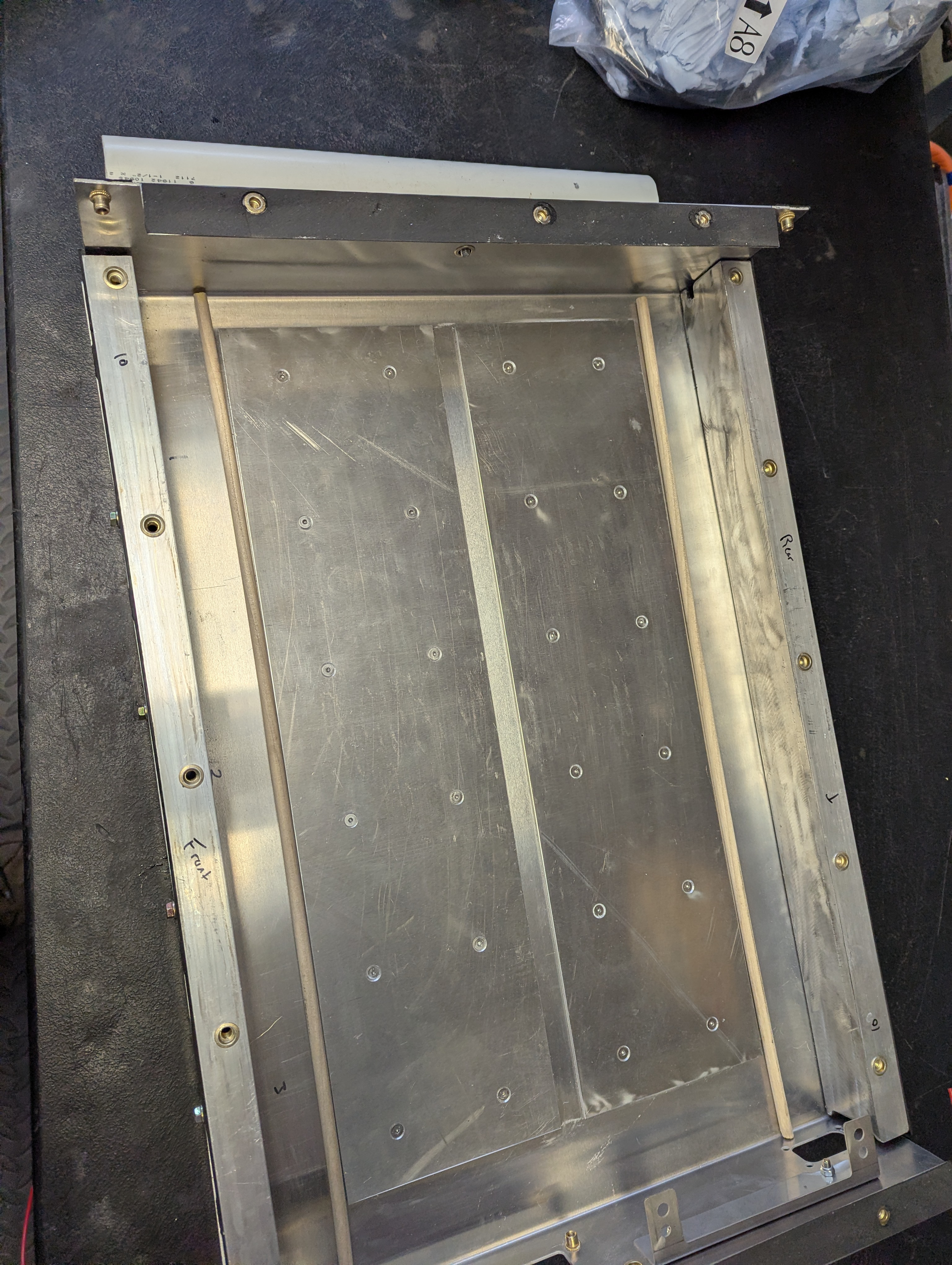

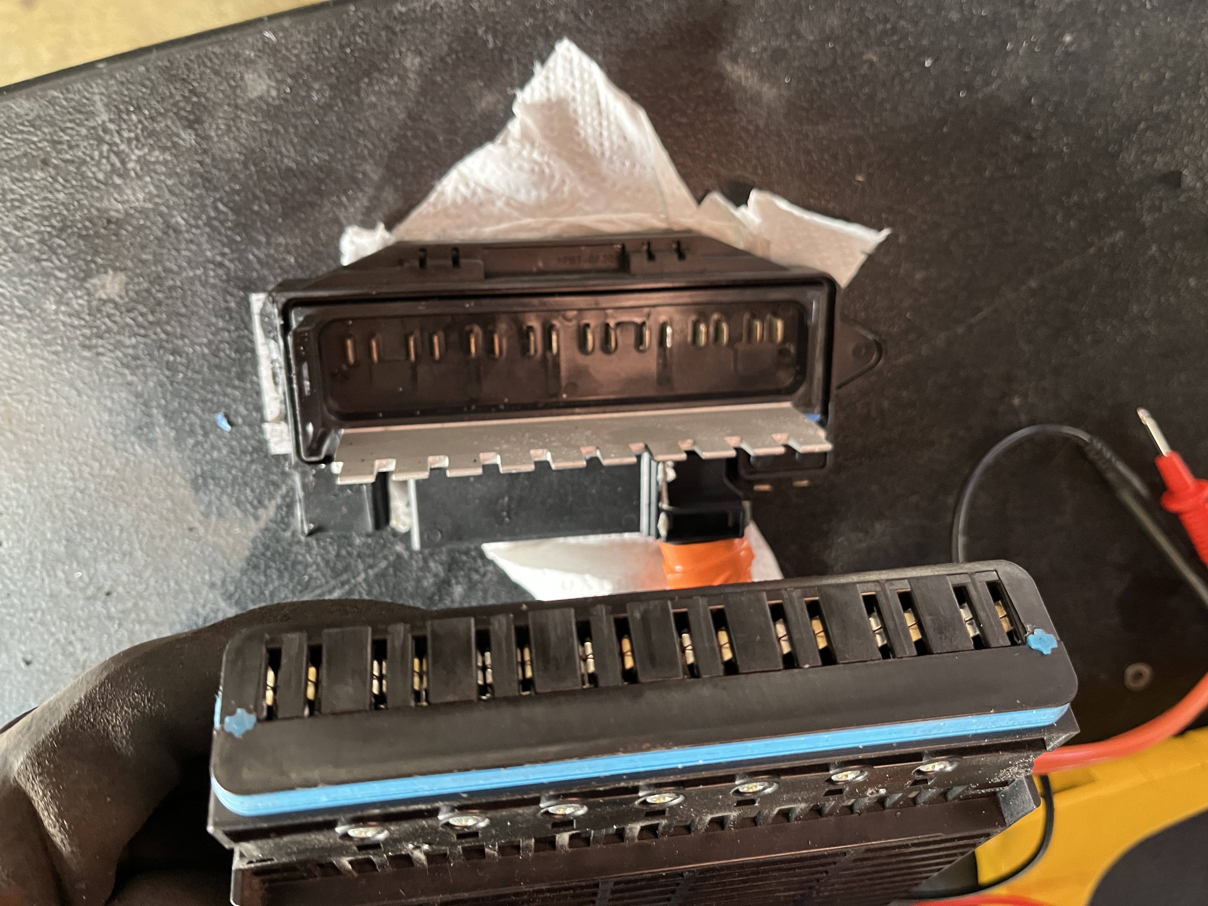

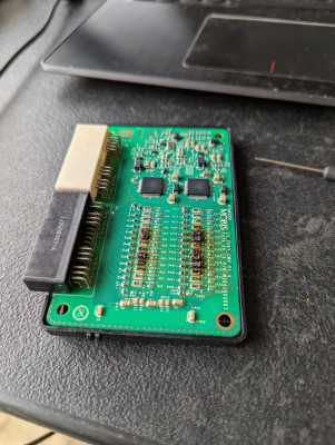

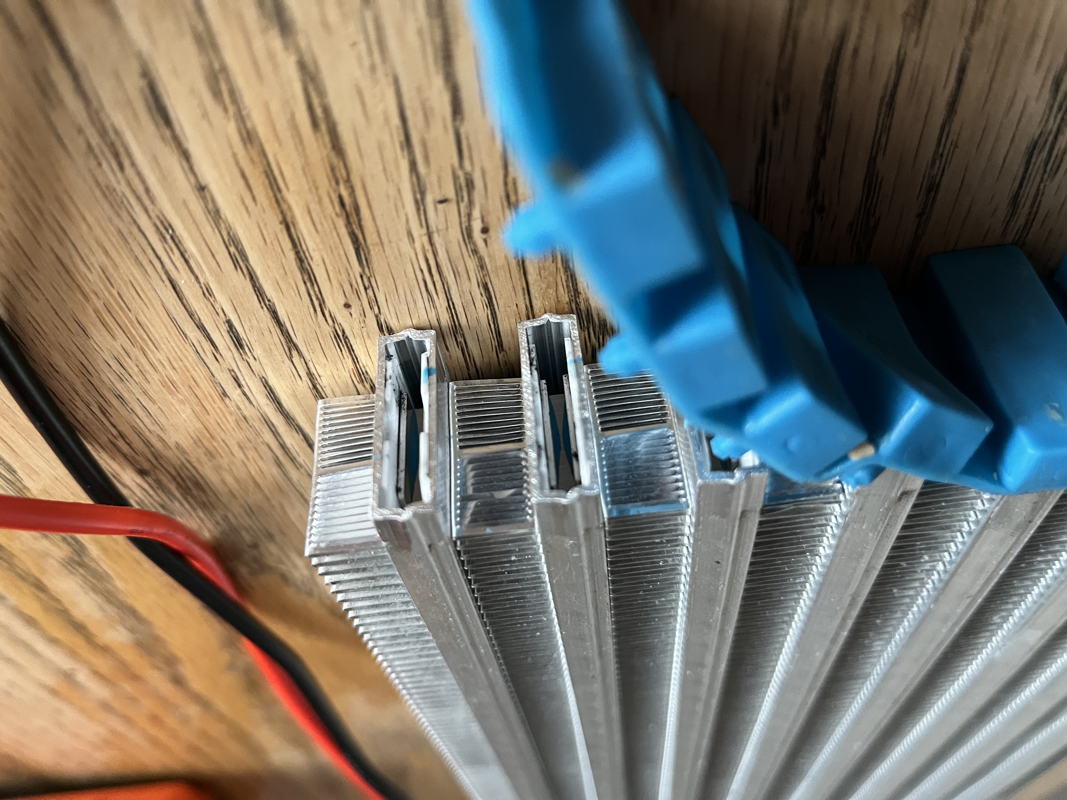

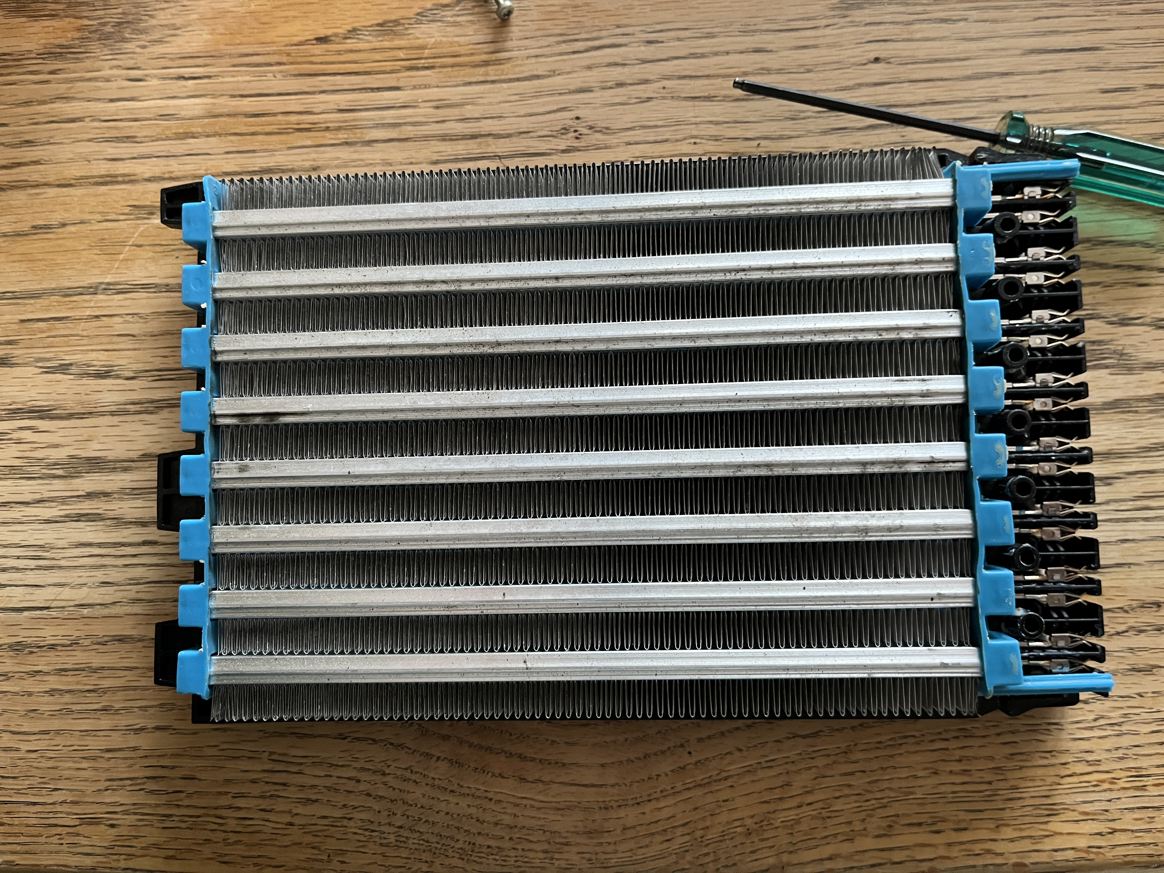

^ Nissan leaf PTC air cabin heater partially fitted into the heating duct of the subaru
^control unit popped off the heating elements. this is done easily by pressing the tabs on the sides.
^control board potted in
^ heater cores assembly
^plastic covers removed by removing screws and sliding them off
^if you look closely you can see the heating elements and gap pads inside the aluminum tubes
^resistance of 1 of the 8 elements
got the wrong top picture above.
^ complete air PTC heater located in my heating duct
