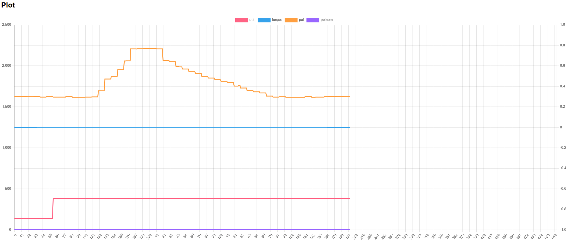

Re: [WIP] 1979 Subaru Wagon: Leaf Stack,Zomb,Ioniq 5 1/2 pack
plot attached. i included pot because potnom stayed at 0.
did you select a direction?
Please post your spot values too
Brake ON, you are now the second person in a 2 weeks to do this.

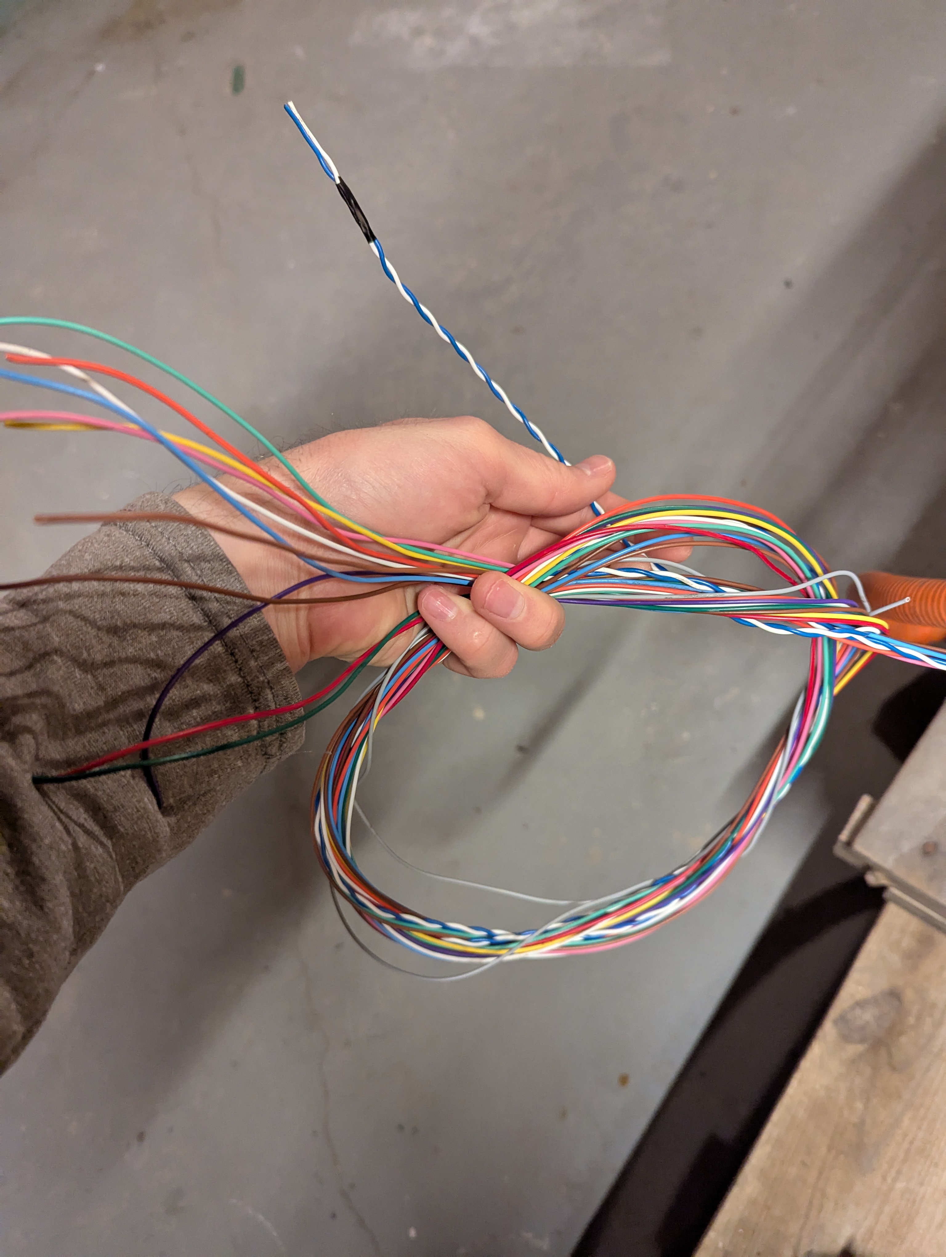

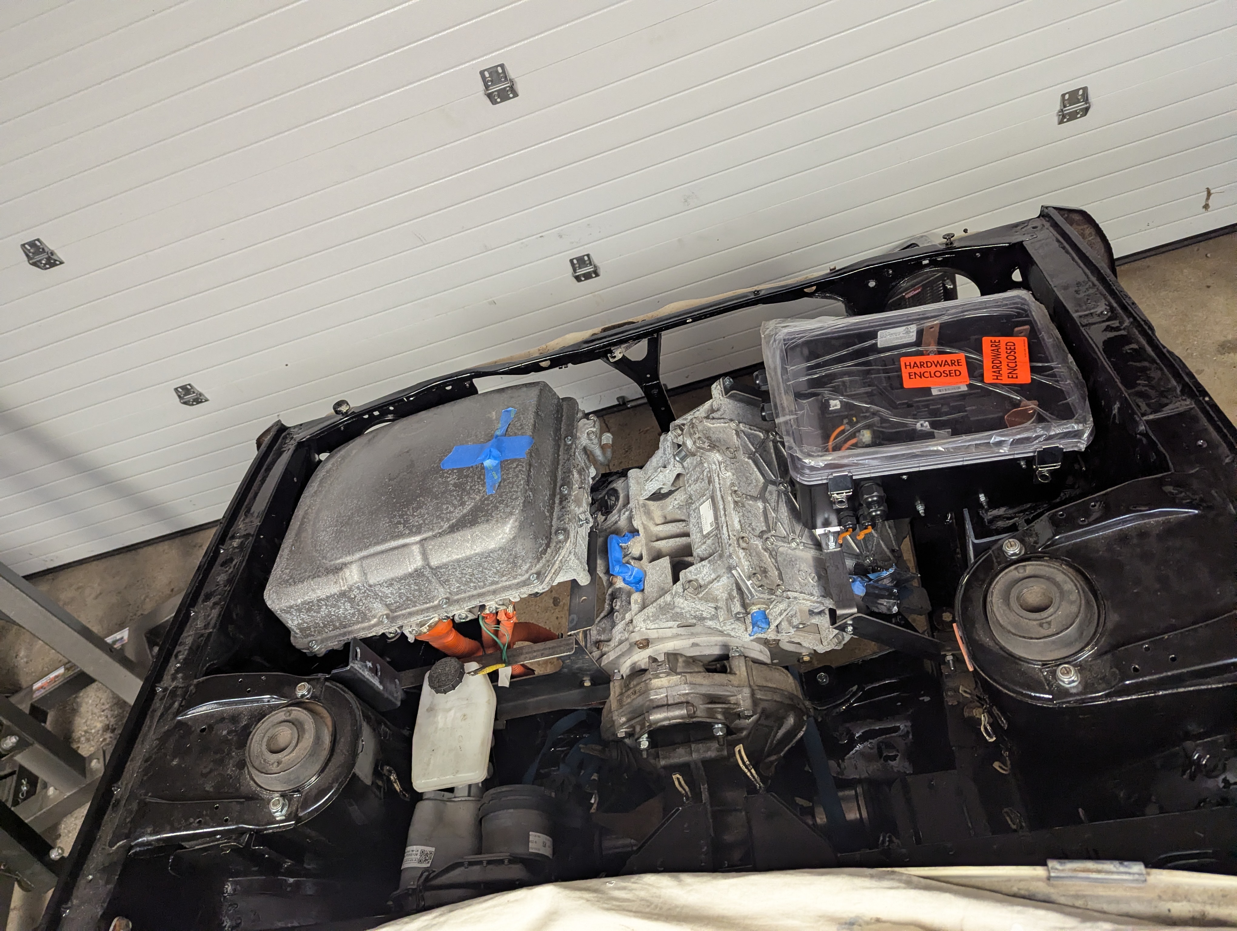

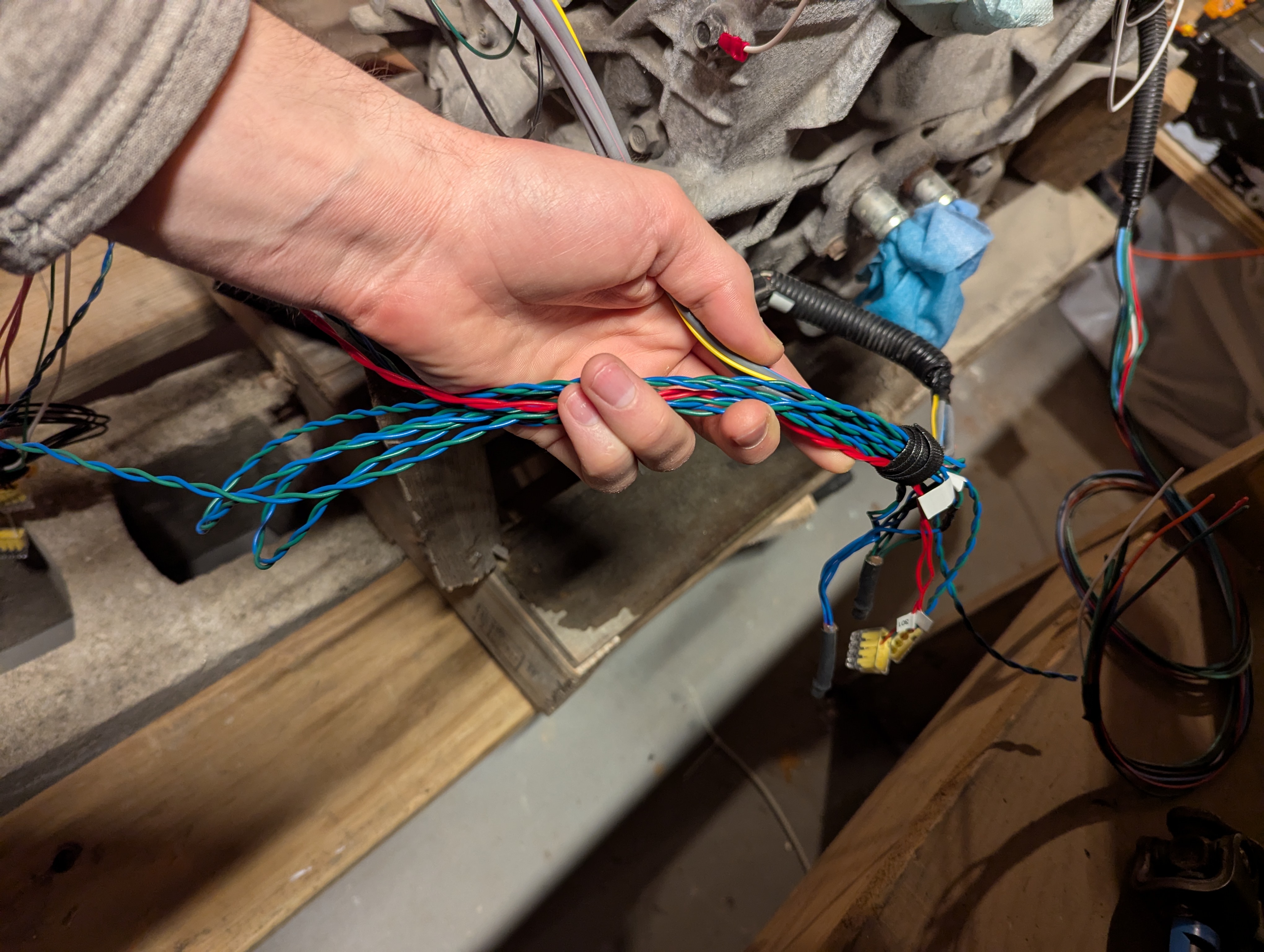

]lAnd here are some photos of the can lengths hanging out of my inverter and pdm connectors I was hesitating to cut off. Could these be causing issues? If they're suspect I can remove them and remake them later on
- Bratitude
- Posts: 1080
- Location: Canada
- Has thanked: 222 times
- Been thanked: 413 times
why keep all that? You have all the can branches still….
The stack only needs:
12v+
12v -
Can H
Can L
ignition
If you unwrap the harness, very quickly you can separate and clean up to a simple harness.
Add 6pin deutsch dt connector on then end, then wrap it all up. Makes it simple and clean
Also not sure what year stack you have, but that teal line usually is the ignition from the motor harness.
I kept the wires because i wasn't sure if there were any i was going to need in the future. Thats crazy you only need 6 wires going to the stack. Very excited to clean up the harness.
Thank you for catching that i wasn't pressing the brake! Sure enough when i press the brake and accelerator i got a spin!! Spent the morning taking the gearbox off and making a new pallet and then after dinner it span first try!!! My girlfriend captured my reaction on video which is pretty funny. The first time i pressed the pedal it span up and then decelerated smoothly. Second time i pressed the pedal it began to judder and i had to switch the system off to get it to stop. I'll play with the throttle/regen/limit settings and do some more research to try to make it accelerate smooth and stable. parameters and plots are attached incase anyone wants to scan for possible fixes.
WOOHOOOOOOOO
WOOHOOOOOOOO
Full HIM first real spin 4-13-25.pdf- (1.62 MiB) Downloaded 450 times

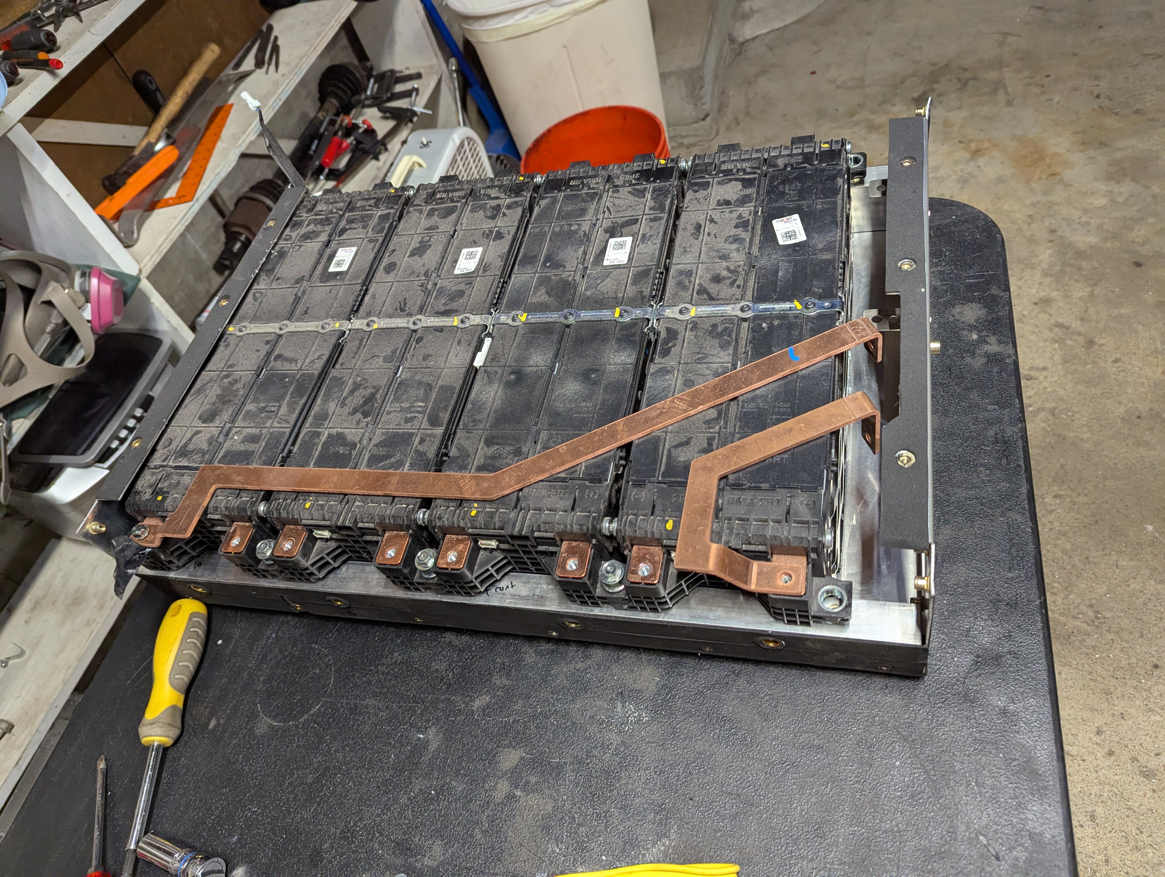

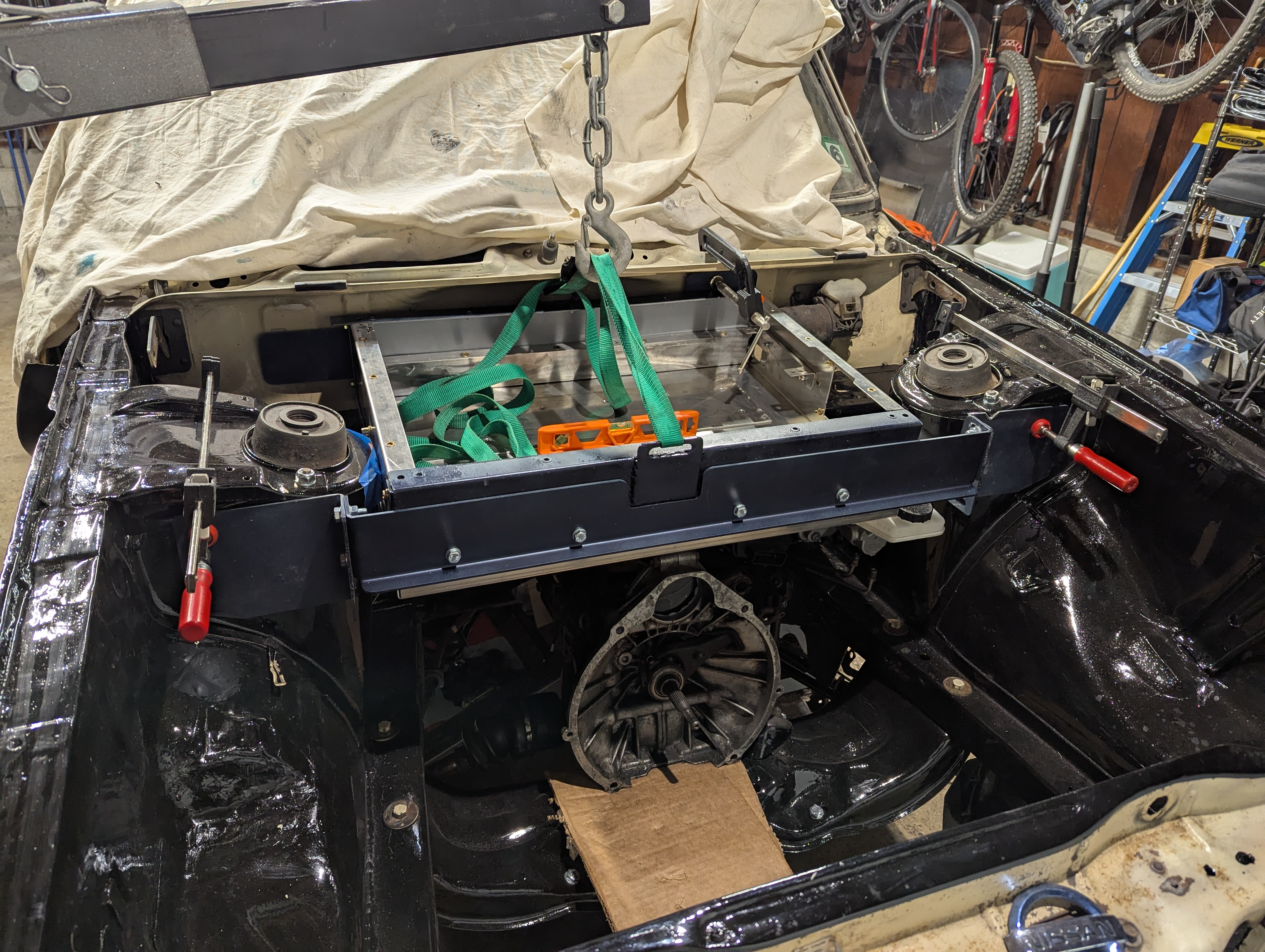

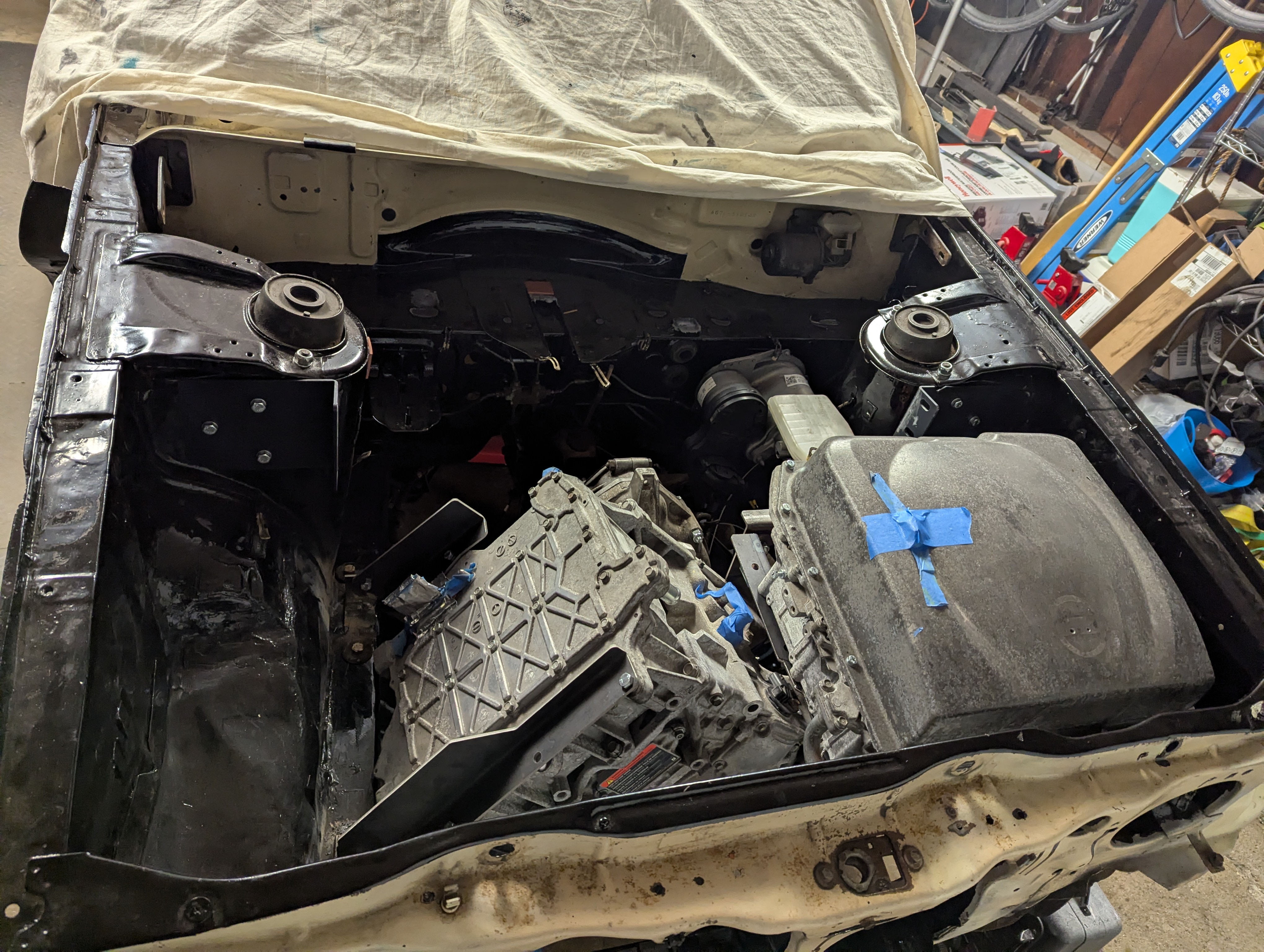

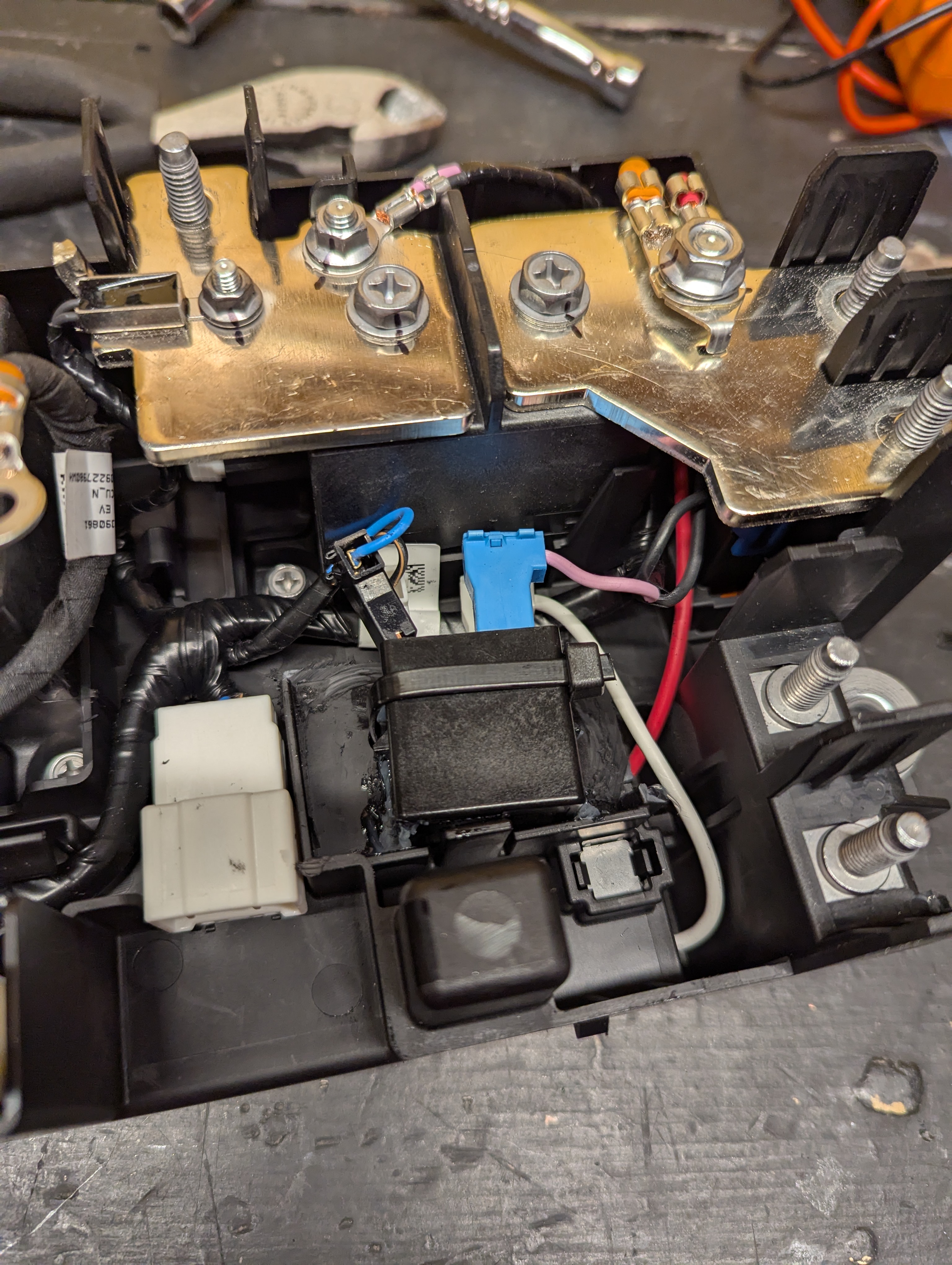

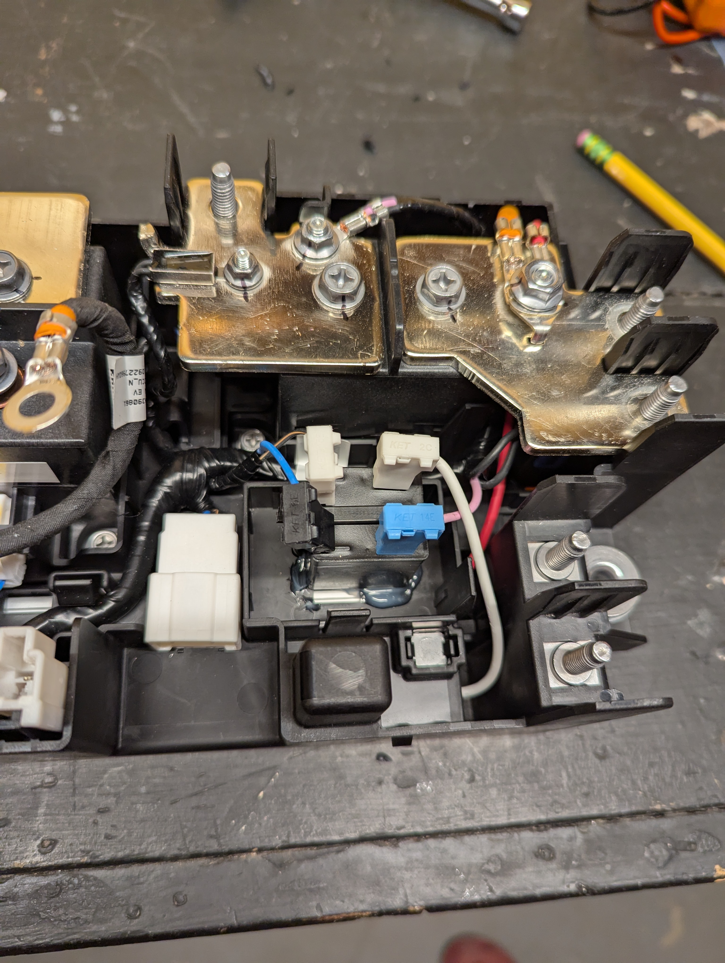

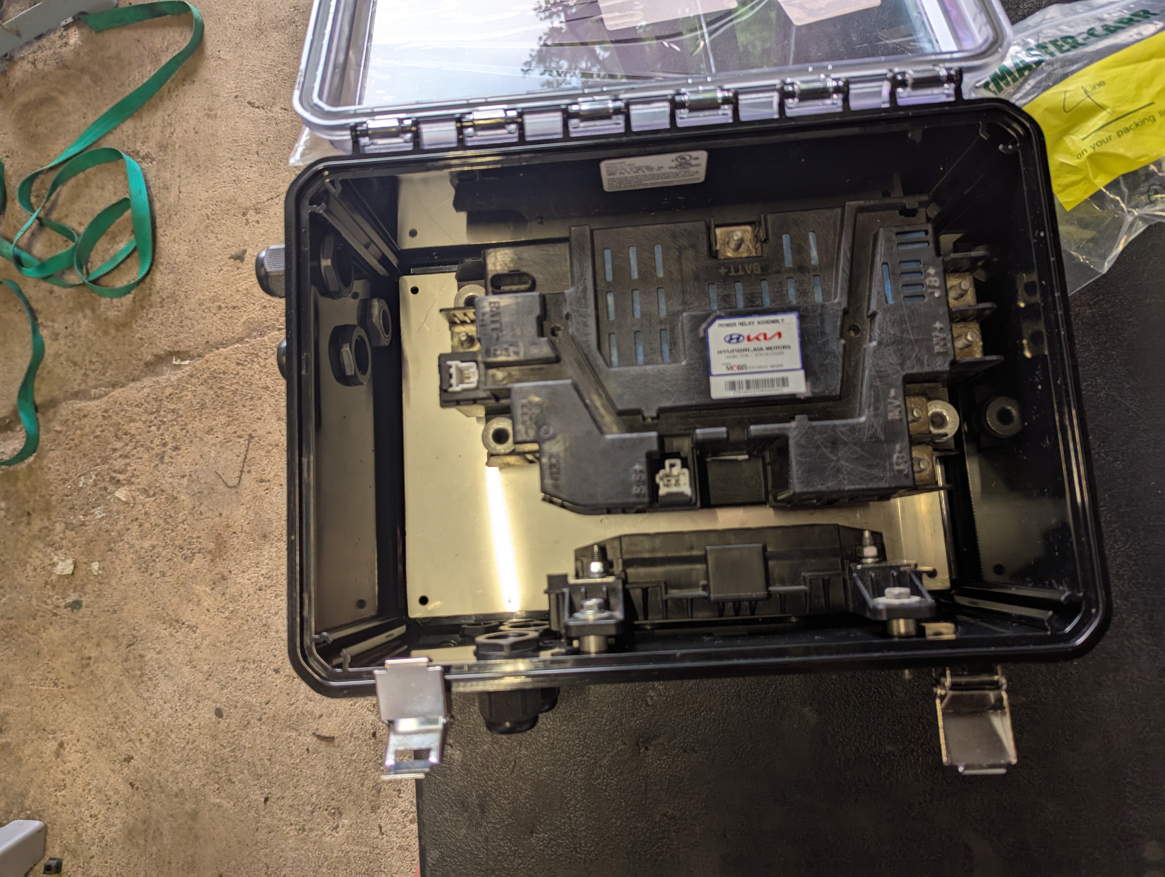

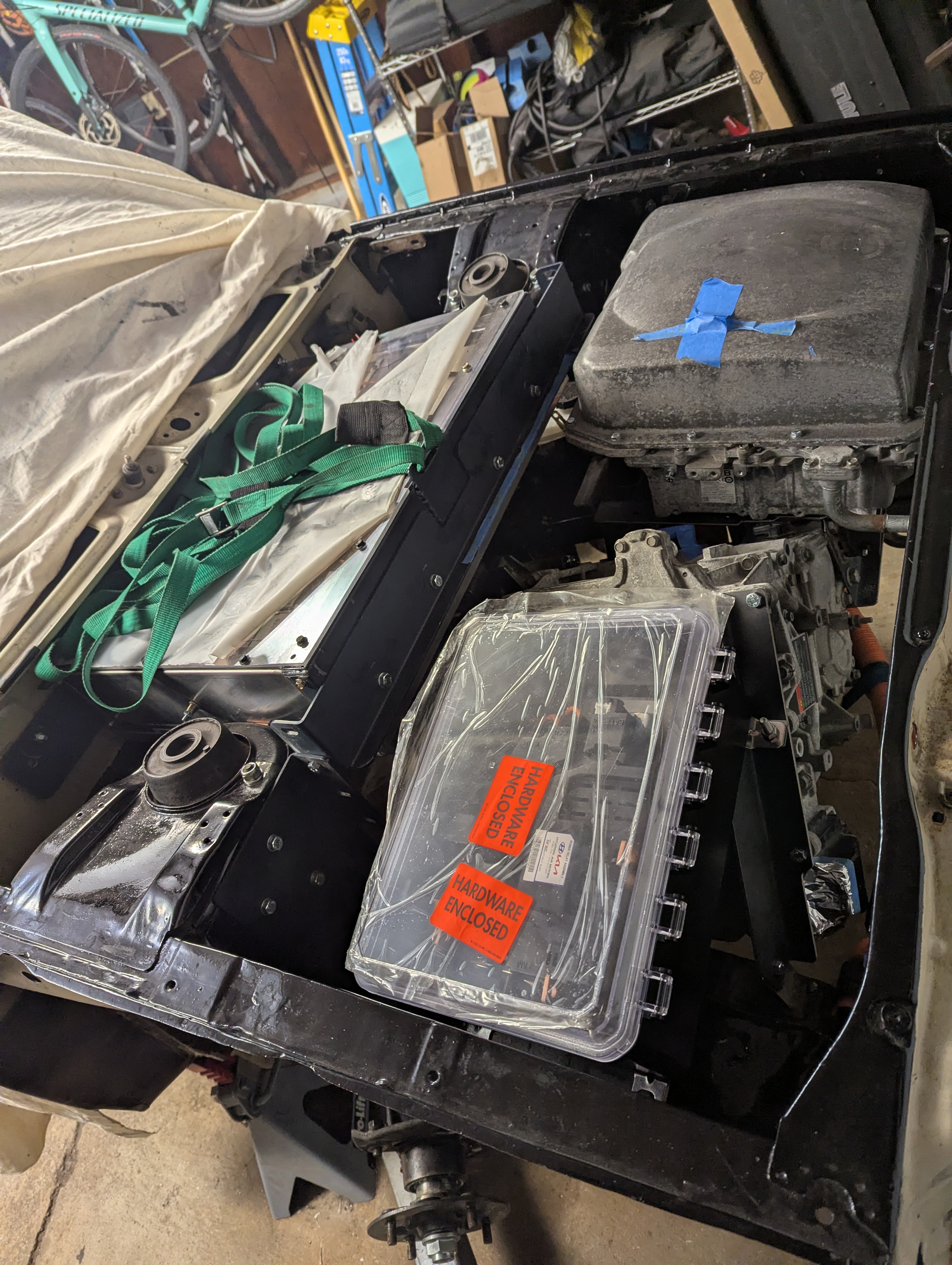

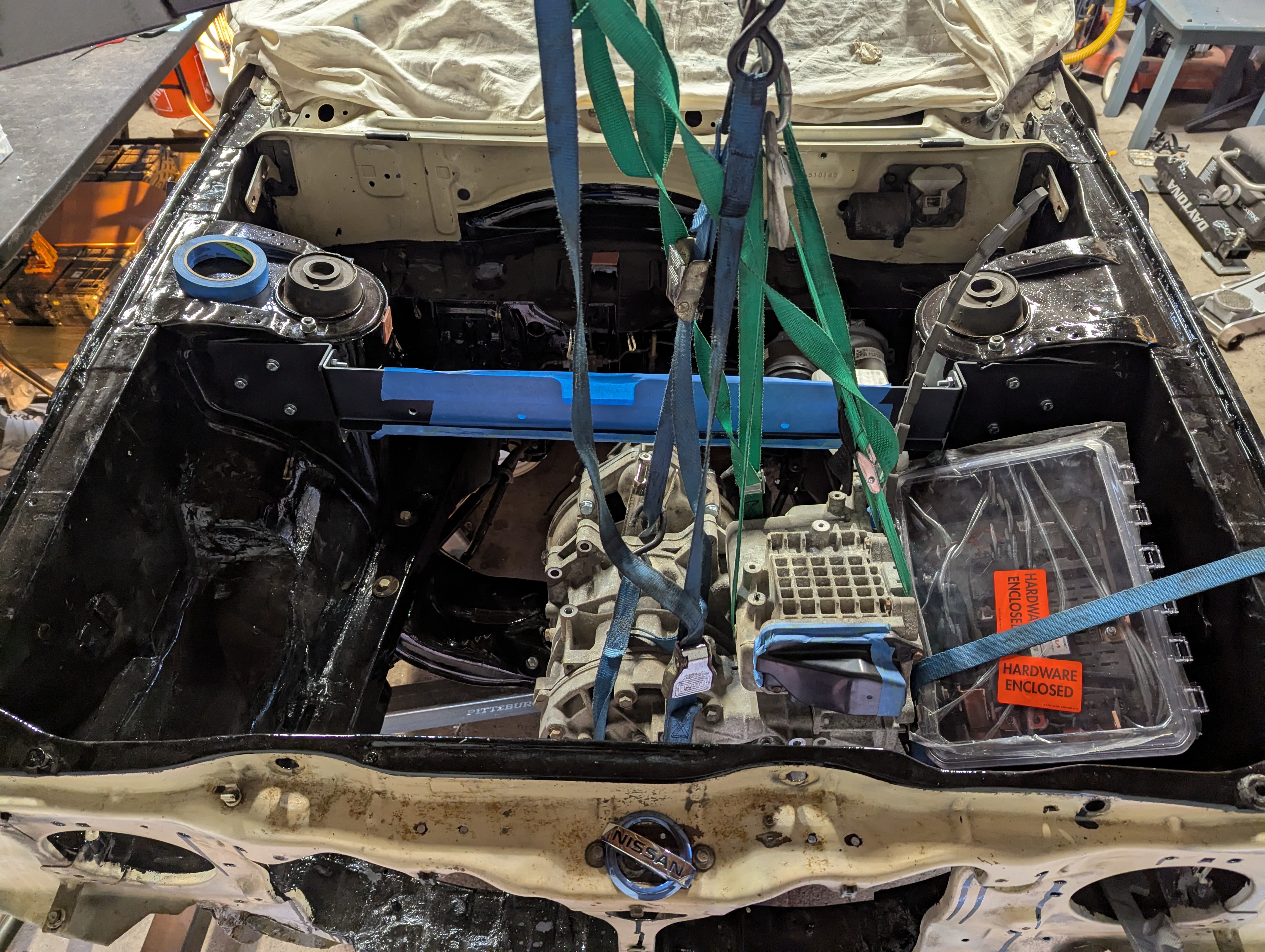

Using the hyundai/kia power relay assembly aka contactor box has one challenge (so far): The relay is not a relay it is actually a FET or something, and my electrical engineer friend and i have a hunch that it requires 800v to operate. I ordered a 400v relay (Panasonic AECN11012) to replace it. It clicks with 12V applied which the previous "relay" did not do! Pics of the mods to install the new relay are below.
relay upright. tidy, but interferes with bus that goes above it.
relay tipped over. had to dremel off some plastic. not as tidy, but fits well and plenty of creepage and clearance distance to buses above. held down with a zip tie and RTV.
Somehow my 12V battery discharged to 4.7v over the course of a week of being unplugged. No idea why that happened and wondering if i can revive it or if it has to be tossed. It was brand new 2 months ago and i didn't notice any dip in voltage in my previous testing.
Still trying to source a Subaru. My contact in connecticut with three of these sandbagged me and doesn't actually want to sell me one. There are 2 in oregon i'm trying to buy, but one of the sellers is on vacation. Simultaneously I have had 2 leads for selling my remaining batteries fall through (one was a scam). Glad i'm in engineering and not purchasing or logistics jeezum!

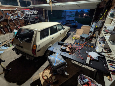

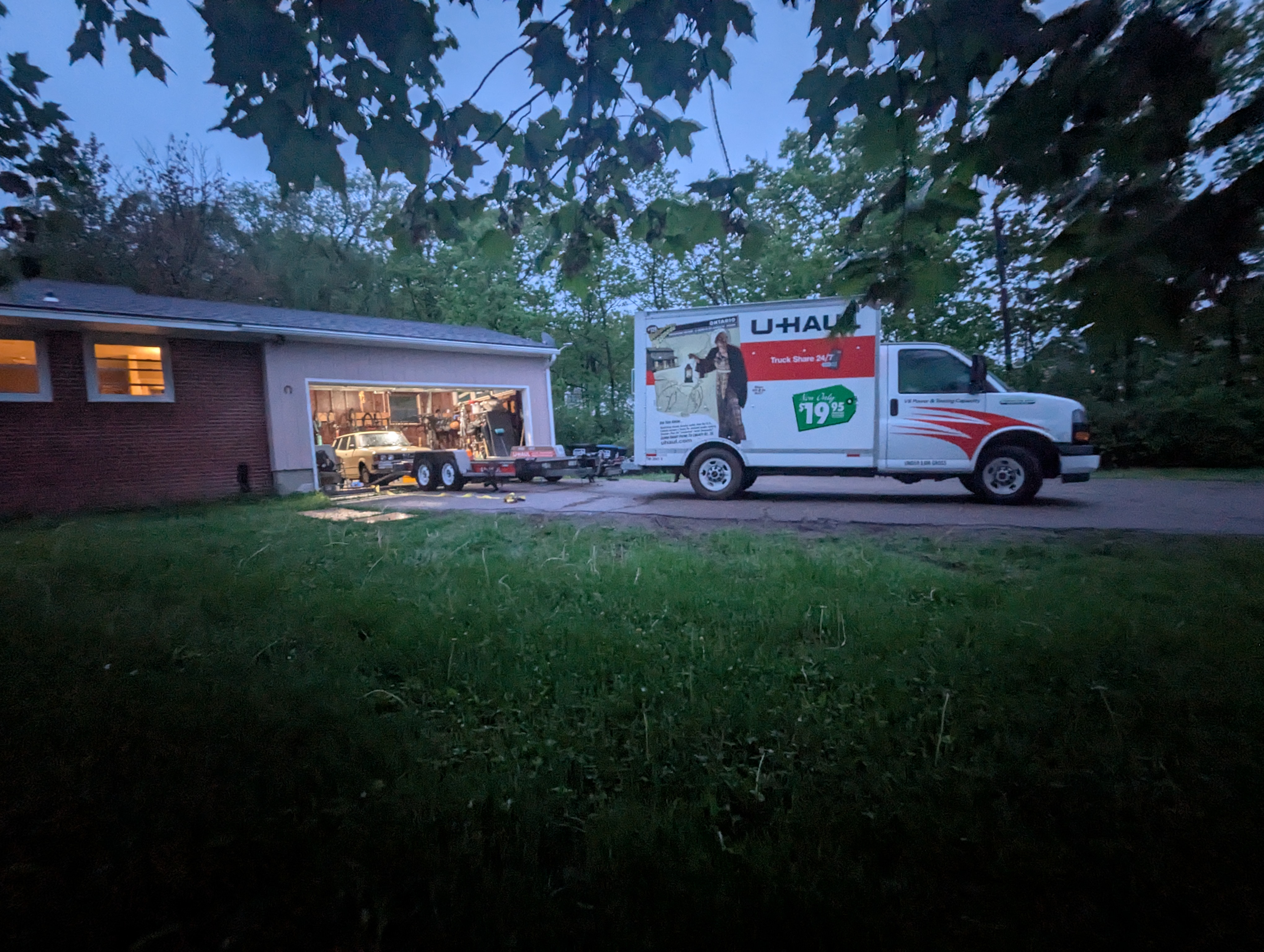

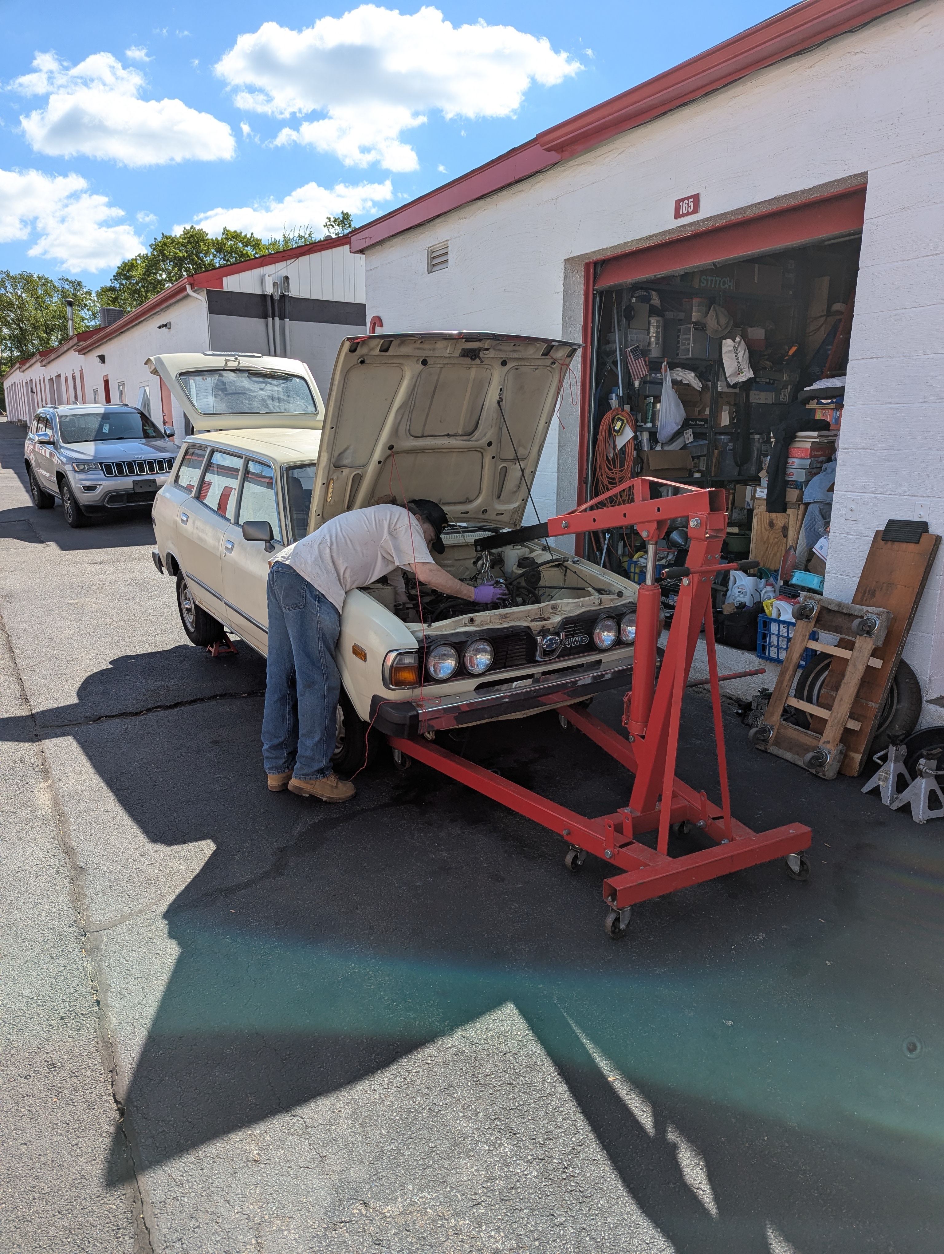

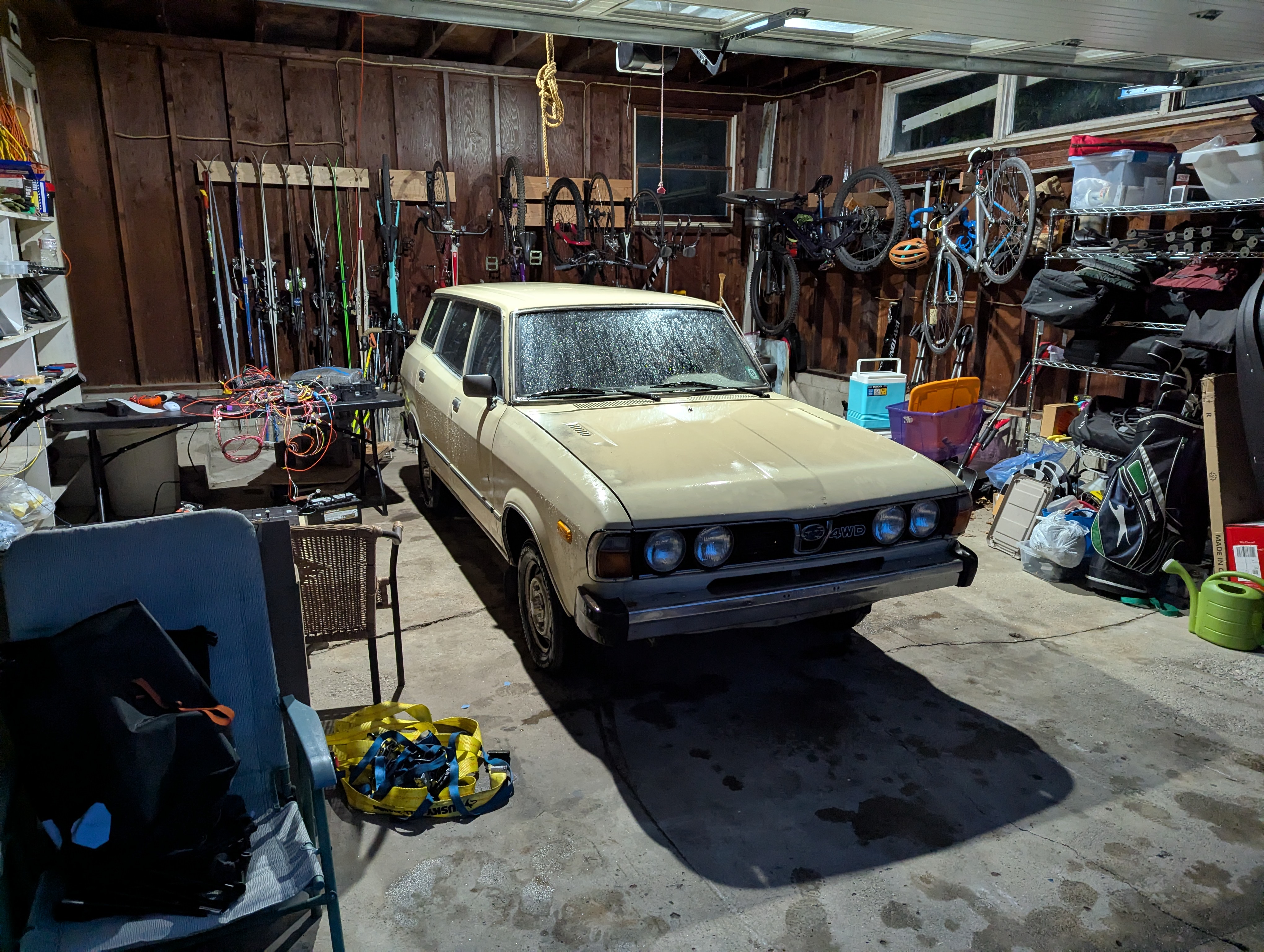

Got my car!! 1979 Subaru GL 4x4 wagon. Originally from NJ, bought it from an enthusiast in CT with 75000mi. He kept the engine, gas tank, and exhaust and gave me a great deal on what was left. Had a hell of a time driving it back on a Uhaul trailer and box truck and sinking them up to the axles in my front yard. Now for the fun!! Step 1, where do the batteries go?

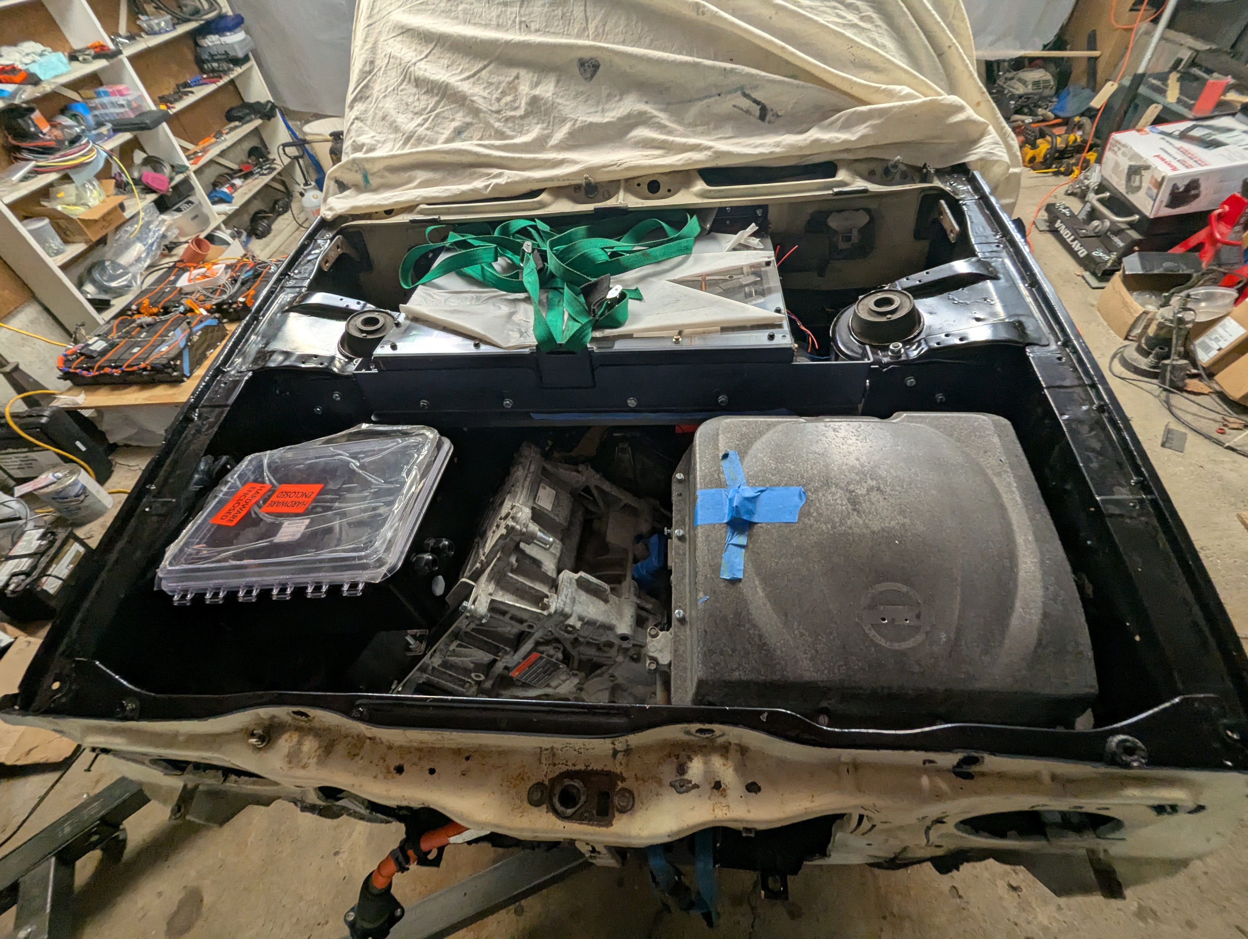

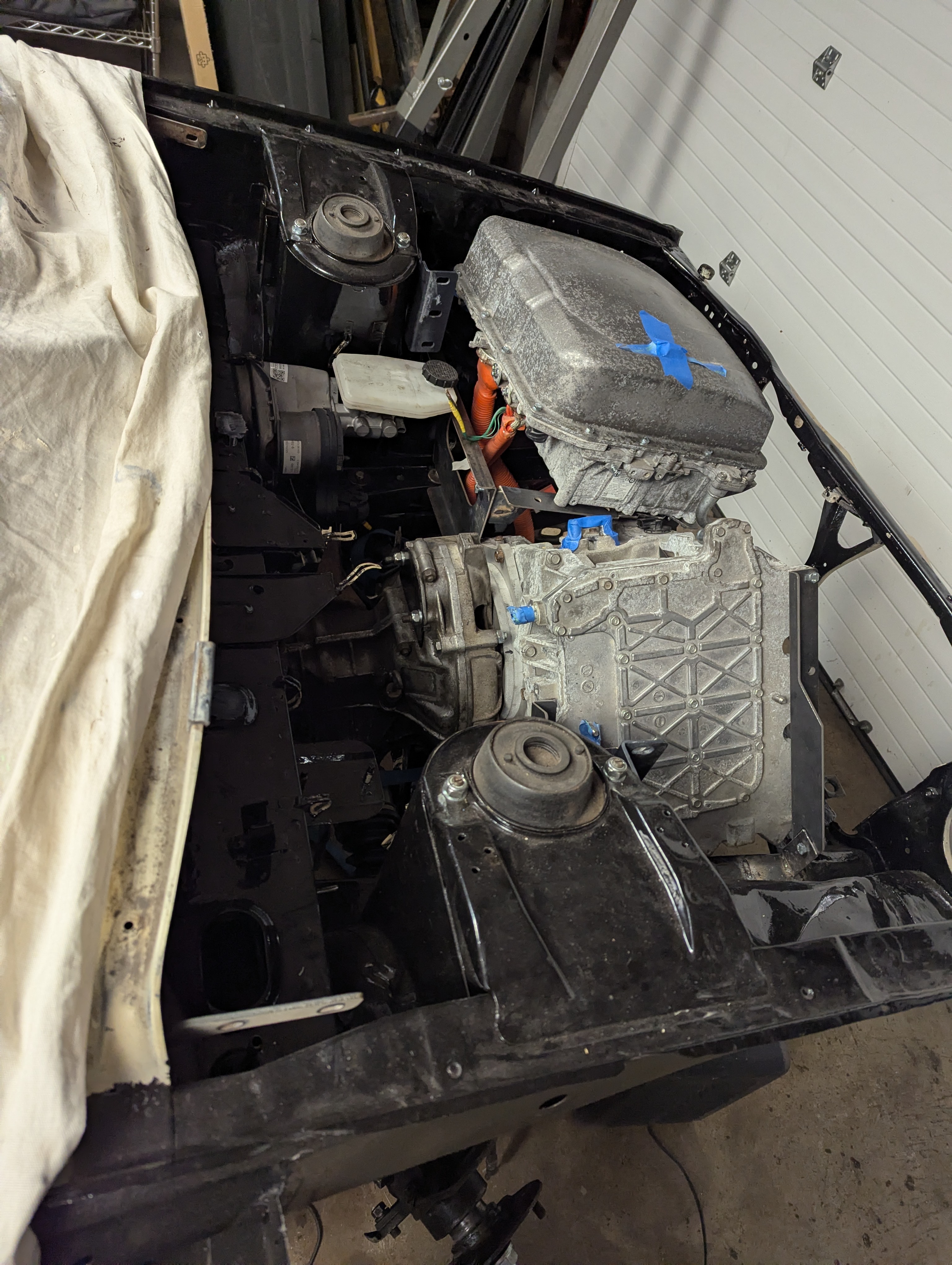

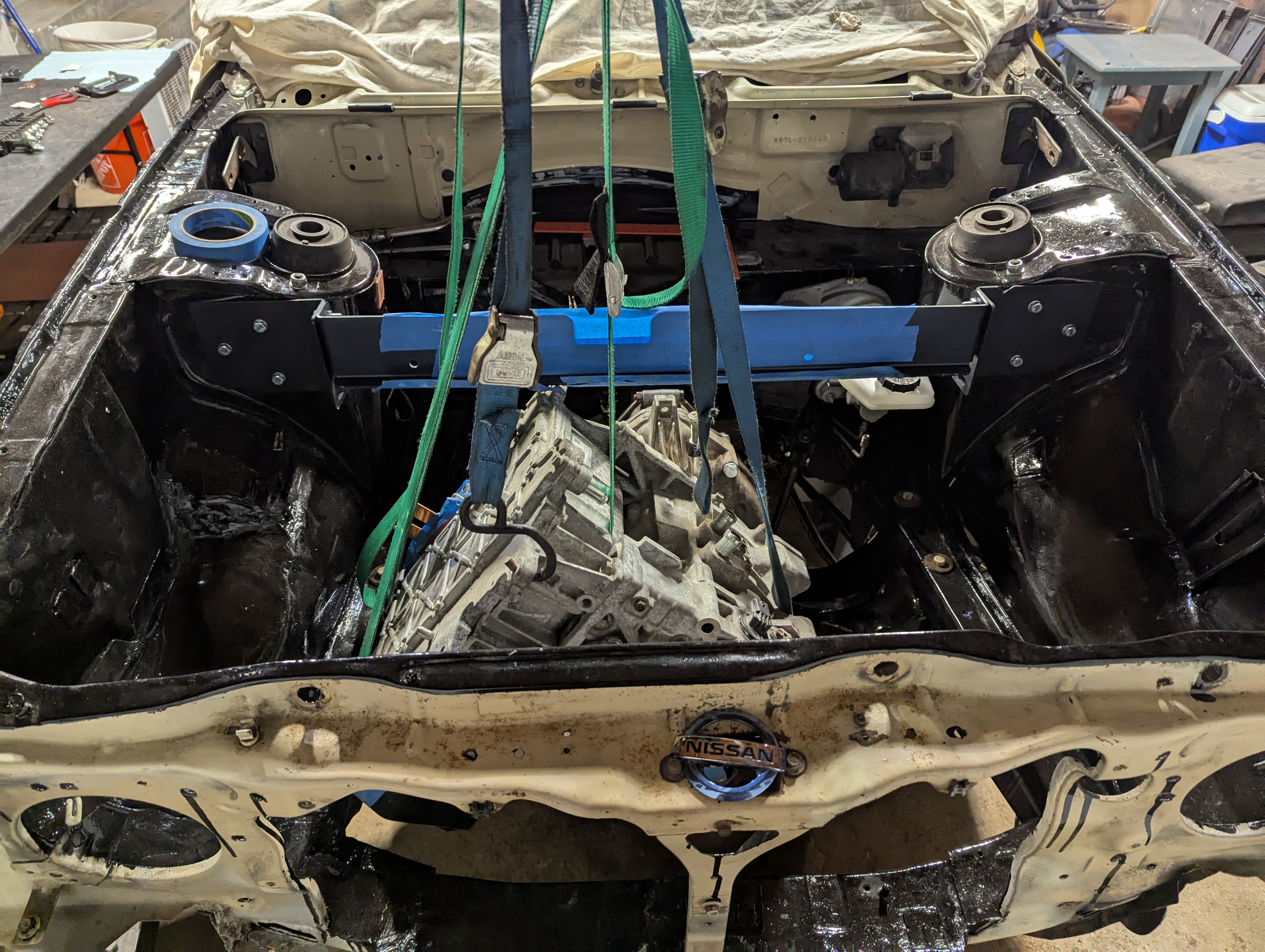

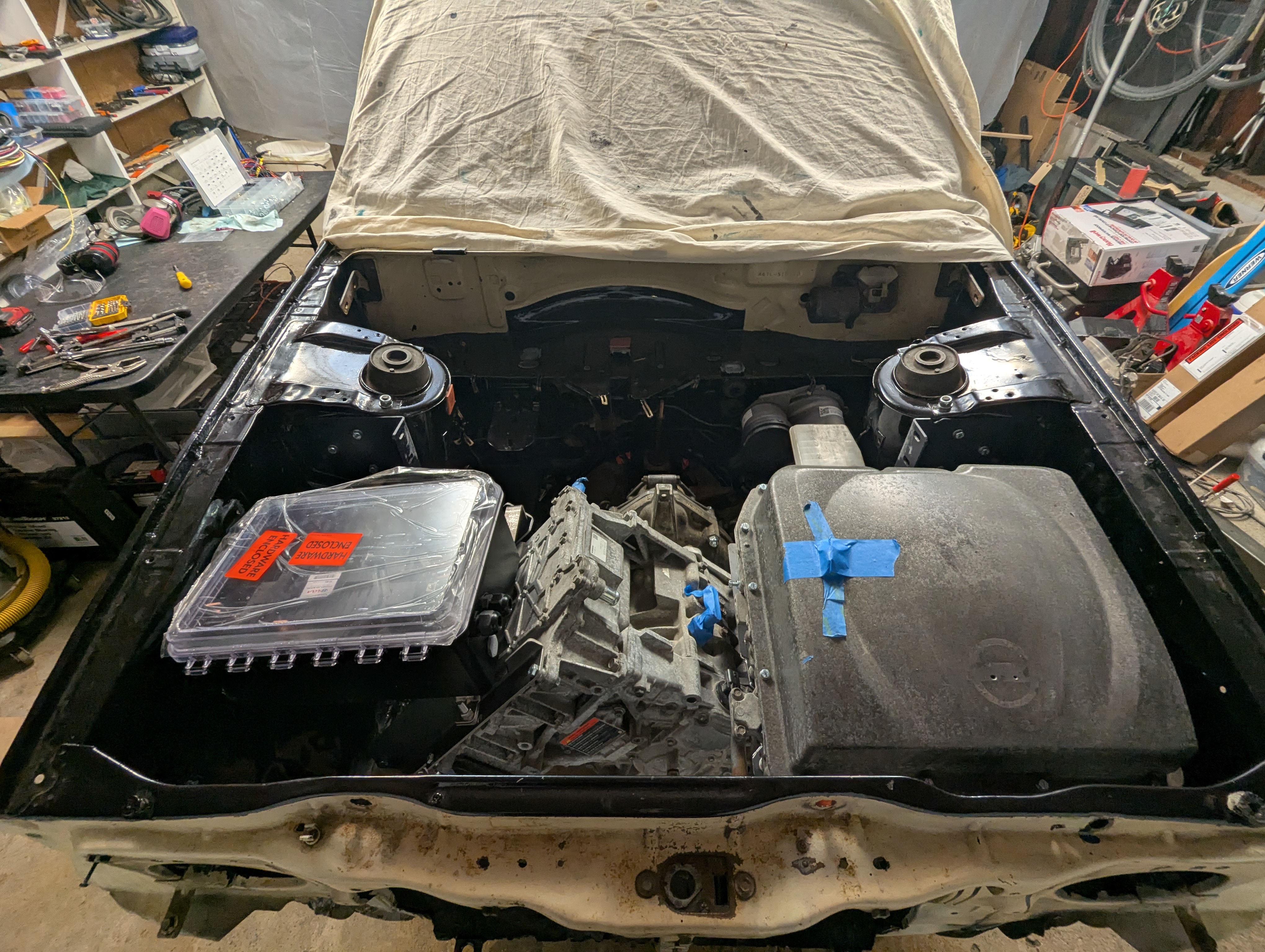

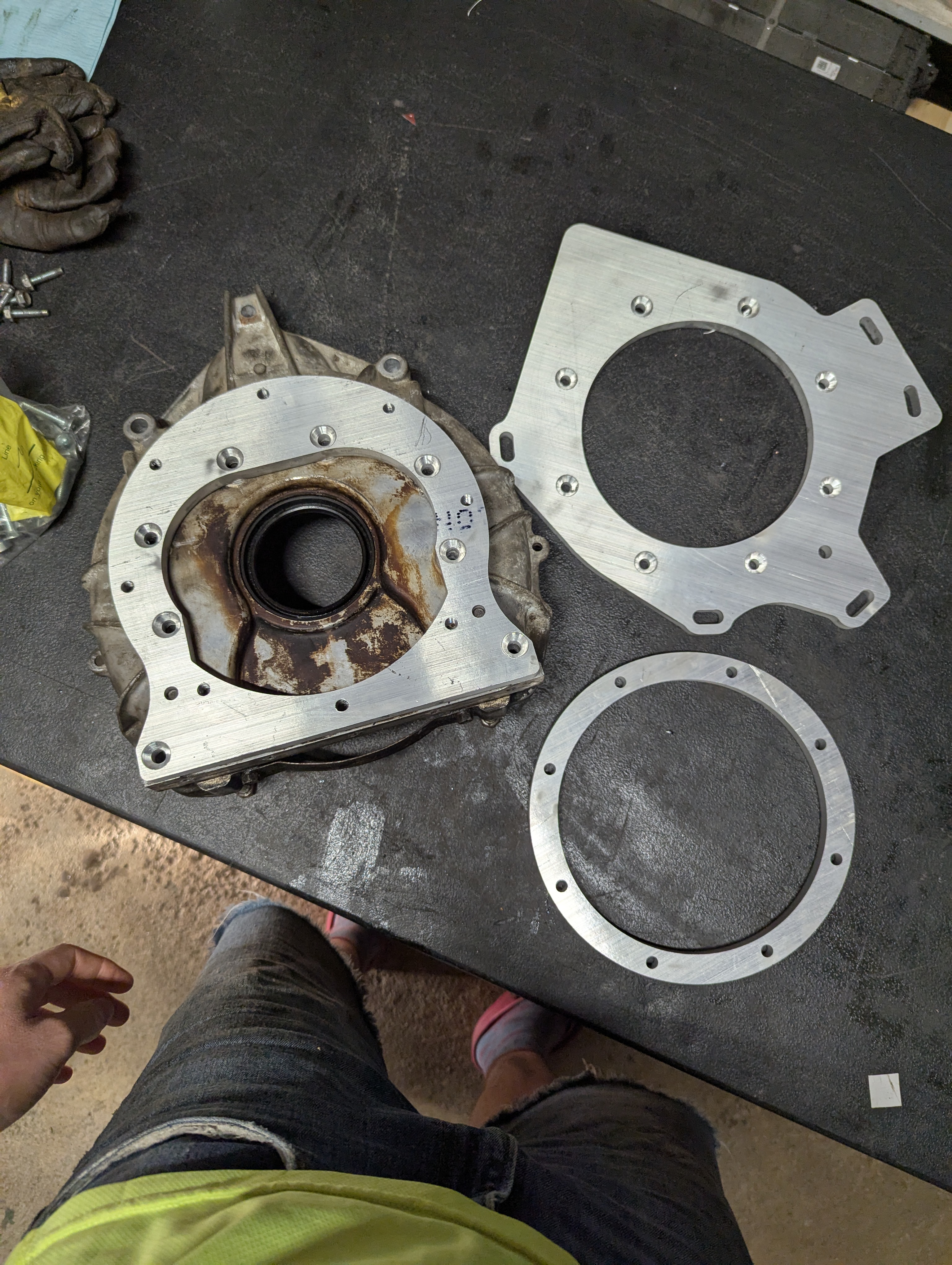

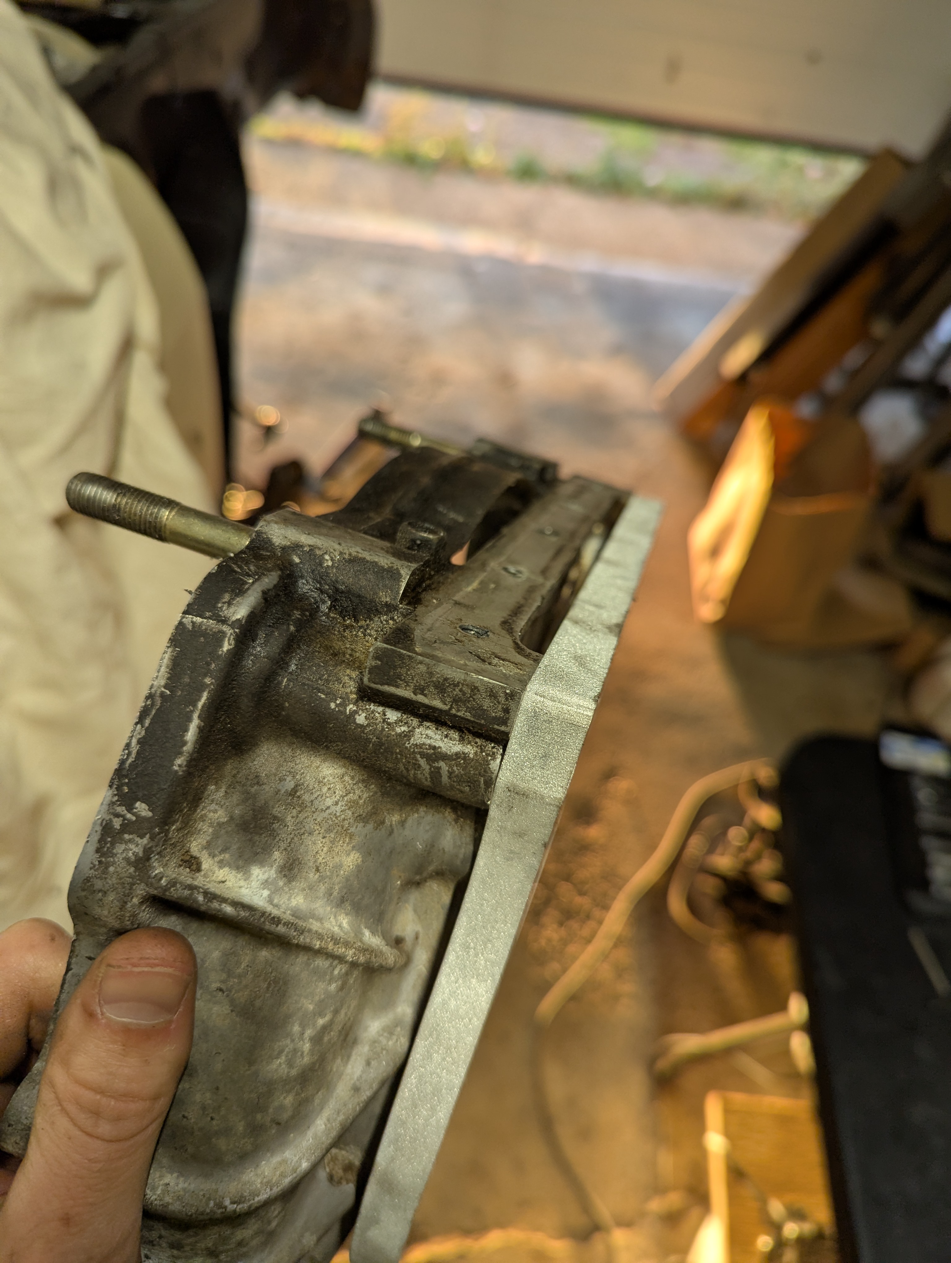

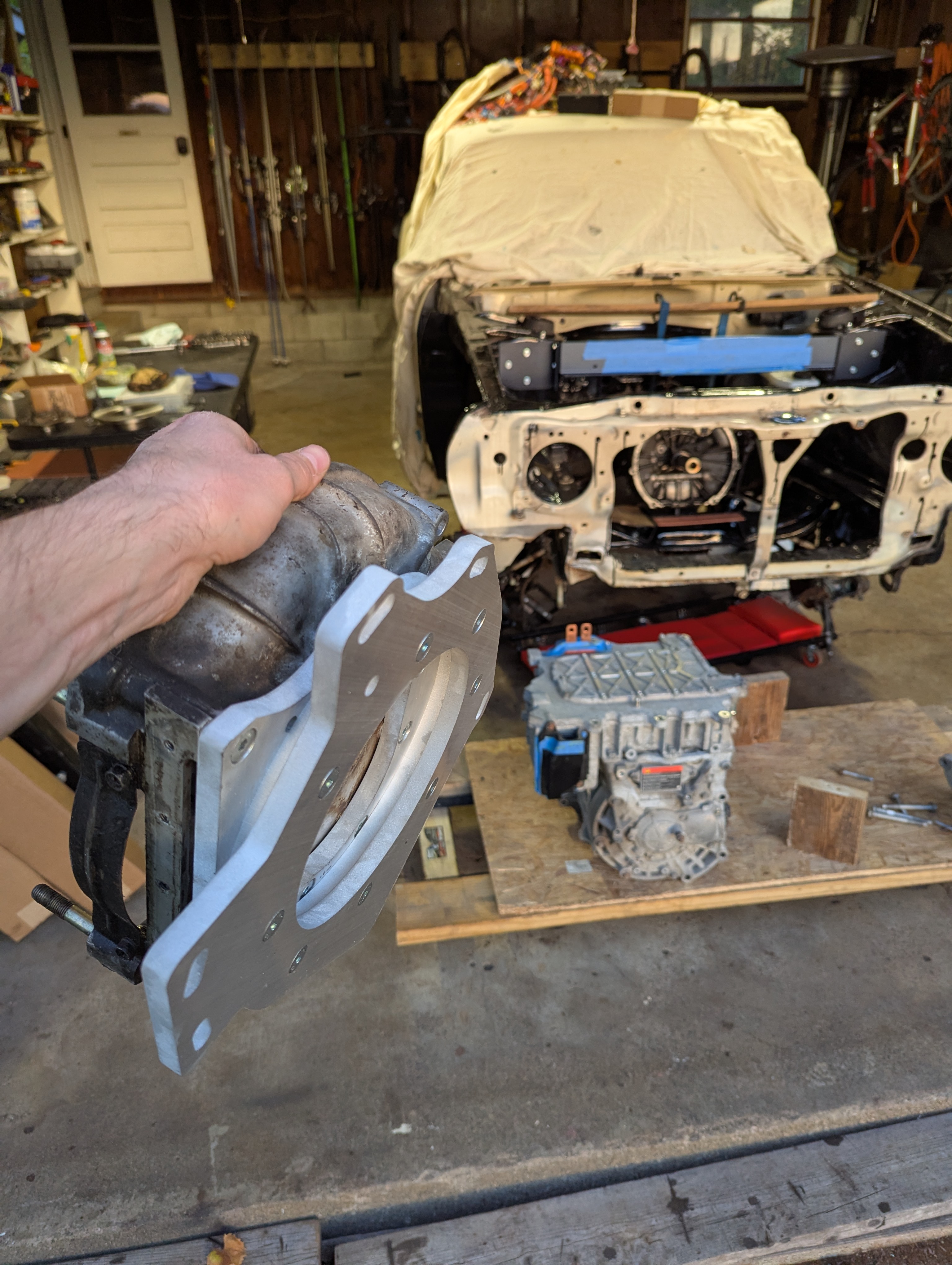

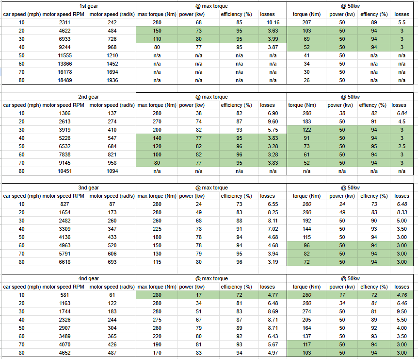

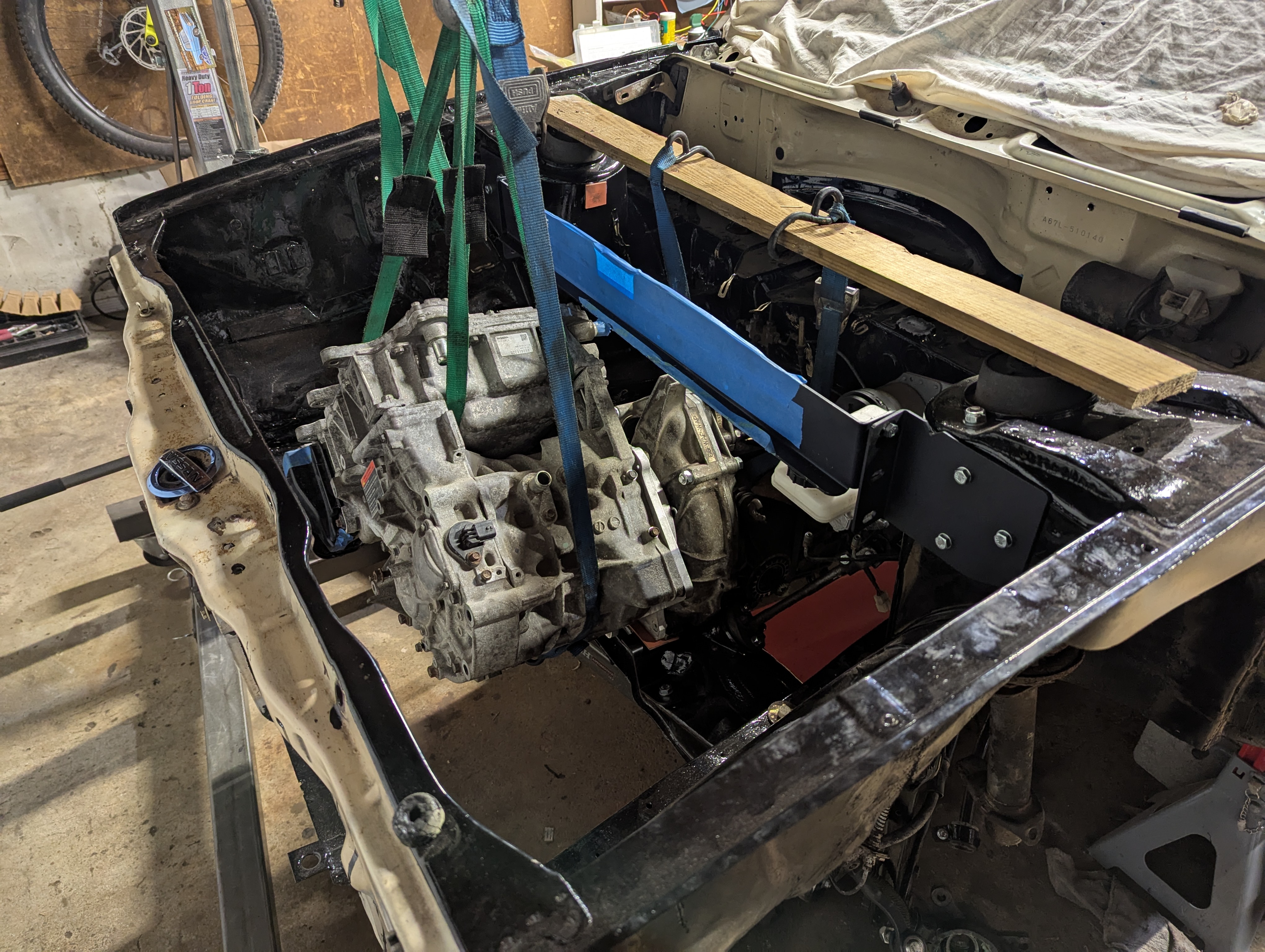

@bratitude i'd like your thoughts on the transmission. i kept it in and i got a bellhousing so i can use your system, but i'm wondering about changing it out for a transfer case. i got the service manual for my car so i gotta look up gear ratios and see what RPMs and speeds would look like. the transmission is pretty small and looks pretty light so idk if it would be worth it. if you've gone through that thought experiment what were your takeaways?
- Bratitude
- Posts: 1080
- Location: Canada
Well how complicated do you what it to be?
And do you want it 4wd?
Or awd?
Rwd? Or fwd?
Keeping the original gearbox means no drive line mods or additional fabrication. if anything you could switch to a ej awd 5mt and have awd.
Ether way I have an adapter sitting on the shelf
Or use the leaf gearbox and make it fwd. then custom axles and motor mounts. If it will even fit.
But it’s a Subaru, Fwd? Yuck
Or awd?
Rwd? Or fwd?
haha i specifically got this car for the selectable 4WD! do you normally leave it in one gear or shift at all? i didn't get a flywheel/clutch because i saw one video where a guy said you don't need a clutch to shift a manual with an electric motor.

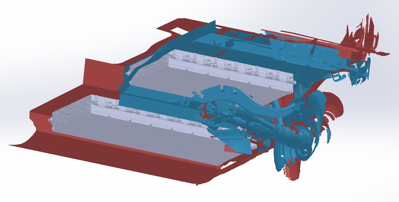

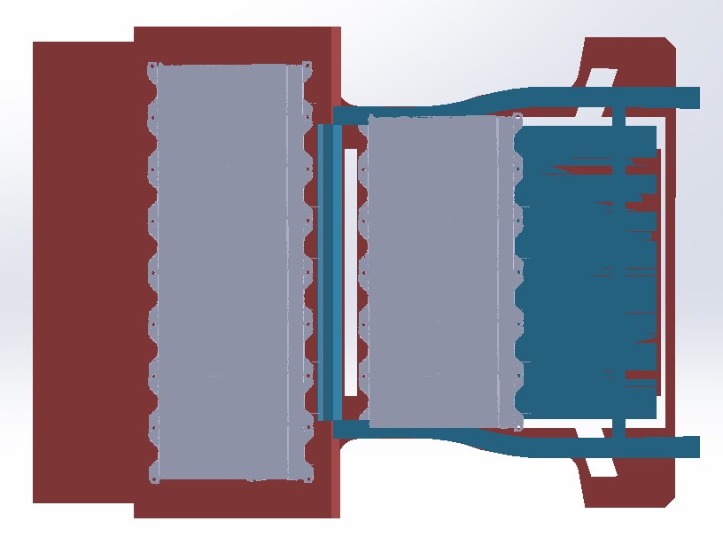

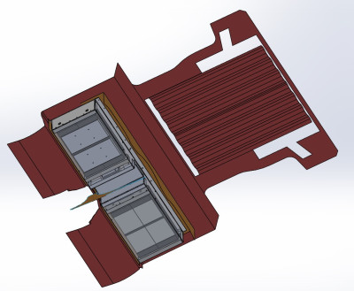

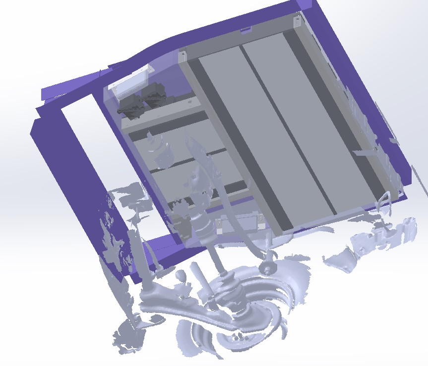

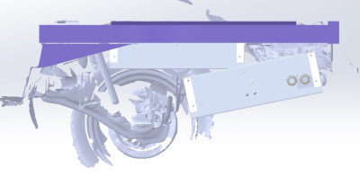

i got a cheap 3D scanner and played around with various free pieces of software and i'm incredibly unimpressed with the software. i don't fully trust my scanner yet either. but i got some crude ugly models that i brought into solidworks where i'm going to design my battery boxes. it looks like they'll fit better than i thought and i might not need to do a rear seat delete!

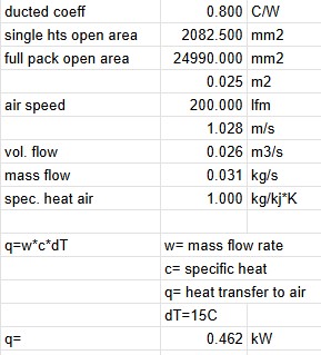

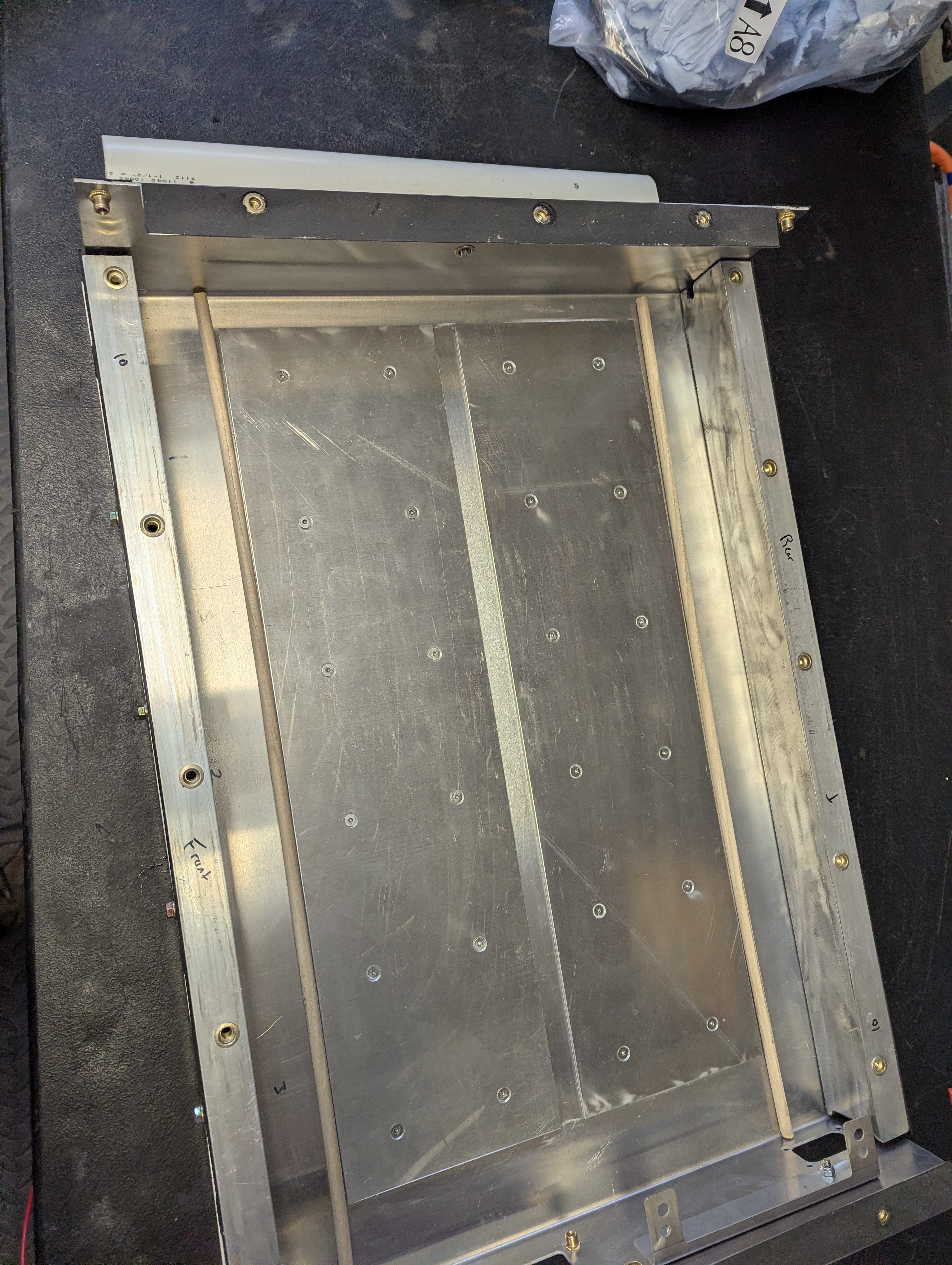

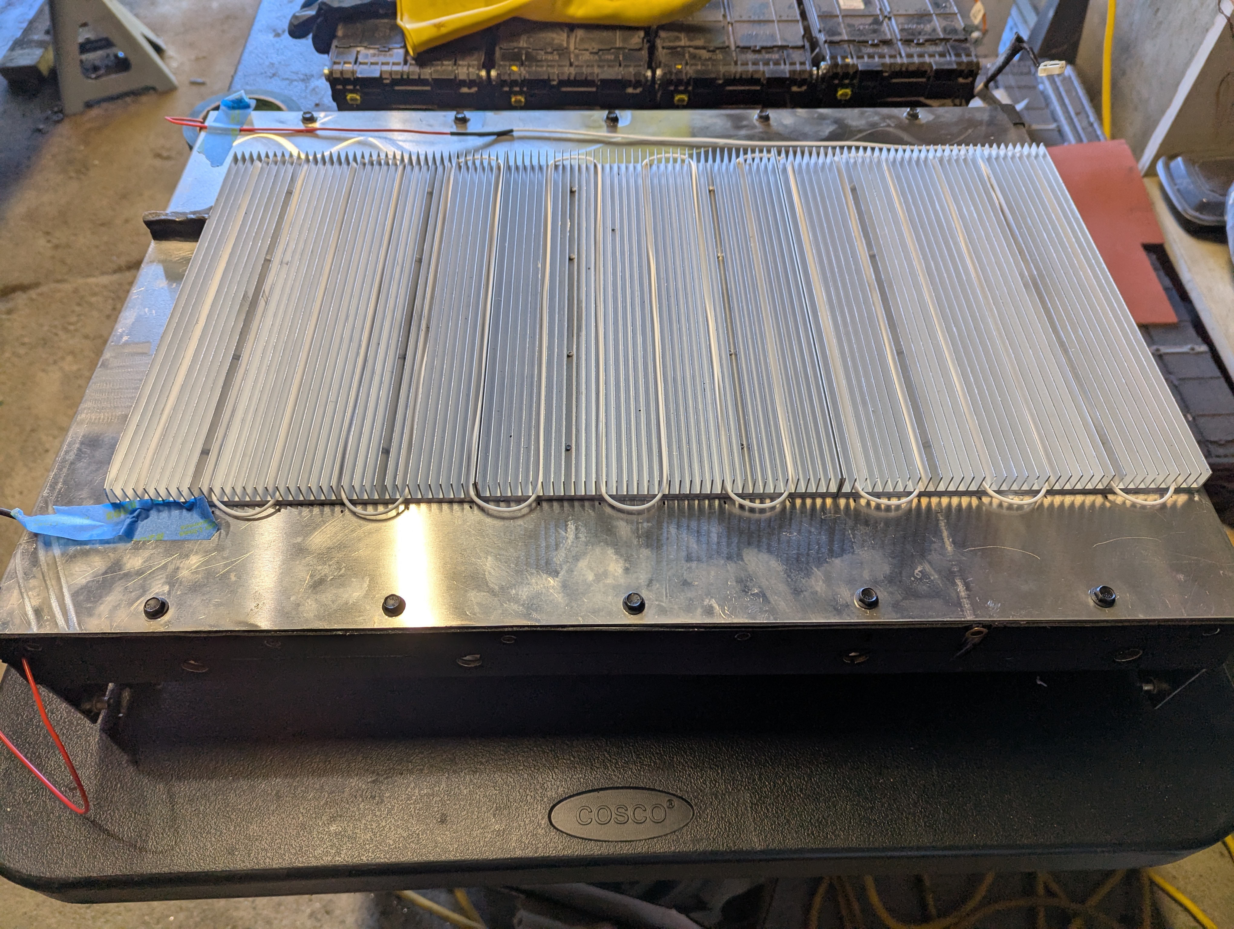

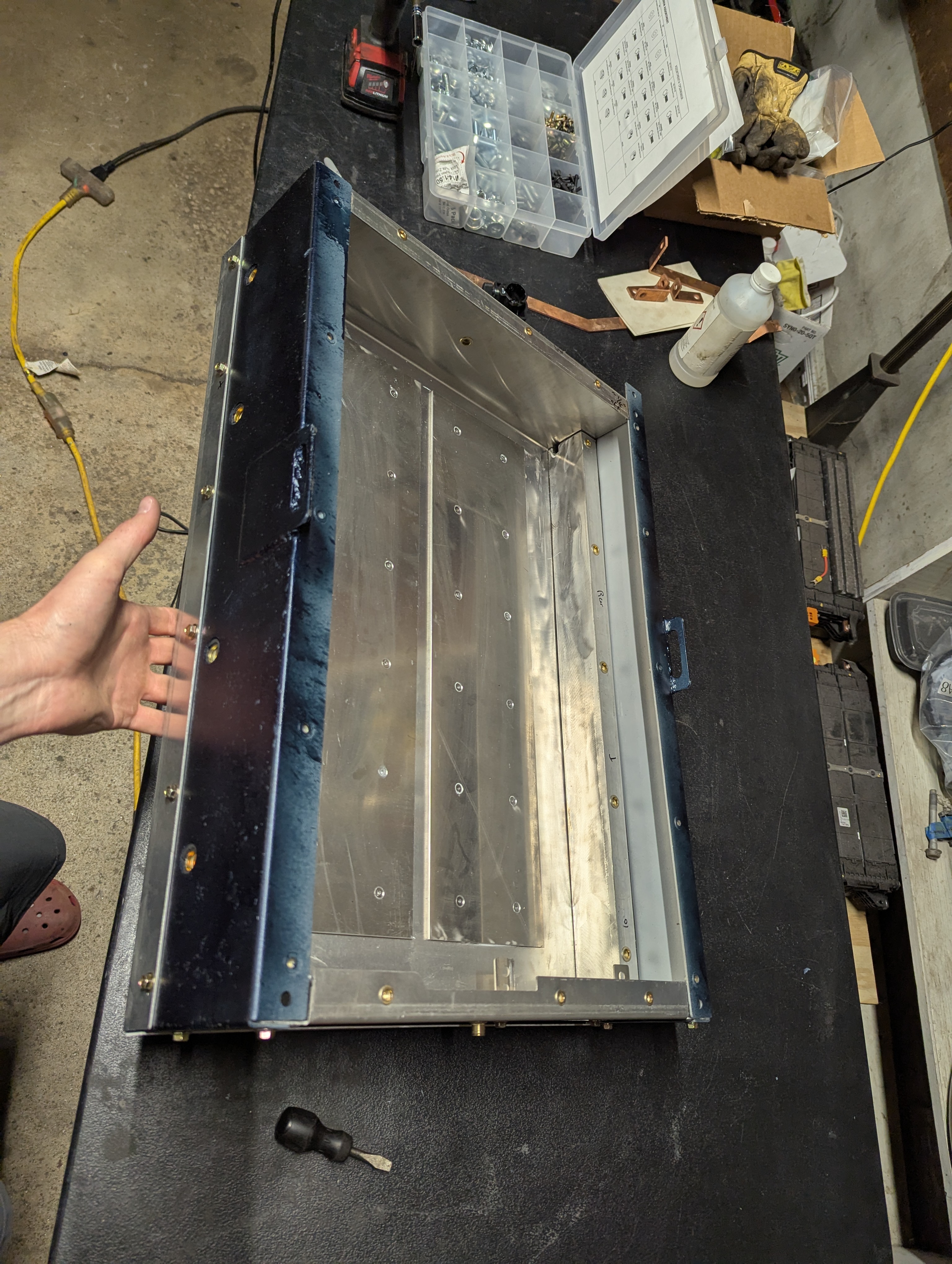

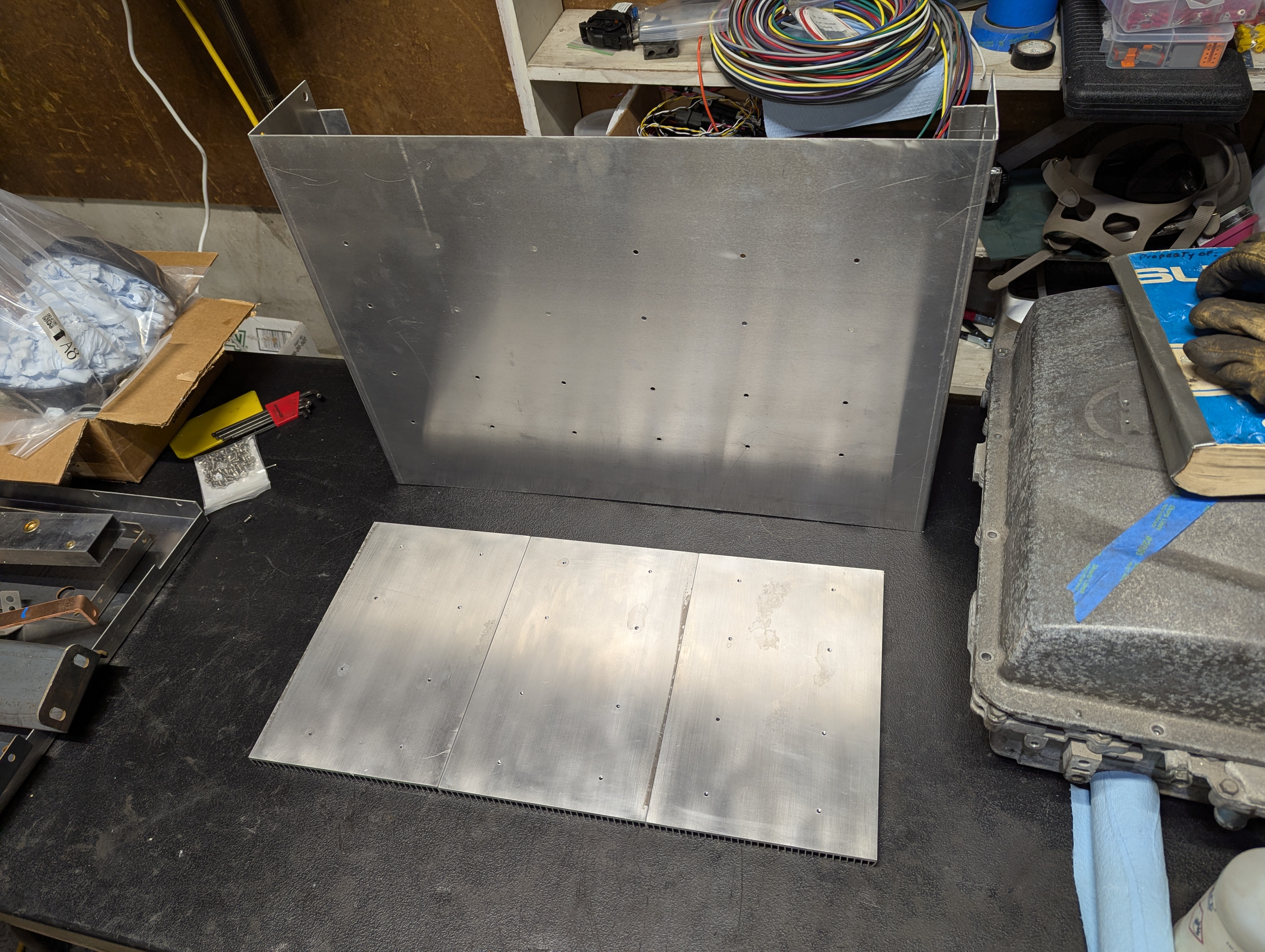

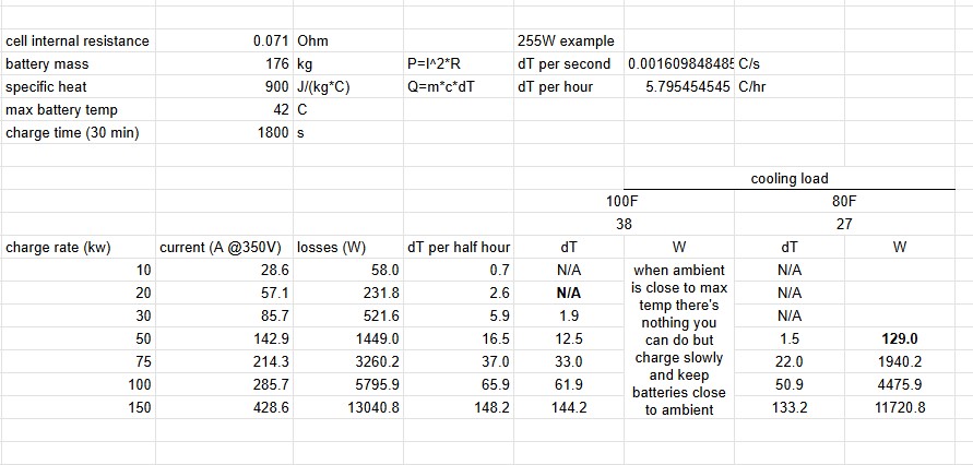

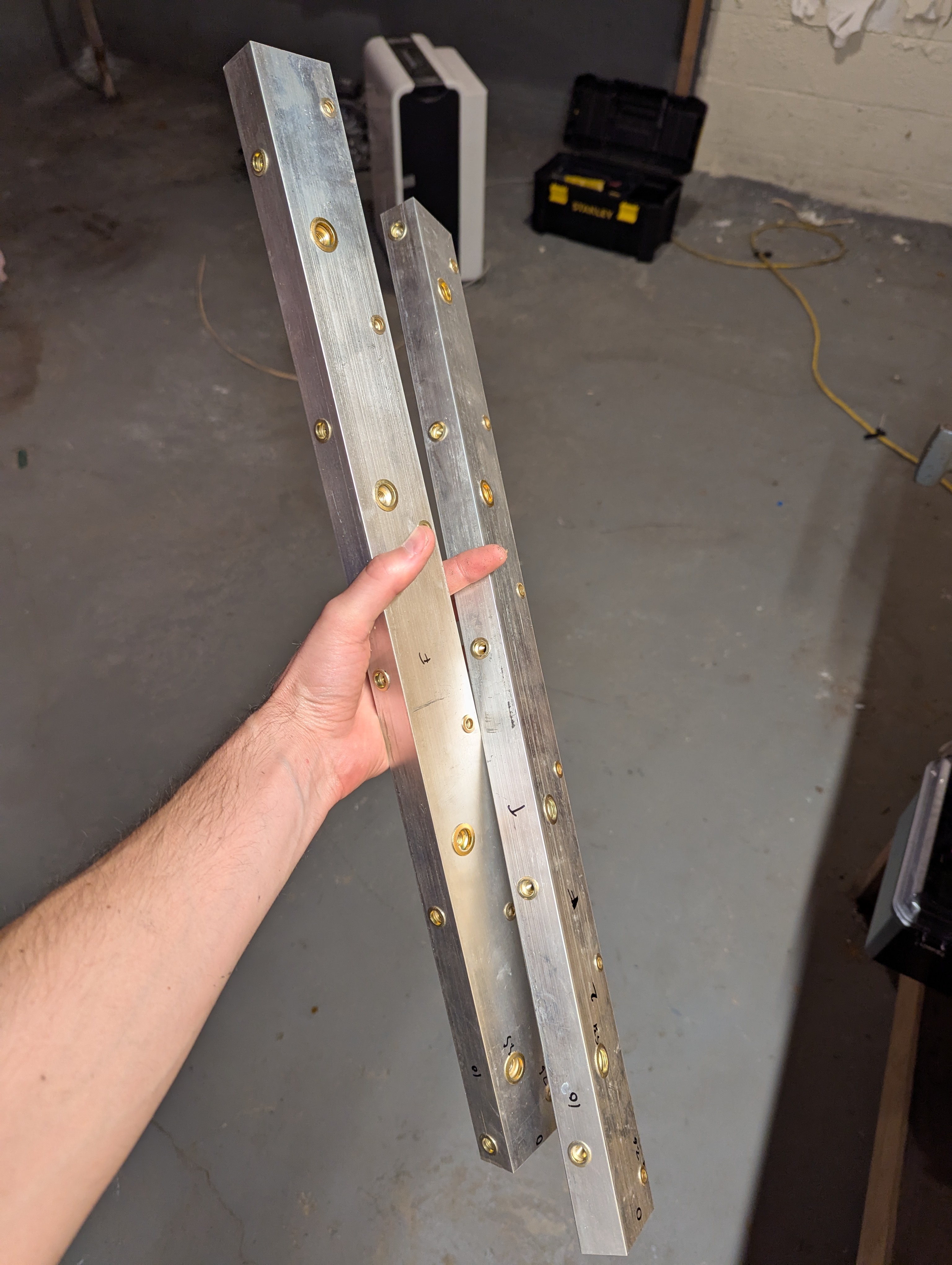

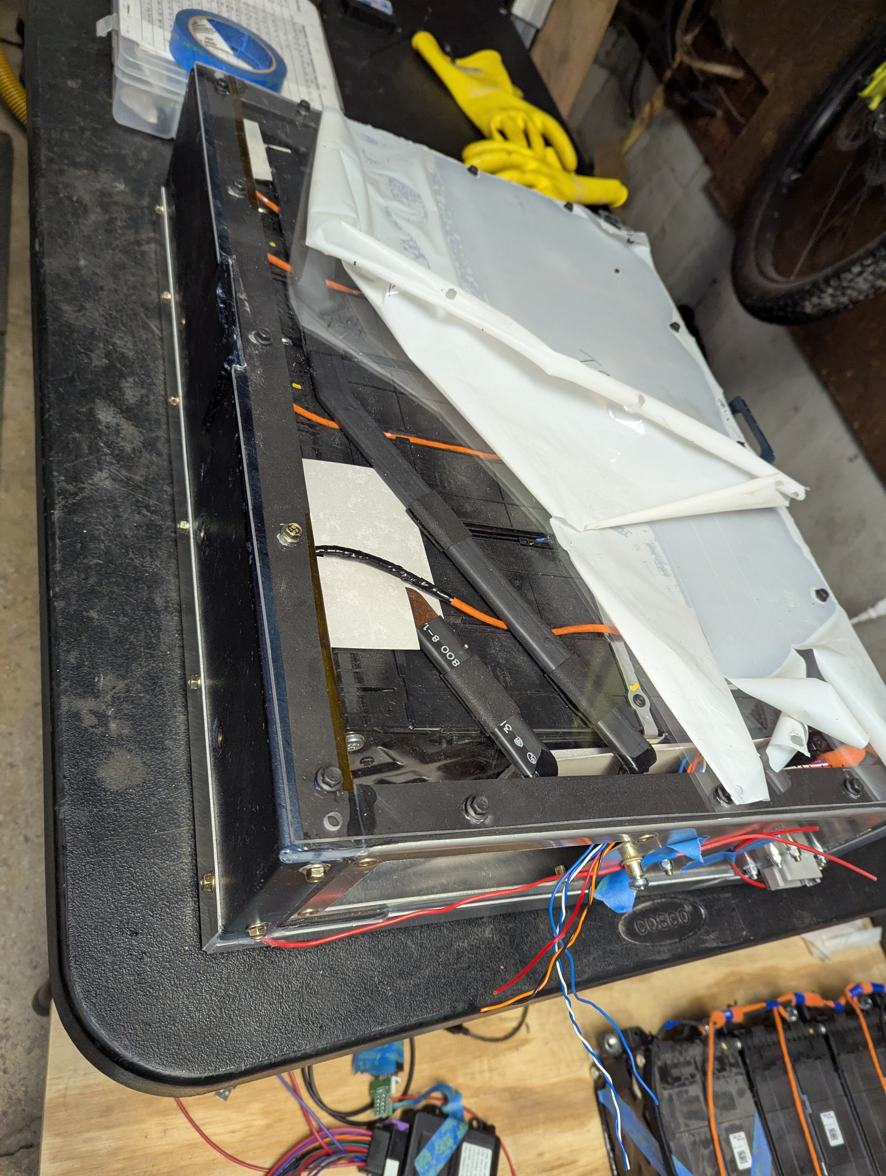

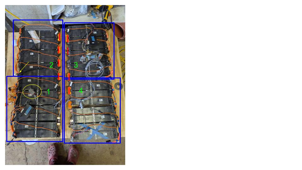

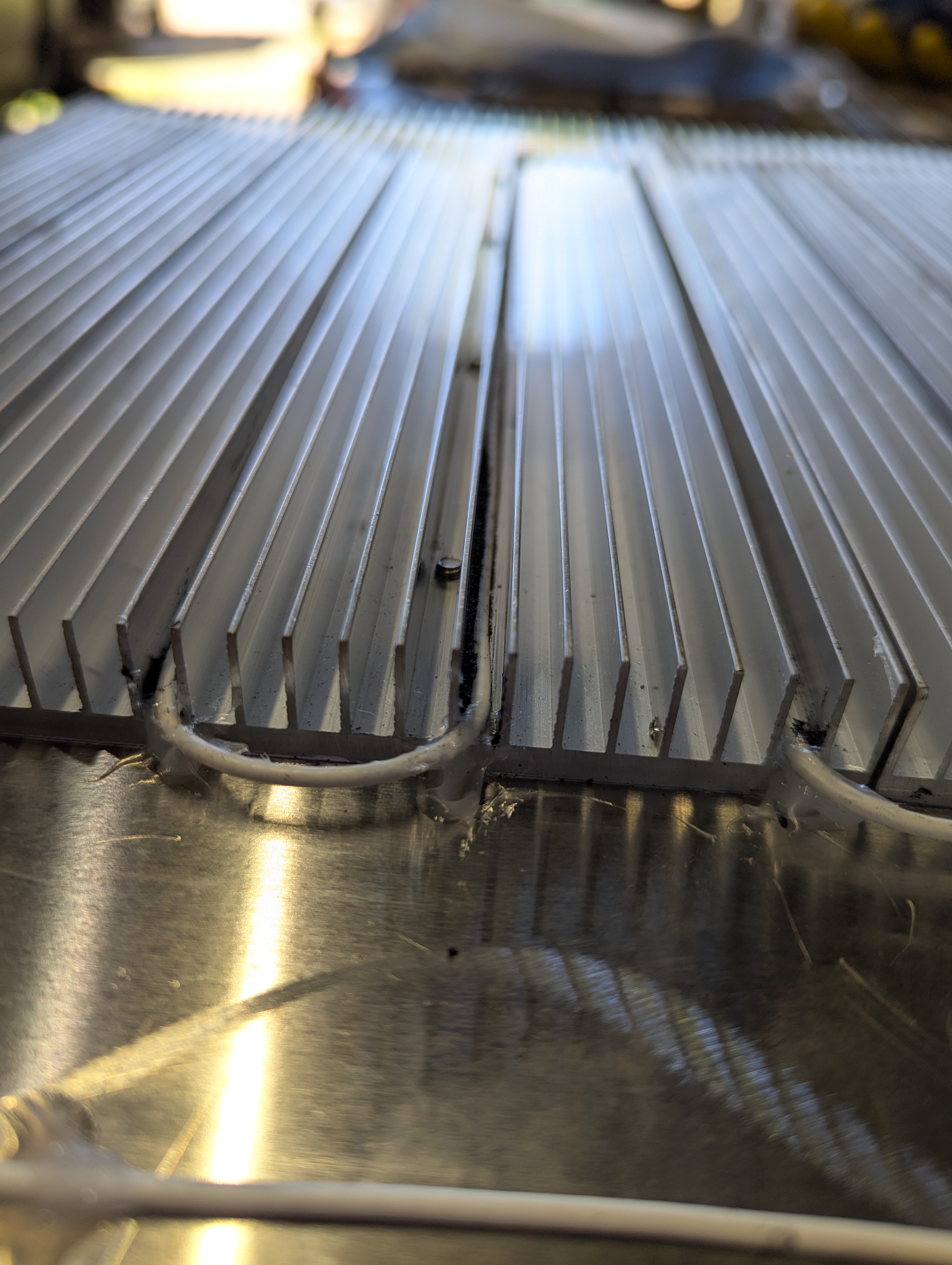

Might ditch liquid cooling! I've always thought air cooling would be better for most EV conversions, and after realizing the cost and complexity of custom liquid cooling I started thinking about switching to air again. Another thread had some very useful data to show thermal behavior of batteries during driving and charging, which increased my confidence too. I pulled a couple muscles in my brain trying to do math, but it seems air cooling will be "good enough" for my project. If anyone wants to check my numbers or see how i did it i'll attempt to write it up below.
i started with the heat generated in the battery pack based on cell resistance as described in another thread on here, and copied their values for resistance since i don't know mine yet. on a 100deg day you can't really cool the pack below it's max temp so you just have to keep the charge rate below 20kW. on an 80F/27C day it looks like a little bit of cooling will allow me to charge at 50kW. That feels like a reasonable set up for me.
next: find a heatsink that fits my pack and see if it can take out 129W from the pack on an 80F day.

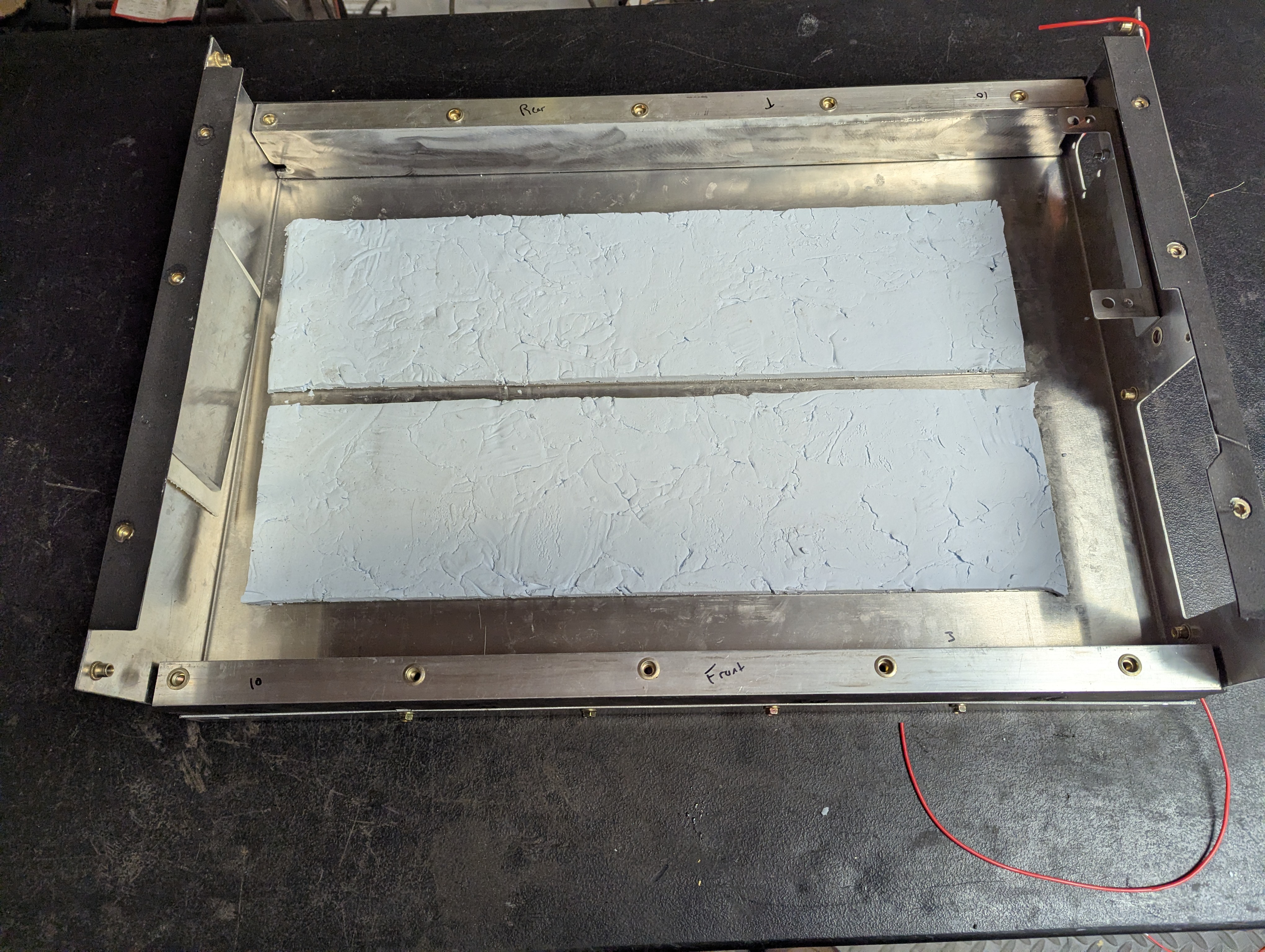

heatsink: https://www.digikey.com/en/products/det ... R0/5848416
3 of these will fit well under a 4-pack of my hyundai modules. i'm trying to keep 4 packs because they fit well under my car and i'll be able to reuse all the BMS slave wiring if i do.
datasheet claims R=.8C/W when ducted at 200LFM so i'm going to see how much heat is transferred to the air at that flowrate on a hot summer day doing 50kW charging.
The equation Q=w*c*dT where Q us heat transfer, w is mass flow rate, and c is specific heat of air is used.
- mass flow rate is found from 200LFM and the open cross sectional area of the heatsink.
- dT is 42C (max battery temp from the other thread) - 27C (hot summer day) = 15C
- gives 450W of heat transfer out of the whole pack. This is not a conservative estimate and I plan to adjust the variables as i find better info for them, but 500W compared to the 129W targeted tells me there is margin for this type of forced air cooling directly on the packs!

website says i need the bellhousing from an EA81 and i'm pretty sure i got one from an EA71. it looks a little different than the one in the picture. Will this bellhousing work? and looks like the NEMA B spacer is not needed for the subaru-leaf mate up?

Far away from it but I have this idea of internal air cooling in my mind for a battery box in the engine bay. Find a space for a radiator and internal fan(s) and have gaps around the modules so the air reaches them from all sides. The rad's connectors can go outside the wall so very little risk of water ingress and cooled nicely by the "big" radiator in front. Might even reverse air flow during charging to blow heat out front to have the pack's wall cooled by ambient air as well.
