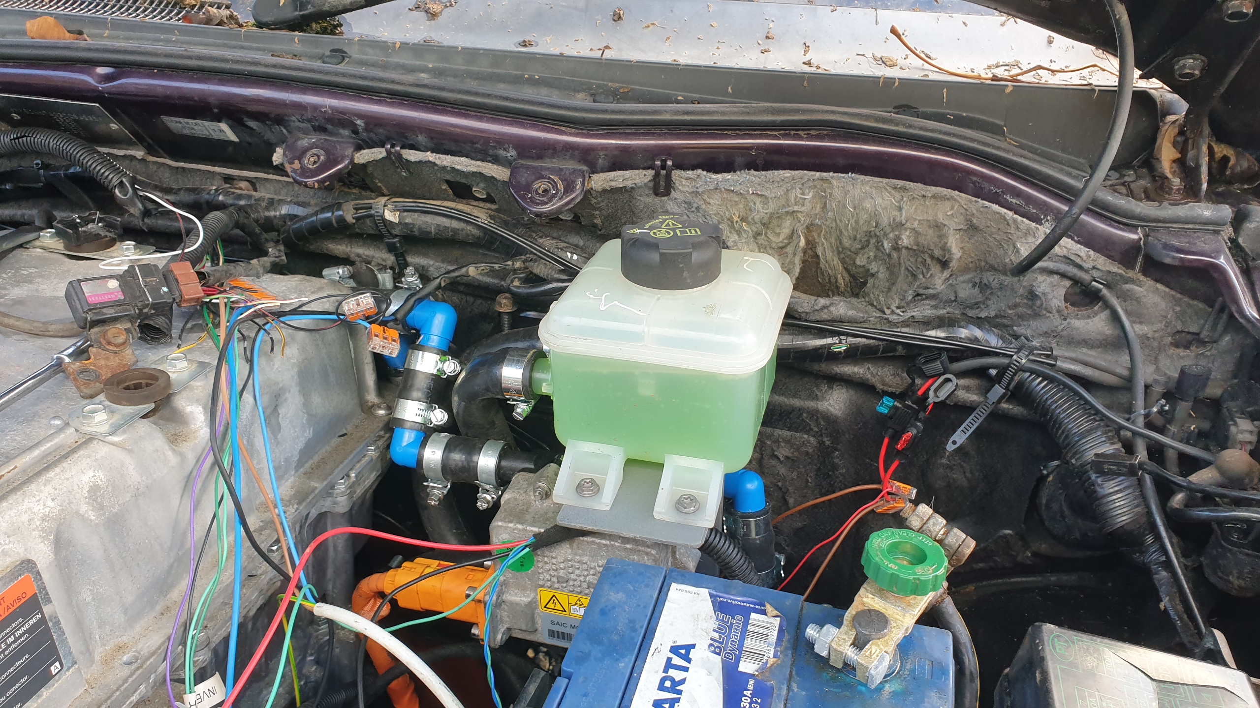

Mine is installed in the L200 now and we have observed around 6kw so far. Simple one can message for control. Must get it into Zombie soon so can prove it out.

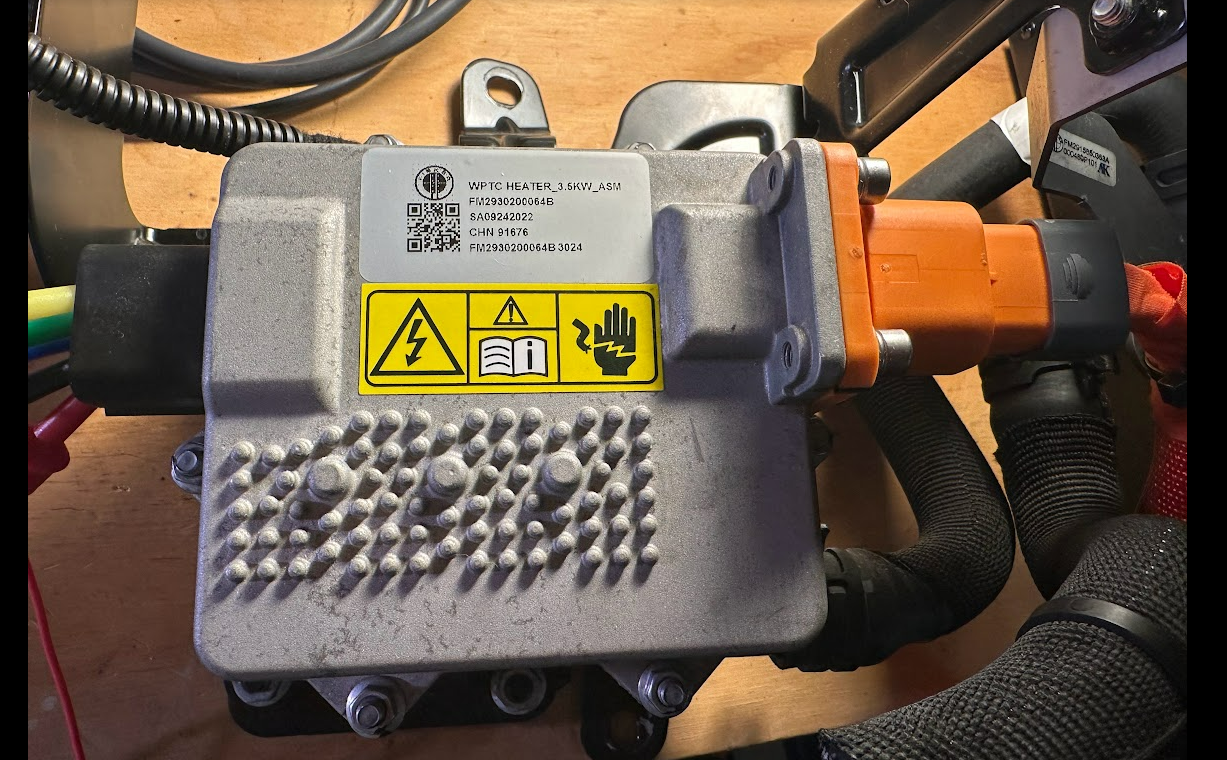

So it seems not all these heaters use the same can IDs. Attached is a canlog from this heater, 0x2A0 is the zombie control message so ignore that one.
LV and HV pinouts seem to be the same however.

The coolant path is symmetrical so it does not really matter which way you flow.
Orientation does matter, mount it so it does not trap air, Fittings to the top.

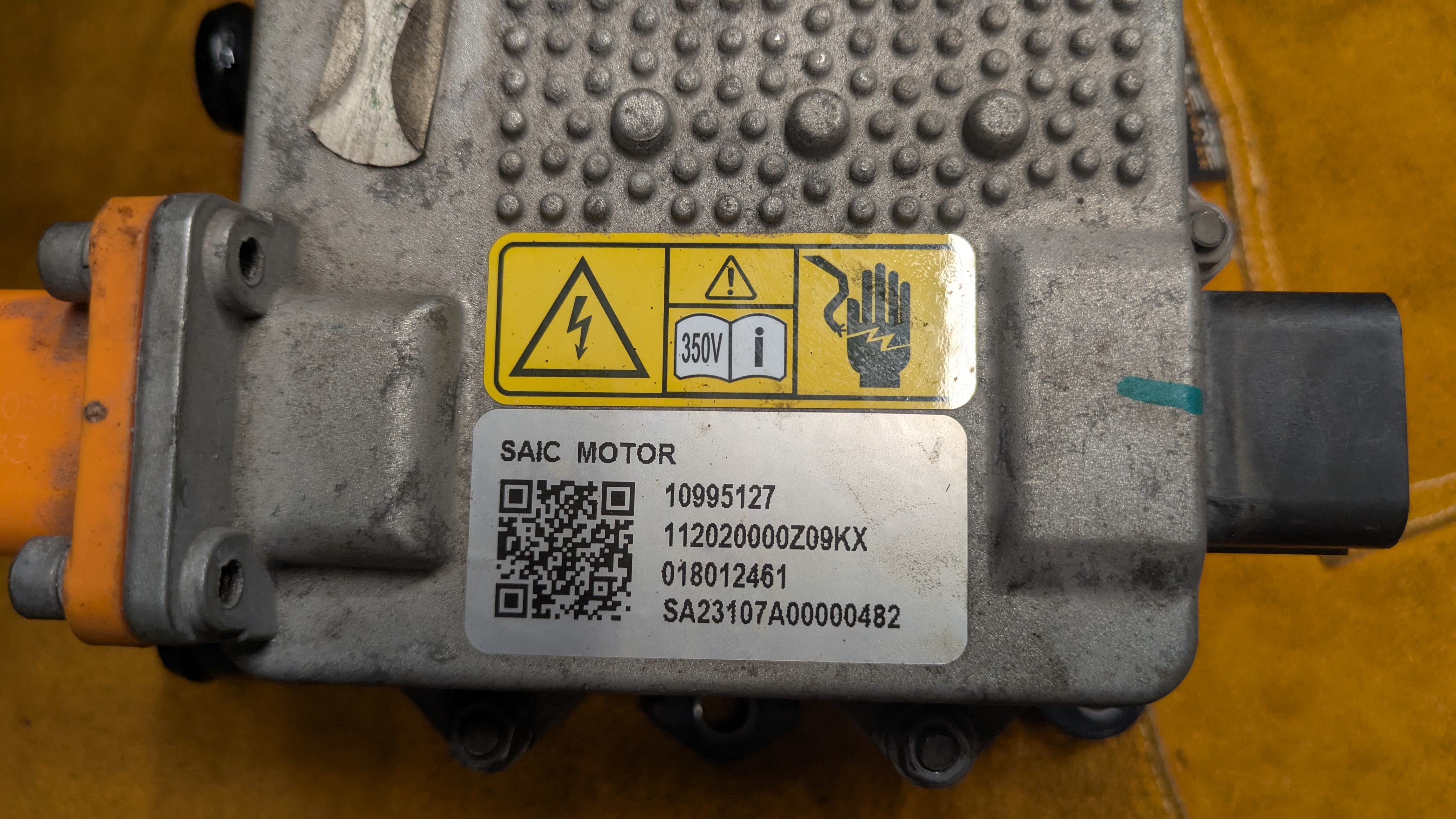

Also got notified some heater will look the same but slightly different part no have different CAN ids.

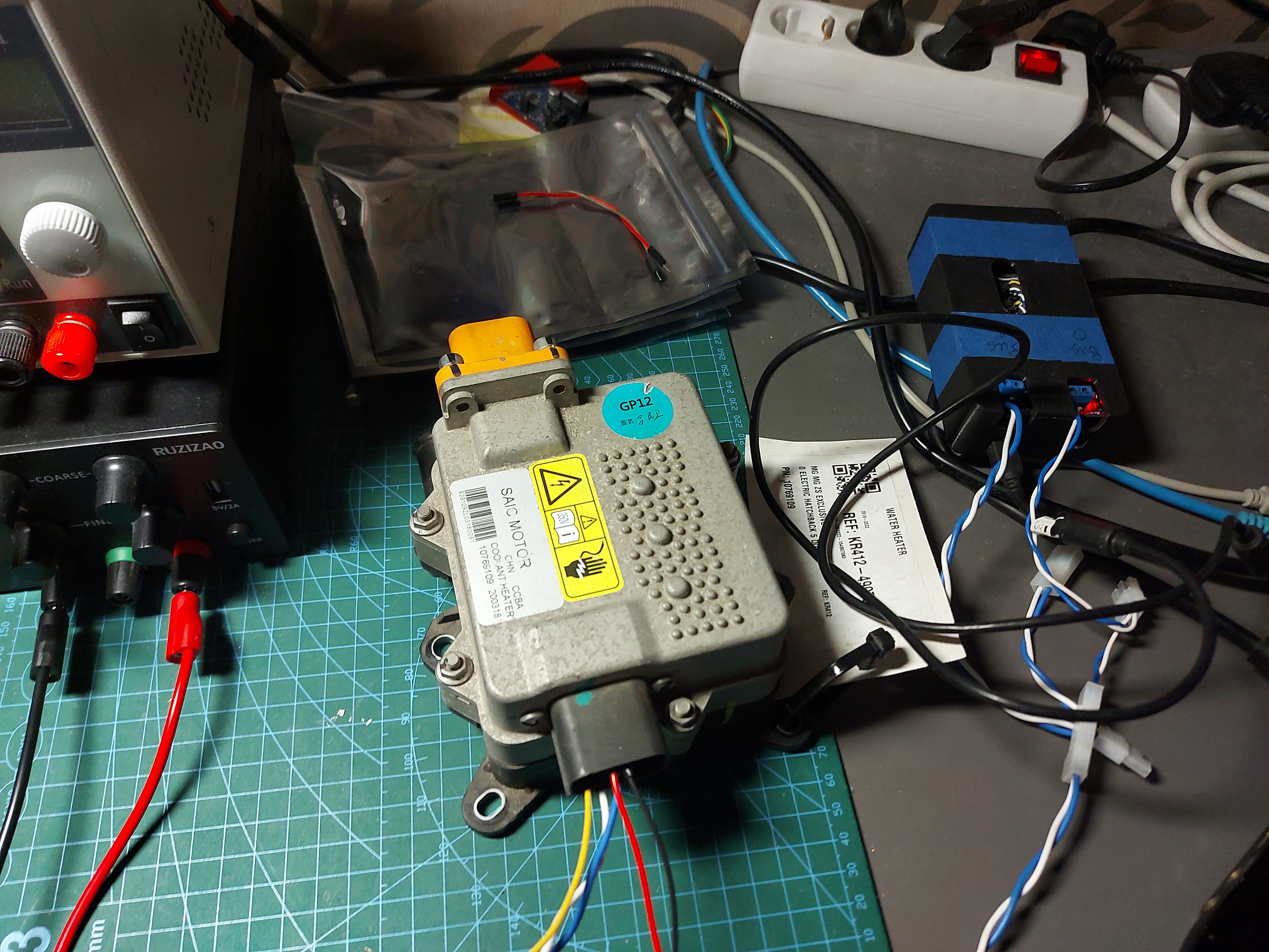

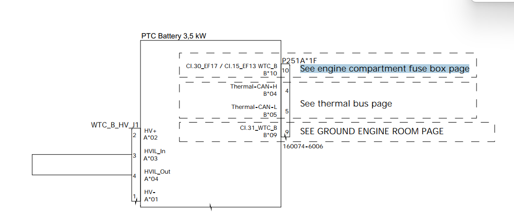

In the US these heaters are found in the infamous Fisker Ocean. I can start a new topic if anybody is interested.
Connectors are the same. The wiring is mainly same. The car schematic I found doesn't show the CC/Ignition KL15 pin. I powered up this heater on my bench and it started sending messages right away. While, CC/Ignition KL15 pin is physically there, it doesn't seem to do anything.
The CAN IDs and message coding is different from MG, but I figured out some basics already. My bench power supply is only capable of 1A@300VDC, so when I send (what I think is) a control message, power supply isn't capable of providing that many amps. Heater tries to fire up and sends some CAN data in response, but then times out on trying. I'll need to find better power source.
This one has cooling IN and OUT clearly marked.
Schematic snip Heater itself: Power supply fails to pull needed amps and heater times out trying...

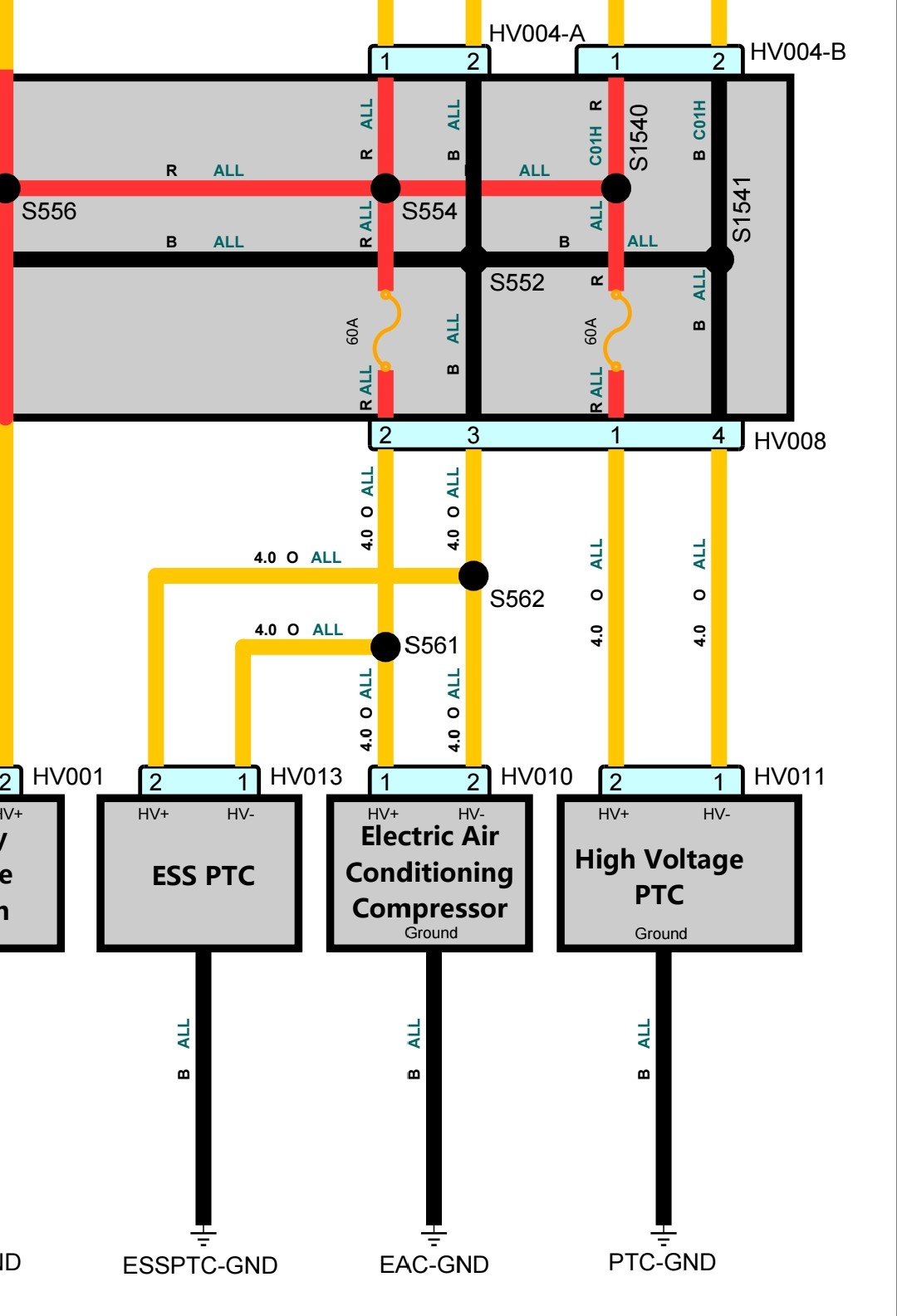

Is the size and characteristic (fast-blow? time delay?) of HV fuse known for this heater?
Max consumption I=P/Vmin=3.5kW/230VDC~15A. Mine came with the 4mm2 HV cable, which can do <25A continuously. The heater is an inductive load though.
- Posts: 2753
- Location: Bristol
- Has thanked: 264 times
- Been thanked: 717 times
Re: MG Coolant Heater

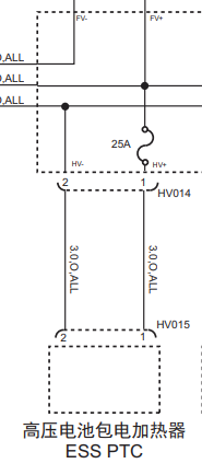

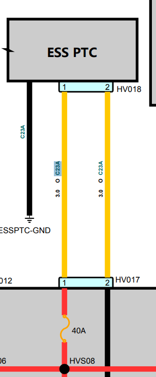

MG ZS MY22 diagram shows 3.0mm2 cables with 40A fuse...
MG ZS MY19 diagram shows 3.0mm2 and a 25A fuse, which is more reasonable.

The MG4 manual has it listed as a 60A fuse.
Think that the heater is a resistive load. Not that this really matters
The fuse is not for overload protection. But just for short circuit protection.
The most important characteristic of the fuse is HRC (High Rupturing Capacity) so that it doesn't explode if a short occurs.
