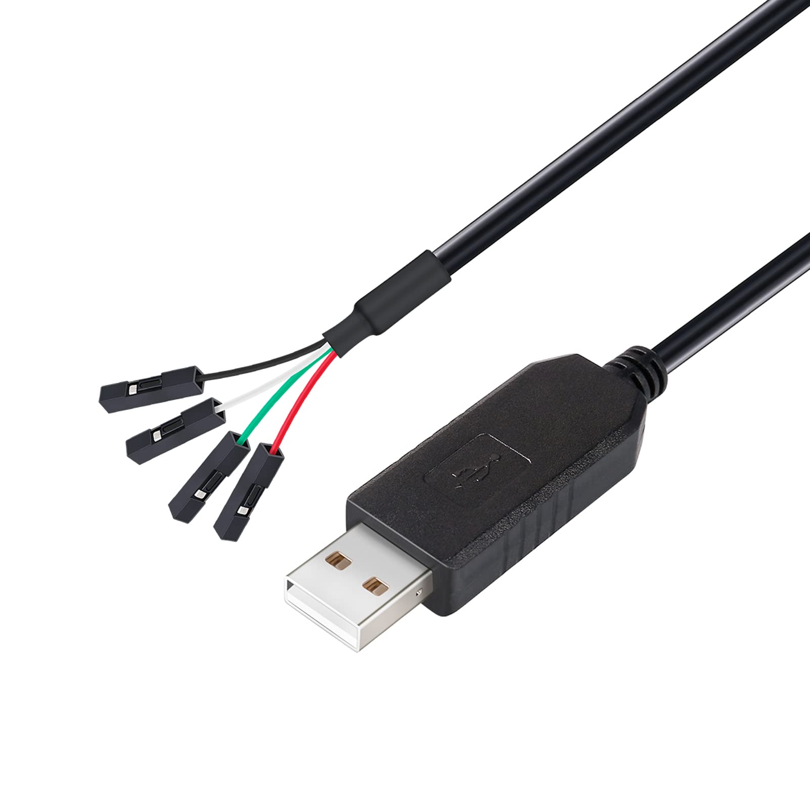

Have you got one of these?
Connect the black cable to GND, green and white to rx and tx (of course I don't know which way around).
Then open a terminal program on your computer with a speed of 115200 baud and at the prompt type
json
and enter.
What do you see?

I have a serial adapter cable on the way, but when I plug in the board over micro B and read from the serial port over 115200 it results in this.
