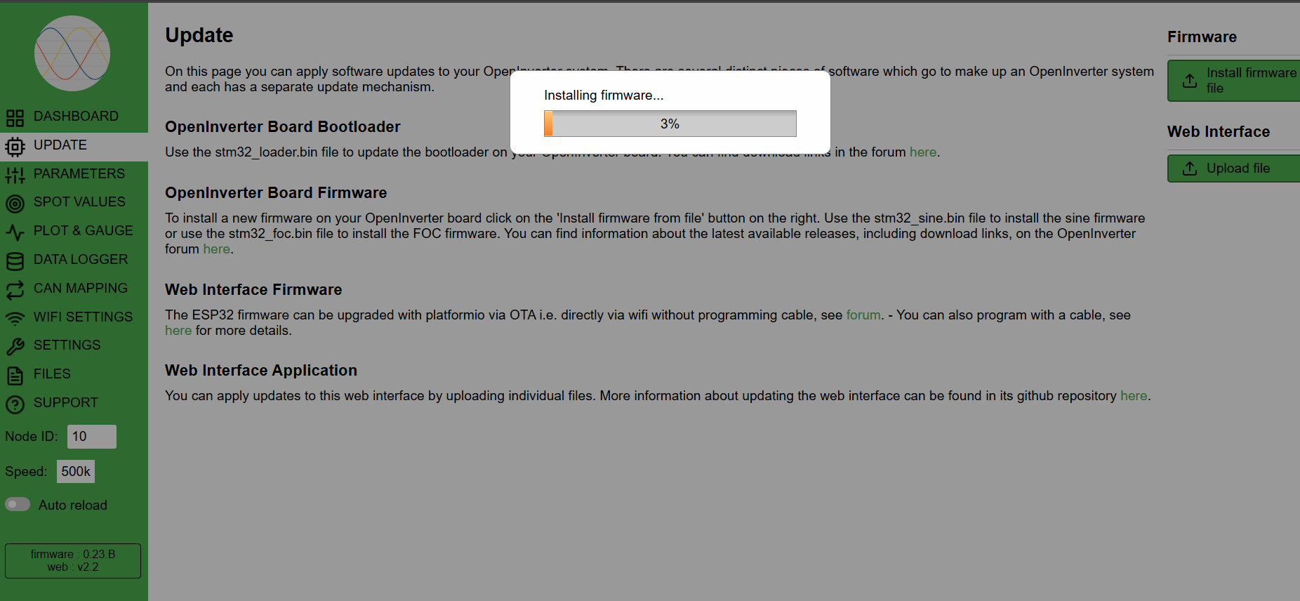

I have two v2.2 boards running firmware v0.23B.
I’m attempting to update both to the latest firmware, but the upload process consistently fails at around 3% (see attached image).
I’ve retried the update multiple times on 2 boards with the same result
Could you please advise what might be causing this or suggest troubleshooting steps?
Thank you!

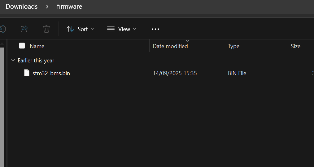

Delete any .json files from the files section
maiks
Posts: 96
Joined: Thu May 11, 2023 9:20 am
Has thanked: 7 times
Re: Flying ADC 16 channel BMS 96S test
Post by maiks »
Jacobsmess wrote: Tue Nov 11, 2025 1:16 pm Delete any .json files from the files section
l have only one file in the location and thats .bin file

Been thanked: 1913 times
Are you running 500k CAN Baudrate?
maiks
Posts: 96
Post by maiks »
johu wrote: Wed Nov 12, 2025 3:25 am Are you running 500k CAN Baudrate?
I’m running it on a 500k baud rate.
I applied 12V to the BMS ENA_IN pin for about 4 seconds, and the board powered on (LEDs started lighting).
Next, I set the node ID to 10, and it successfully displayed the current BMS firmware version.
When I proceeded to update the firmware, I clicked Install, selected the firmware file from my PC, and confirmed. The installation began, but after reaching 3%, the BMS powered off (lights went out), and the update process froze at 3%
ok, try keeping ena_in powered during update.
maiks
Posts: 96
Post by maiks »
johu wrote: Wed Nov 12, 2025 4:45 am ok, try keeping ena_in powered during update.
Yes, it worked — thank you so much. However, one of the boards tried to update and then stopped midway. The indicator lights went off permanently. I’ve tried power cycling it, but it still won’t light up. I’ve checked all the wiring, and everything seems intact. What could be the problem?
just connect it to the CAN bus alone without the other module. Of course there will be no parameters. Just start the update anyway and it should go through
