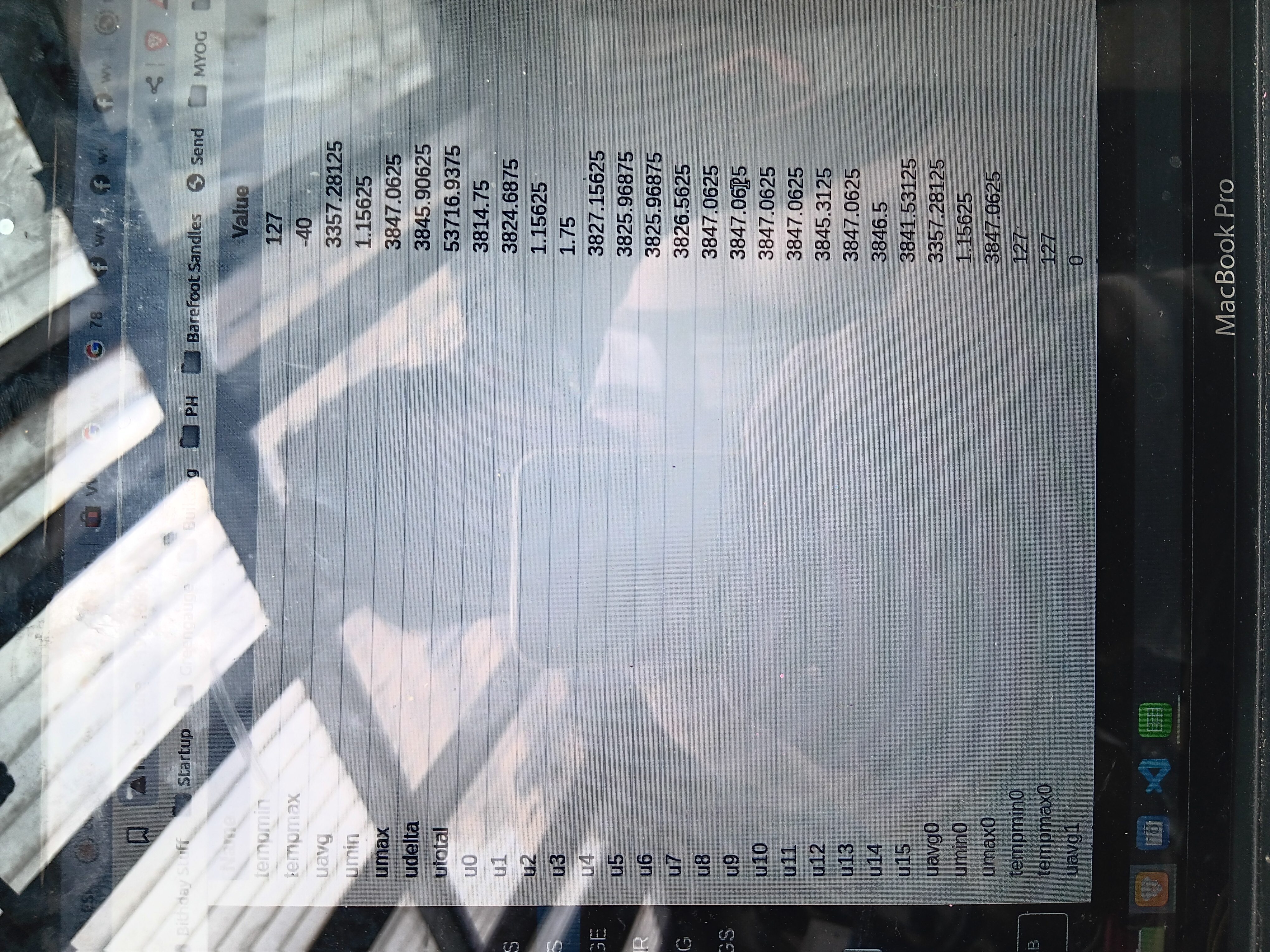

So, I've found a bit of time to try and get these board running again.
I've got 7 boards that run following fixing D1 (diode) and U11 (voltage regulator).
Of the 7, 4 are giving faulty voltage readings.
(BMS1, BMS2, BMS4 and BMS7). So far I've not run them in series, so I'm just testing with a bank of 16 cells at a time until I can get them reading correctly.
I've gone through all the components on the left of the board (cell tap inputs) and measured each resistor and FET. All but one board appear to be fine (FET readings around 0.6V for most bar Q1 and Q5 which read around 0.7V).
I've checked the boards with a thermal imaging camera and cannot see any particular components that appear too hot, checking the 17pin plug confirms the wiring it correct (3.8Vbetween each pin).
I'm at a bit of a loss as to what next to check and how to check it.
Any guidance or tips of what to check would be great.
Hardware version is V2.1 and I'm running the latest firmware....
Help me O-I Community, you're my only hope ;)

what readings do you get?
what is lasterr?
Best post 192.168.4.1/cmd?cmd=json

johu wrote: Tue Sep 23, 2025 1:46 pm what readings do you get?
what is lasterr?
Thanks, I'll try post the jsons tomorrow.
Voltage readings anywhere from -1V to 4V. It seems as though the difference between the 1st incorrect voltage and the 2nd is 3.8V but im not entirely sure. I'll check tomorrow.
Last error has shows Cell_Polarity on some, nothing on others, when I chance the number of cells down to 8 and then increase back to 16 (with saving params and power cycling) this clears. I'm not entirely sure this is related however.

Re: Fying ADC BMS incorrect voltage readings
Interesting! With this method you could find the faulty channel.
That said, errinfo should also show the channel where supposed reverse polarity is detected
Post by Jacobsmess »
So this is an example of one BMS with 2 broken channels (U2 and U3). The incorrect values jump around quite a lot.
From -0.5625v to 1.75v

errinfo is 0, lasterr is none
output from http://192.168.4.1/cmd?cmd=json

Are you absolutely sure u2 and u3 voltages make it to the board?
Jacobsmess wrote: Sun Sep 28, 2025 3:53 pm Oh, thanks for editing my post to make the code legible (whomever it was). I didnt realise it could be entered as such!
Used the next best online json formatter, then wrapped it in 'code' tags 8-)

Thanks, I'll double check but it did appear so. I checked the voltages between one connector terminal and the first resistor.

So I psyched myself up to try and identify the issue again this evening, given the rain....
I jumped directly from the connector pin for U2 and U3 to the resistor for the relevant channel but it made no difference to the voltage readings on the webUI....
Any other suggestions on how to test this?

So I had some more time on this. Looking at BMS7 I get erroneous values for U10 and U11 (-1.15625mV and 1.15625mV respectively).
Firstly I took a BMS giving good results (BMS3) set testchan to 1 and took readings across every fet terminal from V0-V16.
I then swapped the board for the above BMS7 and repeated the measurements checking again BMS3. Somewhat unfortunately they resulted in the same values (give or take 0.01V which was likely due to my cack handed measuring rather than anything else).
I was hoping to find a smoking gun but no dice.
Any other suggestions on what to check?
