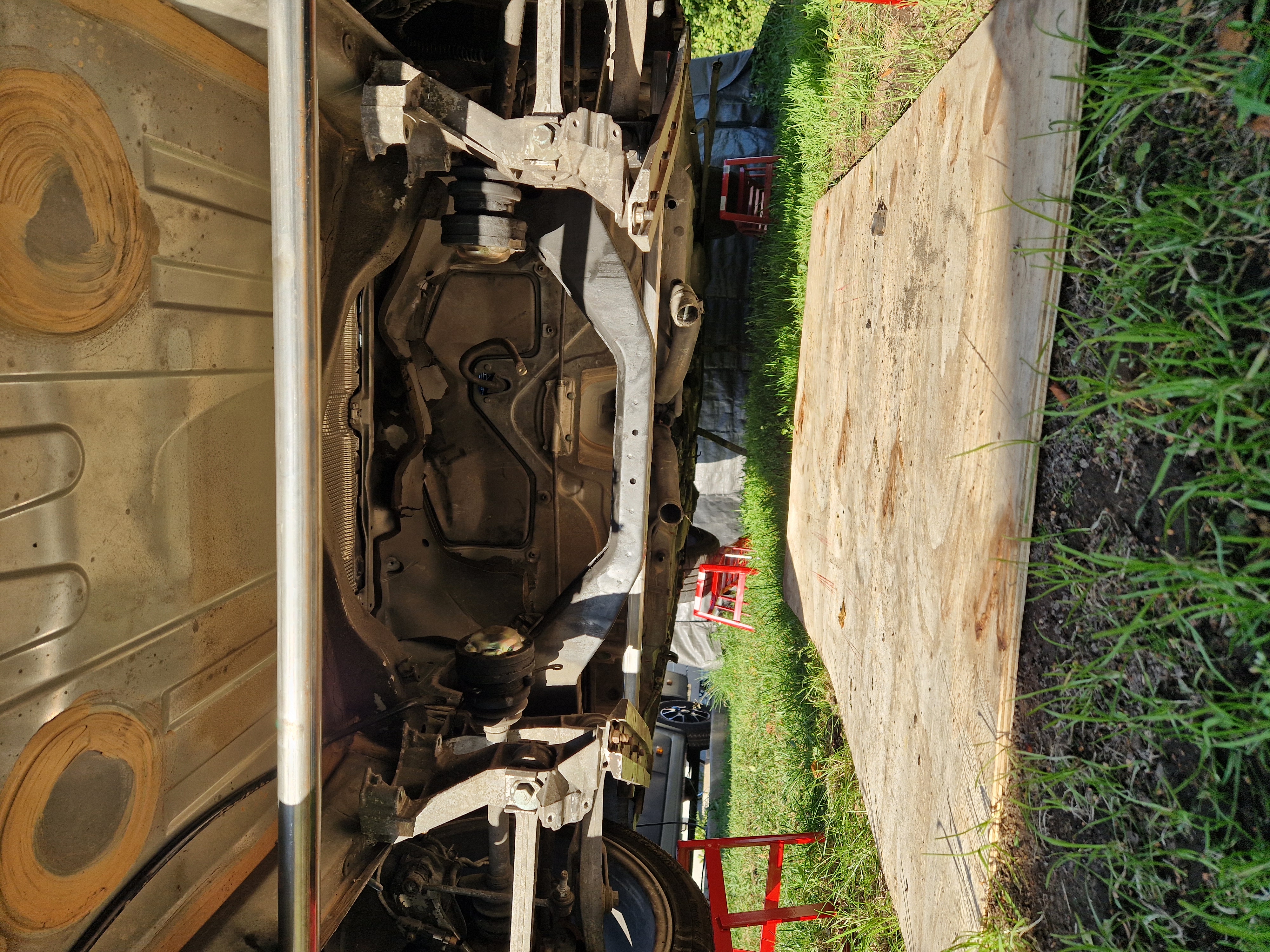

So Boxsters have been converted to electric by many people by now and most of them has gone with Tesla motor. I have chosen to go with a complete 160kW Leaf stack. Sure it does not have the power of a Tesla but it's still more than my car had with ice. Haven't got the battery yet but aiming for a 40kWh.
Have some more parts to remove before I mount the motor and all the other stuff

Trying to decide how I can mount the motor

Making the drivetrain electric shouldn't be that much trouble (at least I think so..) but the other bit, make a heater work and sending can bus signals to the car so all warning lights and things like that don't remains on is a bit harder. So if anyone have a nice solution or can point me in the right direction, I would be most thankful. I guess a Teensy or Ardinou can do It. I want a water heater (Preferably vag as they are easy to source here) so I can keep all the HV stuff in the back. The temperature can be set by a potentiometer if it makes it easier. The car was bought with engine and gearbox already removed so no possibilty to take can logs.

Swapped the Leaf gear for a Tesla Sdu. Got my hands on the last oi-board from Johannes. Will probaly go for a zombieverter also. Soon it's time to heat up my soldering iron
