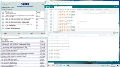

Little update. Scrolling through values, I noticed Charge Mode = No request & Operating Status = Standby
I have not been able to spoof signals for these values . Could they be internal calculations based on the data received?

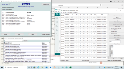

Another day, another hole on the wall..Some more spoofing, this time adding ID data from the 6A_charge_log.
Still have the LED light staying RED & no charge activation.
Feel free to dissect and comment on the new .ino file
VAG_phev_1_initial_charge_10_sec_with_addit_messages.ino
(33.7 KiB) Downloaded 89 times

Edit 3: Fascinating! I was trying to sniff the behaviour of the CAN-bus between the Caddy and the Mongoose and somehow it's able to tell that there is a DB-9 adapter in between! If it isn't directly connected to the car, it will send three messages to 0x700 and then complain, otherwise it will send only one. Adding 12V on the appropriate pin didn't seem to help. I'm going to try and sniff the J2534 data, maybe this can tell me what's going on
Edit 4: Alright, I think I got it now. I messed up by connecting 12V between chassis ground and 12V, the Mongoose measures in reference to signal ground. I can now get a list of Control units. So, for reference, ODIS error ODS8001E can mean that no battery voltage was detected. I found out about it by comparing the output of this j2534-shim/logger between a working connection with the Caddy and a non-working connection.
Edit 5: ODIS can connect to the OBC now and is incredibly helpful. Some noteworthy things:
  • VW37X does indeed seem to be the right project
  • Coding out charge lock and flap seems to have worked
  • 1068 Ohms on the thermistor wires didn't give values in range. I found 943 Ohms (measured out of circuit) to result in around 35°C. 22 Ohms less would be around -14°C.
  • I will have to confirm the pinout of the connector tomorrow. ODIS reports electrical DTCs on the Charge lock, the charge socket itself and the third LED.
Edit 6: Confirmed: Blue LED is on pin 6, not on pin 22 for 682BG. Other electrical DTCs remain. Blue LED will start blinking when EVSE gets connected.
Edit 7: I'm stuck again. Coding out the charge lock didn't seem to have any effect. I've been trying all day to get the charge lock working first with a simple 74X-based circuit, now with an Arduino. It does seem to register the resistors and the relay I use to short the 10k resistor that's in series with a 1k resistor, because the initial values after powering the OBC down and up again (locked and unlocked) differ. Weirdly, it seems that only the locking pin ever gets pulled high. The unlocking pin (Pin 17) never sees any voltage. Can anyone confirm that this is expected behaviour? Or did I maybe fry pin 17 in my experiments?
