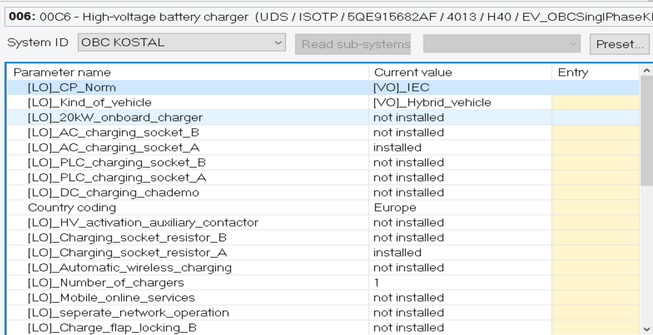

Re: VW GTE 3.6Kw charger 5QE 915 682 AF

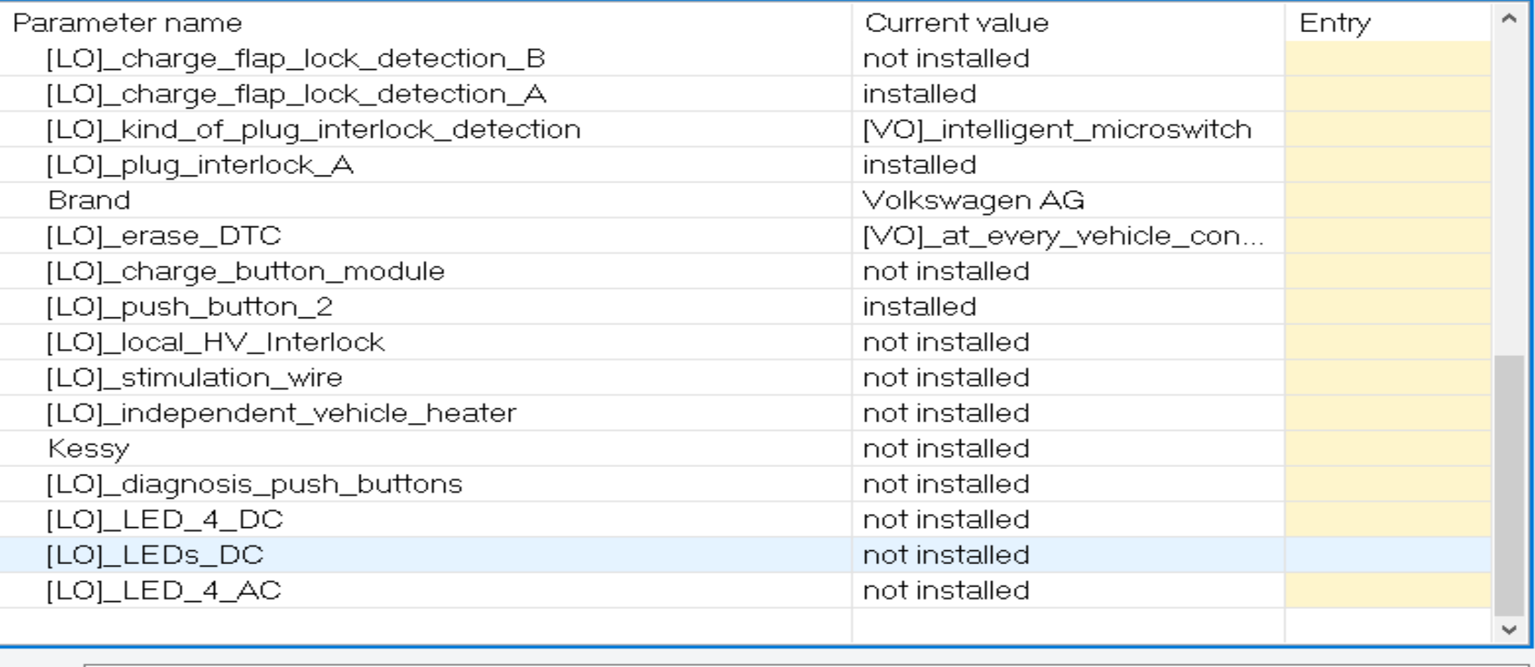

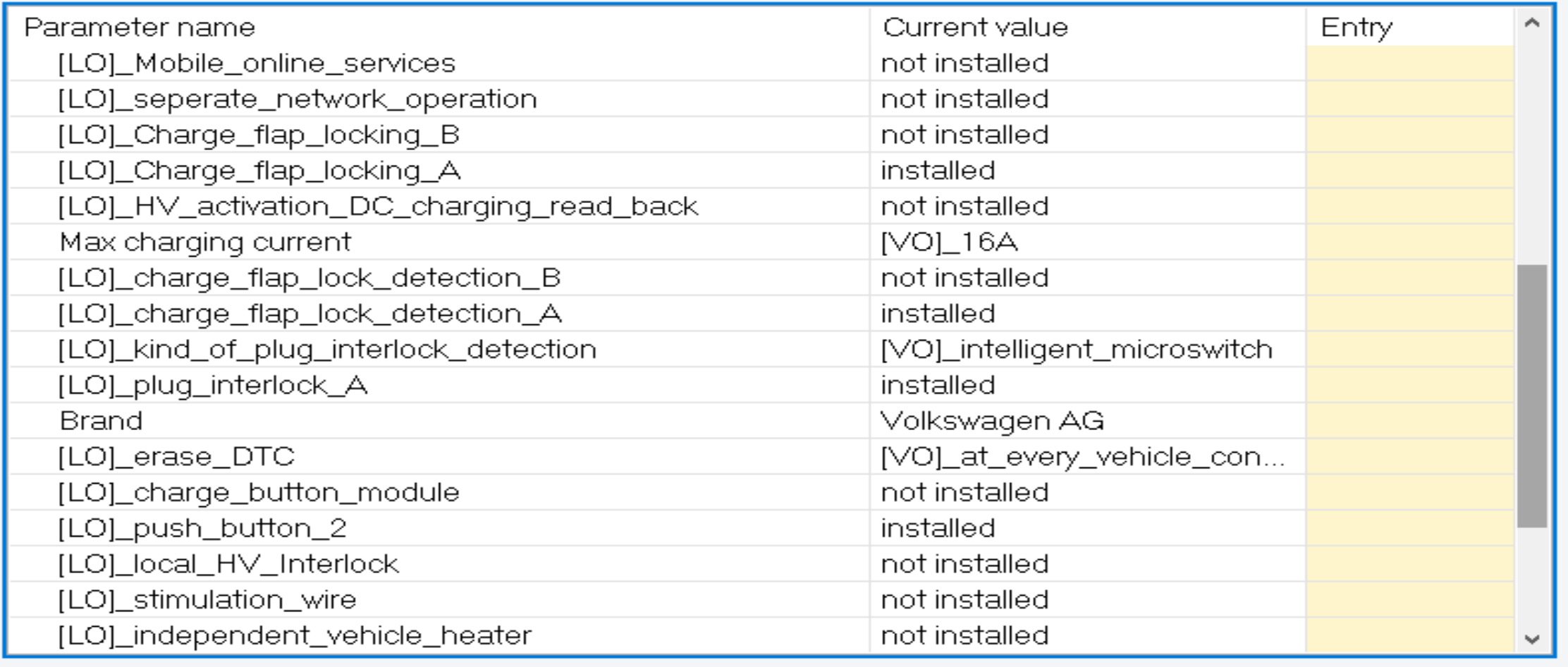

You will also need to spoof the lock feedback signal. I coded it out with ODIS, but it was still expecting it and causing a fault.
Can you take a snip of the coding values in ODIS (The list of available options?)
Do you have the charge plug wired to the charger similarly to a golf GTE wiring diagram? Just trying to determine if you're using it in a 'stock' type arrangement, as mentioned the lock feedback and plug temp sensors are likely needed.
You may also need a few LED lights for the status indications, as well as a momentary switch for the charger port button.
I'd use ODIS and see what you get for the plug resistances for the locking and temp sensors.
Confirm they're coming in on the A channel and not the B channel.
In some wiring diagrams it seems they use the B as the primary channel.
I'd also confirm that they need to be connected to the 12V rail, been a while but I seem to recall that the resistances are all based off of a ground connection.

Seems my previous message did not get sent. My resistances are all internal and connected directly between OBC & Locking actuator.
The resistace values add up to Damiens initial testing values.
I think the OBC is in fault mode & just locks the actuator - because when I connect up my Arduino with Damiens code, the actuator locks & unlocks a few times. To me that indicates that the messages are getting received by the OBC.
Un-coding the lock, causes the charge sequence communication between OBC & Type2 charger to not function, so I coded the lock back.
What sequence are you using when activating the charger?
I plug in my Type 2 charger, wait for the charger to detect AC voltage, & start the code "a" as per the instructions.
It just sits there laughing at me....

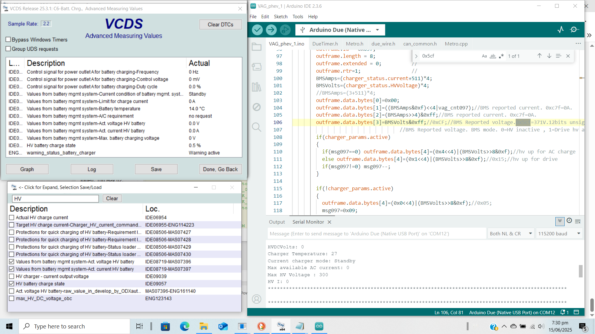

Carrying on with this project, I am now trying to spoof additional messages.
What I did notice, is that when I have the Arduino code running & Charger not yet activated
Frequency, Control voltage & Duty cycle are activated.
Current cond - StandBy = normal as I have not yet activated the Charge process.
Limit, Battery temp (spoofed by Damiens code) & A/C requirements seem normal.
The next 2 are where I am not sure how this works...
Voltage HV battery - The code is supposed to take AC supply Voltage, which it reads correctly, and duplicate it for simulating HV battery voltage. This stays at 0V
Current HV Battery - this remains at 0A, but I do not have a charge process activated.
Spoofing CAN ID 097 for battery voltage, it seems the values do not stay constant, so I am assuming there is a checksum thingy going on.
From what I understand, If Battery voltage is not detected, the Activate Charge will not function.
Does this make sense?

Re: VW GTE 3.6Kw charger 5QE 915 682 AF reverse engineer
I have spoofed SOC, but that has not advanced the charge process.
I have also found the 'Itermediate charger voltage value' which I hope to spoof to get the charger to see Battery Voltage.
I'm now comparing e-tron sketch, gte log & phev.ino code to find additional values using vcds.
Will keep updating here.

So I managed to spoof BMS voltage using incomming AC Voltage on ID 0x097. STill not enough to get charger happy to charge.
Will continue digging and adding more values over the weekend.

Spent the day spoofing the charger. I did so much, I had to go backwards, as I created heaps of faults - quite a few due to Checksum errors.
Good news is I got the charger to work ONCE. I thought I was creating a short circuit, so stopped the charge. Now can't reproduce the process.
Back to drawing board tomorrow, but there is light at end of tunnel....I think

Is your charger coded for a EV or Hybrid? If it's coded as a hybrid, may be worthwhile trying to code it as an EV (or vice versa)

I'll swap my charger version from Hybrid to Electric & see what that does too! Thanks again for the reply and vital info.
