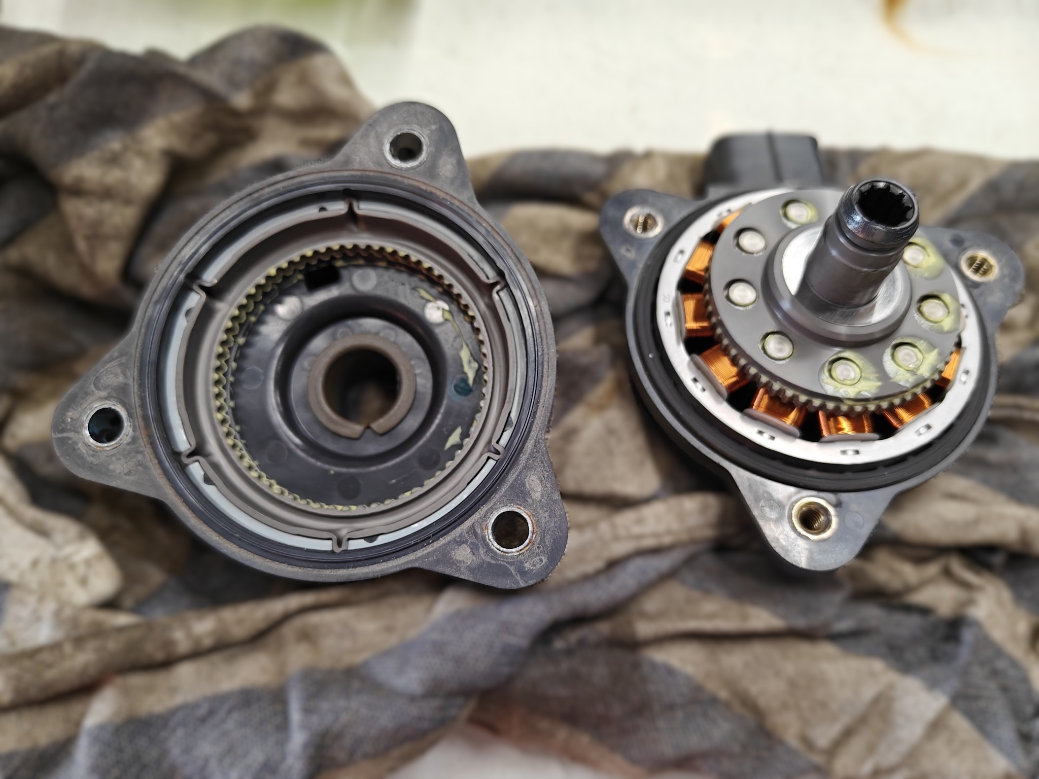

In case someone wonders what this is made of, I happened to open one "accidentally"
If you remove the srcews which hold the actuator on the sheetmetal part, the motor splits.

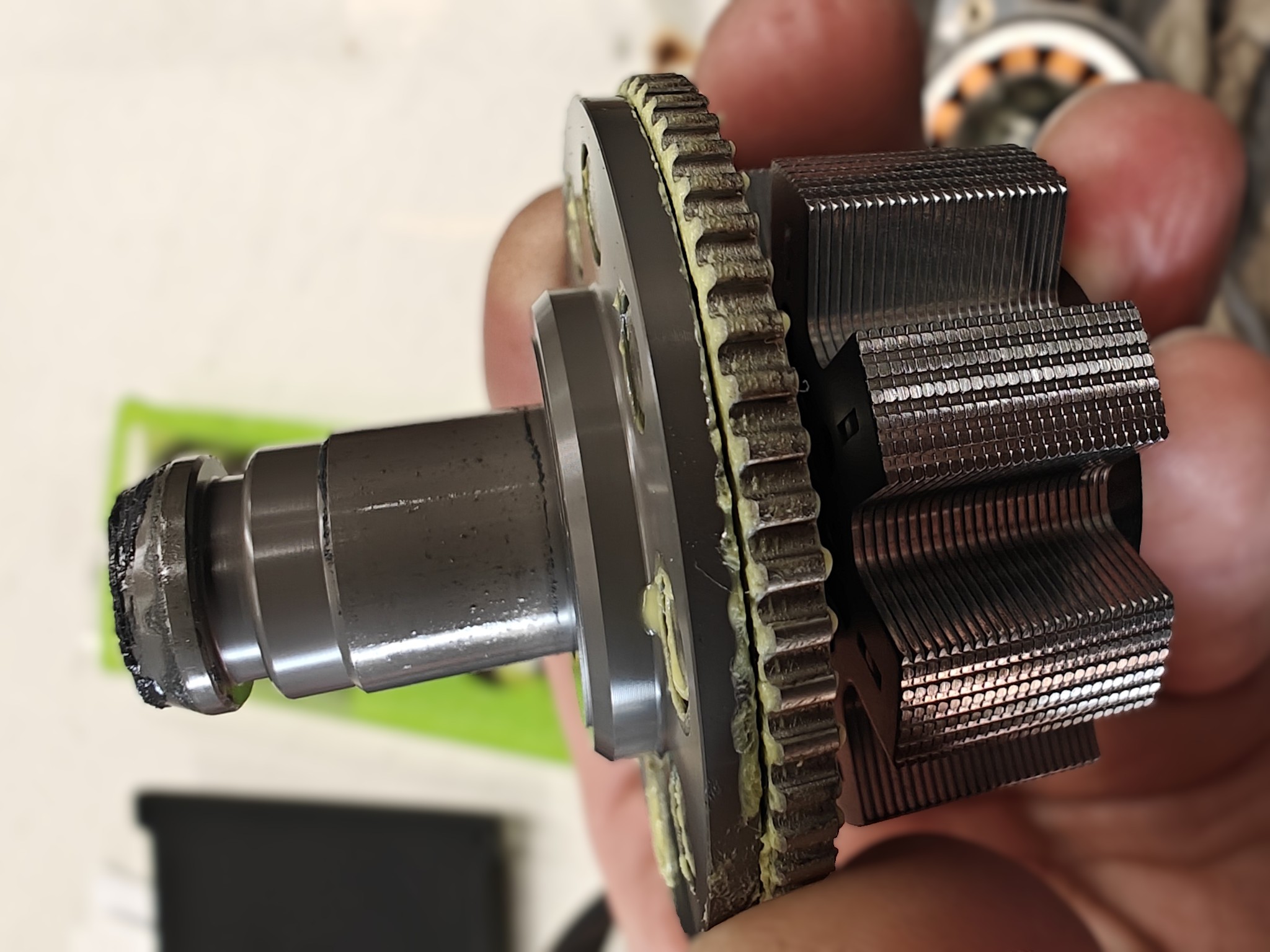

This is SO COOL!!!
There is a Cycloid gear drive in this :D

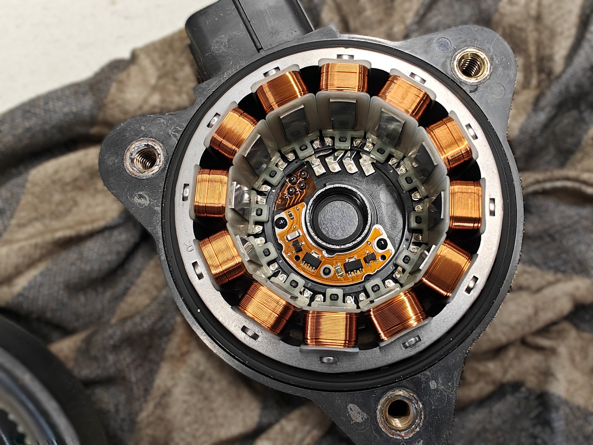

The motor is a switched reluctance motor

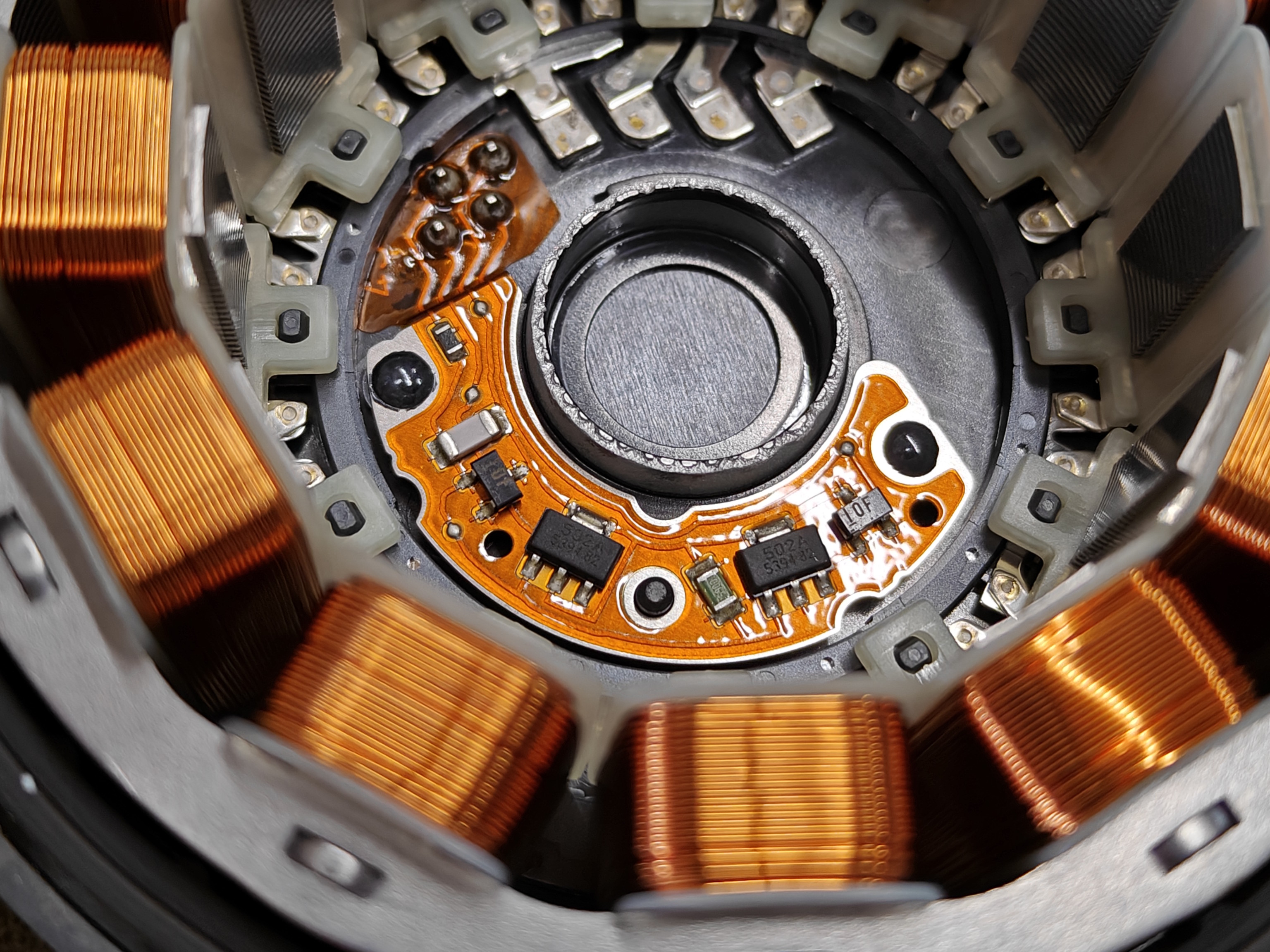

Two SOT-23 hall sensors I0F scribed on packaging --> Could this be TI DRV5023?
Two SOT-223 502A 5394 82 --> Voltage regulators for hall sensors?

Schematic of the motor FPCB
Hall sensors are TDK Mikronas HAL502 type
https://www.digikey.fi/en/products/deta ... -A/5271763
10F SOT-23 type not identified, but he's most certain that it's a double protection diode
