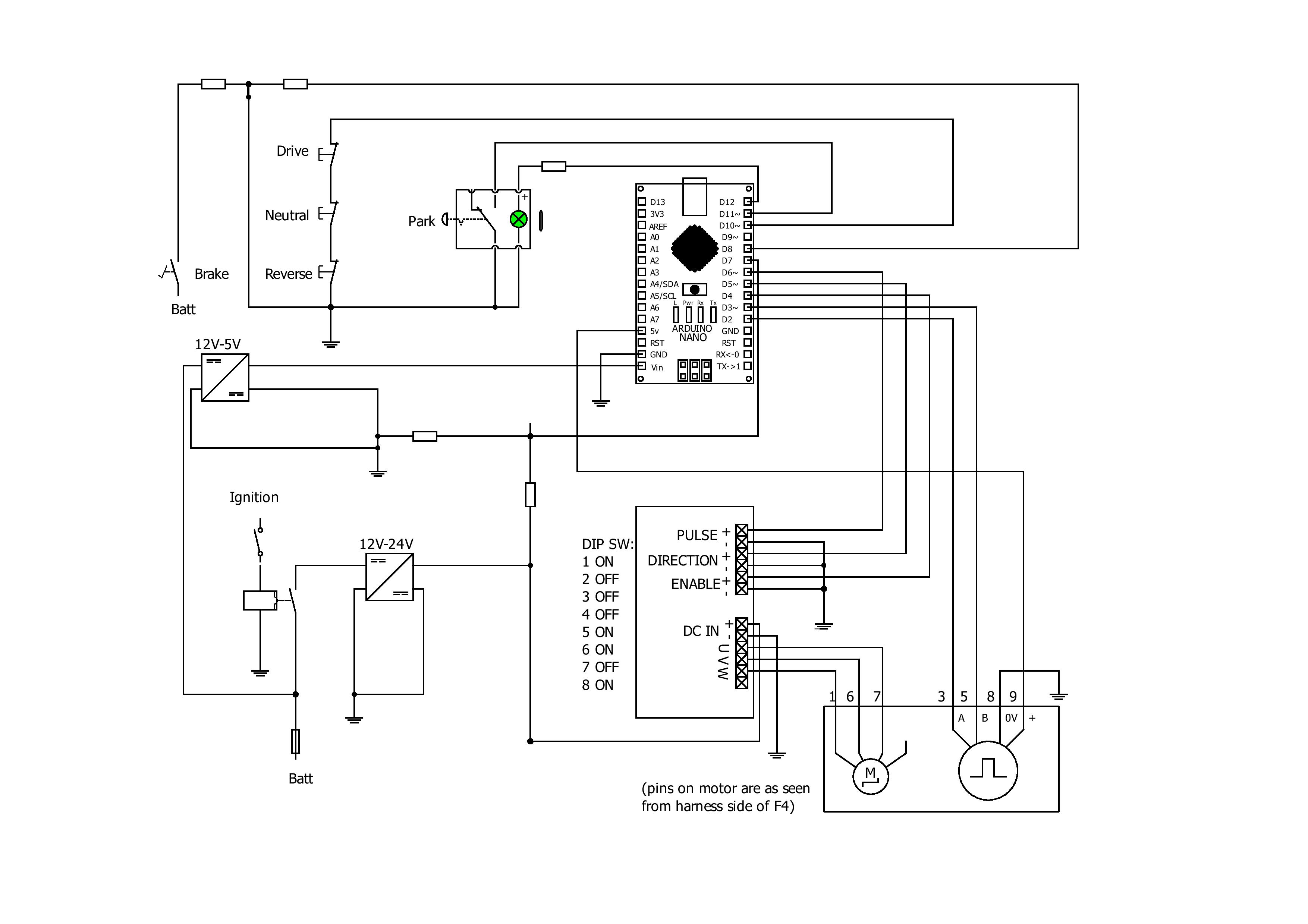

Over on this forum user dddrewski has posted his park pawl implementation using a Cloudray 3-Phase Stepper Motor Driver 3DM580S driven by an Arduino Nano. It's not complete but there's enough there to get started.
Here's the wiring diagram as built, and the arduino nano program to run the transmission park pawl motor.
The first time it runs, the park indicator light flashes. You push the park button and it will do a homing routine to move to park, and remember the position.
The arduino stays powered all the time, so it remembers to state of the park pawl after that.
I there are a couple of voltage dividers in there that I didn't write down the resistor values. I don't remember, but they're probably in the 100k ohm range. They result in the nano only seeing 5V on inputs.
I also didn't write down the resistor value on the LED output. It was a 3V LED, so I just tried a few values until it read 3V across the LED.
The only thing I may change is to put the Resolve-EV controller into Neutral when park is activated. Right now, it will go into park while the Resolve-EV is in Drive or Reverse.

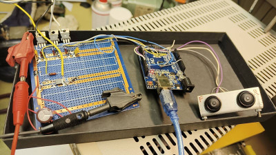

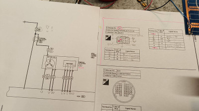

My father got curious about the park actuator motor and is working on motor control, this'll probably become some sort of controller which would be open source.
He pieced together the connector pinmap and wiring diagram, so it's now useful :)

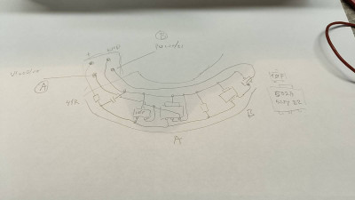

Schematic of the motor FPCB
Hall sensors are TDK Mikronas HAL502 type
https://www.digikey.fi/en/products/deta ... -A/5271763
10F SOT-23 type not identified, but he's most certain that it's a double protection diode

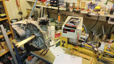

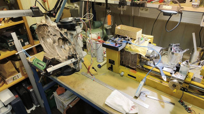

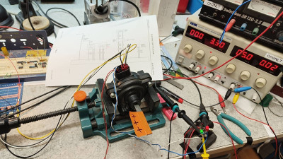

Motor first spins, just feed forward
After few nightshifts, the motor dyno gives approx 7kg on a 161mm lever, so that's approx 11Nm already!
Currently running feed forward.
PaulHeystee wrote: Thu Jul 17, 2025 11:58 am This looked like a viable solution, however, I was not able to get it working, hence the design of my own controller.
Mine is also less bulky and it does not require 24 volts to run it.
Have you implemented the encoder feedback in your controller or are you running feed forward? Would you be willing to share details?

More information from research dept.
Almost certain that the SOT-23 is a 10F diode
Also, Renesas is Japanese manufacturer, so that would also make sense.
The actuator motor is a SCSRM type
Some observations:
It's 155 encoder A or B pulses from end to end
Angular movement is approx 30 degrees
Motor resistance 1,35ohm / phase
Phase inductance varies between about 1,6mH to 4,4mH depending on rotor position
phase coil saturation. On pole ~4ms, between poles ~1ms
Now the test code has been improved, so the actuator doesn't change direction when it hits a hard stop and misses steps.
Testing with park pawl and input gear
Powerstage
In the video, you hear first disengage and then engagement of the park pawl. As the tooth is not aligned with the pawl, you can totate the gears until the pawl engages by spring force.
