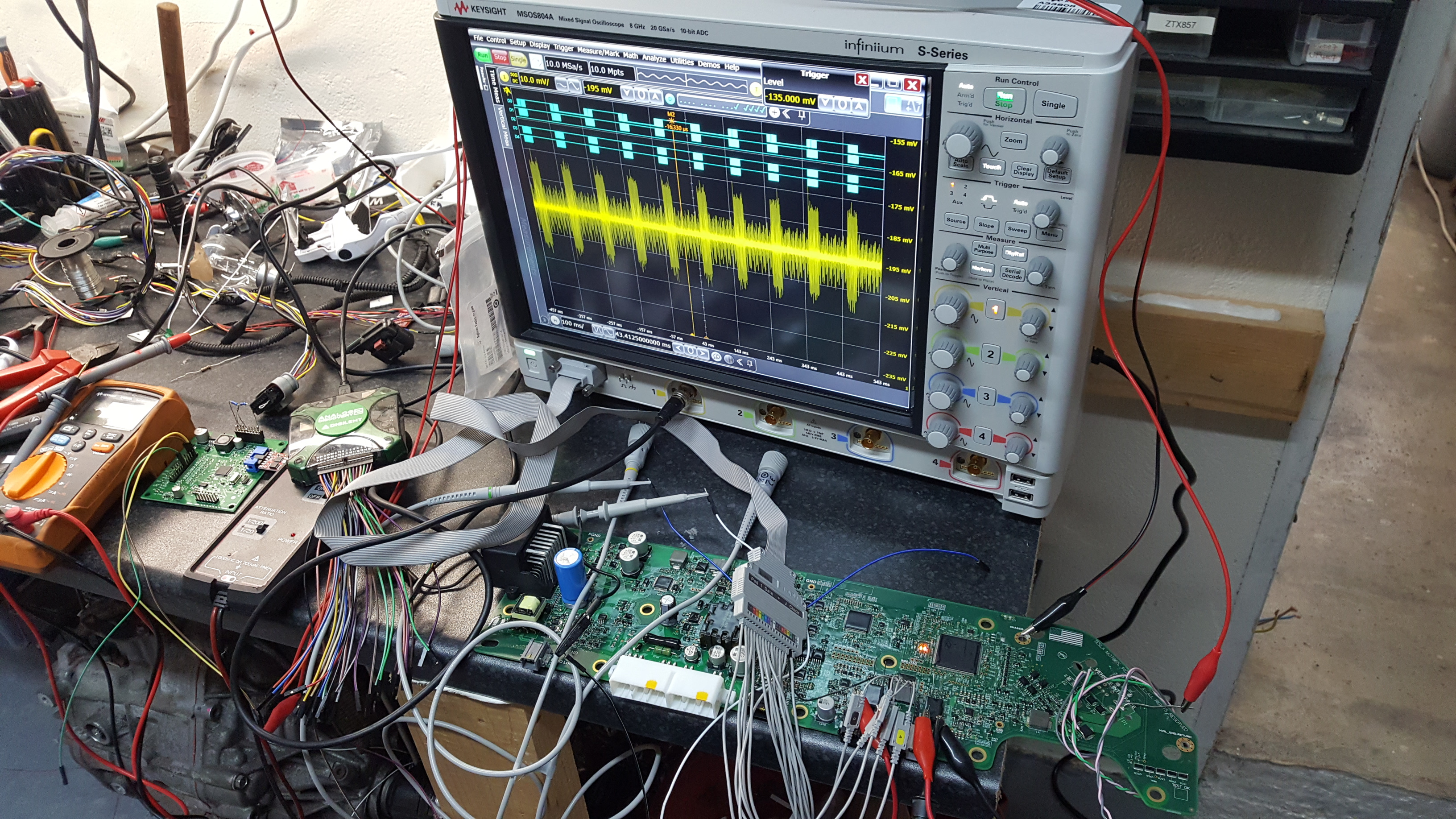

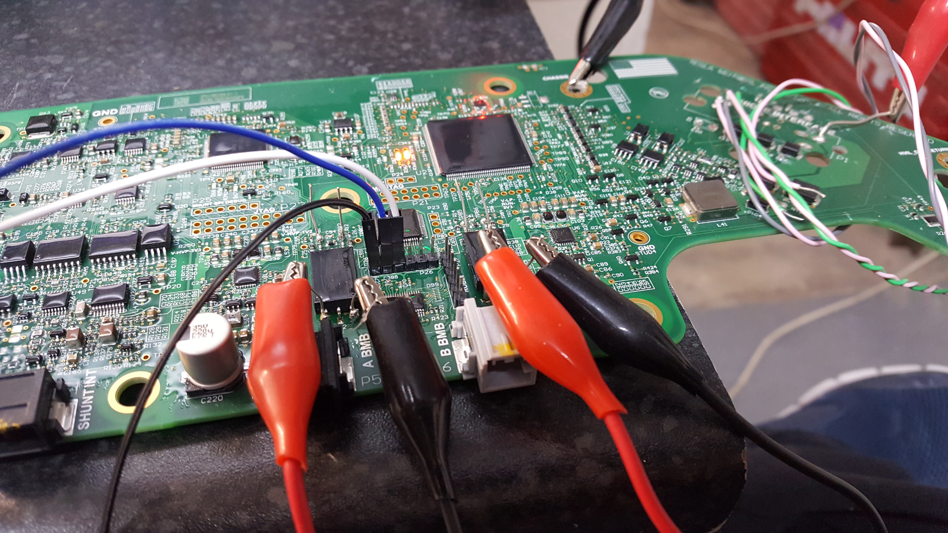

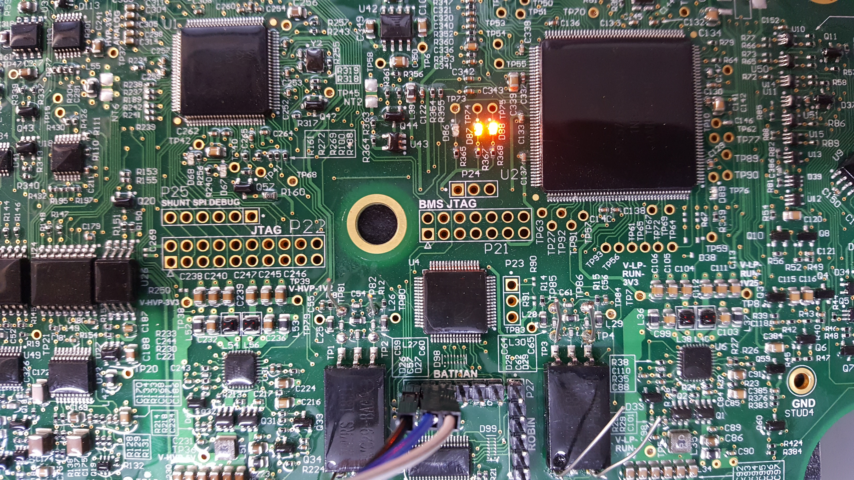

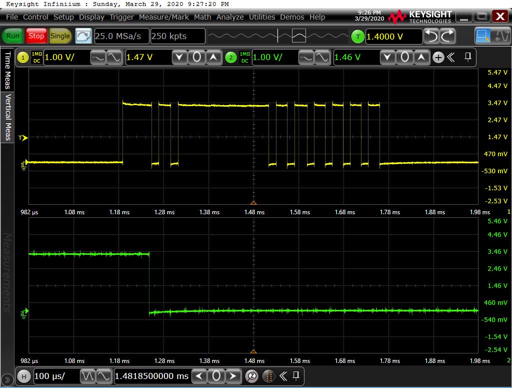

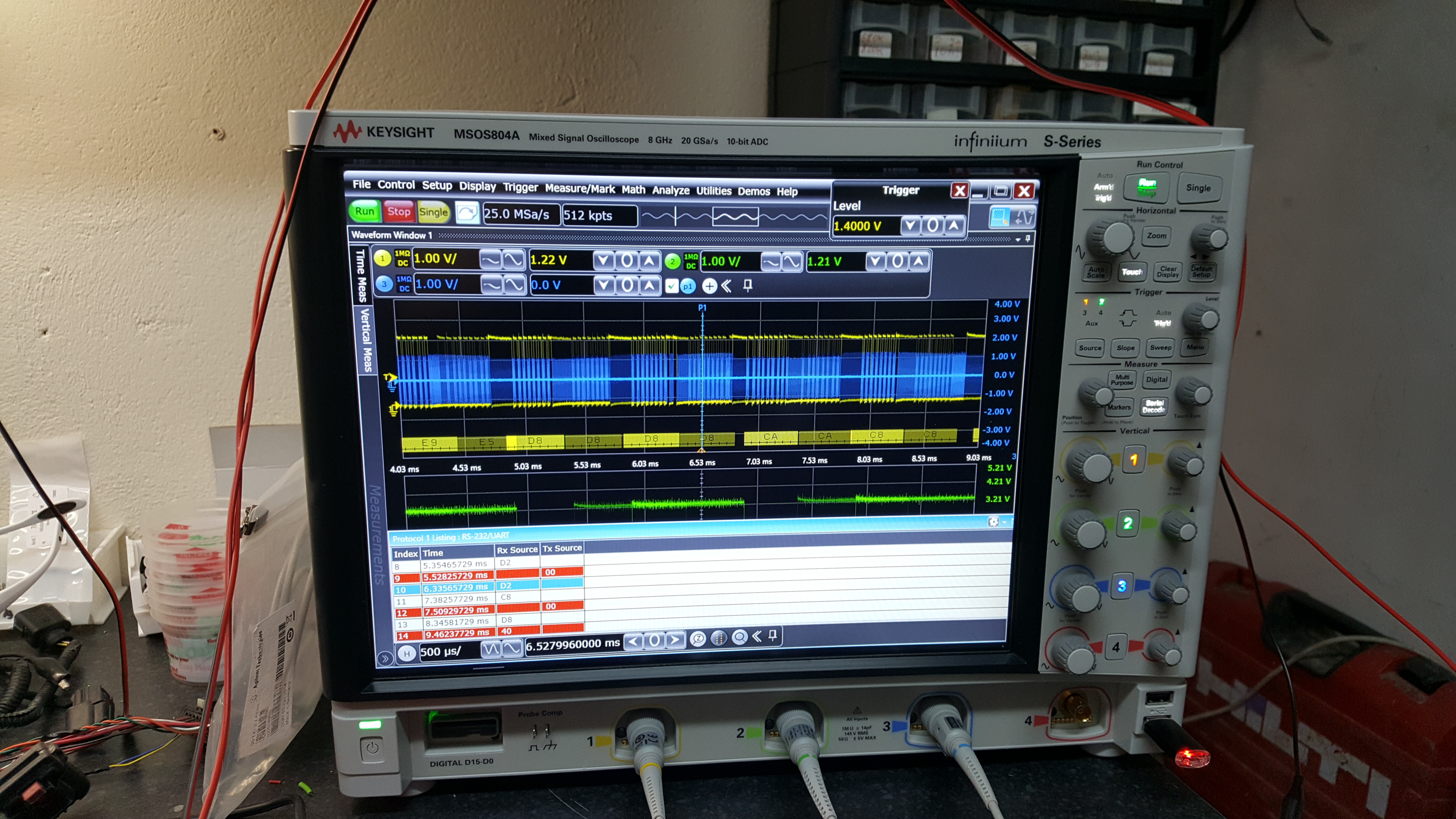

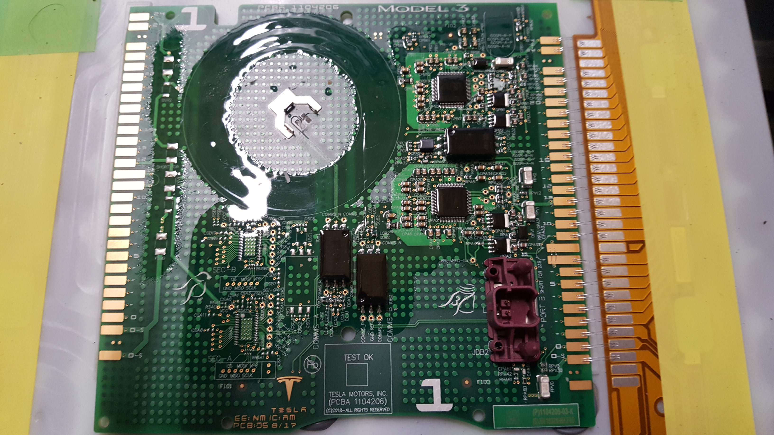

So both batman and robin have 6 pin 2.54mm headers. Seemed only right to populate them and go probing around. Results attached.

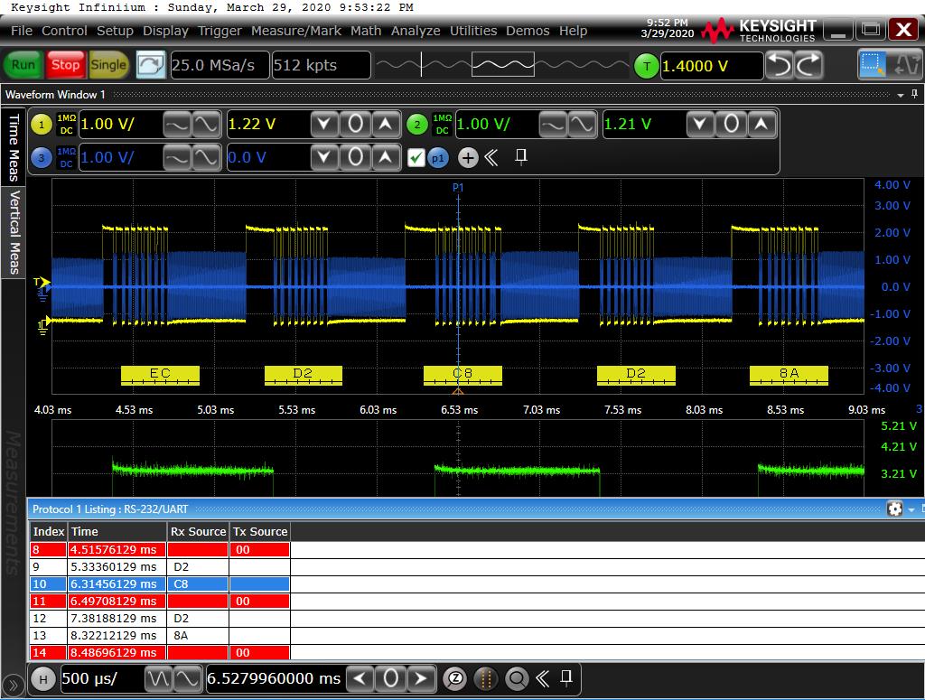

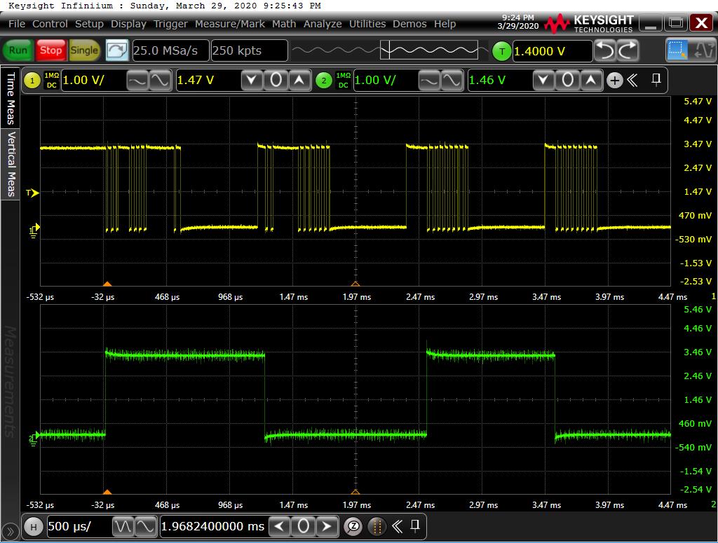

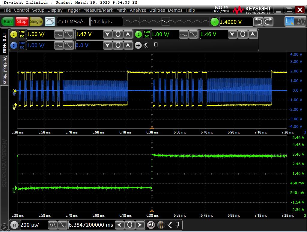

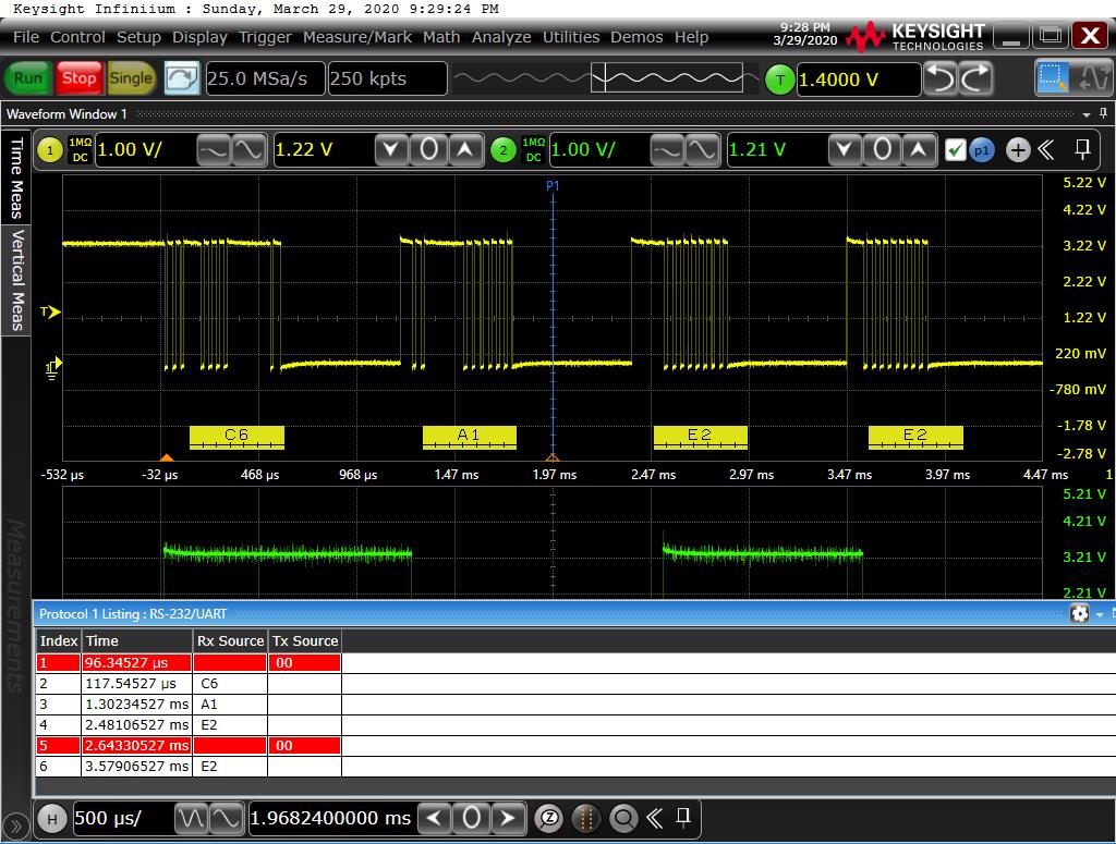

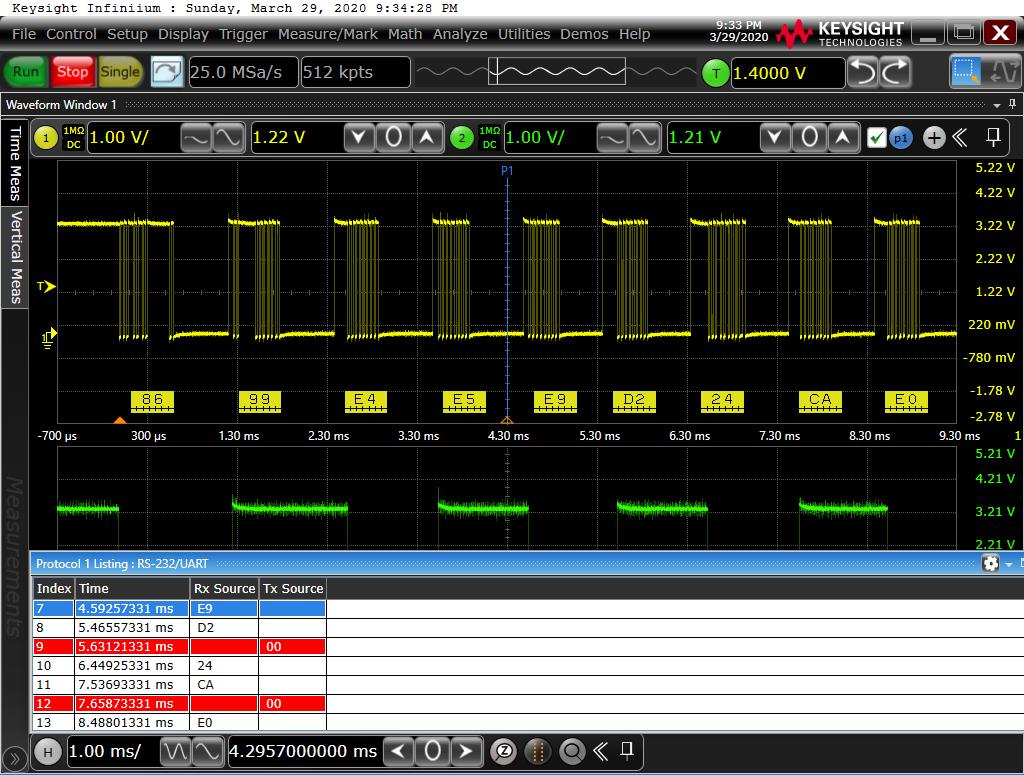

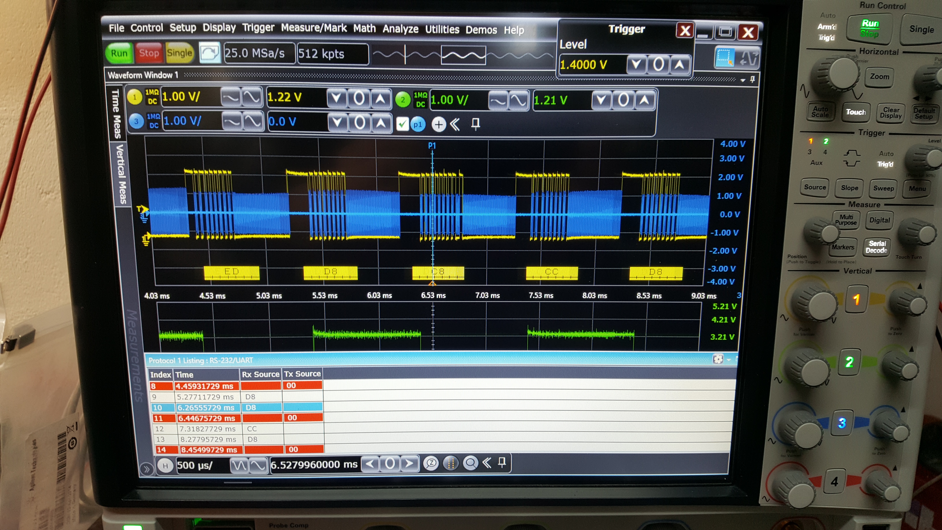

Soooo... in the attached chan3 (blue) is on the outputs of the iso transformers, chan1 (yellow) is on pin 3 of the batman header and chan2 (green) is on pin2 of batman header. Protocol decoder set to serial at 14.4k on chan1 just for kicks....

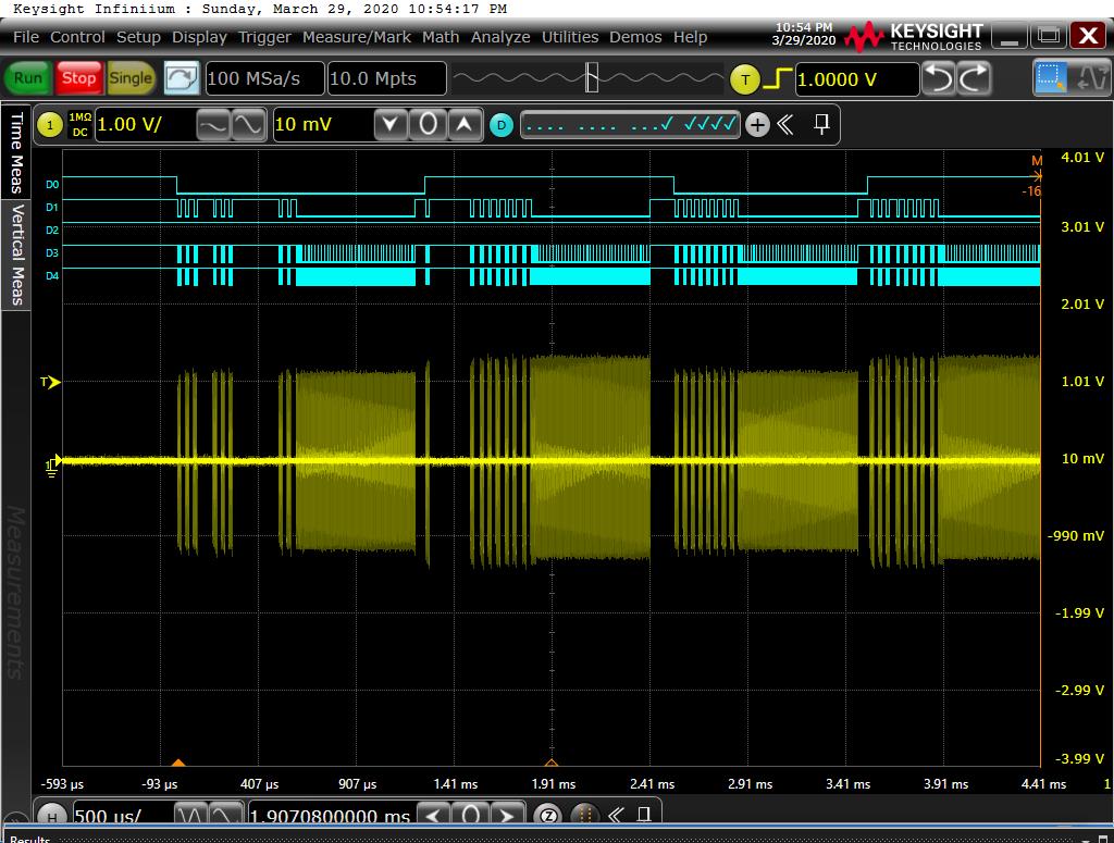

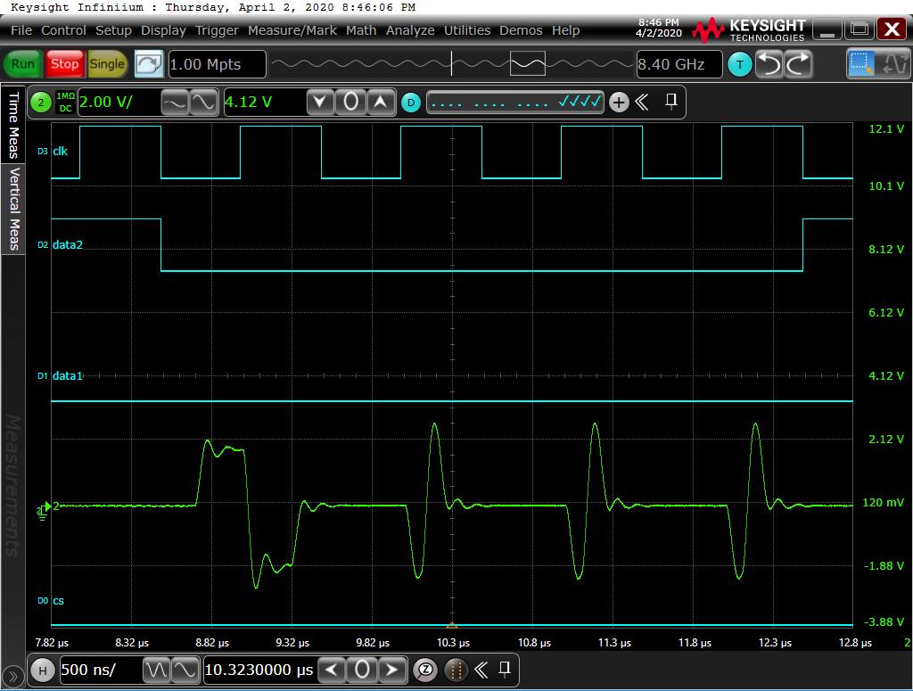

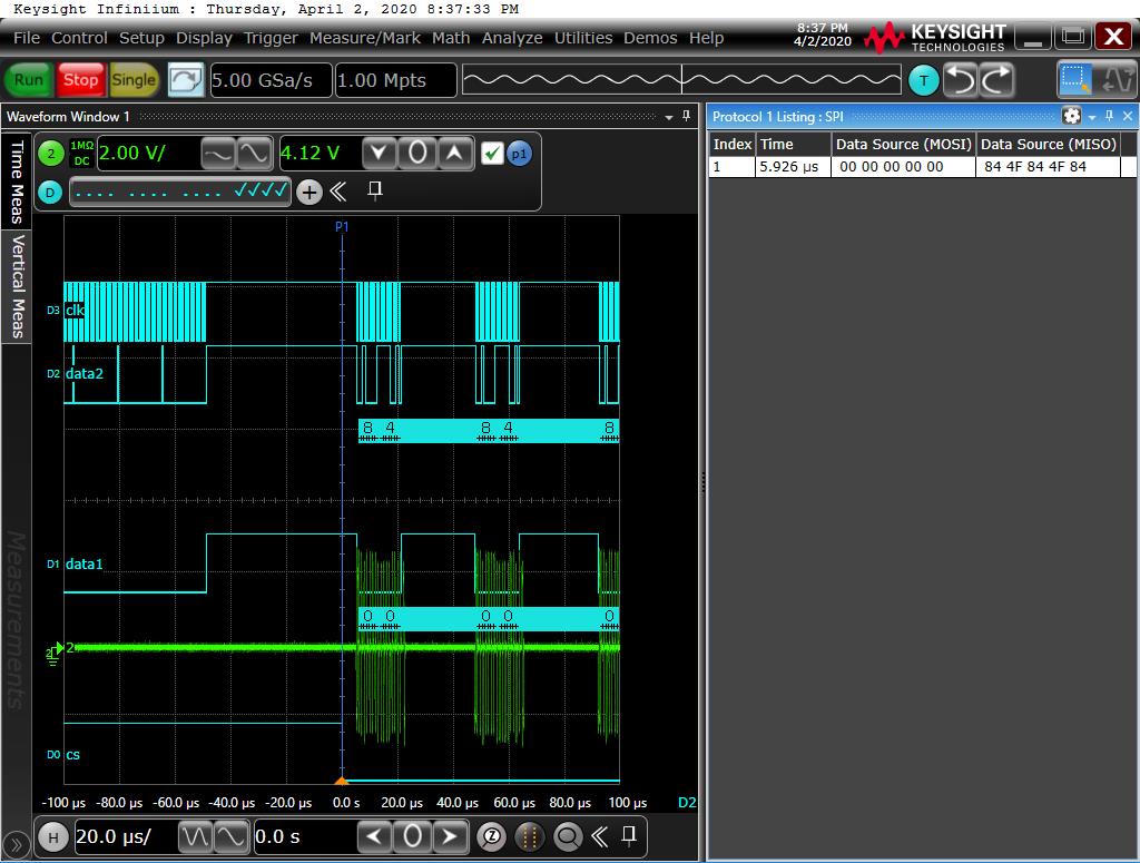

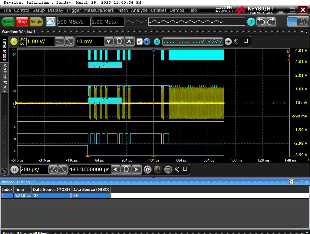

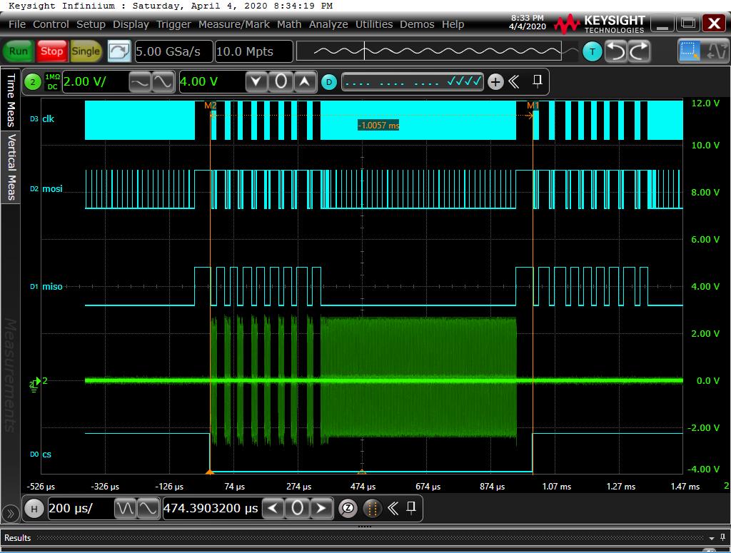

Forgot this is an MSO scope. Broke out the digital pod and probed all 5 pins on the batman header. Kicked on spi protocol decoder and bingo. Now we're cooking:)

So far have an spi capture from the batman chip on the hv controller. Looks like some command data and lots of zeros that could be for cell data:) Of course I'm probably on the wrong track and seeing what I want.

Tom wrote in the YouTube comments (captured here for posterity);
"What you are seeing is; a messages, two bytes and a PEC (also two bytes) to wake up IC one in the chain, so Module 1 IC1, then the other 8 are to poke the chain lets say. So from Module 1 IC 1 to Module 1 IC2, to Module 2 IC1 ect. ect. When it is all zeros it is just waiting for a response"

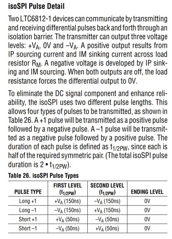

I have tried making some sense of what the SPI data would mean, but so far no luck.
However one thing to add, the signal you reffer to as analogue is ISO SPI pulses.
[url]https://www.analog.com/media/en/technic ... 6812-1.pdf[/url
So the big jist of it is that that you can see the spikes, which is a timing spike, then the way the spike decays indicates its value representation.
Excerpt below on the description from LTC.

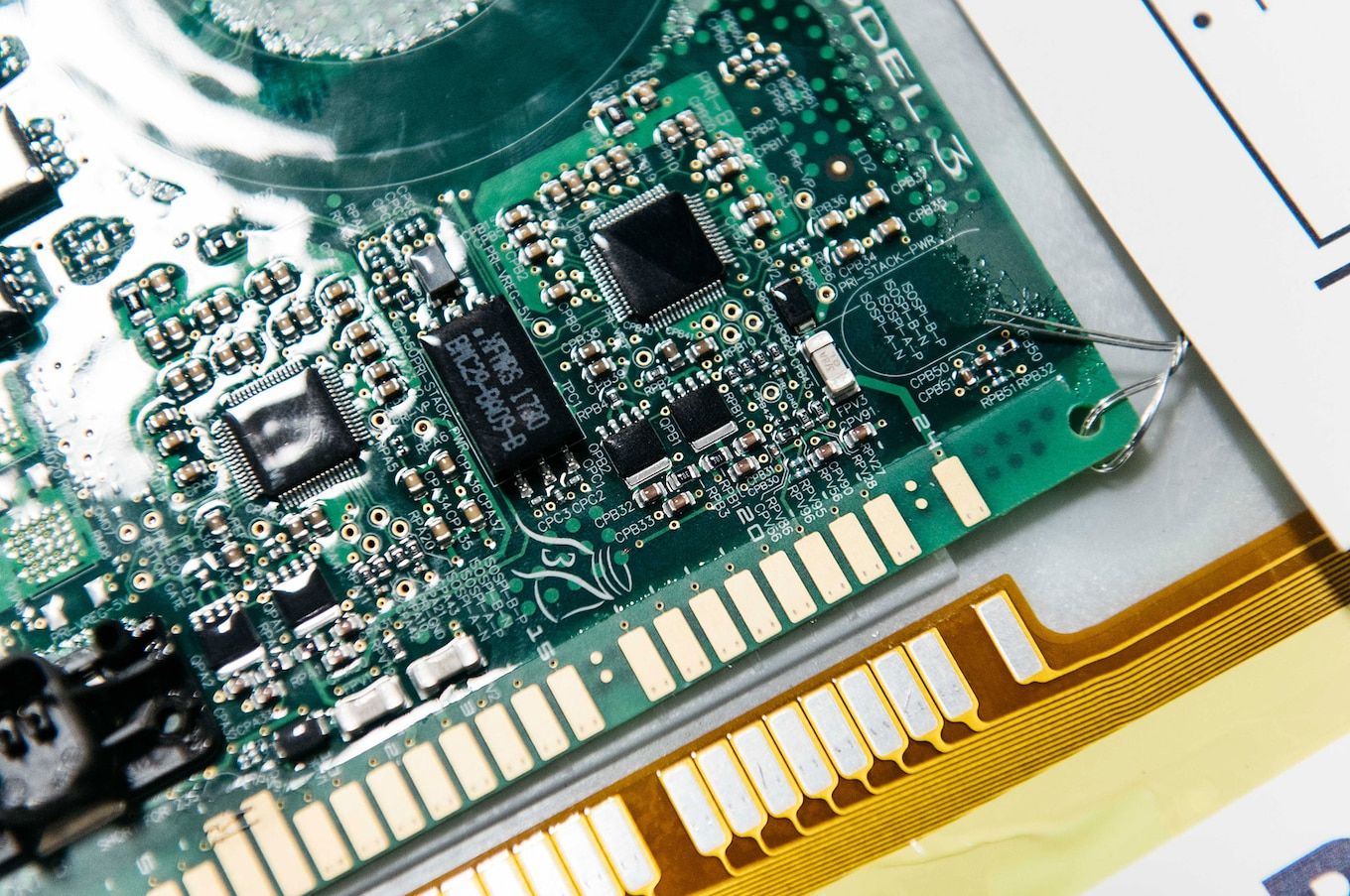

Maybe replace the BMS PCB with a LTC6812 design and treat the gold fingers on the battery as an edge connector that you fabricate a matching connector for 8-)

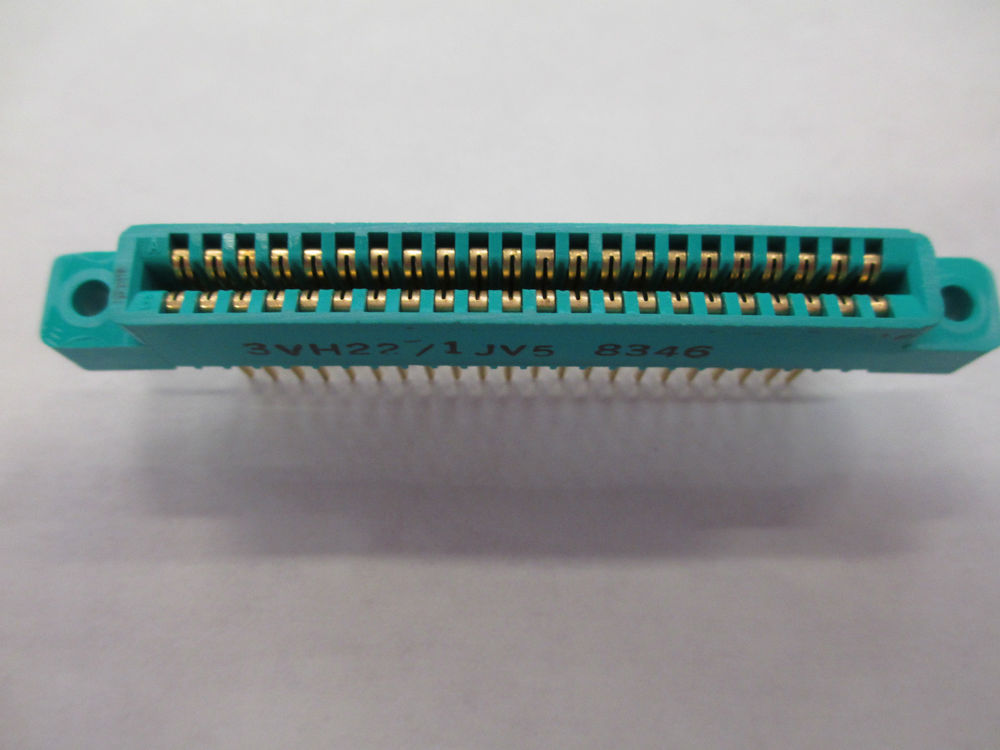

Looking at the Munro teardown the PCB edge connectors clean up nicely once the wires are removed... I wonder if we have enough space to slip the bottom of a mating connector under the flexi circuit... depending on the pad pitch we might even find an off the shelf part 8-)

If you cut the aluminum bonding wires, then you need to find a way to connect the new PCB to the flex cable. The traces on the flex cable are aluminum and can't be easily soldered to (I've tried). The only other option is to run individual wires down to the cell groups. There are access holes through the battery casing that would allow a wire to be soldered to the SS battery casing.

dougyip wrote: Wed Apr 01, 2020 3:37 pm If you cut the aluminum bonding wires, then you need to find a way to connect the new PCB to the flex cable.
That's why I'm proposing a connector that slips onto the flex cable... I've done this a number of times in the past when hacking OEM components with exposed pads on the edge of a PCB :)

The flex cable is glued down solidly to the plastic case along it's whole length. I don't it can be lifted without damaging it.
Posts: 4000
Been thanked: 1117 times
Re: Tesla Model 3 Battery Hacking
More than one way to solve a problem : https://ie.rs-online.com/web/p/conducti ... s/1863616/
But let's stick with plan A for now which is to have the spi comms:)

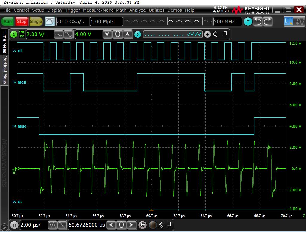

Here we see a full frame of data sent from the master (hv controller). From what I can see at a first glance this looks identical to the format described in the LTC6820 data sheet pages 11 to 15.
LTC6820.pdf
(1.85 MiB) Downloaded 394 times

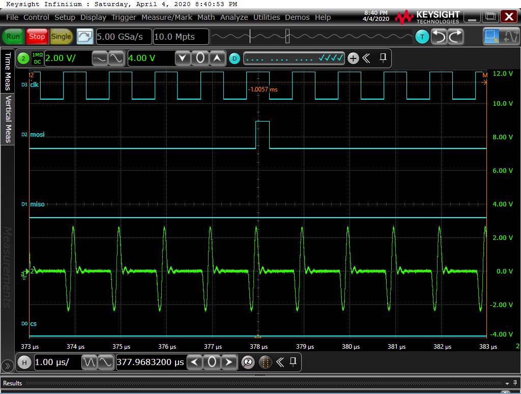

So far the only anomaly I have detected is a pulse on mosi that is not encoded on the isospi bus ...
