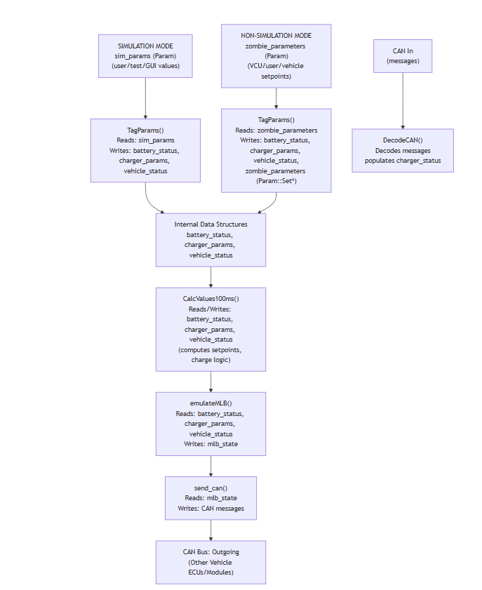

modellfan
Posts: 137
Has thanked: 18 times
Been thanked: 45 times
Re: MLBevo Charger- 11kw & 22kw Info
Post by modellfan »
Thank you very much. I gave it a clear information flow structure and cleaned it up. In the next days, I will test it on the real vehicle.
https://github.com/Modellfan/Stm32-vcu_ ... le_Testing

Why pointers and not use Params as RTE replacement ?
What exactly do you simulate ? A battery simulator to be used as predictive model would be really neat .

I am using parameters. I am simulating SOC, max/min voltage and current. I'll put it all together and try it in the morning. Just wanted a trained eye to see if I missed anything. I have a predictive simulation as well, but I'll try the easy way for now by spoofing the charger before starting the charge sequence, and see if that helps get conclusive charging sequences.
