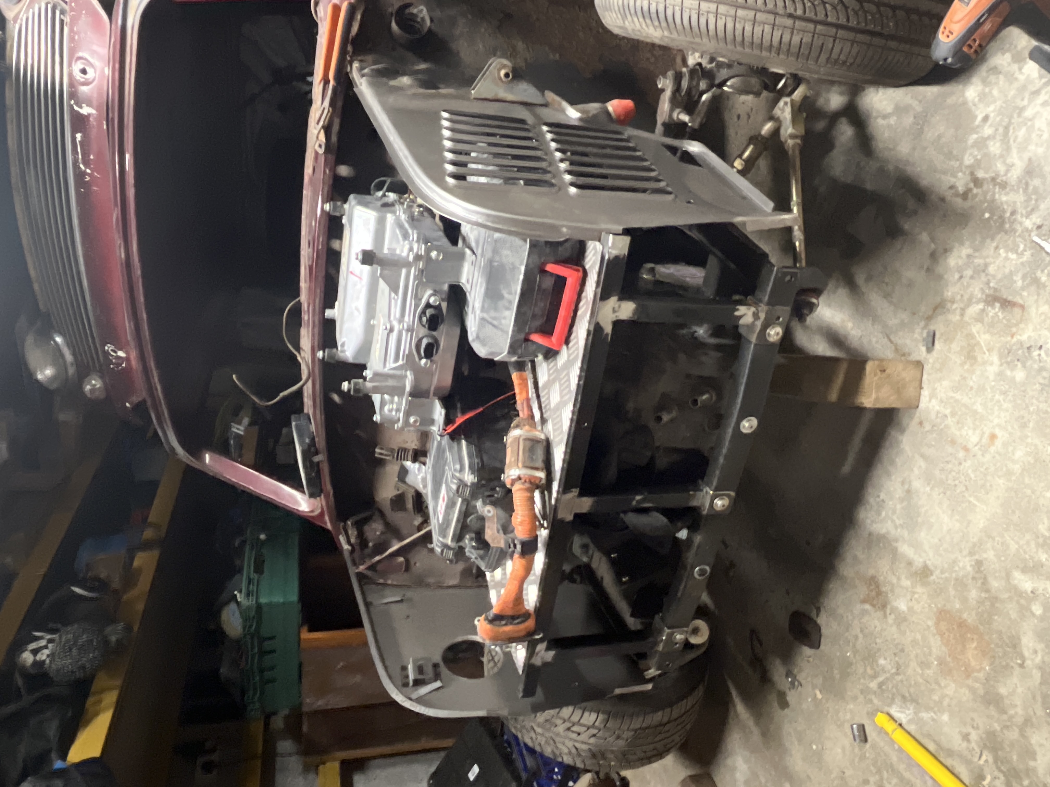

Spent a few hours making prototype motor mounts, once driveshafts are sorted I will make some nice shiny ones, just rear mount to finish the motor is in, I’m only using existing subframe holes.
Any advice on best pedal for a mini??
I have a 2024 sp41 battery on its way so 12kw, just need to source a pedal and decide on vcu.

Looks tidy - id be interested to see how it feels with solid mounts - im thinking about going solid on the next build.

Turbopete wrote: Tue Jul 22, 2025 11:17 am Looks tidy - id be interested to see how it feels with solid mounts - im thinking about going solid on the next build.
There is a TINY bit of isolation from the rubber subframe mounts

Had a little wait for the inner wings but they are now bolted in temporarily so i know what space i have, hope to get two batteries down the bottom and four up top, the black boxes are taller than the batteries
if it works out i’ll be pretty close to keeping corner weights the same as original, give or take 15kg and there will be room in the boot for another pack ( a la gregski ) if i need more range. Big decision now is which vcu to go with, thoughts and ideas are most welcome. I’m a bit simple when it comes to computers so this will be a massive challenge/headache for me. Also need to find a pedal that sits right, not allowed to do any drilling or welding to monocoque in uk so could be tricky to find the right one, again, any ideas would greatly appreciated

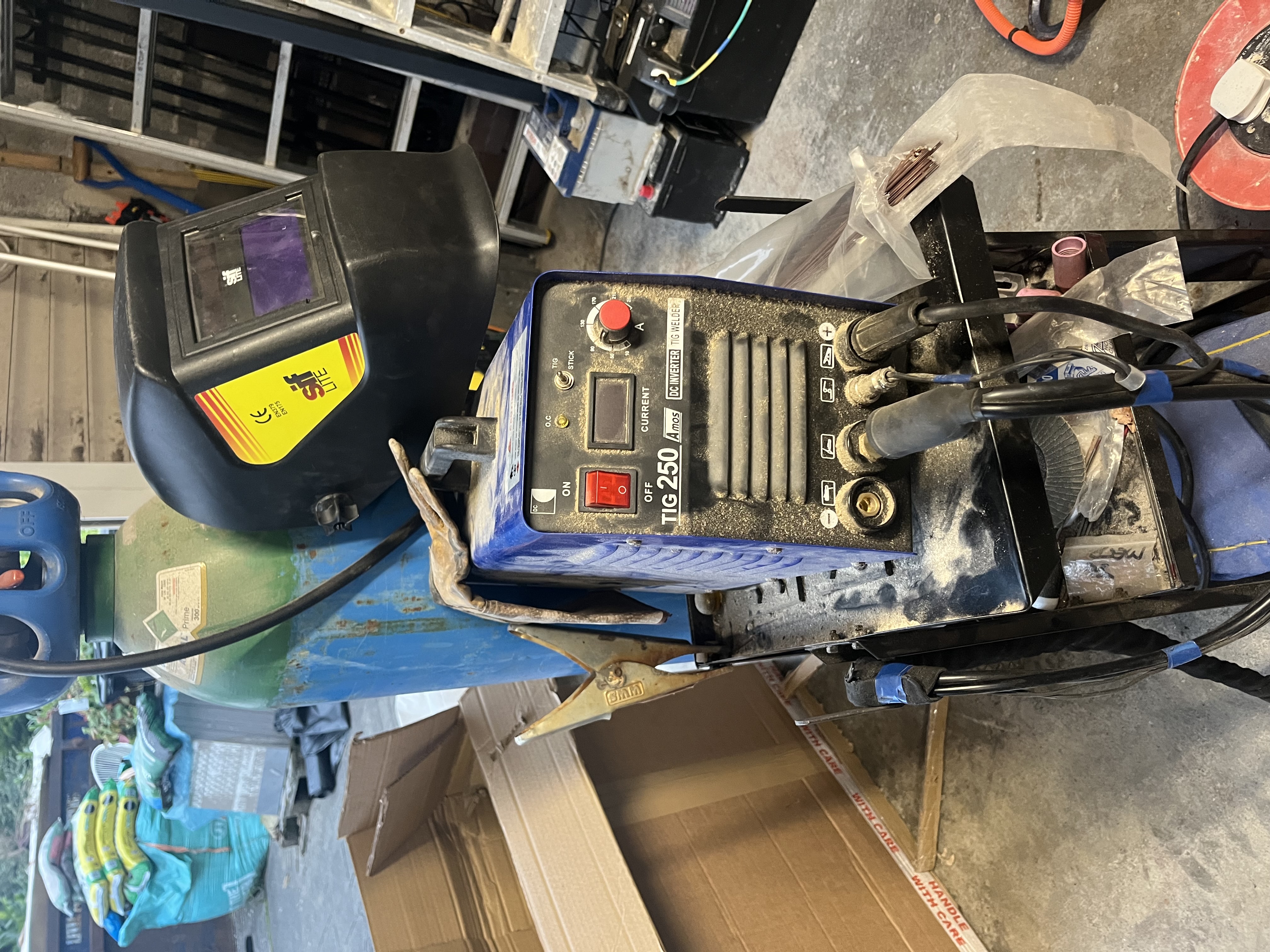

Buit my first ever driveshaft today, a bmx frame was perfect size for the sleeve, turns out bmx’s don’t like being welded though
Luckily I have the S TIG’s cheap Chinese cousin
Also got some more done on front subframe, this will bolt to a couple of captive nuts that rover kindly put in for me way back in 1989

Post by Jacobsmess »
Is the plan to use the driveshafts welded up or have you just used them to act as a template?
