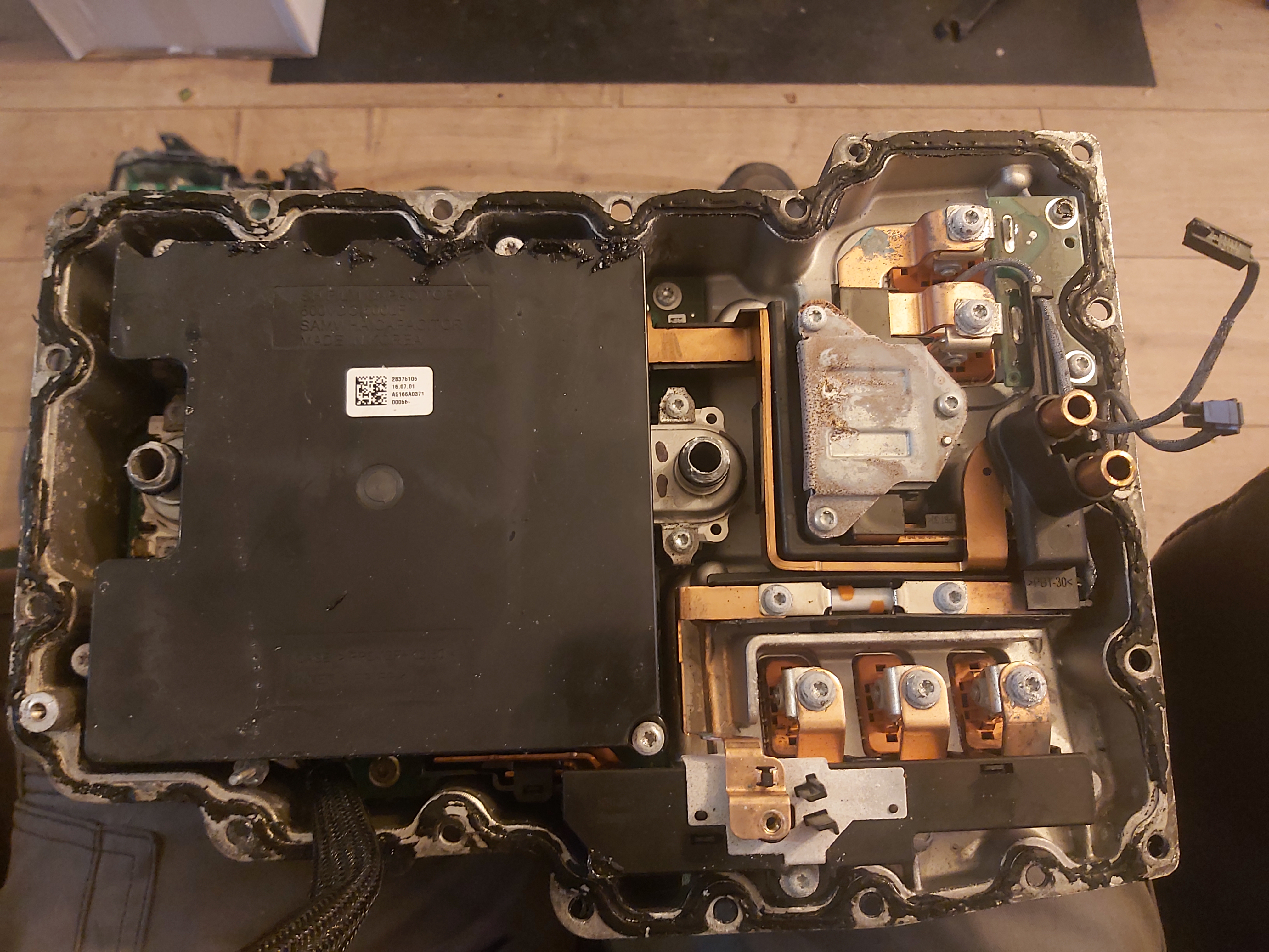

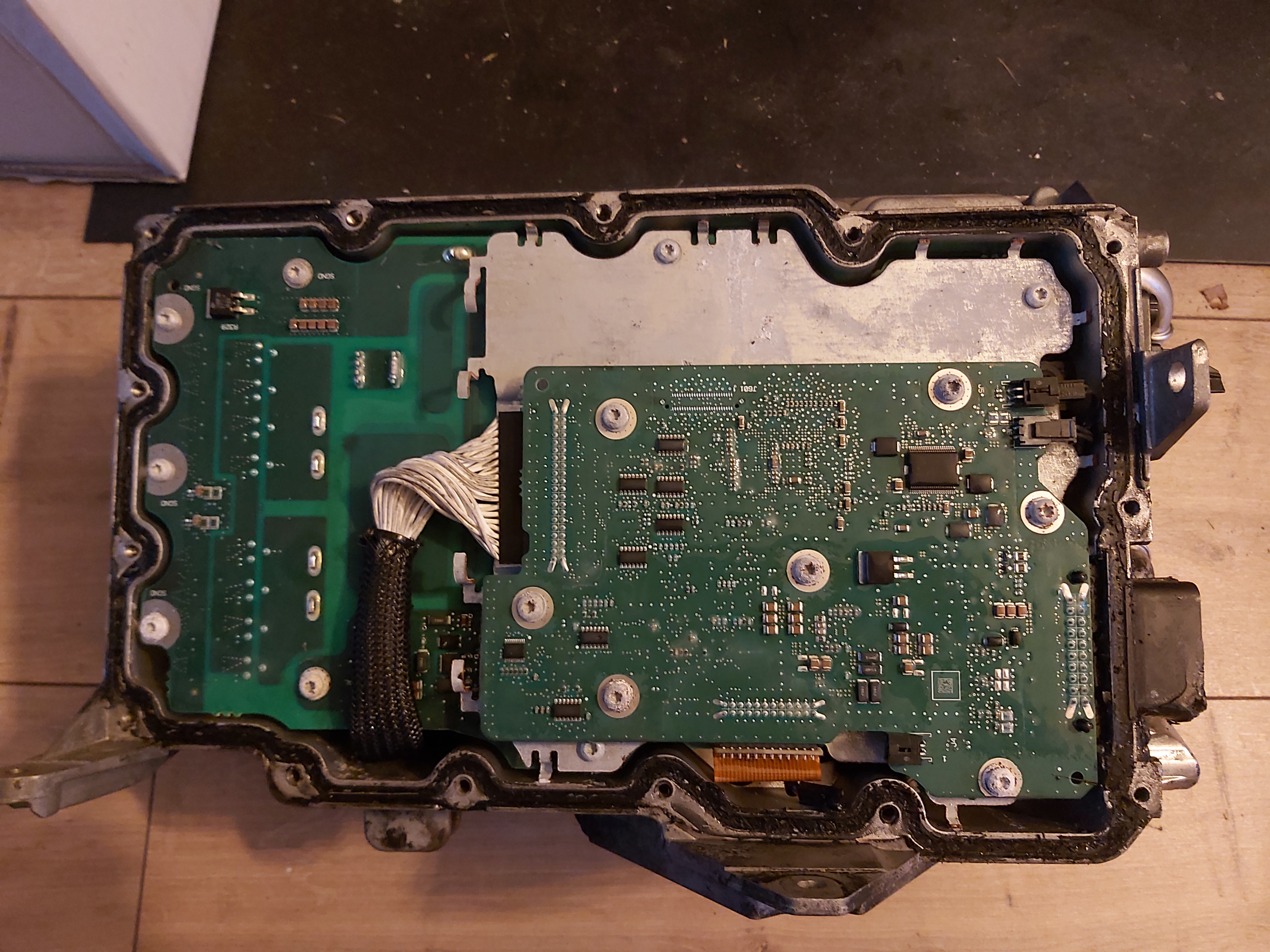

Bought a slightly crispy Volvo XC90 (2015) inverter from a car breaker. My plan is to replace the controller board.
The inverter is specified for 65kW and also includes the DCDC converter.
The battery and motor connectors are on the bottom if the inverter sits in the car.
On the side there is a low voltage multi pin connector, a low power HV connector and a B+ post. think the case is used as the ground connection.
With the lid off we can see the control board on a bracket and the DCDC converter below.
There are 3 smale 2 pin connectors for the HV interlock. A short flatflex cable for the DCDC converter. and the big connector for the inverter.
After removing screws from the DCDC converter side, the case can be split and reveals the inverter.
The inverter board and the DC Link capacitor come out as one unit. the capacitor is connected with 6 screws.
will start with the inverter connector pinout reverse engineering.

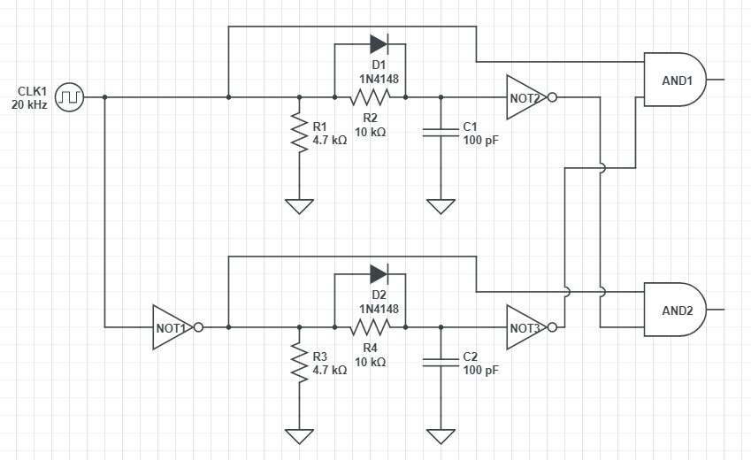

Got 25 wire of the 40 figured out.
The current sensors, temperature sensors and gate-divers.
This whas a big job to figure out. Started out with a wrong assumption that the 3 chips where the same. One of them turned out to be a inverter chip instead off a AND gate. This circuit is a hardware dead-time generator.
This is the output from a simple simulation of the dead-time circuit. Capacitor values are a guess, I couldn't measure them on the PCB.
to do:
-figure out how voltage sense works
-I think there is a cap discharge circuit.
-floating power supply for the gate-drivers
-and some other stuff probably

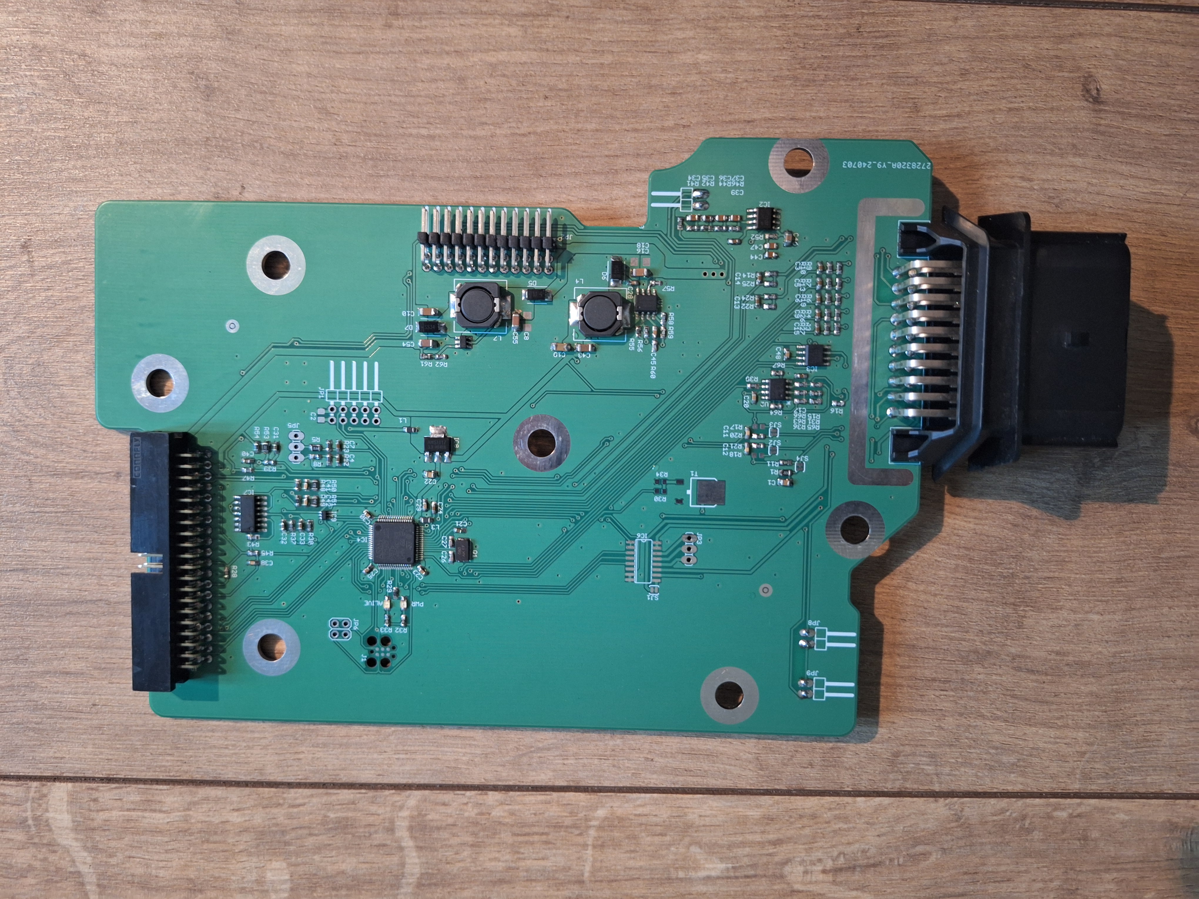

After a couple of long nights V1 board is done
looks similar

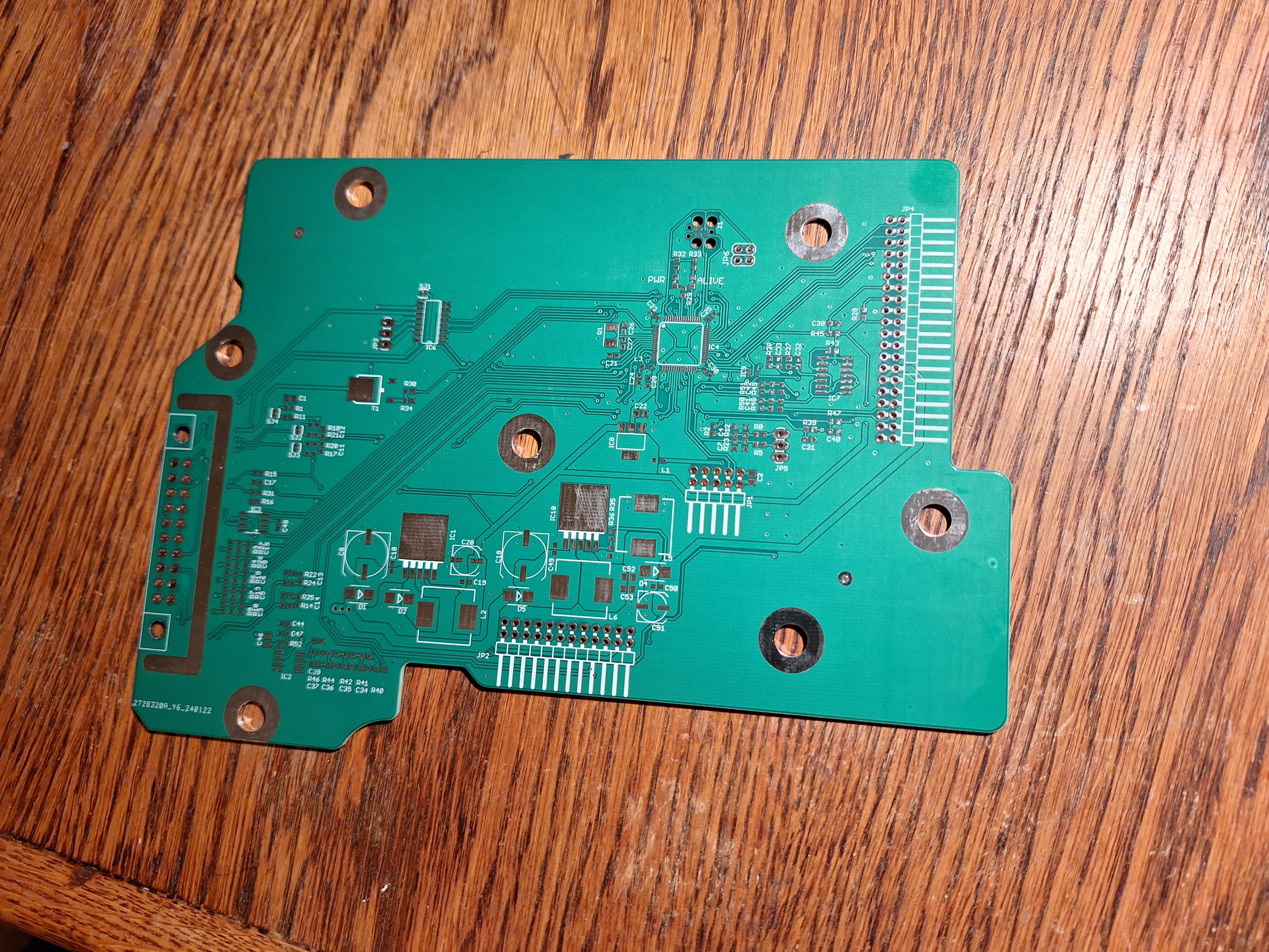

PCB are here!
After desoldering two DC-DC converter boards for parts and transferring them to the new PCB. The power supply whas tested before I placed the other components. The 5V line whas 1.25V at first power up. The LM2596 I got is the adjustable type and not the fixed 5V one.
Added a couple resistors for now. It will be replaced at some point.
The inverter uses a 15V feed so I changed the DC-DC converter from the original design to a more powerful one.
This DC-DC converter is powered from the 12V instead of the 5V like it is in the original design. So I replaced it for a sepic type so it will work from 5V to 32V.
First problem: The capacitors are to high so the pcb dose not fit in the inverter housing. Will find some lower ones.
but first more testing to find out if there are more problems.
It looks a lot better than the prototype

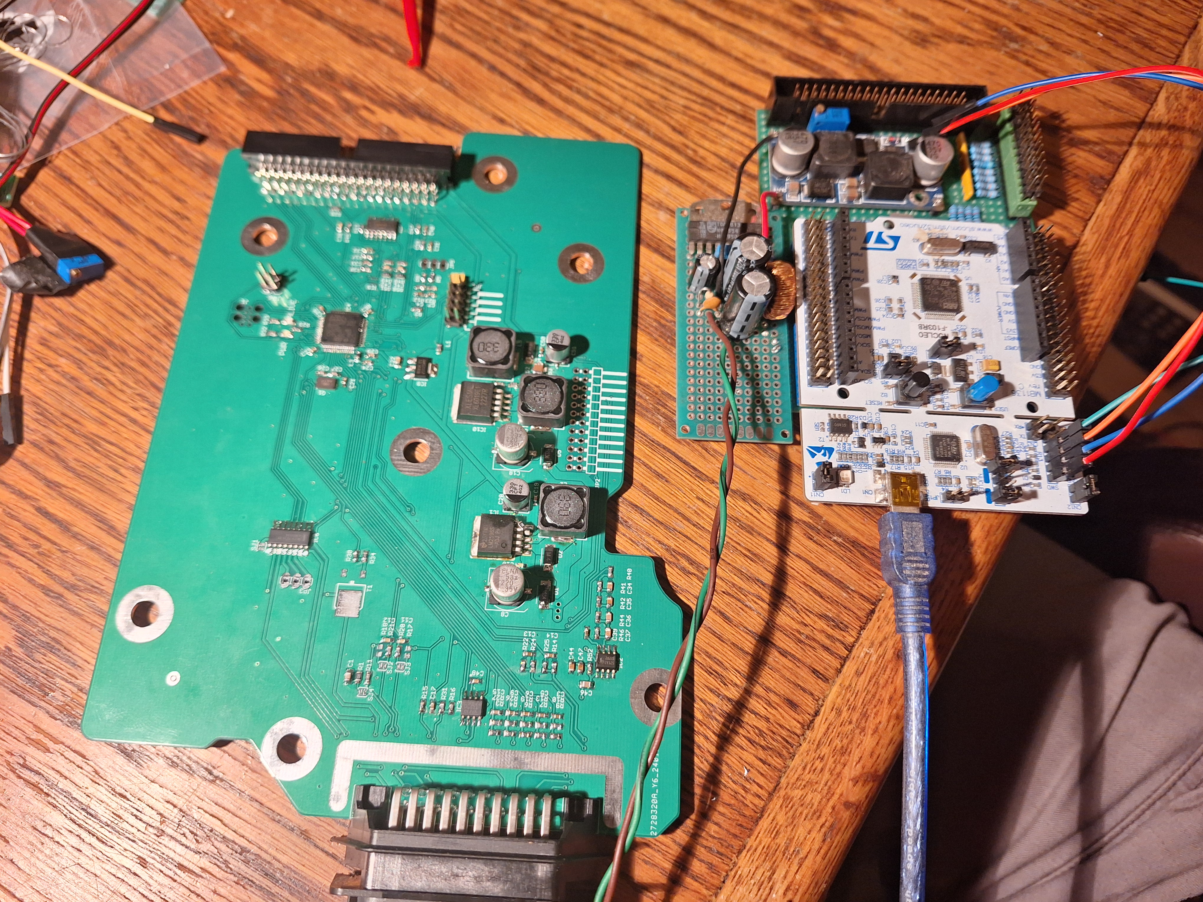

OI replacement PCB V1.1
Made a revision on the PCB there where a couple of small errors pin swaps etc.
Bigger problem whas that the board did not fit in the inverter. Caps and inductors for the 2 DCDC converters where to tall.
Replaced the LM2596 and XL6009 for parts with a higher switching frequency. With a higher frequency the passive components can be smaller.
Used a MP1584 for the 5V supply and a mt3608 for the 15V supply, Did not go with a sepic converter for the 15V supply this time. There is no need for running this controller on 24V or something.
Added a opamp circuit for the PT100 temp sensor in the motor. And changed the layout for the inverter temperature.
Added connectors for the HVIL and connected it to the E-stop input.
Removed a contactor output and used the pin for ground for the resolver excitation signal. to make the wiring simpler.
Moved some of the mounting holes. They did not lined up perfectly on the V1 board and still don't
But the holes a oversized so it fits fine.
Have to change the code for the temp sensors.
The design is not final but this is good enough to get the project running.

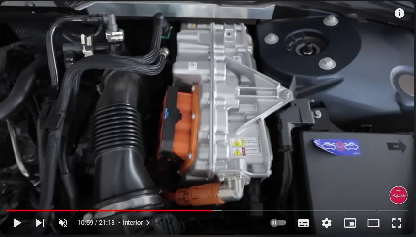

On youtube I watched this video.
Under the hood I saw this.
at first i thought this is a weird place to mount the inverter. Then i realized my mistake, this inverter is for the starter/generator.
So i am not sure what the specs are for this inverter.

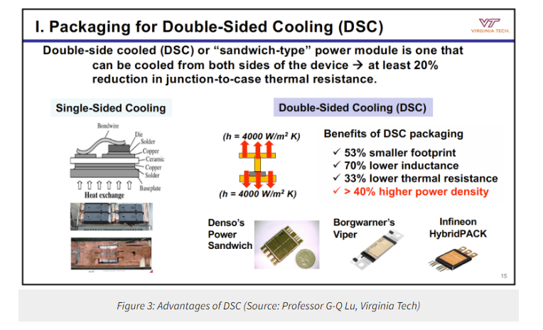

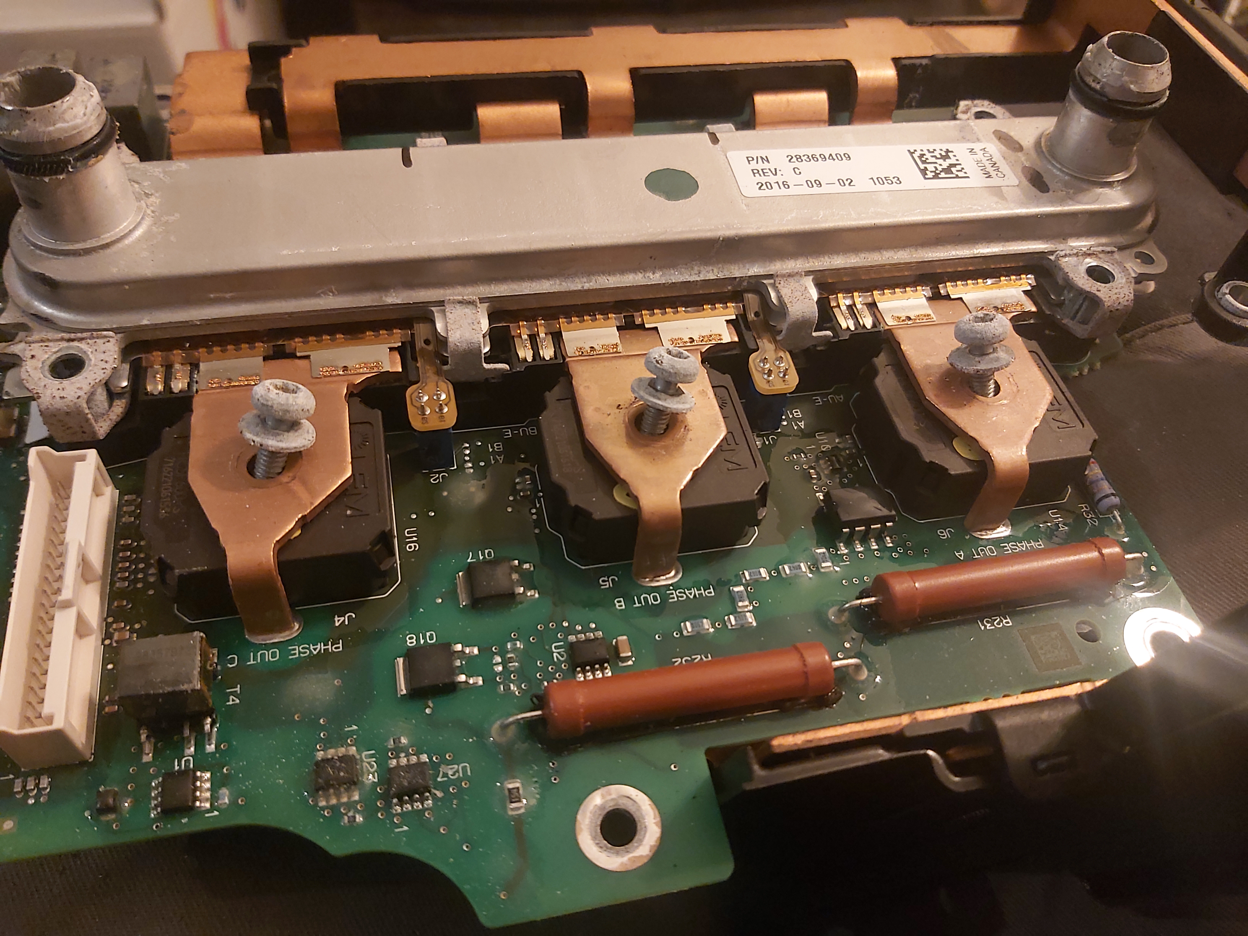

Today I spend multiple hours online to answer the question how much power can the inverter take.
With google image search I looked at a LOT of IGBT modules. At some point I found this.
This type of cooling is called Double Side Cooled (DSC).
searching for DSC module I came across this
The Borgwarner Viper looks like the module in the volvo XC90 inverter.
Looking for Viper modules I landed on the Borgwarner's website. Look what they make
https://www.borgwarner.com/technologies ... onics#cidd We are getting somewhere. After some more googling I found out that Borgwarner at some point bought Delphi how made the viper module.
Strike!!!
In a IEEE paper comparing DSC modules https://ieeexplore.ieee.org/stamp/stamp ... er=9769770
As far as I can tell its a 650V 500A IGBT module.
Strike!!!
Later found this so maybe 750A https://www.power-mag.com/pdf/feature_p ... eature.pdf
Anyway I am pretty sure it will handle the 65kW I am looking for.

Hi. Terrific work. Are you sharing the board? Or selling the design?
- manny
- Posts: 195
- Location: Netherlands
- Has thanked: 58 times
- Been thanked: 159 times
Re: XC90 inverter teardown and reverse engineering
Yes I will.
But I am working on a revision at this time. Going to a 4 layer PCB
- PSA battery (50kWh)
- Zombie VCU
That's great news, I'm following along.
I don't understand exactly: did you desolder the igbt components from the original board and use them, or did you order a new one?
- manny
- Posts: 195
No soldering required the logic and power boards are separate.
Remove the lid unplug the original board, plug in the replacement board and close the lid.
Found the 40pin Part Number : 901303140
Product Description : C-Grid III Header, Dual Row, Right-Angle, Shrouded, Fully Loaded, 40 Circuits, Black
