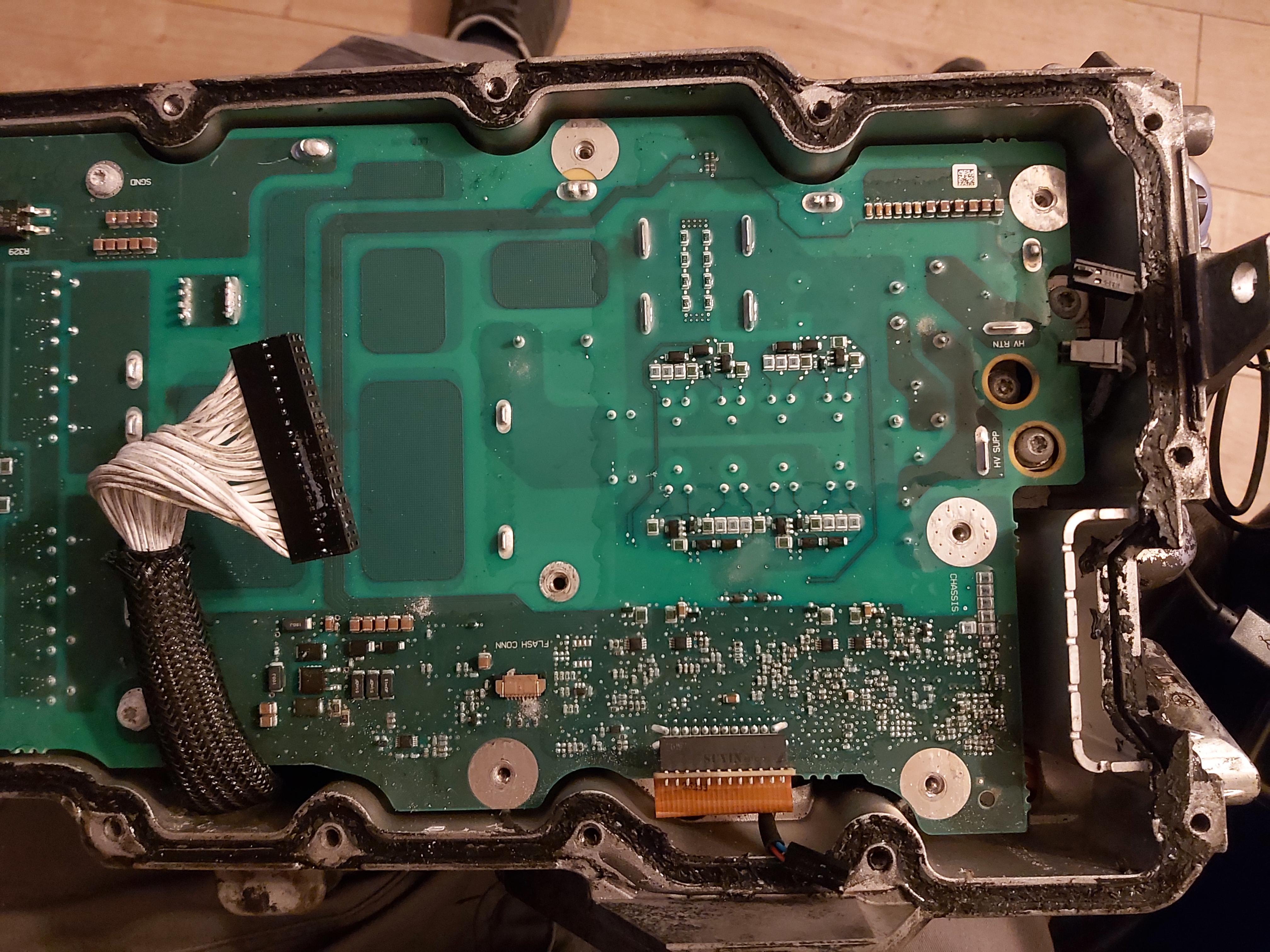

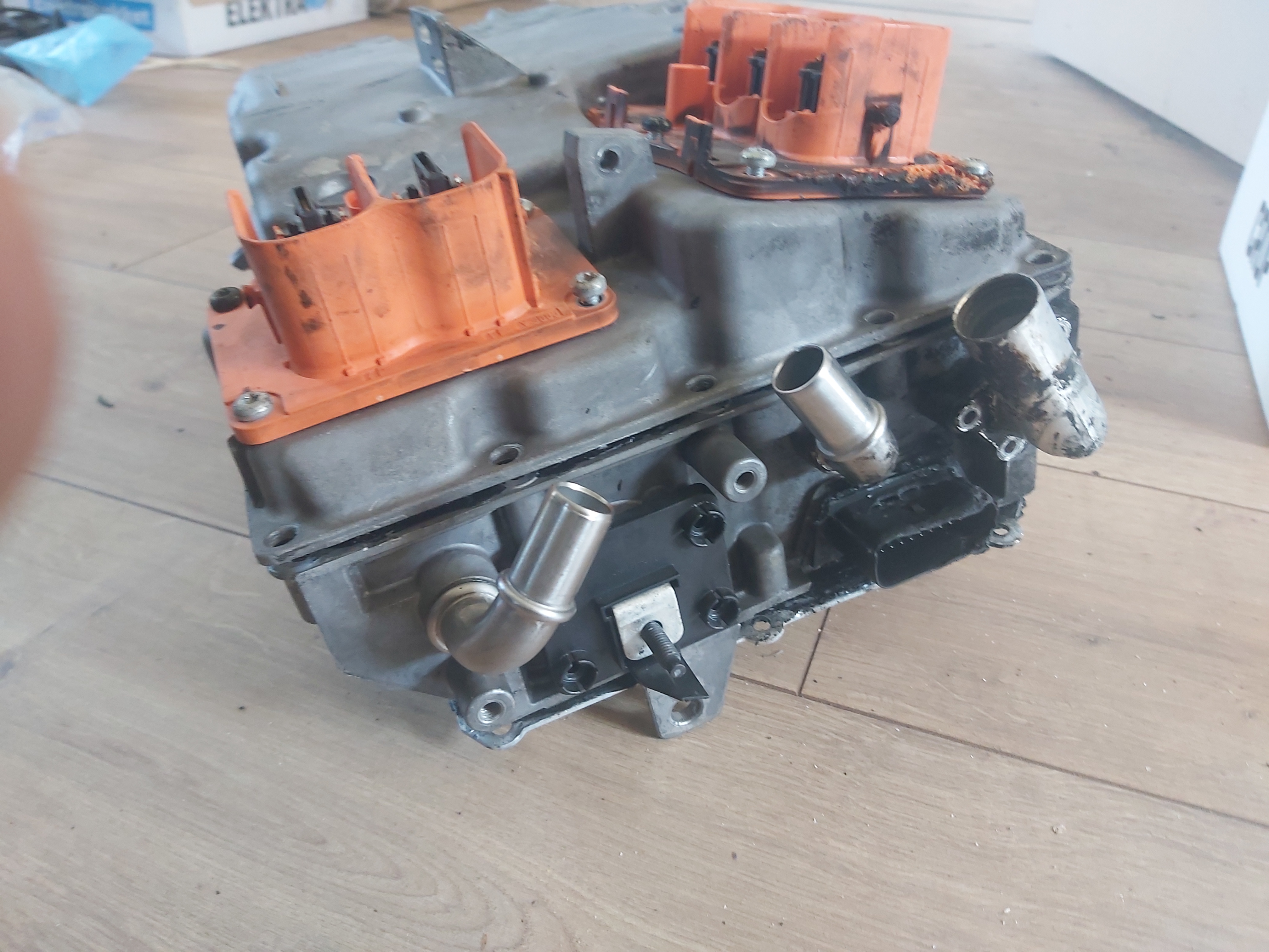

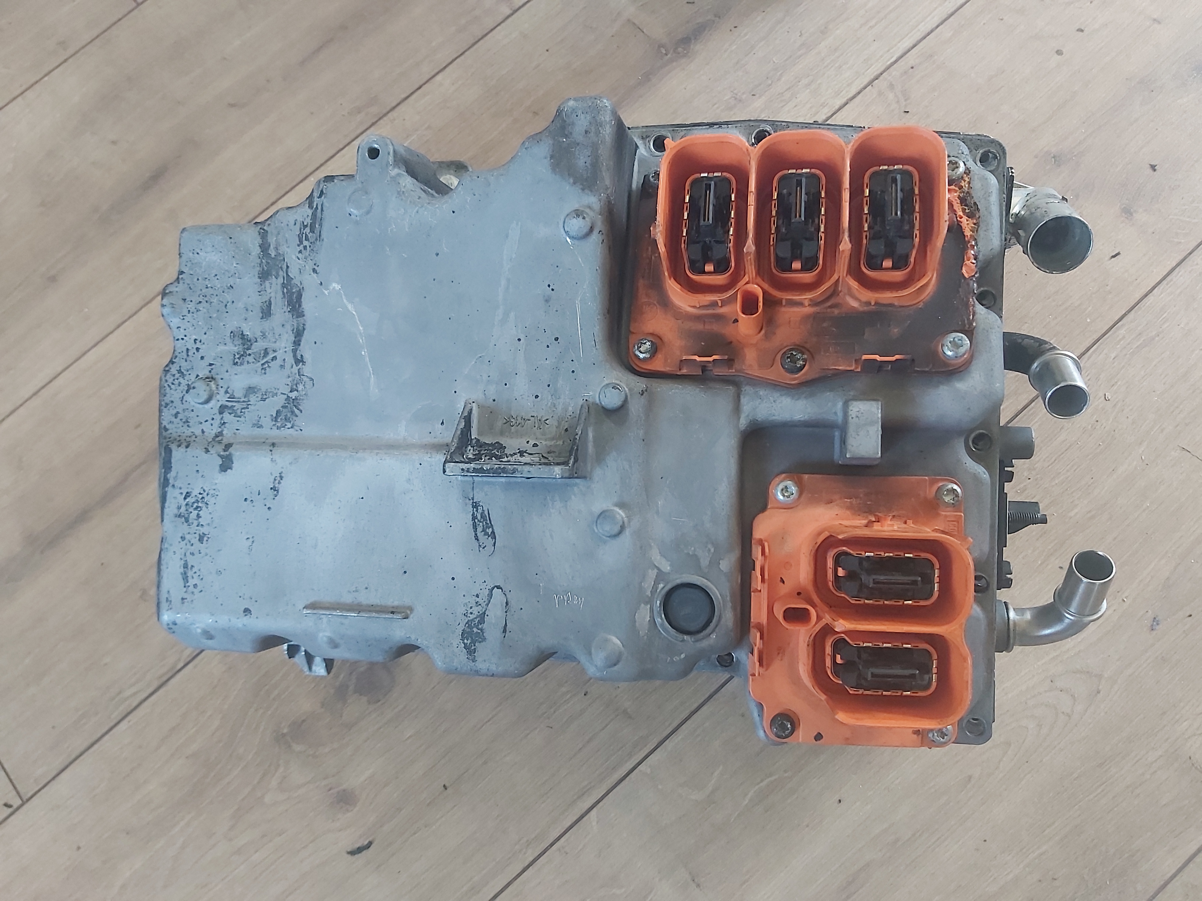

Bought a slightly crispy Volvo XC90 (2015) inverter from a car breaker. My plan is to replace the controller board.
The inverter is specified for 65kW and also includes the DCDC converter.
The battery and motor connectors are on the bottom if the inverter sits in the car.
On the side there is a low voltage multi pin connector, a low power HV connector and a B+ post. think the case is used as the ground connection.
With the lid off we can see the control board on a bracket and the DCDC converter below.
There are 3 smale 2 pin connectors for the HV interlock. A short flatflex cable for the DCDC converter. and the big connector for the inverter.
After removing screws from the DCDC converter side, the case can be split and reveals the inverter.
The inverter board and the DC Link capacitor come out as one unit. the capacitor is connected with 6 screws.

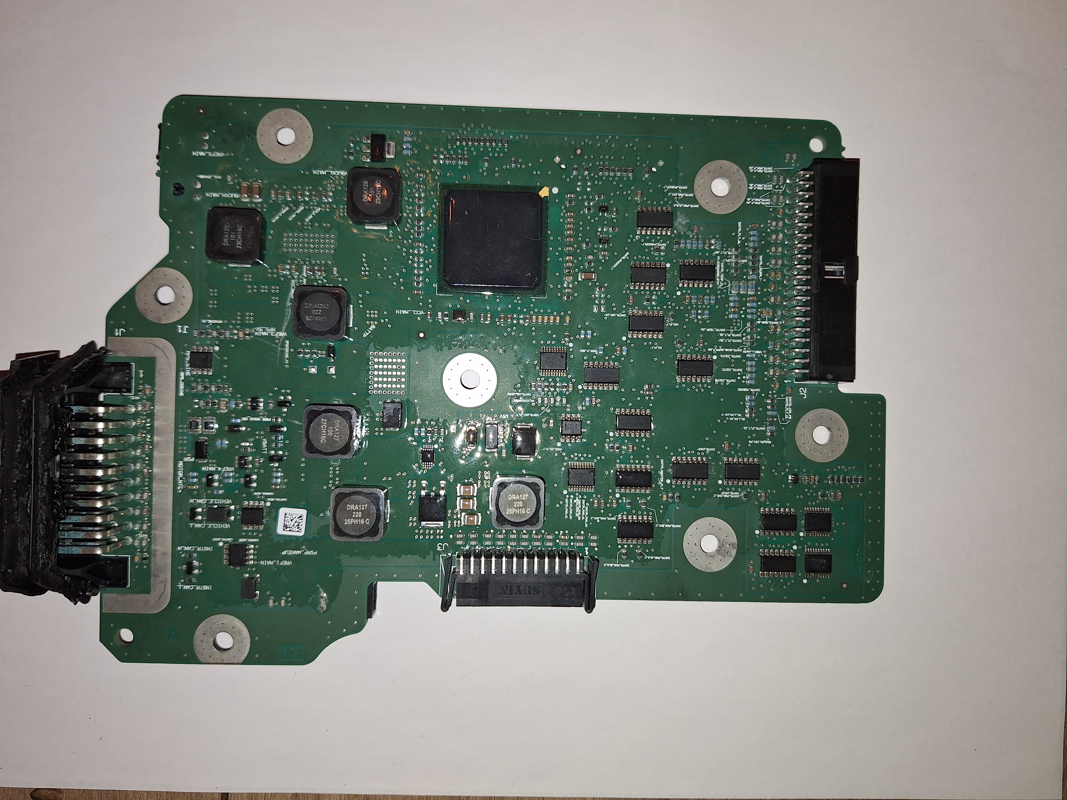

will start with the inverter connector pinout reverse engineering.

Got 25 wire of the 40 figured out.
The current sensors, temperature sensors and gate-divers.

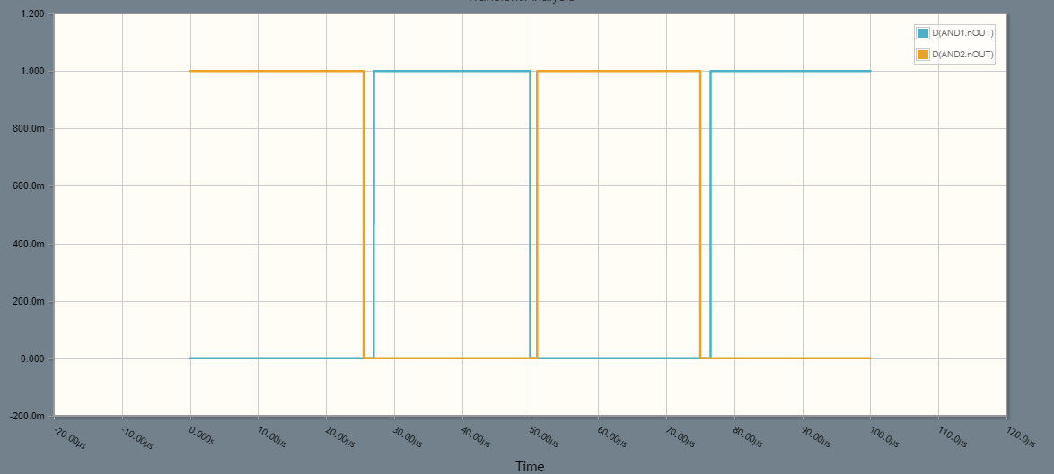

This whas a big job to figure out. Started out with a wrong assumption that the 3 chips where the same. One of them turned out to be a inverter chip instead off a AND gate. This circuit is a hardware dead-time generator.
This is the output from a simple simulation of the dead-time circuit. Capacitor values are a guess, I couldn't measure them on the PCB.

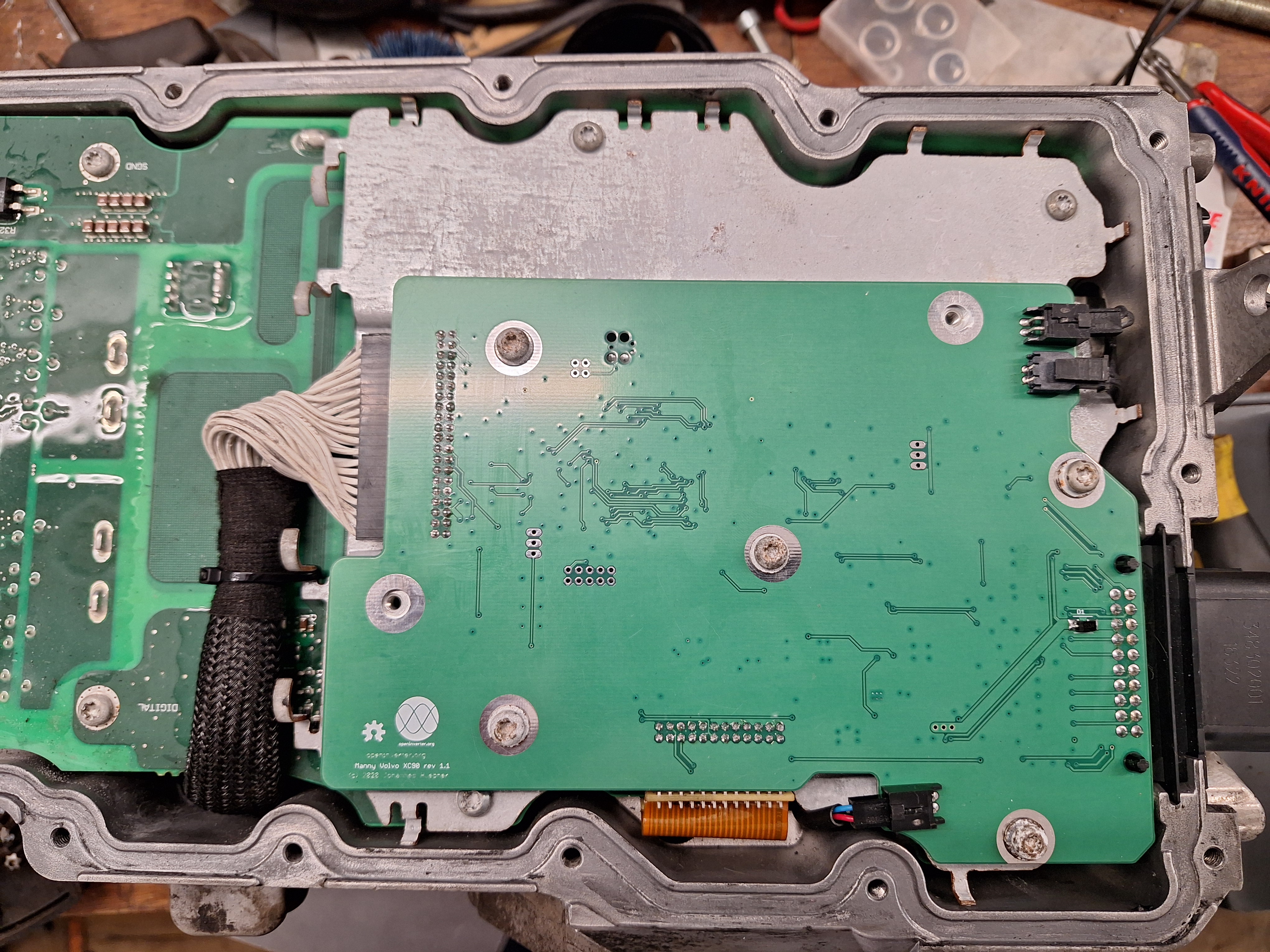

After a couple of long nights V1 board is done
:D looks similar :D

PCB are here!
After desoldering two DC-DC converter boards for parts and transferring them to the new PCB. The power supply whas tested before I placed the other components. The 5V line whas 1.25V at first power up. The LM2596 I got is the adjustable type and not the fixed 5V one. :?
Added a couple resistors for now. It will be replaced at some point.
The inverter uses a 15V feed so I changed the DC-DC converter from the original design to a more powerful one.
This DC-DC converter is powered from the 12V instead of the 5V like it is in the original design. So I replaced it for a sepic type so it will work from 5V to 32V.
First problem: The capacitors are to high so the pcb dose not fit in the inverter housing. Will find some lower ones.
but first more testing to find out if there are more problems.
It looks a lot better than the prototype :D

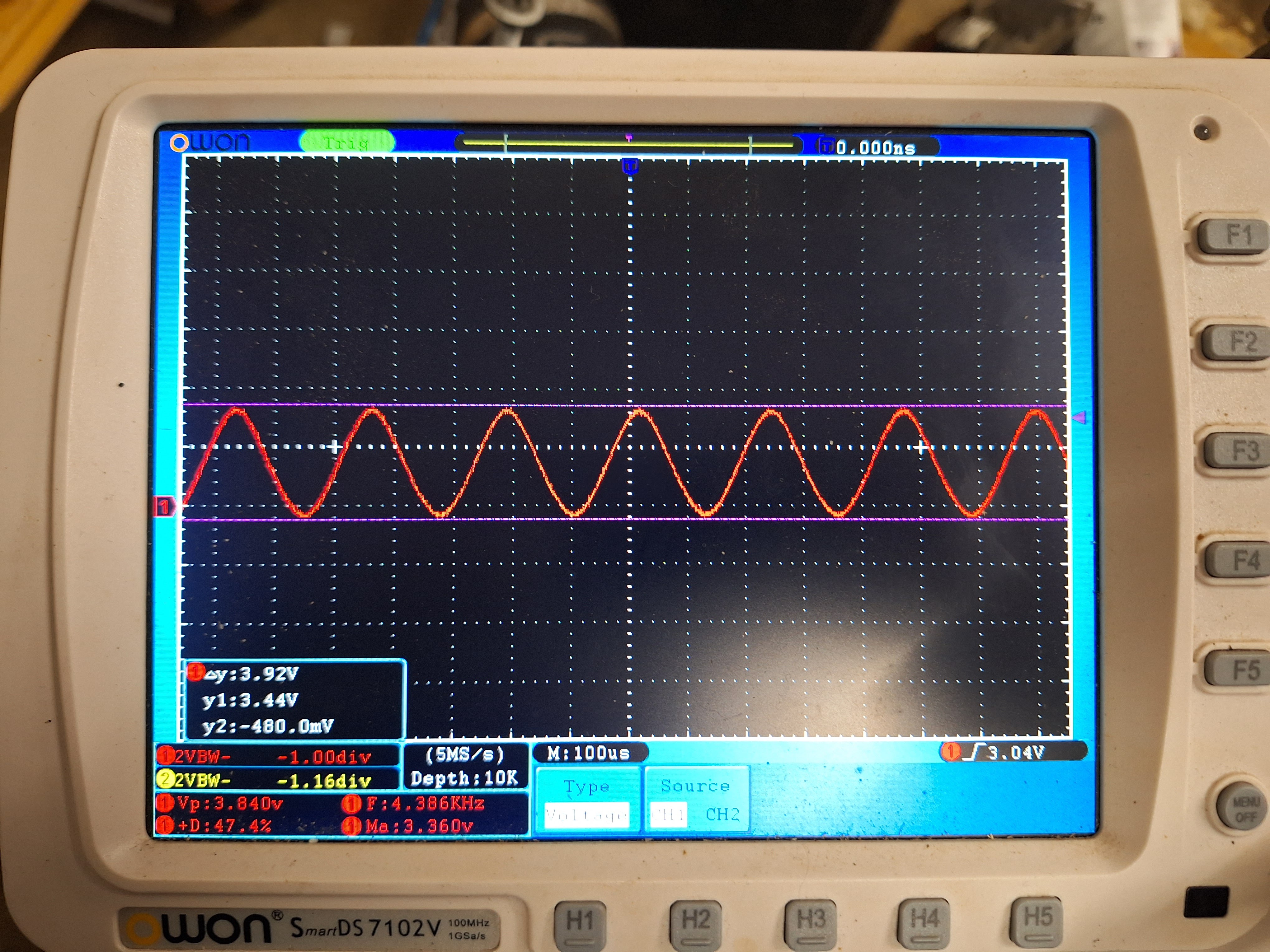

IT RUN'S !!! 8-)
Got the motor running on a 30V 5A power supply. I have the syncofs roughly set.
Changed R46 from 10k to 8k2 to lower the excitation signal. When I put the scope on the sin or cos lines the signal oscillated between -0.5V and 3.5V. I don't think that will be great for the FOC software that the sin and cos signals are clipping the ADC. After the resistor change the voltage stayed between 0.3 and 3.0V, much better.
The first connections I tried for the resolver did generated a good looking signal on the plot. But could not spin the motor with id current. After swapping the sin connections on the motor it spins with a couple of amperes.
The temperature sensors on the motor measure 104 ohm at 7°C. So maybe a pt100. Will check by running some hot water through the motor and checking the resistance.

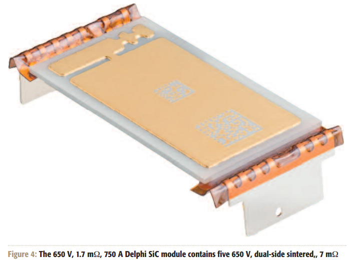

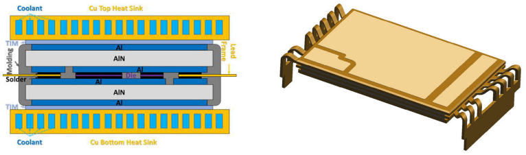

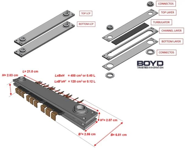

Today I spend multiple hours online to answer the question how much power can the inverter take.
With google image search I looked at a LOT of IGBT modules. At some point I found this.
This type of cooling is called Double Side Cooled (DSC).
searching for DSC module I came across this
The Borgwarner Viper looks like the module in the volvo XC90 inverter.
Looking for Viper modules I landed on the Borgwarner's website. Look what they make
https://www.borgwarner.com/technologies ... onics#cidd
We are getting somewhere. After some more googling I found out that Borgwarner at some point bought Delphi how made the viper module.
Strike!!!
In a IEEE paper comparing DSC modules
https://ieeexplore.ieee.org/stamp/stamp ... er=9769770
As far as I can tell its a 650V 500A IGBT module.
Later found this so maybe 750A
https://www.power-mag.com/pdf/feature_p ... eature.pdf
Anyway I am pretty sure it will handle the 65kW I am looking for.
