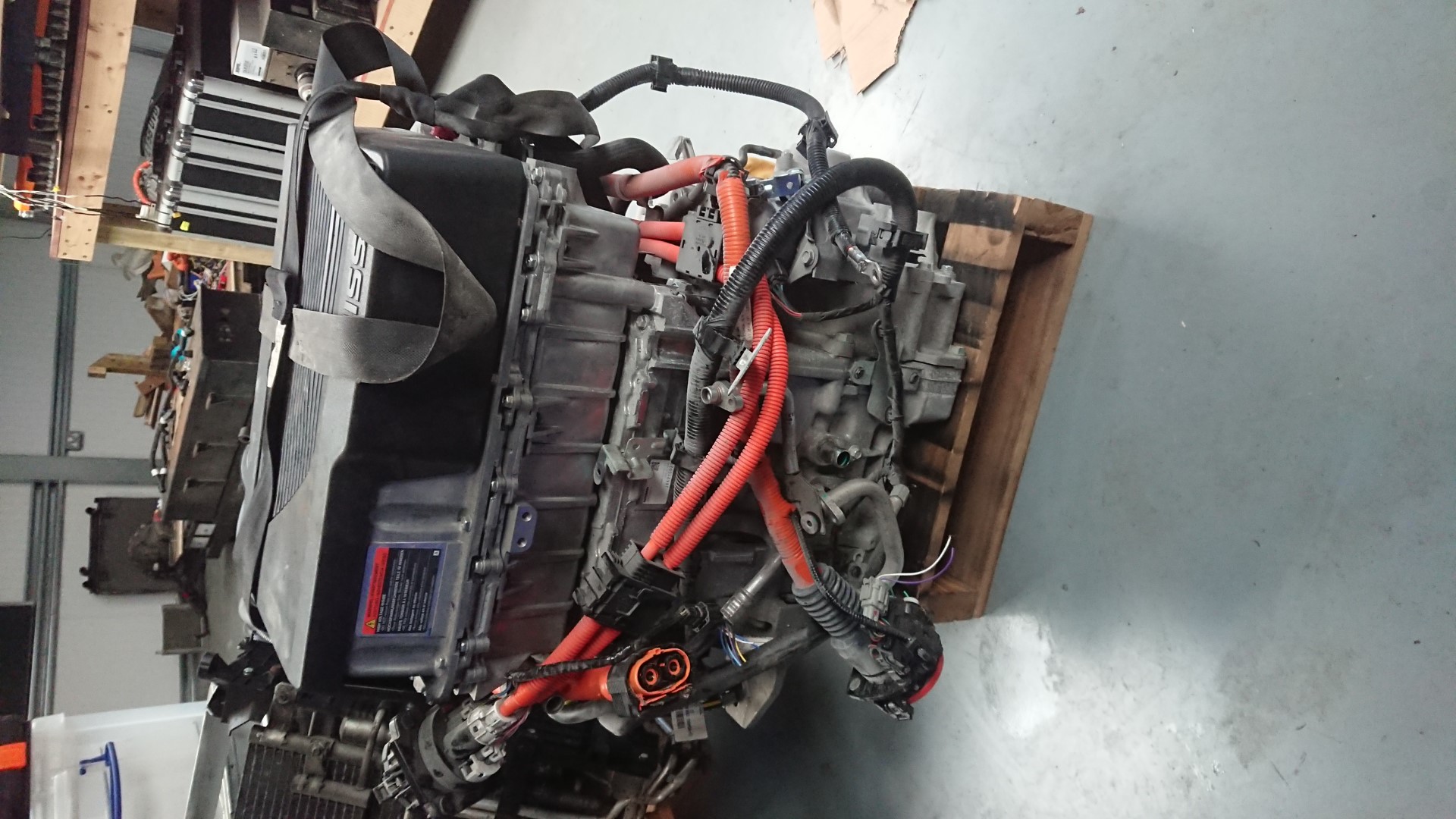

Picked these up from a local mechanic who's moving premises so needed to sell off some parts. I'm not that familiar with the Leaf stuff, is there a way to tell what kW these are? I'm presuming 110kW as they're 2018.
3 full stacks with the 6.6 charger, type 2 and chademo charge sockets, A/C compressor, gearbox etc. Maybe someone in Ireland thinking of a Leaf stack for their project, let me know :)

Yes 110kW stacks, you can see on the inverter part number.
291A0-5SA0A = 110kW inverter
291A0-5SN0A = 160kW inverter

Only difference found between 110kw & 160kw is the main controller in the inverter.
viewtopic.php?p=45803&hilit=160Kw+and+one+110Kw#p45803
The Open Inverter control board for a gen. 3 leaf inverter is being tested now, viewtopic.php?p=64365#p64365
Based on the info in the first link, the gen 3 OI board should allow 110kw inverters to make at least 160kw. This needs to be proven though.
