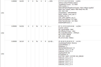

Just testing the Fwd/Rev power and the latest trial mod is excellent with plenty of power in reverse.
On the Leaf drive unit application I feel that the Throtramp units of %/10ms should ideally be %/100ms as I have it set to 1% and still is pretty fierce with easy wheelspin in Fwd on my front wheel drive 106 running on 260v.
Parameter limits are 1 - 100.

Okay it would be worth looking at then, will have a review of code. Timing cannot change, the task is ran every 10ms so possibly add decimals below 1.
Yes provide a CAN log confirm the behaviour now in reverse.

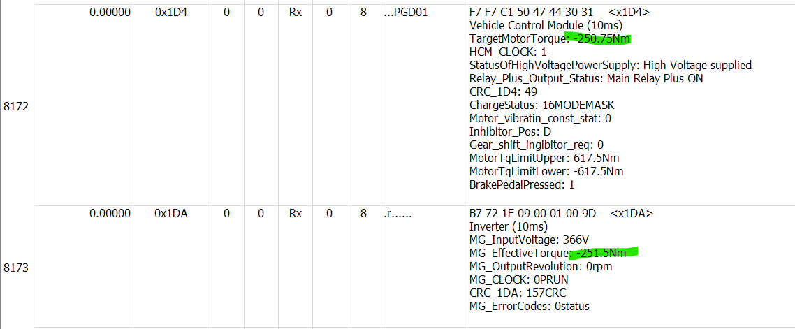

Houston, wehave TORQUE :D
I did this test just by holding against the brake and vehicle not really moving. Now we have symmetrical torque :)
CAN trace from the test
FWD_REV_160325-1203.csv
(1.02 MiB) Downloaded 494 times
Parameters
params_160325-1154.json
(2.27 KiB) Downloaded 562 times

Tested the car running Fwd for a couple of seconds then reverse up a steep slope. Loads of power in reverse but fully controllable.
params (13).json
(2.27 KiB) Downloaded 552 times
Fwd_Rev_test.txt
(1.68 MiB) Downloaded 483 times

Can one of you please do a free run of the motor with reverse gear selected in the Zombie to see what motor rpm it limits at.

So the RPM limit in reverse seems to be about 3500
CAN log:
NoDS_WOTinR_Filtered_11A_1D4_1DA.csv
(183.9 KiB) Downloaded 562 times
Params:
params_231TH_180325-1711.json
(2.27 KiB) Downloaded 473 times

tom91 wrote: Tue Mar 11, 2025 11:54 am Okay so made both limits the same lets see what that does. Make sure not to break anything.
https://github.com/damienmaguire/Stm32- ... 6c70b2aa69
Hi, Tom,
Having same issue, reversing with foot on the ground. Should I try to replace the [1] byte and recompile? My SW is 2.22a

Why are we still saying to the leaf motor that we are pressing the brake pedal while driving?
In the 0x1D4: Brakepedalpressed =1
Also if there is same torque limit both ways, will it mess with the regen?
From Leaf OEM display, regen goes to about 28kW in B mode:
2014 leaf gen2 display for motor power kW

JaniK wrote: Thu Aug 14, 2025 6:50 am Why are we still saying to the leaf motor that we are pressing the brake pedal while driving?
No idea it seems to have no impact on the inverter.
JaniK wrote: Thu Aug 14, 2025 6:50 am Also if there is same torque limit both ways, will it mess with the regen?
Yes this is why its now removed in the vehicle testing branch and will be added into a release upcoming.

Fix implemented in the release now to remove the reverse limiter sent over CAN to the Leaf inverter.
