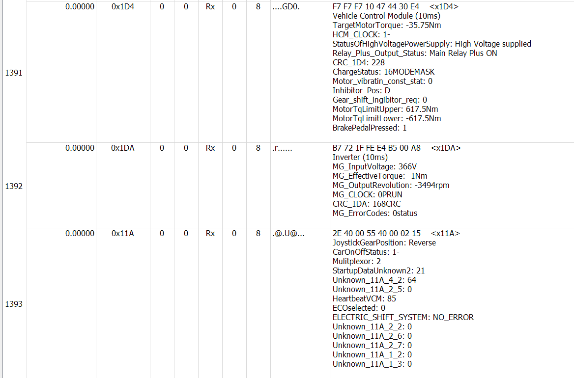

So the RPM limit in reverse seems to be about 3500
CAN log:
NoDS_WOTinR_Filtered_11A_1D4_1DA.csv
(183.9 KiB) Downloaded 598 times
Params:
params_231TH_180325-1711.json
(2.27 KiB) Downloaded 500 times

Why are we still saying to the leaf motor that we are pressing the brake pedal while driving?
In the 0x1D4: Brakepedalpressed =1
Also if there is same torque limit both ways, will it mess with the regen?
From Leaf OEM display, regen goes to about 28kW in B mode:
2014 leaf gen2 display for motor power kW
Posts: 2962
Has thanked: 328 times
Been thanked: 847 times
Re: Leaf full stack not reversing properly
JaniK wrote: Thu Aug 14, 2025 6:50 am Why are we still saying to the leaf motor that we are pressing the brake pedal while driving?
No idea it seems to have no impact on the inverter.
JaniK wrote: Thu Aug 14, 2025 6:50 am Also if there is same torque limit both ways, will it mess with the regen?
Yes this is why its now removed in the vehicle testing branch and will be added into a release upcoming.
Fix implemented in the release now to remove the reverse limiter sent over CAN to the Leaf inverter.
