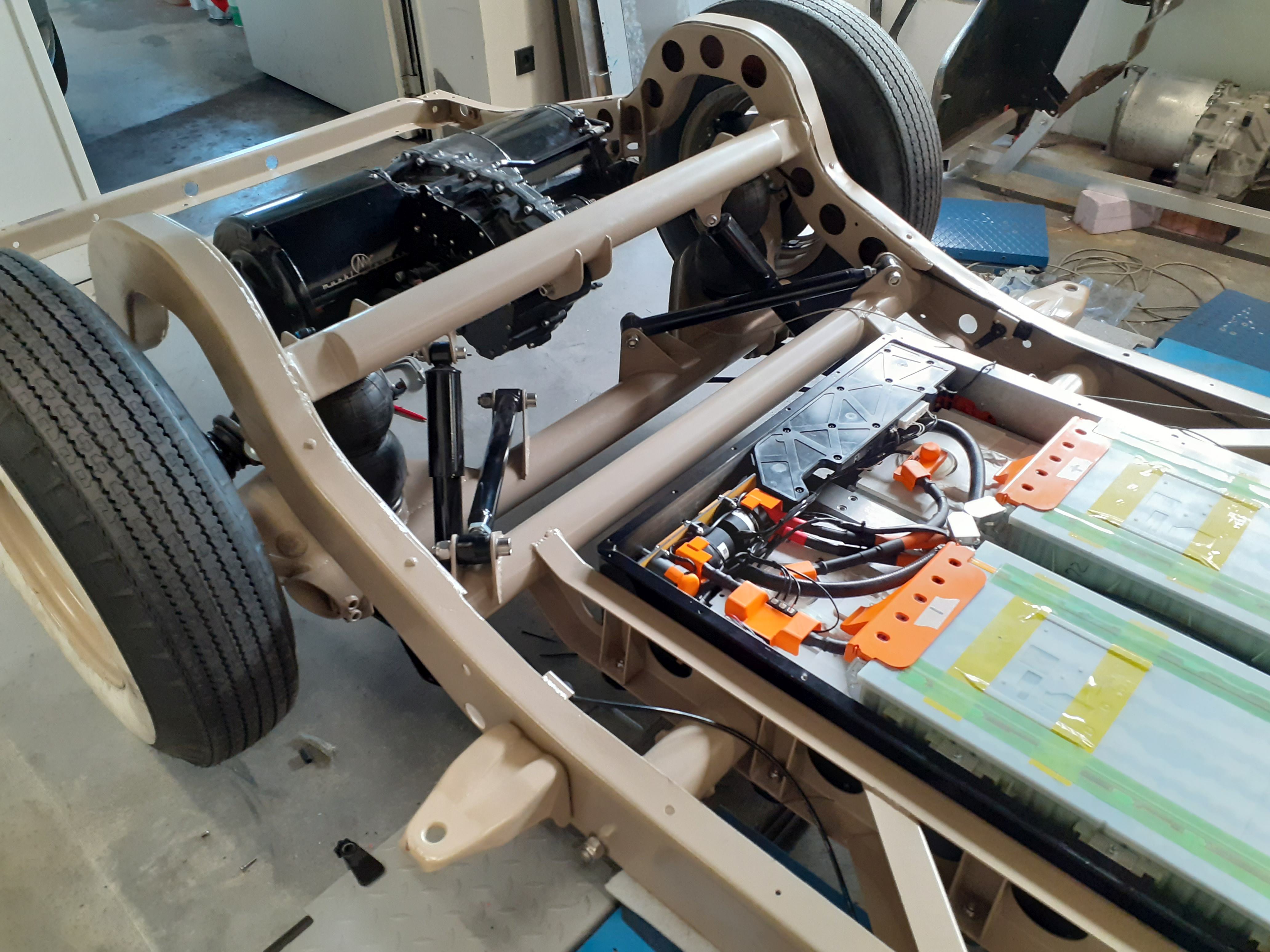

Re: [WIP] Voltswagen T2 -76
Getting back to this.
Final mount sandblasted, powder coated. Motor has been mounted!
3D-printed some endcaps for the crossbar to keep dirt and dust out. With my own Ceravan logo, of course.
Sketching out mounting places for all the rest of the parts. I think inverter fits well somewhere on the shelf where the gas tank used to be, maybe HVJB next to it. Tesla M3 PCS fits perfectly behind the motor.
I should start looking into options with the charger etc. I have both the Tesla M3 PCS and the Leaf PDM. Currently leaning on using the M3 PCS with the M3 BMS and other components I got with the pack which as far as I understand saves me from Batman scavenging etc..?
Ah well. Need to study more.
Meanwhile did rest of the brake lines finally, too.
I had some ideas about using pressure switches with T-fittings to do original style brake light switch + brake warning light, but ended up just running the lines straight to the master cylinder at least for now. I don't fancy the idea of extra T-fittings in the lines, weight of the sensors and all the brake fluidy mess if they ever need replacing. Seems easier to install electronic switch somewhere in the linkage for brake lights.
As for the warning light in the dash, which I want just in case, I got a fluid reservoir with the level sensor which I deemed far smarter way of doing that than the pressure switches in the lines. I kind of want to know there's an issue with the brakes *before* the lines have no pressure.
I think fluid level sensor in the remote reservoir makes most sense; if there's ever an leak somewhere, hose between the reservoirs gets detached, something horrible, then the reservoir level will go down and light up the warning light while there's still plenty brake fluid in the smaller reservoir on top of the master cylinder etc.

The Tesla M3 PCS is NOT waterproof, so I would re think its location and house it in something.
Vaguely planning...
Would something like this be outrageously dangerous for the EM57 phase connectors?
I'd much want to avoid putting anything on top of the motor now (where the phases typically stick in from) as the space is tight and the whole thing is rubber mounted and therefore free to move slightly, which cooould squish the connector built on top.
But it has the side hatch for tightening the bolts.
And since I can 3D-print and lathe, I could relatively easily print out a Nylon "sleeve" for some round copper bars with holes in the middle, then use longer bolts to connect the cable lugs to the internal busbars. Sleeve for isolating the copper rods from the motor body and stabilizing them so no bending forces would be transmitted to the internal busbars.
After that it'd be just a matter of sealing of the top and printing a weatherproof case for the new connector?
As these would be only a couple of centimeters long so I'm not concerned about conductivity within the material, but the only thing that worries me slightly is that normally the inverter busbars are squeezed in there between two flat coppers, so contact surface is much more than what this would achieve seeing the round rod would only contact the busbar on one side...
Since it's HV and I lack sufficient qualification, hivemind please help am I being stupid or is this actually viable way out of my problem?
Thanks in advance!
I'll let others comment on the safety, but if you do this I'd be interested in a similar setup if you're happy to sell one on? Thanks
My thoughts on the safety is it's probably fine. Provided you get good connection. The bolt will pull everything tight, so provided the faces are clean you should have the same amount of copper (or more) than originally when compared with the original busbar.
You may bump into issues with your vehicle inspection if they are strict on the emi side of things by using external wires vs internal busbars. That aside, I believe this can be done safely.
This is what pops into my head I drew the phase wire section a bit too tall, keep it short but effective to not get into vibration induced fatigue / failure where it overhangs. If you get the spacing right you could use a silicone to seal the wires to the adapter & cover. If you're really good you could do some thick orings and grooves for them and avoid the silicone mess.
And if you do nylon internally and for the cover you could print a 3rd piece / thin orange cover for the color / safety side of things.
You could also flare the standoffs on the inside to make better connection if needed / worried. Keep the gap between the busbars as your safety gap, unless they had a non-conductive wall between them. Then you need the divider to achieve the same effective air gap or a larger gap.
Simpsons did it
As this is basically a reiteration of something that exists, why not take a look how one implementation has been made and see how to adapt/improve the design from there?
Oh! Hey yes that's pretty much exactly what I had in mind!J0hannes wrote: ↑Thu Jun 26, 2025 2:41 pm Simpsons did it
https://inductiveauto.com/product/nissa ... 25VsPEtW-K
As Cera is from Finland, I don't see an issue on the emi as current rules for conversion don't really ask much regarding that if the vehicle being converted is old as this Voltswagen is.
Yeah I don't think EMI restrictions/rules apply to 1976 here, so should be all good inspection-wise.
Yes adding spacers like this between the wires sounds good. I might just steal the idea of using those threaded cable passthroughs used in the linked product for waterproof connections.jrbe wrote: ↑Thu Jun 26, 2025 11:56 am This is what pops into my head I drew the phase wire section a bit too tall, keep it short but effective to not get into vibration induced fatigue / failure where it overhangs. If you get the spacing right you could use a silicone to seal the wires to the adapter & cover.
Yeah I think this should be doable.
There's a protrusion from the motor case just below the rearmost phase in my setup, which necessitates longer copper and bolts, currently around 80mm length. Could shave off some 1.5cm from that if I could bypass that screw protrusion somehow. Oh well.
But anyway with this my phases would end up looking something like this:
(I'm learning how to use Sweep -tool in Fusion
I can also attach the wiring to the motor mount I made previously, as I understand EU directive requires bolting down HV wiring every 20cm or so.
SO. MUCH. WIRING.
Making the main harness.
12V battery, etc are located in the rear. Main fusebox is in the front below dash. I'm upgrading the original 1970's wiring diagram slightly.
- Adding main fuses (Midi 50A) to battery positive so no wire goes unfused. Original schematic has no protection for shorts in the main harness before the dash fusebox.
- Original wiring uses 1*6mm2 from battery to front and 1*6mm2 from front ignition back to rear for starter/cranking. I'll be keeping 2*6mm2 but using both for feeding power to the front. Double the capacity, less voltage drop.
- Instead of feeding all the main fusebox current through ignition lock, I got a cheap-ish AEV14012 to use as a main contactor, controlled by the ignition lock. Slightly overkill for 12V but hey, you use what you find.

Hmm. Might also be getting 2nd (102nd, at least) thoughts about the battery pack.
The more I look the harder it seems to mount the M3 modules safely
darn mechanical levitation!
That added to the imbalance issues some people have been having, BMS support, etc.
Currently as far as I understand it, the original BMS might or might not work with some Batman trickery? I should take yet another look at Damien's videos about these and the PCS.
Orion 2 BMS on the other hand requires soldering all the tiny wires to the slave boards, which looks like a thing I'm unsure if I want to tackle anytime soon.
I might be able to sell the pack locally, then find something "easier to work with" instead. But trying to avoid hasty calls on this. I know some people like brat are running M3 pack so it should be doable. Maybe just a lil bit too difficult for my level and first build.
Just pondering.
Just pondering.

I forget if you were planning to mount under the rear bench seat or under the bus somewhere. You should have the original VW mounting holes for minibus seats in the floor and the seat belt mounts on the angled walled behind that. That’s what I used as the basis for a frame for my box. Can’t remember what level of detail about this I shared in my build thread, but I can dig out photos if it’s useful.
Cera
- Posts: 94
- Joined: Thu Feb 10, 2022 10:08 am
- Has thanked: 46 times
- Been thanked: 66 times
Yeah I have the bench seat mounting brackets and am confident I can find multiple ways of attaching any battery box to the van itself.ianlighting wrote: ↑Sun Aug 03, 2025 7:12 am I forget if you were planning to mount under the rear bench seat or under the bus somewhere. You should have the original VW mounting holes for minibus seats in the floor and the seat belt mounts on the angled walled behind that. That’s what I used as the basis for a frame for my box. Can’t remember what level of detail about this I shared in my build thread, but I can dig out photos if it’s useful.
... But making a battery box for the M3 modules is still pain due to their fragile construction
I've considered multiple approaches from the welded L-bracket frame (which I'm not entirely happy with) to @nkiarnan's plastic inserts inside a steel box (but CNC milling plastic inserts seems to cost a lot). Bottom line seems to be their mounting (inside any box) ends up being more costly and difficult than any of the smaller rectangular modules which can just be laid next to each others like bricks.
Then on top of that, even if I'd go ahead and pull the trigger on the POM-C inserts or something similar, I'm still uncertain about my skills in actually making them work. I've seen some people using them so my impression is that they have to, and *do* work if you know what you're doing, but I'm not entirely sure how people have done that and if it's something I'm comfortable attempting myself since I'm already struggling this much with the "easiest" part (mechanical mounting).
I still don't fully understand what the M3 BMS requires to get it working (and if it's possible to get it working why people choose Orion 2 over it).
But lots of this is me not understanding the battery tech and related components well enough yet. We need some "BMS for dummies" options, pro's/con's and compatibility chart to wiki.
Basically current thinking is; 6000e for the battery modules + 1500-2000e for Orion BMS (and worst case screwing something up when wiring and blowing a module) + 500-1000e for enclosure it's just perhaps not worth it for me. I don't know yet.
Bit of a desperation and frustration mixed in I admit since I've been at this for many years and it'd be nice to finally get moving and batteries seem to be the last big hurdle now.
