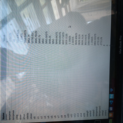

I'm getting incorrect voltage readings on 3 of my boards and 2 dont even power up.
I swapped headers and this may have led to the issue.
I've checked Fet readings and resistors. The 3 working boards I have appear to match the 3 that are giving incorrect readings and the 2 that won't start.
I can flash firmware to all via the STLink, all are running the 0.25.25 FW and see flashing LEDs on all of them after doing so.
I've got continuity from pins and traces seem to be unbroken. I've checked diodes and they seem to be ok... is there any guidance anyone can offer in getting these working again?

Sorry so I've got 10 boards in total.
4 (not 3 as previously stated) work fine
3 give incorrect voltage readings but otherwise appear to operate fine, no errors.
3 that don't power up at all using the 12V connection header (and enable etc.) But can be connected to using an STLink and the LED lights up when connected to and flashes after the FW is written.
I think the incorrect voltage readings were present prior to me swapping the headers.

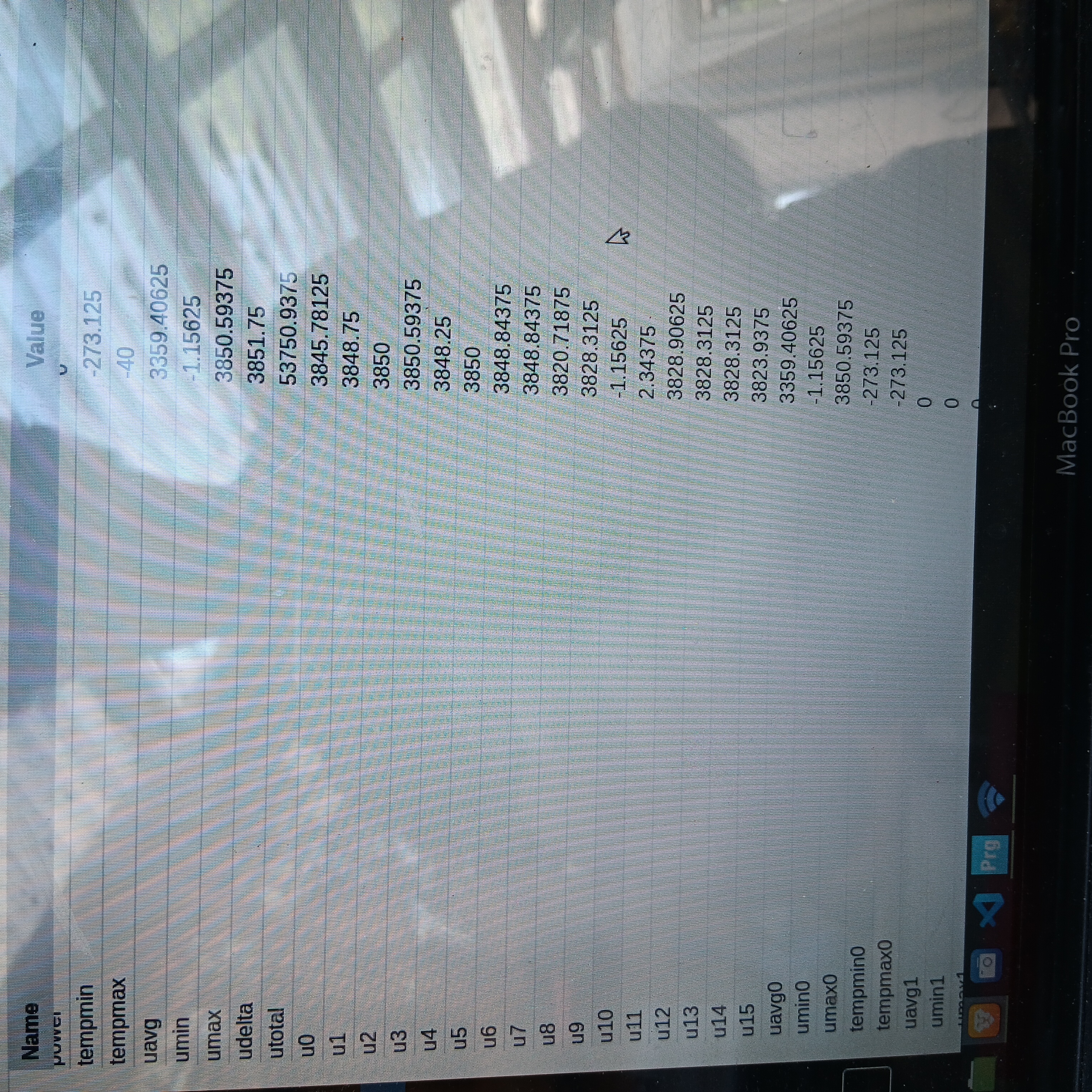

Re: Flying ADC BMS - incorrect voltage readings and two not starting up
Images of 3 of the boards spot values that are presenting incorrect voltages....
U5-U8 U2-U3 U2, U5, U10-U11

Indeed the "incorrect voltage readings" are differently incorrect than discussed in said thread. They essentially read 0. Have you checked whether the cell voltages make it to the board at all in those positions? Doesn't look like failed FETs.
The boards that don't power up must have a broken 5V regulator, I suppose. You can try feeding stable 5V into the current sensor 5V rail and see if they light up. If not it's the 3v3 reg that's broken

ok thanks, I'll check on the boards with the wrong readings, I'd half assumed as I have continuity from the cell tap input to the resistor legs that I should be good but will check voltages also, hopefully its just a dodgy soldering job, I'm 95% they were ok until I changed the header but I'm not 100%.
I'll also check the regulator on the dead boards. Thanks for the guidance!

I've ordered some replacement 5V regulators as I think a couple were broken. I've checked the voltage at the first resistor cell tap leg on one of he board that was giving incorrect readings on 3 cells and the voltage was correct all the way (3.85V).
I'll recheck the fets but I'm fairly certain they all read correctly as oer your instructions on the other thread (0.65V across the Drain to source i think except a couple maybe Q1 and Q5 that read 0.73v)

So, I've found a bit of time to try and get these board running again.
I've got 7 boards that run following fixing D1 (diode) and U11 (voltage regulator).
Of the 7, 4 are giving faulty voltage readings.
(BMS1, BMS2, BMS4 and BMS7). So far I've not run them in series, so I'm just testing with a bank of 16 cells at a time until I can get them reading correctly.
I've gone through all the components on the left of the board (cell tap inputs) and measured each resistor and FET. All but one board appear to be fine (FET readings around 0.6V for most bar Q1 and Q5 which read around 0.7V).
I've checked the boards with a thermal imaging camera and cannot see any particular components that appear too hot, checking the 17pin plug confirms the wiring it correct (3.8Vbetween each pin).
I'm at a bit of a loss as to what next to check and how to check it.
Any guidance or tips of what to check would be great.
Hardware version is V2.1 and I'm running the latest firmware....
