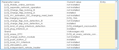

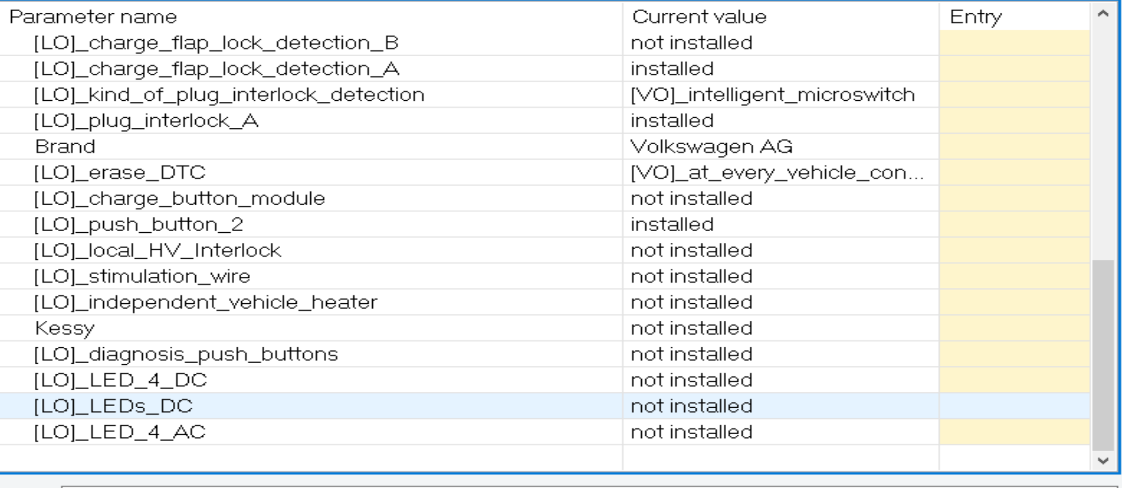

You will also need to spoof the lock feedback signal. I coded it out with ODIS, but it was still expecting it and causing a fault.

Can you take a snip of the coding values in ODIS (The list of available options?)

I have the stock set-up with the flap locking mechanism and LED push buttons. If I reset to factory settings, the lock fault is erased, until I activate it again. I have a type 2 charger plug connected so normally there is no over run of the locking actuator.

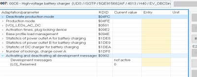

I don't see any actual values in VCDS relating to the maintenance or pilot lines, and I have yet to find anything relating to them in the CAN messages. Their voltages do not seem standard either. But in a normal oem setup, either of these signals would flag a fault and cancel any charging. I'm thinking of putting 100kOhm resistor on each line and connect to positive to see if there are any changes.

Use ODIS. The signals and faults are listed there

I'd use ODIS and see what you get for the plug resistances for the locking and temp sensors.
Confirm they're coming in on the A channel and not the B channel.
In some wiring diagrams it seems they use the B as the primary channel.
I'd also confirm that they need to be connected to the 12V rail, been a while but I seem to recall that the resistances are all based off of a ground connection.

Seems my previous message did not get sent. My resistances are all internal and connected directly between OBC & Locking actuator.
The resistace values add up to Damiens initial testing values.
I think the OBC is in fault mode & just locks the actuator - because when I connect up my Arduino with Damiens code, the actuator locks & unlocks a few times. To me that indicates that the messages are getting received by the OBC.
Un-coding the lock, causes the charge sequence communication between OBC & Type2 charger to not function, so I coded the lock back.

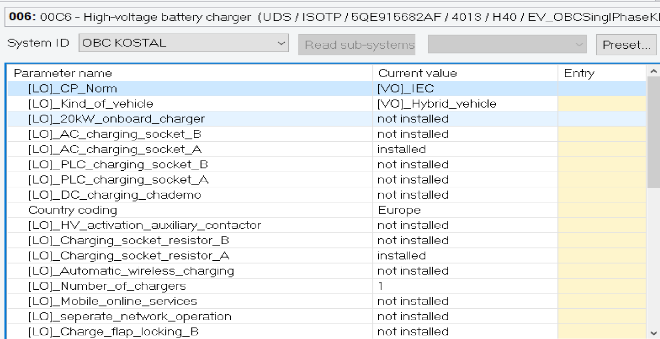

In your sketch, some of the ids are in decimal, but notated as hex.
for instance your BEM_05 has a ID of 0x869, but it should be either 869 (decimal) or 0x365 (hex)
Is your charger coded for a EV or Hybrid? If it's coded as a hybrid, may be worthwhile trying to code it as an EV (or vice versa)
