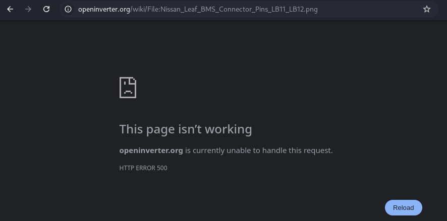

Seems like most of the pictures getts http 500 errors on the openinverter wiki when you klick on them, is that related to this in any way?
/Linda

Thanks for pointing that out. That must be caused by one of the recent updates though. Am looking into it.linda.ljungdahl wrote: ↑Sat May 17, 2025 3:54 pm Seems like most of the pictures getts http 500 errors on the openinverter wiki when you klick on them, is that related to this in any way?
The forum runs on a hired server somewhere in Germany, so can't play with the hardware. I assume the PFSense Firewall could be installed on it?

I installed MediaWiki 1.43.1 now and disabled the newly installed SemanticBundle (viewtopic.php?p=82317#p82317). This was the last alteration 10 days ago and I'm afraid it may have broken things. The installation was very intrusive.
