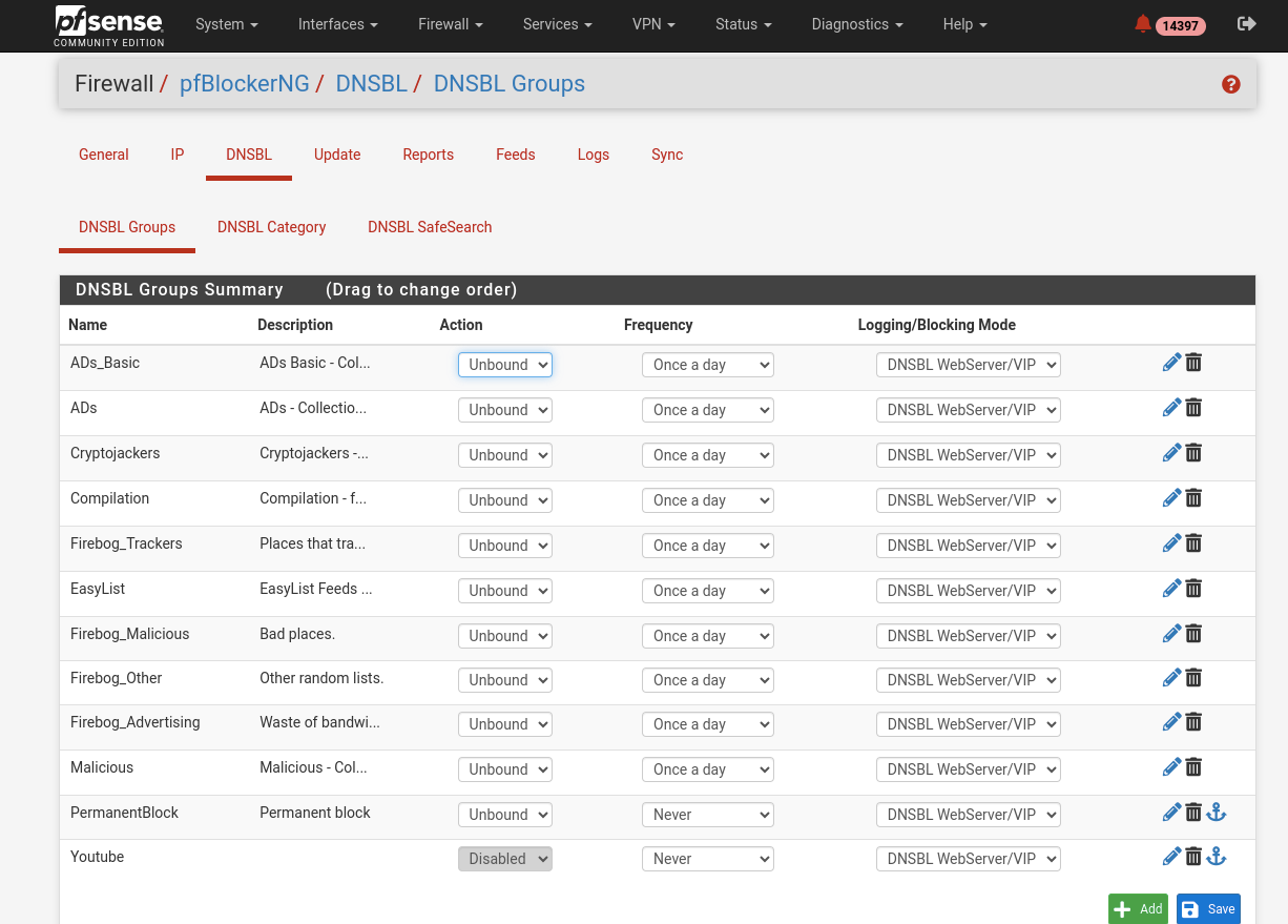

If that server is at home you can install a PFsense firewall - Free software and then you can have lists added to known bad servers or IPs.
You just need a computer with 2 NIC cards
these are some of my lists.

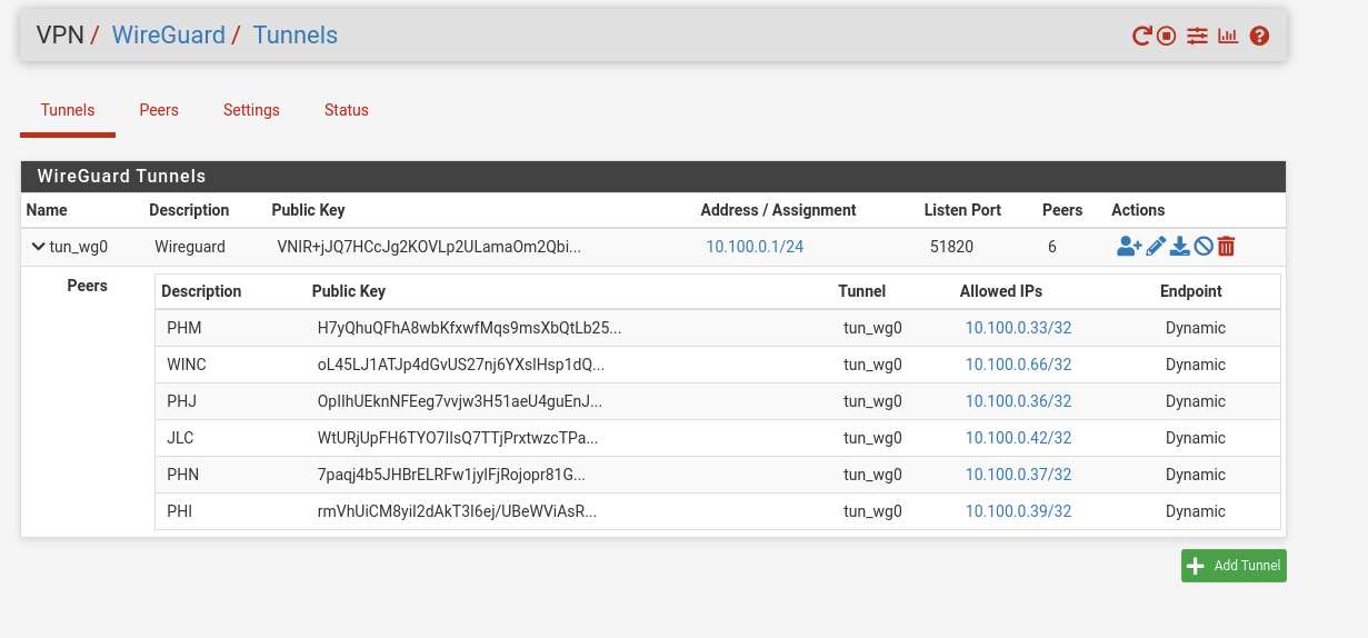

you can also have VPN tunnels from you phones or PC to send all traffic back home through your firewall. All phones in my family send all traffic back home tunneled . that way you can connect to any wifi hotspts and nobody can see your traffic.

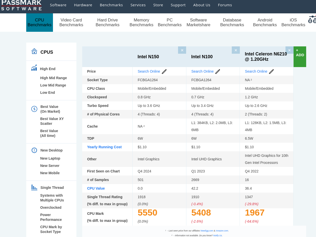

You just have to compare the processors to see what you need.
they all use about 6W but the n150 has more power.
