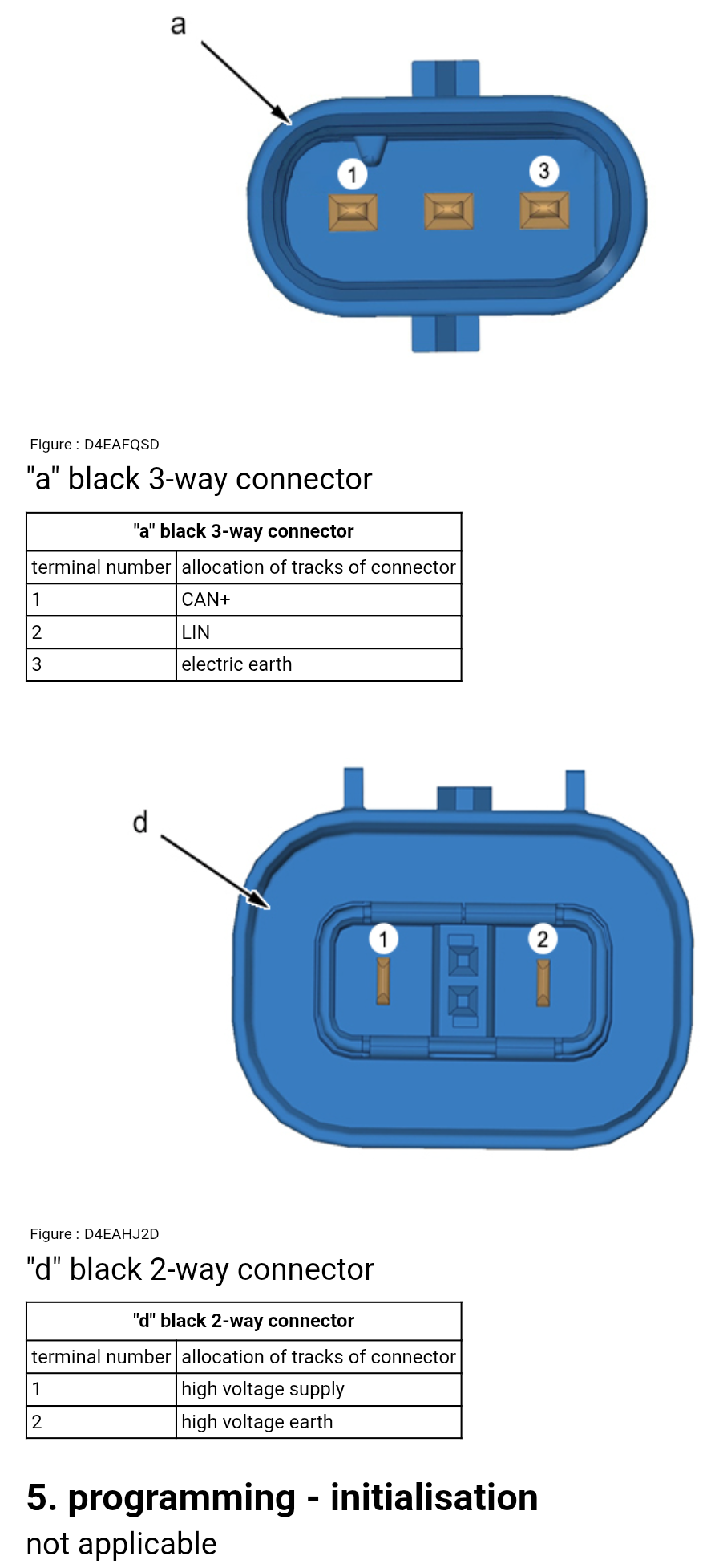

Cool! You wouldn’t happen to have come accross a pinout of these, would you? I have tried and failed to find one in the past…

4F0973703
Also available as a pigtail for those who don't trust their own crimping ability

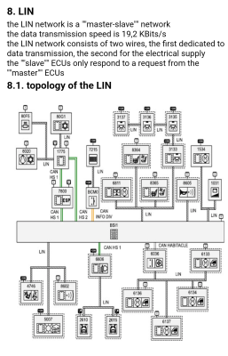

What is the other component on the same network? AC compressor or a pump?
GeneralScanner
Posts: 25
Joined: Mon Jul 18, 2022 11:41 am
Has thanked: 13 times
Been thanked: 10 times
Re: Lin heater logs from e2008
Post by GeneralScanner »
8020 is the a/c compressor
1775 is the "electric drive train supervisor ECU".

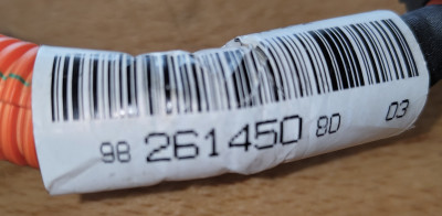

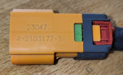

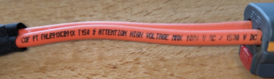

My HV wiring just rocked up.
Part number 4-2103177-1 for the housing.
A TE HVA 280 apparently.
Stellantis part number is 9826145080 and has two of these connectors on either end of a pair of cables. The hvil appears to be internal to the plug (can't see any external LV wiring) .
Back of plug to back of plug is 30cm

It also is a nice and readily available connector which is a bonus.
https://www.te.com/en/product-4-2103177-1.html
Note this is just the housing not a full set with crimps, backshell and seals.
