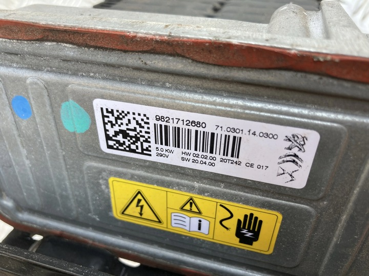

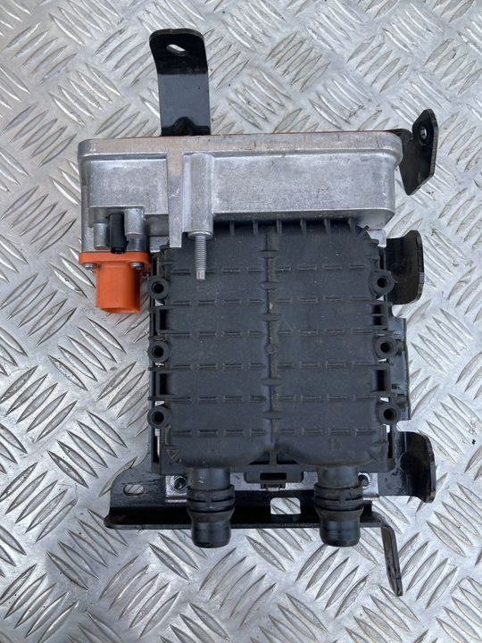

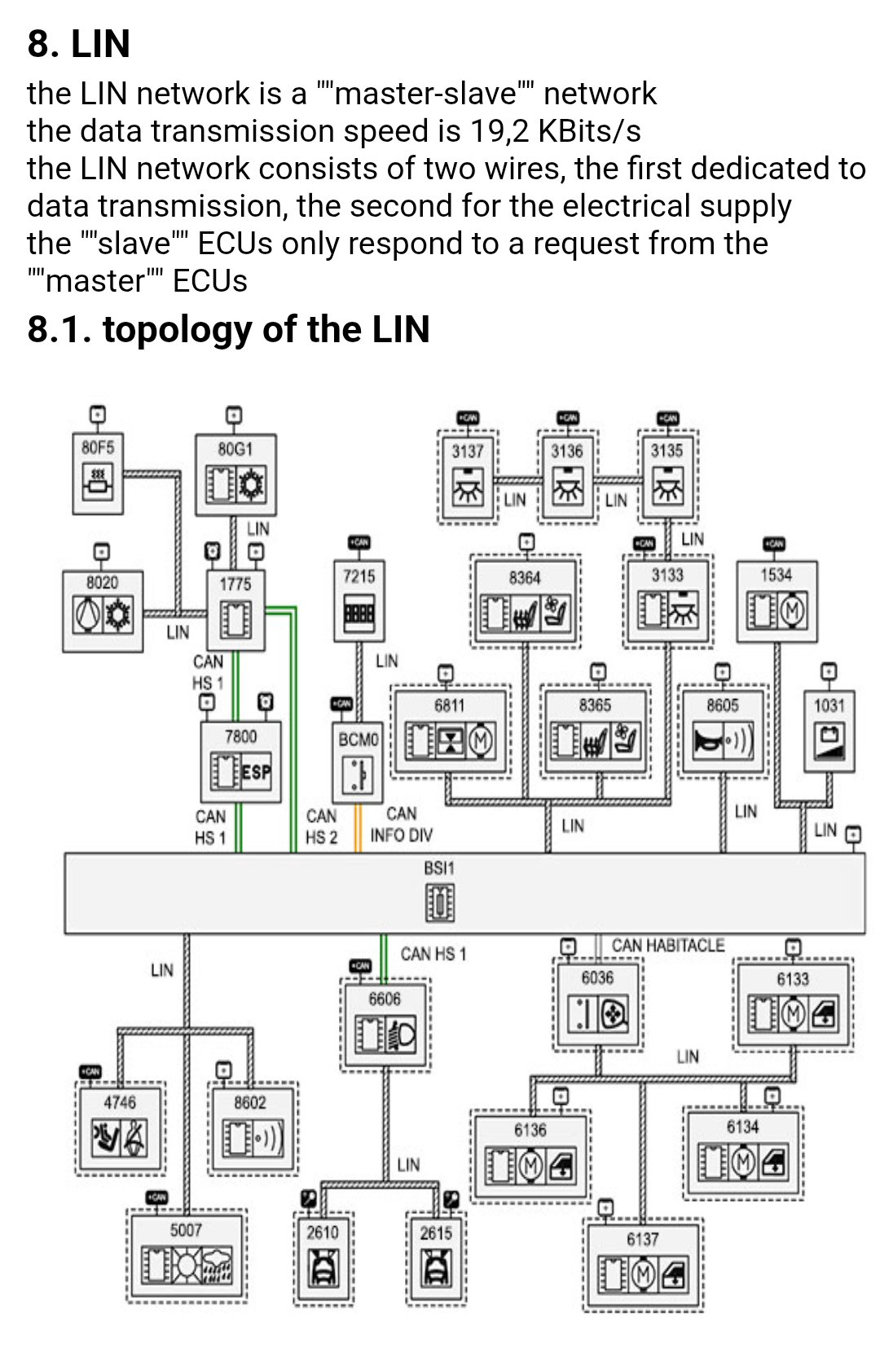

I have some Lin logs from my missus's e2008
From the heater and I believe a/c Lin bus this runs a 5kw eberspacher heater.
I started the log full hot I believe then full cold then full hot again. I did verify the heater hose were getting warm.

One of these?

Yep

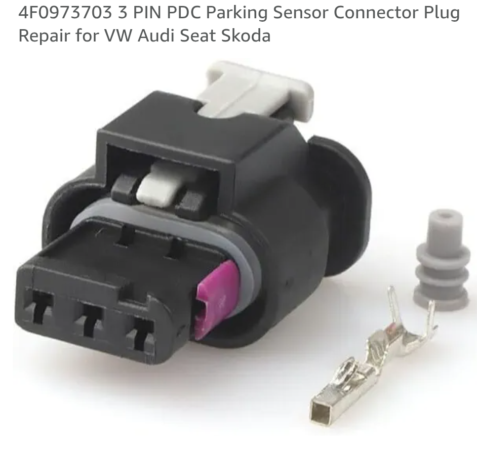

Cool! You wouldn’t happen to have come accross a pinout of these, would you? I have tried and failed to find one in the past…

4F0973703
Also available as a pigtail for those who don't trust their own crimping ability

Brilliant! Very thanks, much clap 👏!

Heater is 80f5
Posts: 2962
Has thanked: 328 times
Been thanked: 847 times
Re: Lin heater logs from e2008
What is the other component on the same network? AC compressor or a pump?
GeneralScanner
Posts: 29
Joined: Mon Jul 18, 2022 11:41 am
Has thanked: 14 times
Been thanked: 18 times
Post by GeneralScanner »
8020 is the a/c compressor
GeneralScanner
Posts: 29
1775 is the "electric drive train supervisor ECU".

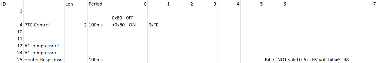

Can you please get some logs of it running steady just heating.
Then a log of going from HVAC on to off.
Posts: 2962

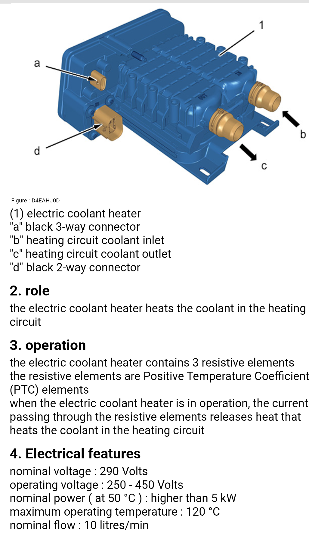

Small issue to gum up the works, it has a heatpump setup so using the AC compressor to heat the cabin. We will need to figure out how to force it to do ptc heating.
https://ev-database.org/uk/car/1947/Peu ... 008-54-kWh
Heat pump (HP)	Yes
HP Standard Equipment	Yes
GeneralScanner

The yes heat pump is from reading up on the e-2008 specs
Got it working it tries drawing current and pulls down my HV power supply. Now its time to do testing on a real setup (I do not have one).
Lin bus info below
https://github.com/Tom-evnut/Lin-E2008-Heater-a-c

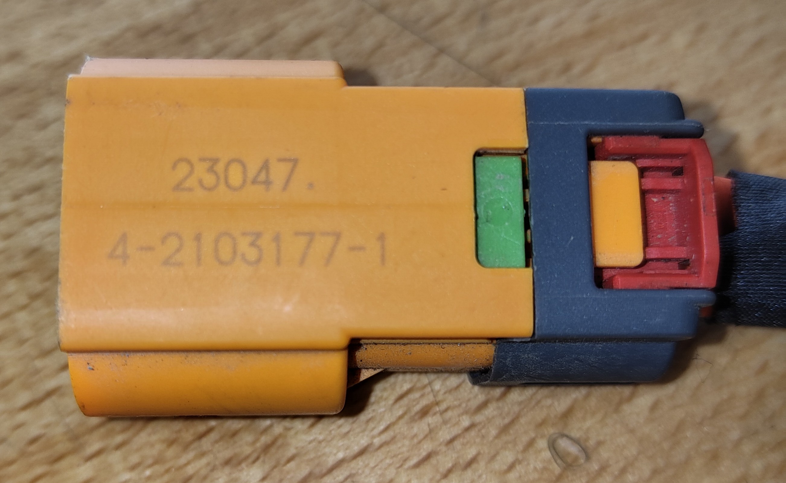

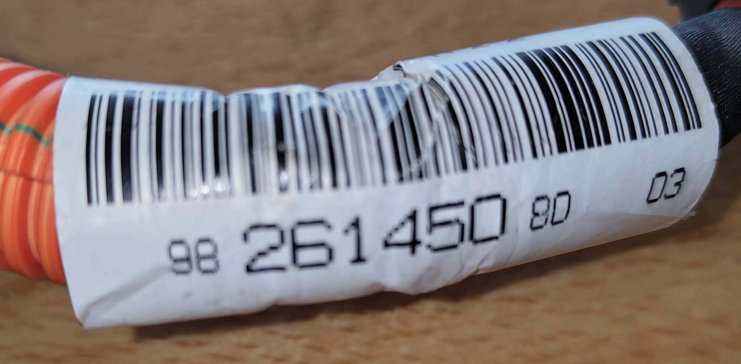

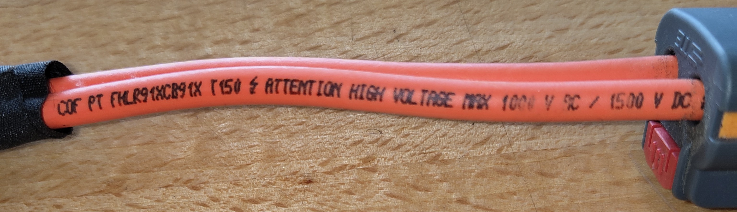

My HV wiring just rocked up.
Part number 4-2103177-1 for the housing.
A TE HVA 280 apparently.
Stellantis part number is 9826145080 and has two of these connectors on either end of a pair of cables. The hvil appears to be internal to the plug (can't see any external LV wiring) .
Back of plug to back of plug is 30cm

It also is a nice and readily available connector which is a bonus.
https://www.te.com/en/product-4-2103177-1.html
Note this is just the housing not a full set with crimps, backshell and seals.
