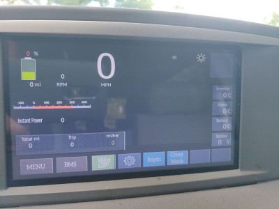

For monitoring i have a 5inch nextion display with an ESP32 reading from the canbus and displaying on the nextion display.
I wrote a basic arduino code like :
If canbus available check for the id
If id is (for example) 0x1Dsend the value to the serial bus which is connected to the nextion dislay.
Current and voltage are being read straight from the isa shunt
Gear, tmphs, rpm are sent from the vcu (in your case that would be from your imverter board) via custom can mapping

I have to thank @PetersonOctavius for starting me and helping me on this project. I will open another separate thread to post the current files in case anybody wants to use them. they work for nextion 5" and 7" screens. both have a 800x480 displays. mine is the 7" version.
The screen still has the plastic on it so it is a little washed out.
This was done in Excel but if anybody is good at Photoshop, it can be made to look a lot better.

So..... I was doing the CAN mappings for the motor and inverter. I saved the mappings and turned off the car and turned it back on.
The screen was not showing the SOC anymore and the voltage was 309V instead of 369V.
2nd BMS was blinking slow and when I looked it is MUXSHORT...

Can mappings work for the inverter. at least first 2 and 4th. To test the other 3 and 5 I need to drive the car.
Now even if the BMS does not have the correct voltage for the battery, I am taking the battery voltage from the inverter (udc) and is showing the correct value of 369V.
I will post all files as they are, tonight after work.

It fits in place of the other screen perfectly. the other screen was also a 7".
Not liking the colors and how you can see from different angles.
In the future I am going to test a DWIN screen. problem is that it uses a different software then Nextion and I am going to leave it as is for now.
DWIN is also $40 cheaper on Amazon.
Pictures are not good either. in reality is it is a lot better.
Closeup.
