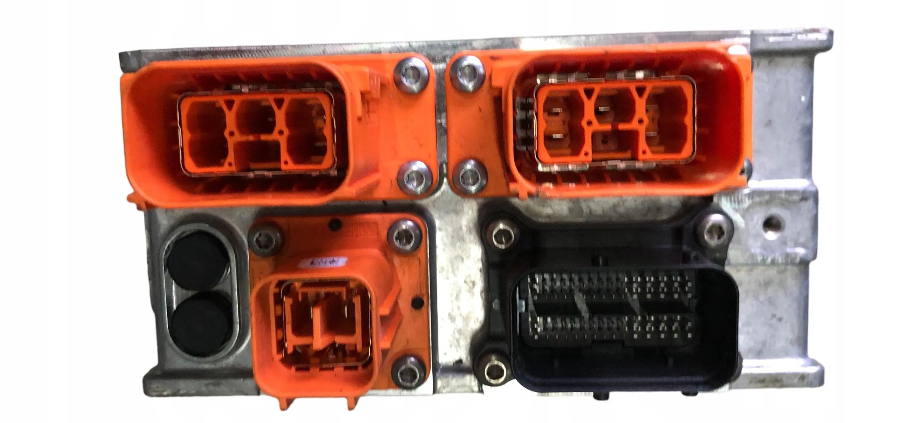

Anybody had success making those chargers work? I'm particularly interested in 22kw versions or at least 11kw ones. Why do the 22 kwh versions have a second connector for what looks to be 3 phase charging?

modellfan wrote: Wed Oct 23, 2024 7:46 am I won't say how I found out. VW id.3 Chargers and the other chargers discussed here don't have the same AC plug. The id.3 and propably also id.4 / enyaq have small deviders bentween the horizontal pins. The others don't. CCS HARNESS NOT COMPATIBLE!
Did you try getting the pictured charger working? How did it go?
