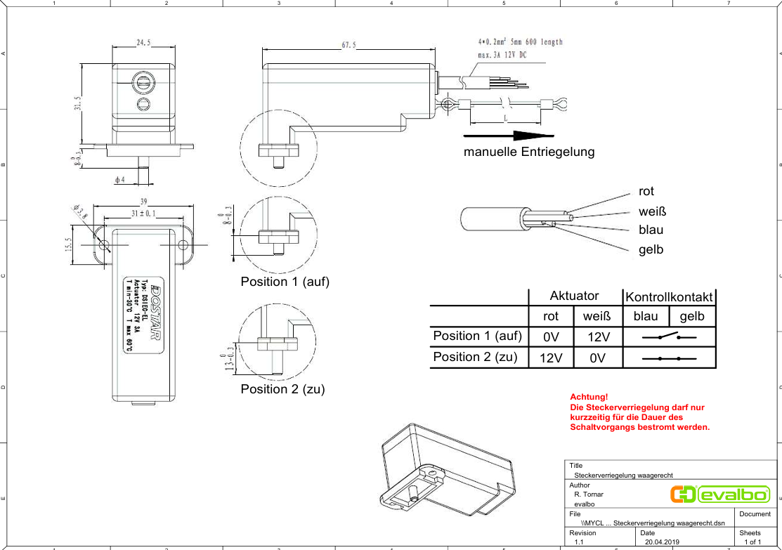

Some have Hall sensors/ analogue feedback, not often but it does exist.uhi22 wrote: ↑Fri May 02, 2025 4:50 pm - It is not even clear, why two values are necessary. If we have a feedback consisting of two resistors and a switch, we can only have two possible values: one for "on" and one for "off". So one single threshold parameter would be sufficient to divide the range into the two possible states.
Let me dig in my notes and get you some more info on what I have found over my time looking at actuators.
"most" common is 1K+10K (open or closed), 1K (so 10K bypassed) (open or closed) then an overtravel where we end up at 11K again.
Or the Simple switch kind.

This spec explains all the vairants they offer including HALL based ones- uhi22

My port is from Duosida. The locking mechanism is a screwed-on part with an electromagnet and a switch. Four cables are routed out, two for the magnet and two for the switch. The switch is closed when the plug is locked. I have connected one wire from the switch to GND, the other to foccci. As a result, I expect a value of 4000 when open and close to zero when closed. This is what the manufacturer says “Working cycle:On: 5%ED activation <300-500 ms,continue 3 seconds max”. Not much time for experiments. It can also be unlocked mechanically, which of course also activates the switch, which means that the mechanical unlocking does not go unnoticed.

How to kill the lock motor? Just tested, and found:
Preconditions: LockClosedThresh=2000, LockOpenThresh=1900. LockRunTime 1500ms. Feedback line open, so it is at high level, I get AdcLockFeedback=4036.
Action: Power-on.
Observed: Lock motor is controlled into direction "unlock" for ever.
Expected: Lock motor is not actuated at all, or the actuation stops after 1.5s.

There was a feature implemented, which inhibits the actuator test as soon as a plug is inserted or a DC charging session is ongoing. This was a kind of protection feature, to avoid dangerous things while power is flowing. However, now I implemented an exception, that the actuator test for lock and unlock works always. I think this is needed, because it makes sense to test the locking with a real plug.Zieg wrote: ↑Thu May 01, 2025 7:05 pm Oh, and when you're testing it I suggest doing so with an actual plug rather than through the web interface. For some reason it doesn't always want to respond to open/close commands there. So you could find yourself confused why it's not working, only to realize it's actually working just fine once you plug in.
Also cleaned-up the actuator test. In the old versions, when setting actuatortest to "lock", it executed the locking, but immediately unlocked by application. So inspecting the mechanic in locked state was not possible. Now with the new software, the actuator test is able to go into a stable "locked" and "unlocked", and when leaving the actuator test, the application takes over again.
To avoid killing the lock motor in case of wrong feedback, I propose to use time-based locking (by setting LockClosedThresh and LockOpenThresh to 0), until all remaining improvements are implemented.
