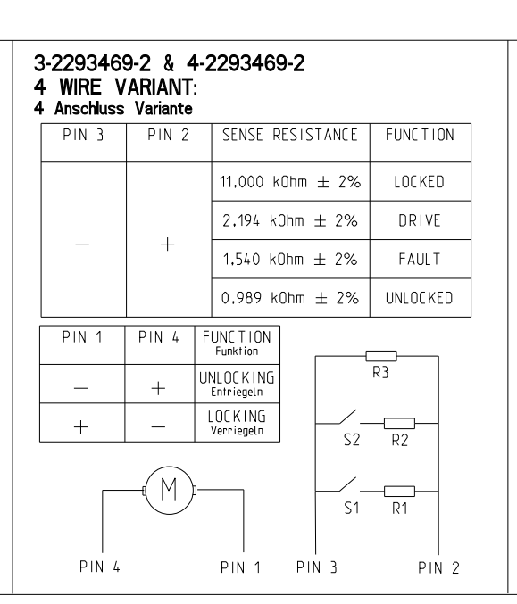

Agree, best have auto offset added based on the other threshold. should be easy to work into the code. so like 200bit offsets as standard.uhi22 wrote: ↑Fri May 02, 2025 4:50 pm - It is not clear, how to adjust the two threshold values. It does NOT help to adjust them to exactly the measured values in both states, because then we just get random behavior. We need to define whether they shall be set below or above the measured values. Or set them to the measured values, and add a tolerance band in software.
Some have Hall sensors/ analogue feedback, not often but it does exist.uhi22 wrote: ↑Fri May 02, 2025 4:50 pm - It is not even clear, why two values are necessary. If we have a feedback consisting of two resistors and a switch, we can only have two possible values: one for "on" and one for "off". So one single threshold parameter would be sufficient to divide the range into the two possible states.
Let me dig in my notes and get you some more info on what I have found over my time looking at actuators.
"most" common is 1K+10K (open or closed), 1K (so 10K bypassed) (open or closed) then an overtravel where we end up at 11K again.
Or the Simple switch kind.

TE have discrete switch positions.
This spec explains all the vairants they offer including HALL based ones
https://www.te.com.cn/commerce/Document ... F2323264-1

The currently implemented range detection is:
- We have two cases: (A) "closed" is higher resistance and (B) "open" is higher resistance.
- For (A):
if AdcLockFeedback is low (between 0 and <LockOpenThresh), we detect OPEN.
if AdcLockFeedback is middle (between LockOpenThresh and LockClosedThresh), we keep the last detected state. (or detect "in progess"???)
if AdcLockFeedback is high (above LockClosedThresh), we detect CLOSED.
Example parametrization: AdcLockFeedback is 100 while open, and 1000 while closed. The parameters shall be LockOpenThresh=300 and LockClosedThresh = 800.
- For (B):
if AdcLockFeedback is low (between 0 and <LockCloseThresh), we detect CLOSED.
if AdcLockFeedback is middle (between LockClosedThresh and LockOpenThresh), we keep the last detected state. (or detect "in progess"???)
if AdcLockFeedback is high (above LockOpenThresh), we detect OPEN.
Example parametrization: AdcLockFeedback is 500 while closed, and 3000 while open. The parameters shall be LockClosedThresh=700 and LockOpenThresh = 2700.
