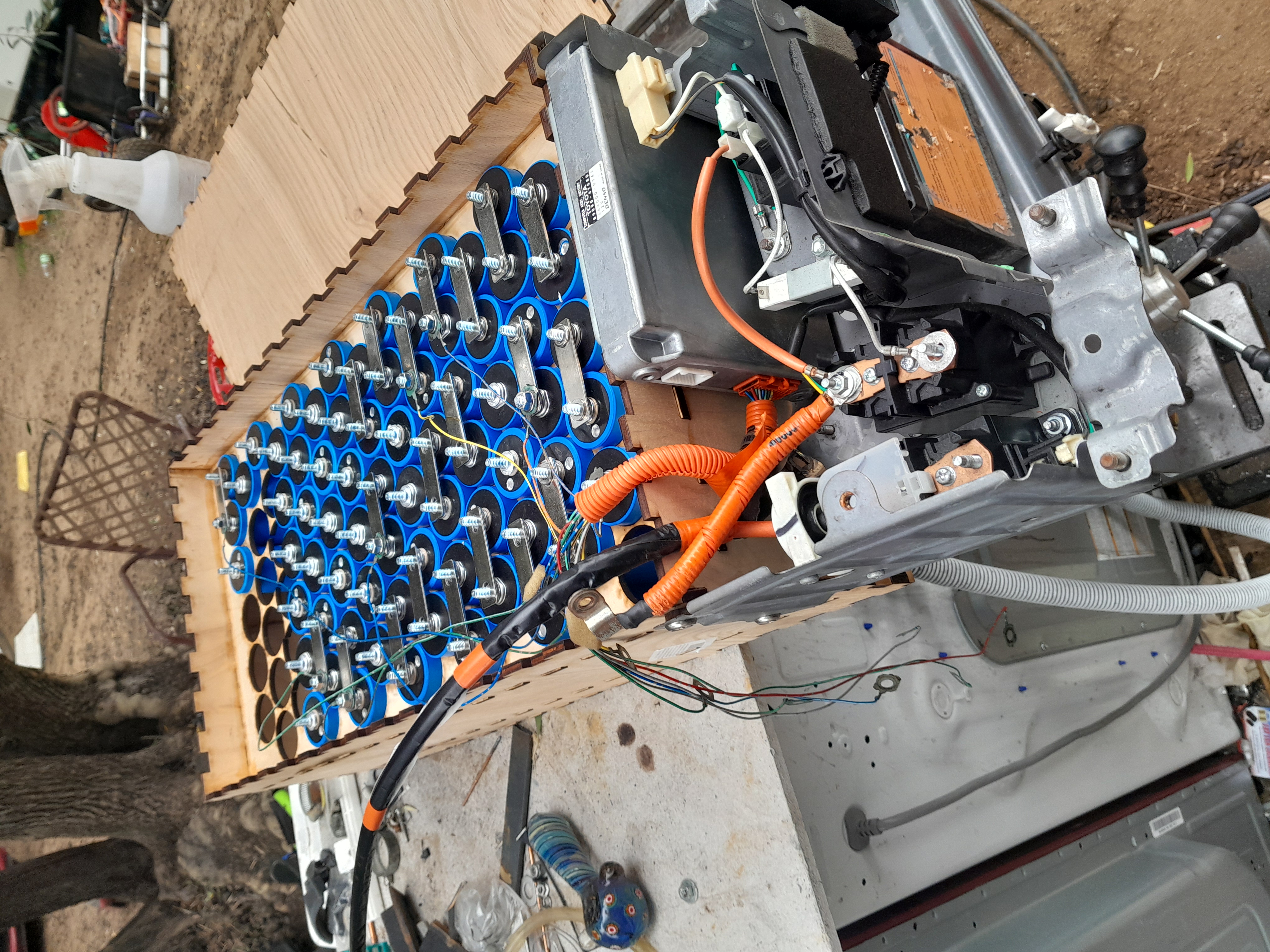

amazing work! really this is one step closer to simulating the hybrid battery computer and thus achieaving the goals.
I have continue pursuing the other direction keeping the battery ecu and lying to it or modifying its firmware.
this is my 20ah(can do 100a , 150a for 5 second) 70 cell lipofe4 battery. hooking it into the prius this morning and will test mpg and eletric only range, try and see how much SOC it will use of the 20a. i have enough space in the box for 84 cells . 5 vs 6 cells per voltage block, 18.5 vs 21.9v fully charged per voltage block. the computer firmware will have to be modified to use 6 cells, but 5> we are about to find out!

In all honesty it looks like madness. How are you going to get an alarming notification when one of your cells goes under/overvolted? Cant wait to see data log from dr.prius and hybrid assistant app.

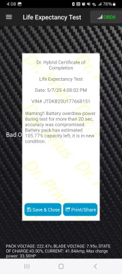

this is my first test, driving out, voltage block 11 looks to be .2 volts lower at times then the rest, so i will charge up the battery by holding the pedals and then see what the difference is at the cell level, by removing the battery and taking off the top and bottom and if one cell is found very off then it gets charged and we will repeat. for now
the test shows 105!
the test shows 105!

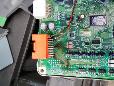

Now it came to me that if you already have the battery on the bench, is it possible for you to open up its brain and trace from which chip the signal lines are coming from?
- lastphaseofthis
- Posts: 13
- Joined: Tue Oct 29, 2024 2:40 pm
- Been thanked: 3 times
Re: can we replicate BTH data gs450h/prius?... Unlocking the PHEV
yes, i have already done so, but didnt post the damn pic lol.
edit: oh ya you want the data lines not the voltage block signals. those are in CAN on this prius ecu, but will take out my gs 450h ecu and report back in a few!

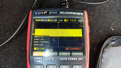

Finally some progress. Here are screenshots from osciloscope and new dump from pulseview. It seems I was having loads of signal glitches before. Crappy connections. Although used an option for 1us glitch filter this time. Picture 5 and 6 shows red and green wires. Capture files taken separately obviously. I didn't want to damage capture device. Will do more capturing tomorrow and acquire second probe for the scope. Also important thing - engine was off, so hv battery voltage readings should be kinda stable.
https://drive.google.com/file/d/1GC9-Vn ... sp=sharing
Given bit time asymmetry it seems i'd have to butcher battery ecu and tap between transceiver and the actual IC. Otherwise there's no way to to read this crap. Unless someone figures out which transceiver should be connected for sniffing.
Attached images are green wire first, then red. Red wire is lower voltage.
After powering up this little wireshare transceiver, no signal on any UART side pins. Perhaps it needs a wake up call from another device on UART side.
Funny thing is, After hooking up RS485 side to the car, both signals are shorted to ground (No matter polarity. Switched A and B and same result). If i unplug a single wire, either red or blue, then signal voltage range goes back to normal. There's still 200mv signal between red/green that i have captured. I guess that's enough for car to work since it did so. I have captured them without transcevier connected so +1,8/-1,8 v range.
below is my full folder. "differential 1 24mhz" and "differential 2 24mhz" files are captures with swapped GND/D0.
https://drive.google.com/file/d/1XbyO9z ... sp=sharing
NOW THE MAD PART!!!
- "differential 1 24mhz" 9600baud rate and invert RX gives frame errors... BUT "differential 2 24mhz" at 9600 baud works perfectly, as in not a single frame error across a hundred packets... BUT bit timing is off, like "50/50 kinda random" off. Like literally some bits are less than half of this baud rate. BUT I have compared 3 packets and they have the same amount of data AND a lot of values are the same for all of those 3 packets.
Why i think its mad? Because i have established that the baud rate must be 38400 or 28800 based on previous captures.
Edit: Scratch that boys. We're going places! You know the saying about placing an infinite number of monkeys and infinite number of typewriters in a room? Amazing things are bound to happen. 19200 baudrate with an odd parity bit fits like a glove! Turns out an oscilloscope was unnecessary after all. But I do not regret buying it all. Will be useful when shit hits the (Taiwanese) fan.
Edit: Added a screenshot of different decodings. Perhaps someone notices something at first glance.
Edit: Made proper data gathering. Samples + dr prius screenshots. If this doesn't work, then the next step is to mess physically with temp and voltage sensors to get boundary values. I don't really have a place for this
https://drive.google.com/file/d/1mwW_1t ... sp=sharing
Edit: Another idea - Someone could inject this data stream on a loop to the Hybrid Vehicle Control ECU while having obd dongle with dr. prius running on a phone. Would this show my battery parameters in the app? Or straight away look for CAN PIDs that dr. prius uses to gather data. Buy rs485 dongle for arduino and send data on loop through bth. Listen on can pins of HVC ECU. Although it seems kinda pointless when you don't know which bytes to change to change data.
Edit: https://rs485.com/rs485spec.html This website rules out RS422 by its minimum of 2V signal level. But I don't think it changes anything. I had a talk with an IT guy who encouraged me to make my own UART/rs385 relay with arduino since, as he told, even a monkey could do it with the help of cyber monkey called ChatGPT, before paying someone to write the code for me.

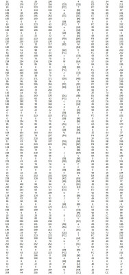

Edit: When exported to 8 column by 12 rows grid, data gives a lot of hints. It is useless for now until checksum is figured out.
Edit: Tried this data set.
95+96
lsb+lsb
37+154
value = (MSB * 256) + LSB
= (0x9A * 256) + 0x25
= (154 * 256) + 37
= 39424 + 37
= 39461
way off.

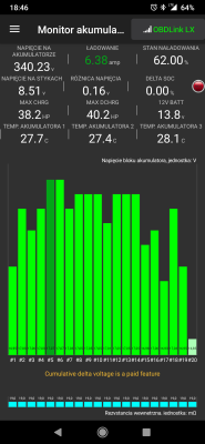

Edit: now look at that. A screenshot from 15.05 data packet sent by Arduino. Sure I still got plenty of DTC errors on the dashboard but most values are legit spoofed. Charging amps sometimes changed for a second to 6.30amps, and voltage did flip sometimes too. I guess byte/bit timing again is to blame. But then other packets give rock solid values even when the engine is running.
Changing any byte makes most values go default. Apart from max chrg and max dchrg, soc, 12v bat. Have to find a checksum to progress.
Picture with 8.6v12 bat corresponds to 12.52 picture. Car even goes into ready with "check hybrid system" message. Engine running. All values stables and nothing changes. Although I'm afraid of damaging my car. Engine sounded odd. Perhaps something to do with real HV voltage being off from truth.
