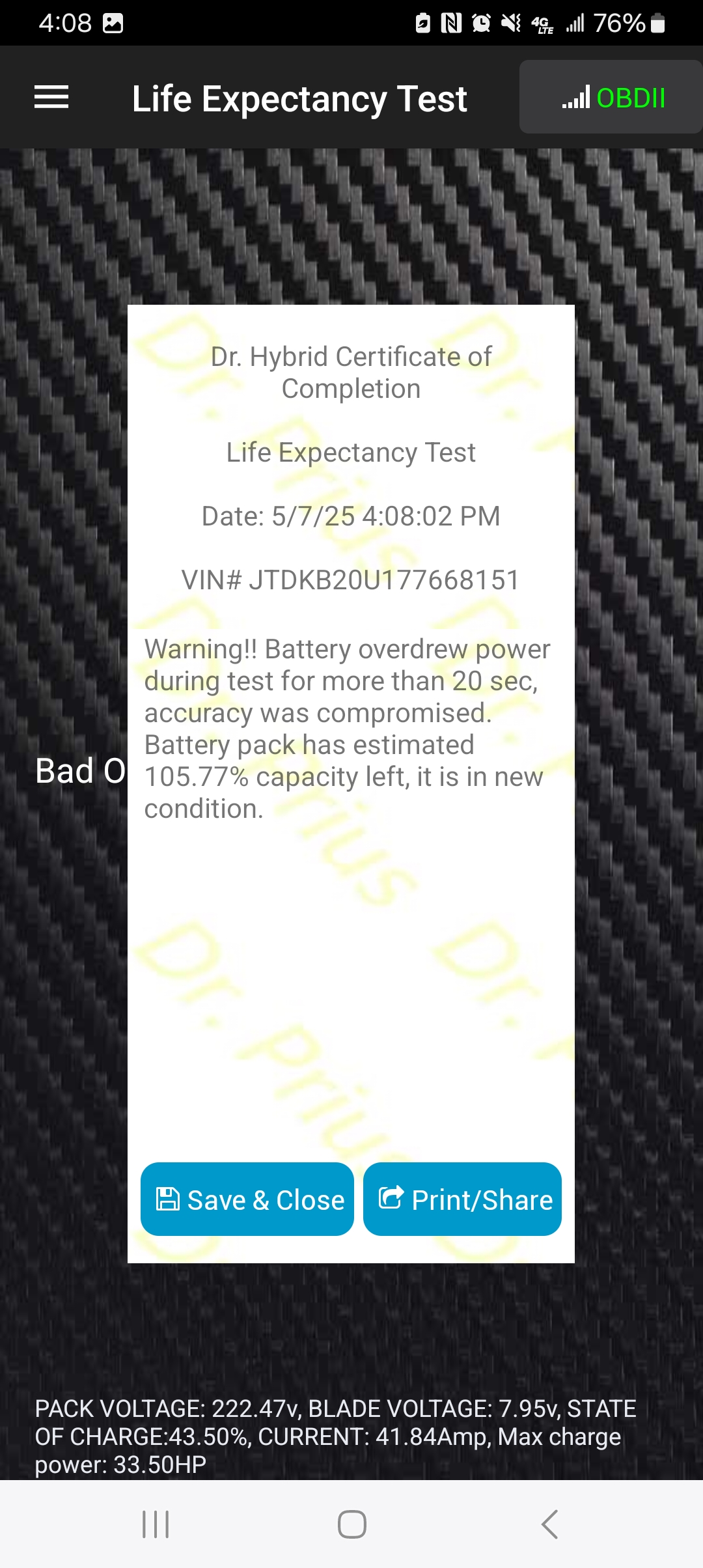

this is my first test, driving out, voltage block 11 looks to be .2 volts lower at times then the rest, so i will charge up the battery by holding the pedals and then see what the difference is at the cell level, by removing the battery and taking off the top and bottom and if one cell is found very off then it gets charged and we will repeat. for now
the test shows 105!

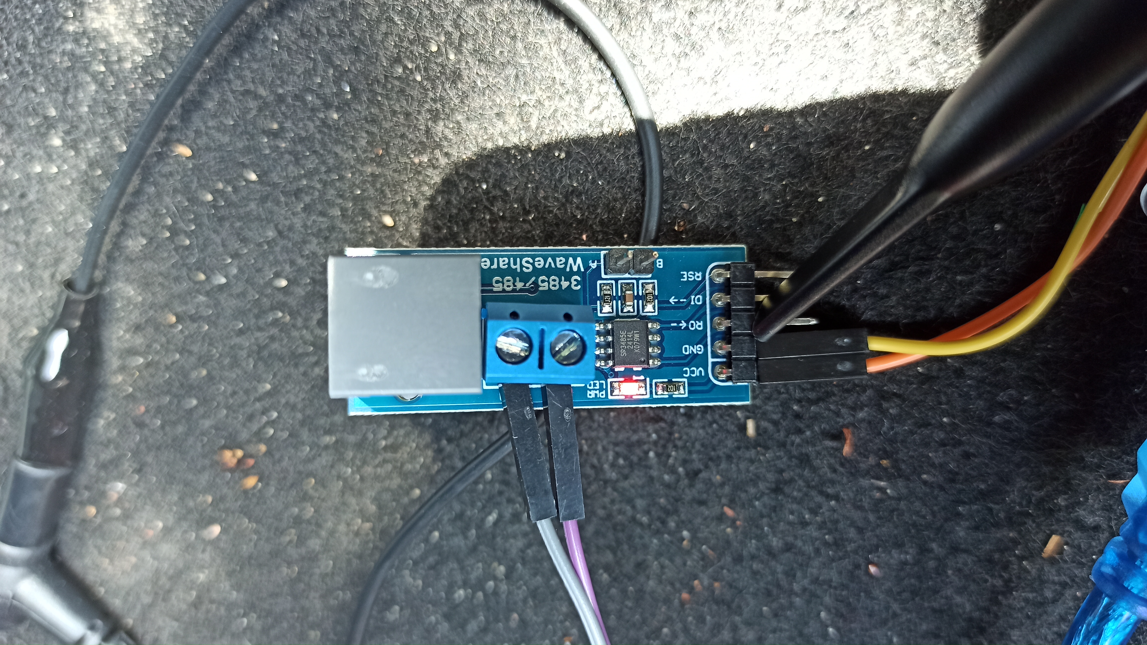

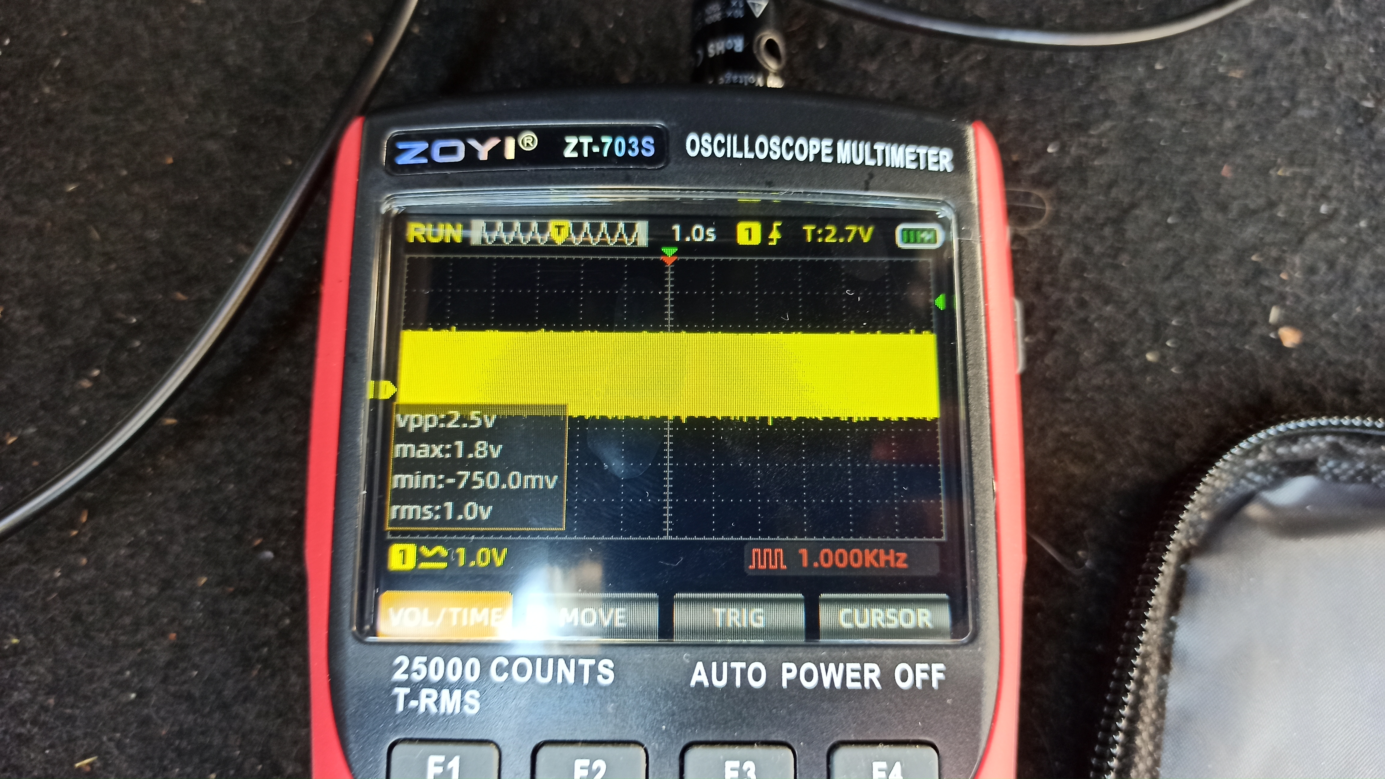

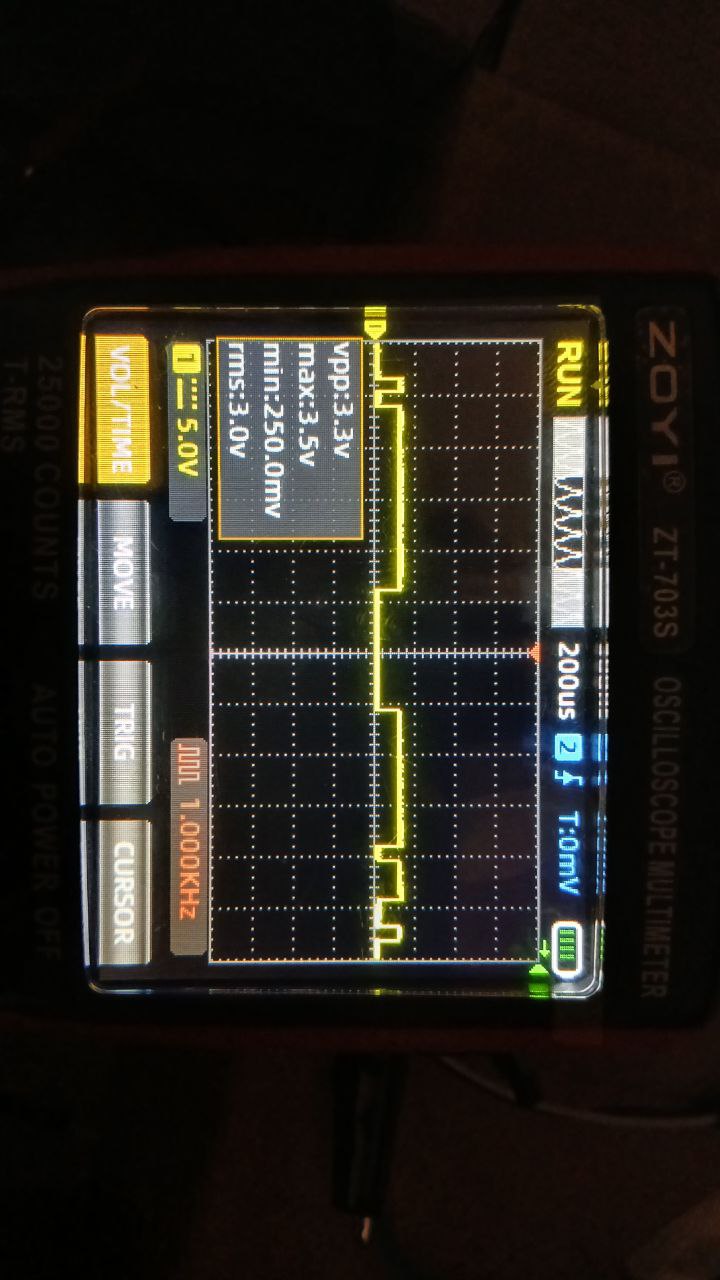

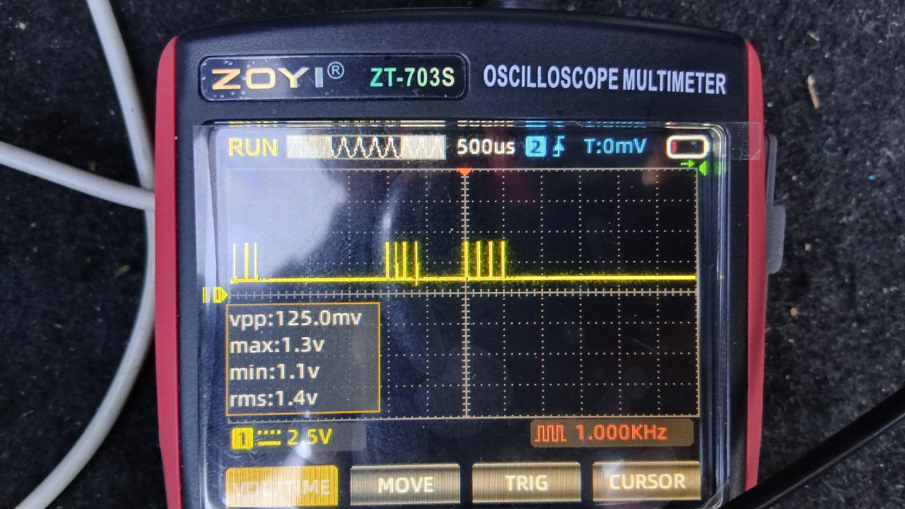

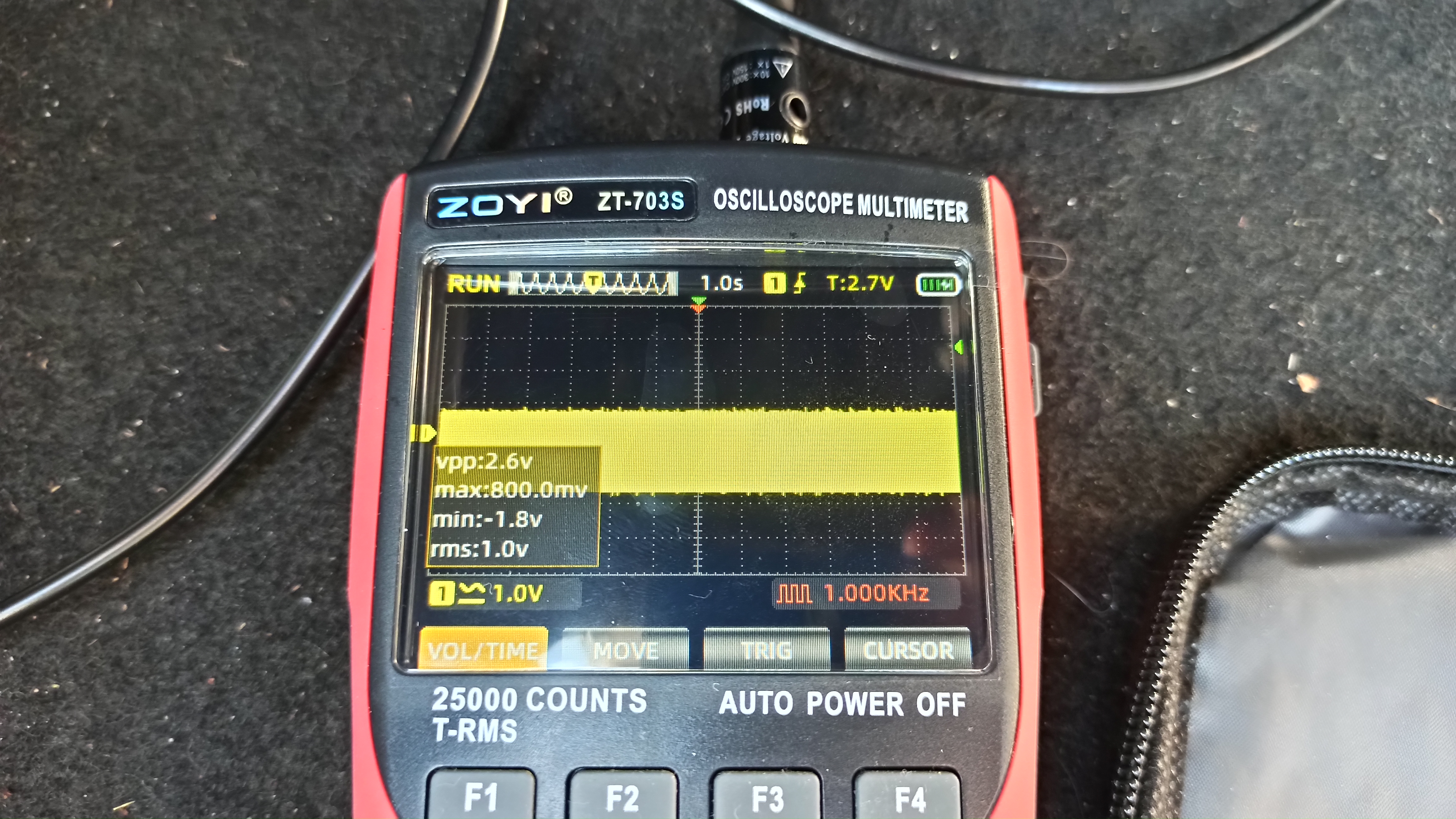

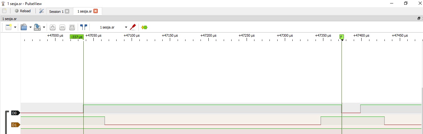

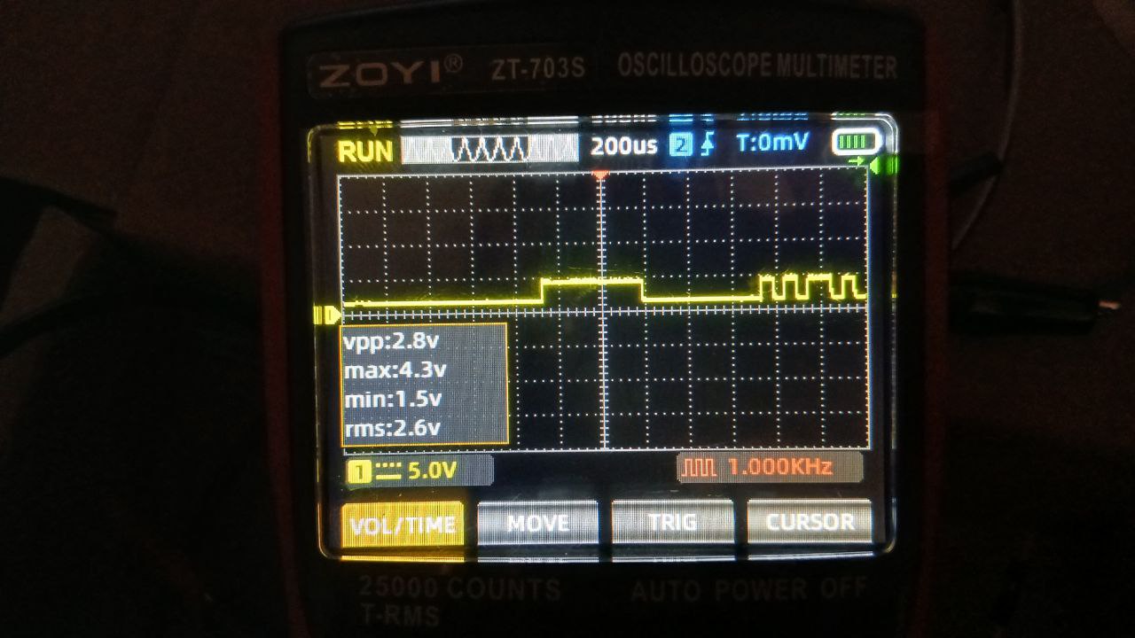

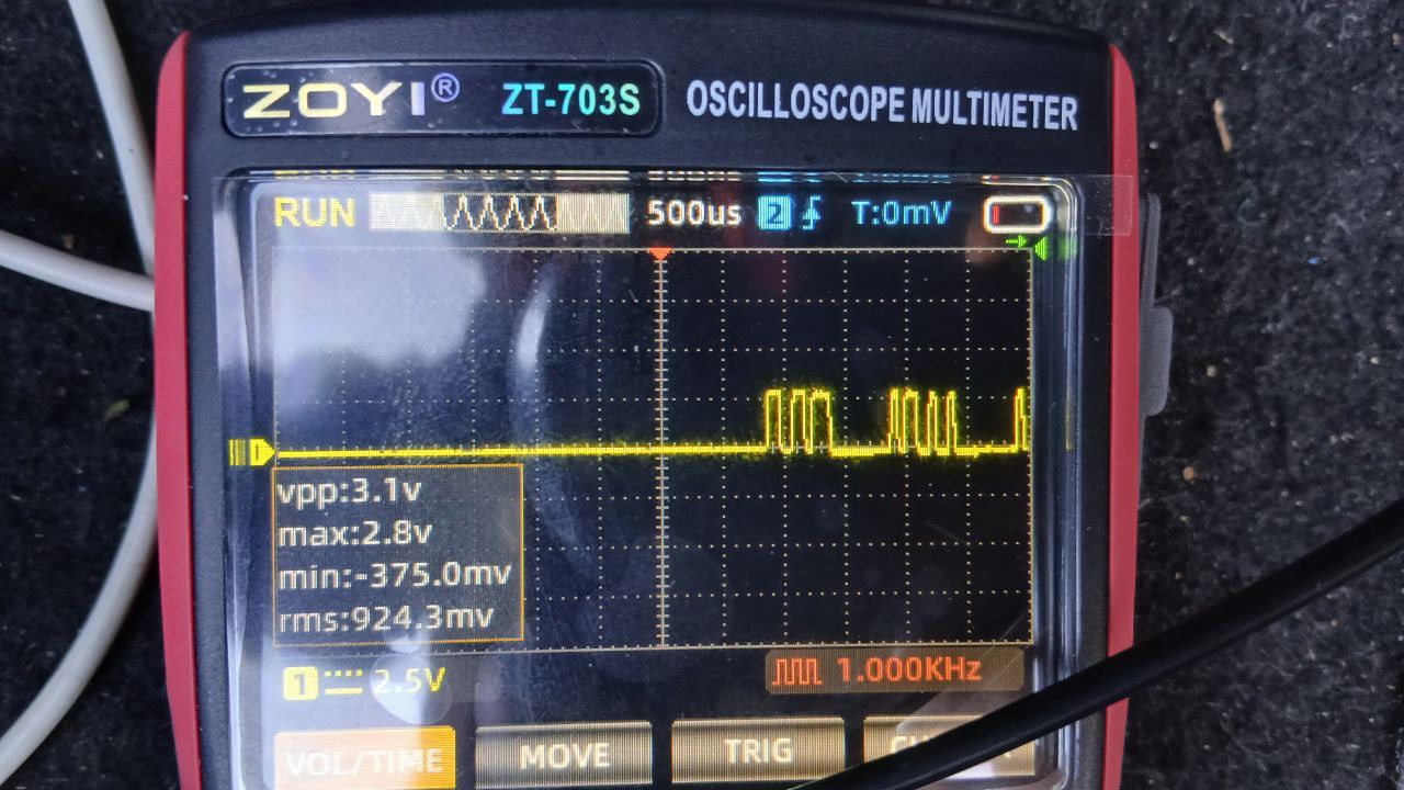

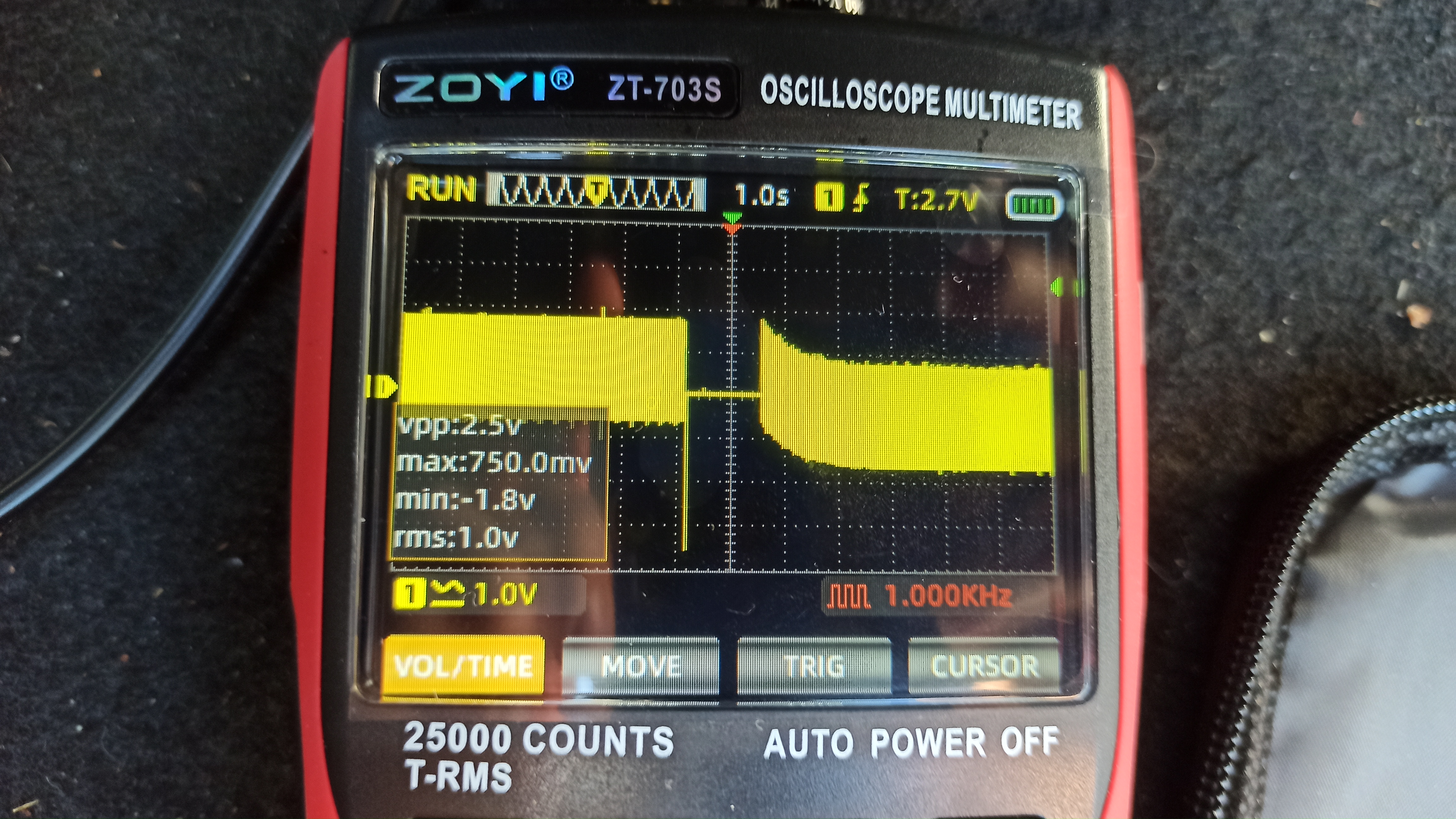

Finally some progress. Here are screenshots from osciloscope and new dump from pulseview. It seems I was having loads of signal glitches before. Crappy connections. Although used an option for 1us glitch filter this time. Picture 5 and 6 shows red and green wires. Capture files taken separately obviously. I didn't want to damage capture device. Will do more capturing tomorrow and acquire second probe for the scope. Also important thing - engine was off, so hv battery voltage readings should be kinda stable.
https://drive.google.com/file/d/1GC9-Vn ... sp=sharing

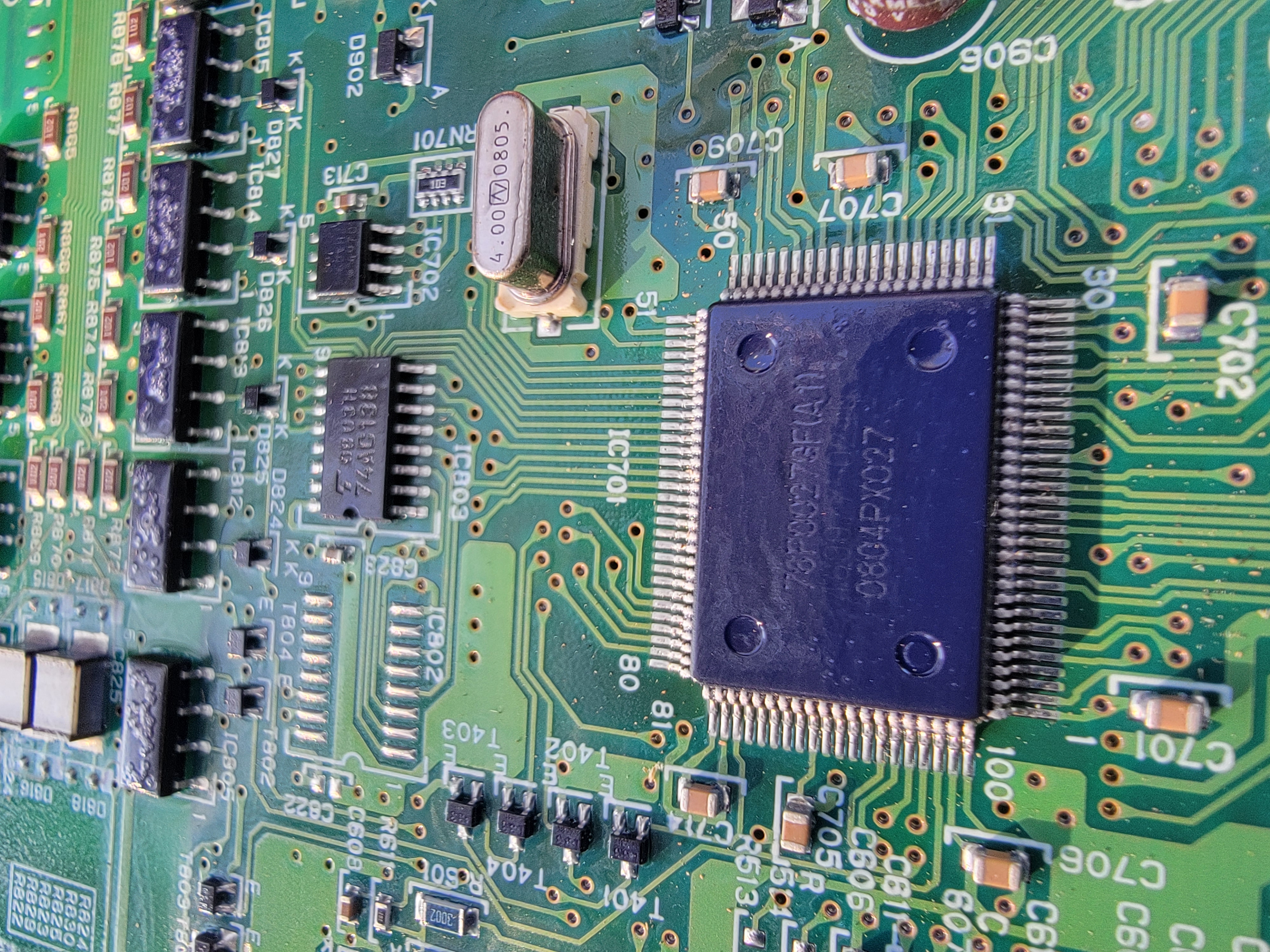

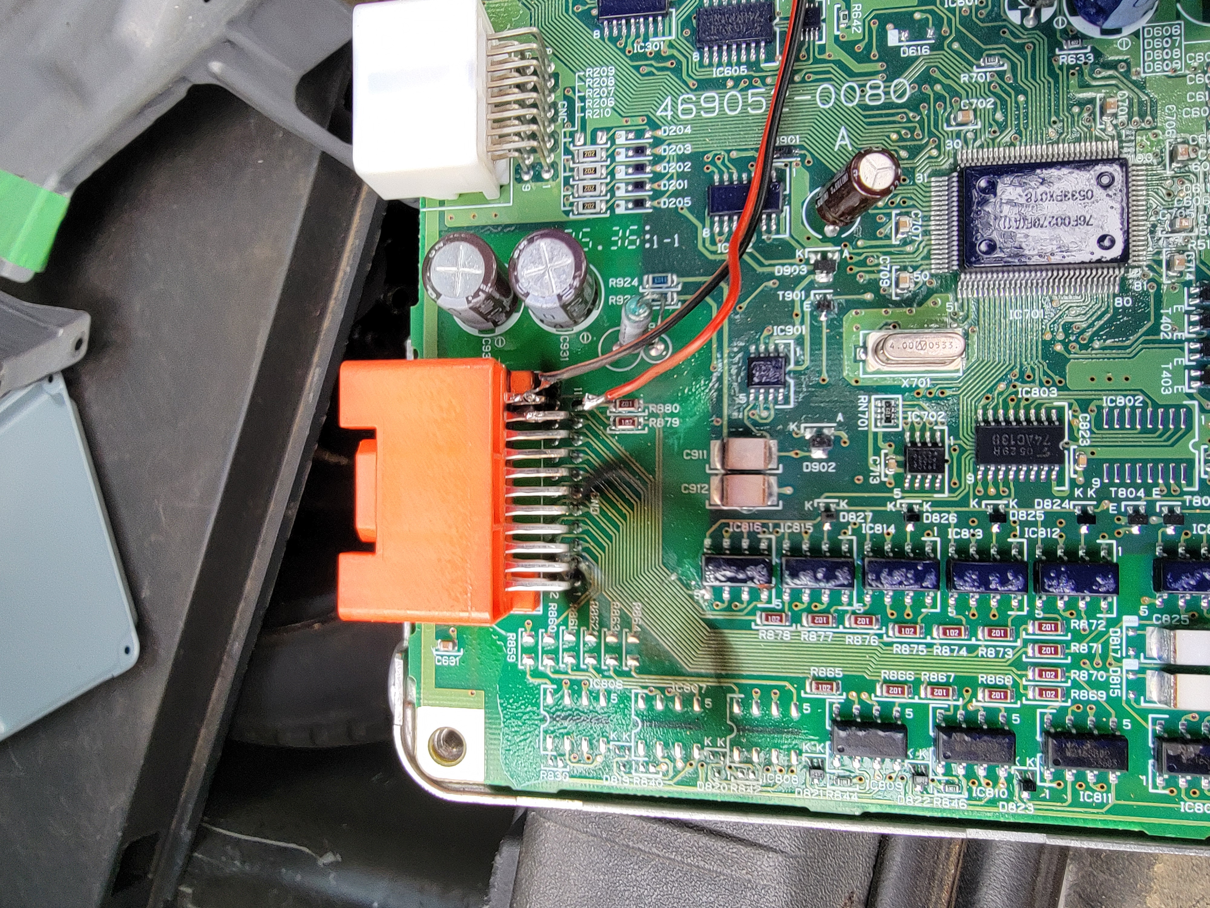

Given bit time asymmetry it seems i'd have to butcher battery ecu and tap between transceiver and the actual IC. Otherwise there's no way to to read this crap. Unless someone figures out which transceiver should be connected for sniffing.
Attached images are green wire first, then red. Red wire is lower voltage.
After powering up this little wireshare transceiver, no signal on any UART side pins. Perhaps it needs a wake up call from another device on UART side.
Funny thing is, After hooking up RS485 side to the car, both signals are shorted to ground (No matter polarity. Switched A and B and same result). If i unplug a single wire, either red or blue, then signal voltage range goes back to normal. There's still 200mv signal between red/green that i have captured. I guess that's enough for car to work since it did so. I have captured them without transcevier connected so +1,8/-1,8 v range.
below is my full folder. "differential 1 24mhz" and "differential 2 24mhz" files are captures with swapped GND/D0.
https://drive.google.com/file/d/1XbyO9z ... sp=sharing
NOW THE MAD PART!!!
- "differential 1 24mhz" 9600baud rate and invert RX gives frame errors... BUT "differential 2 24mhz" at 9600 baud works perfectly, as in not a single frame error across a hundred packets... BUT bit timing is off, like "50/50 kinda random" off. Like literally some bits are less than half of this baud rate. BUT I have compared 3 packets and they have the same amount of data AND a lot of values are the same for all of those 3 packets.
Why i think its mad? Because i have established that the baud rate must be 38400 or 28800 based on previous captures.
Edit: Scratch that boys. We're going places! You know the saying about placing an infinite number of monkeys and infinite number of typewriters in a room? Amazing things are bound to happen. 19200 baudrate with an odd parity bit fits like a glove! Turns out an oscilloscope was unnecessary after all. But I do not regret buying it all. Will be useful when shit hits the (Taiwanese) fan.
Edit: Added a screenshot of different decodings. Perhaps someone notices something at first glance.
Edit: Made proper data gathering. Samples + dr prius screenshots. If this doesn't work, then the next step is to mess physically with temp and voltage sensors to get boundary values. I don't really have a place for this :(
https://drive.google.com/file/d/1mwW_1t ... sp=sharing
Edit: Another idea - Someone could inject this data stream on a loop to the Hybrid Vehicle Control ECU while having obd dongle with dr. prius running on a phone. Would this show my battery parameters in the app? Or straight away look for CAN PIDs that dr. prius uses to gather data. Buy rs485 dongle for arduino and send data on loop through bth. Listen on can pins of HVC ECU. Although it seems kinda pointless when you don't know which bytes to change to change data.
Edit: https://rs485.com/rs485spec.html This website rules out RS422 by its minimum of 2V signal level. But I don't think it changes anything. I had a talk with an IT guy who encouraged me to make my own UART/rs385 relay with arduino since, as he told, even a monkey could do it with the help of cyber monkey called ChatGPT, before paying someone to write the code for me.

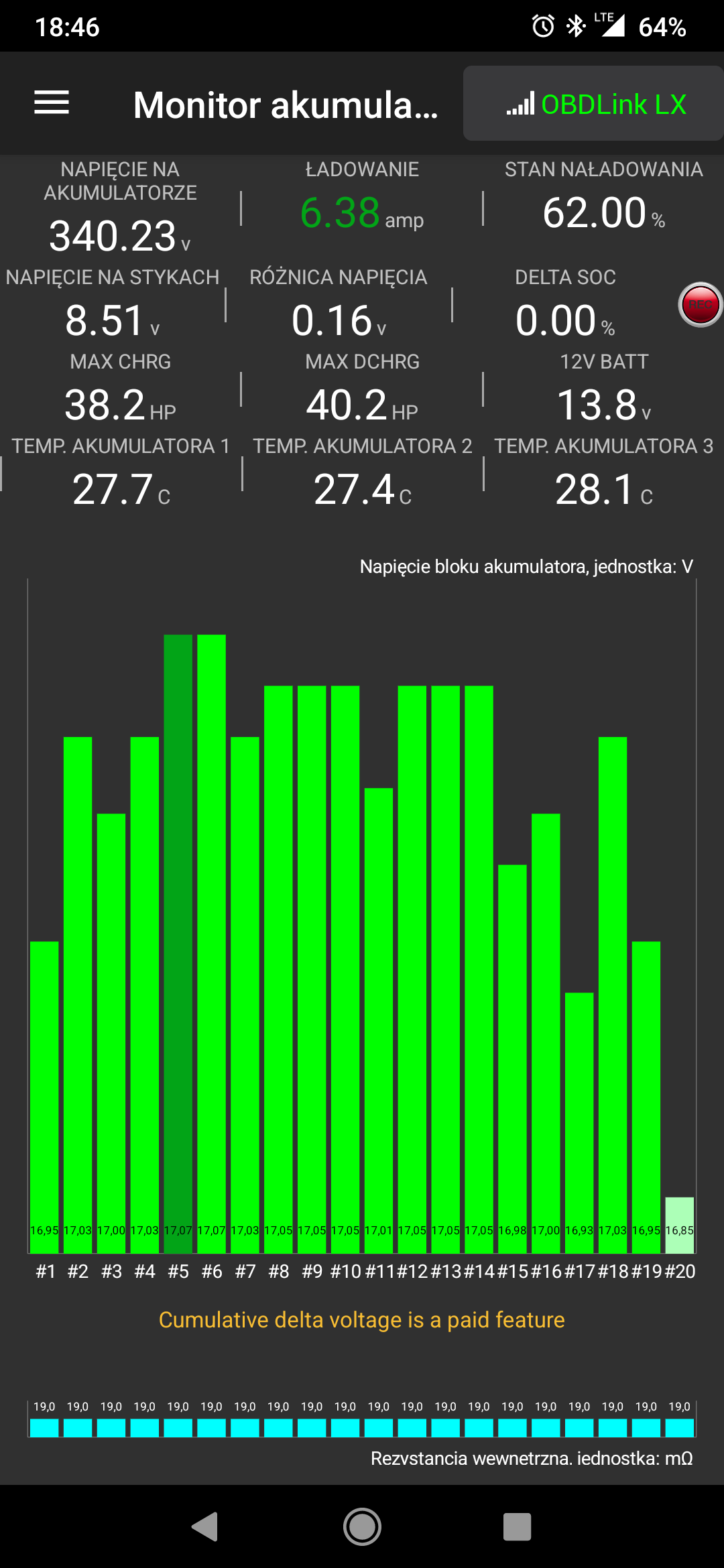

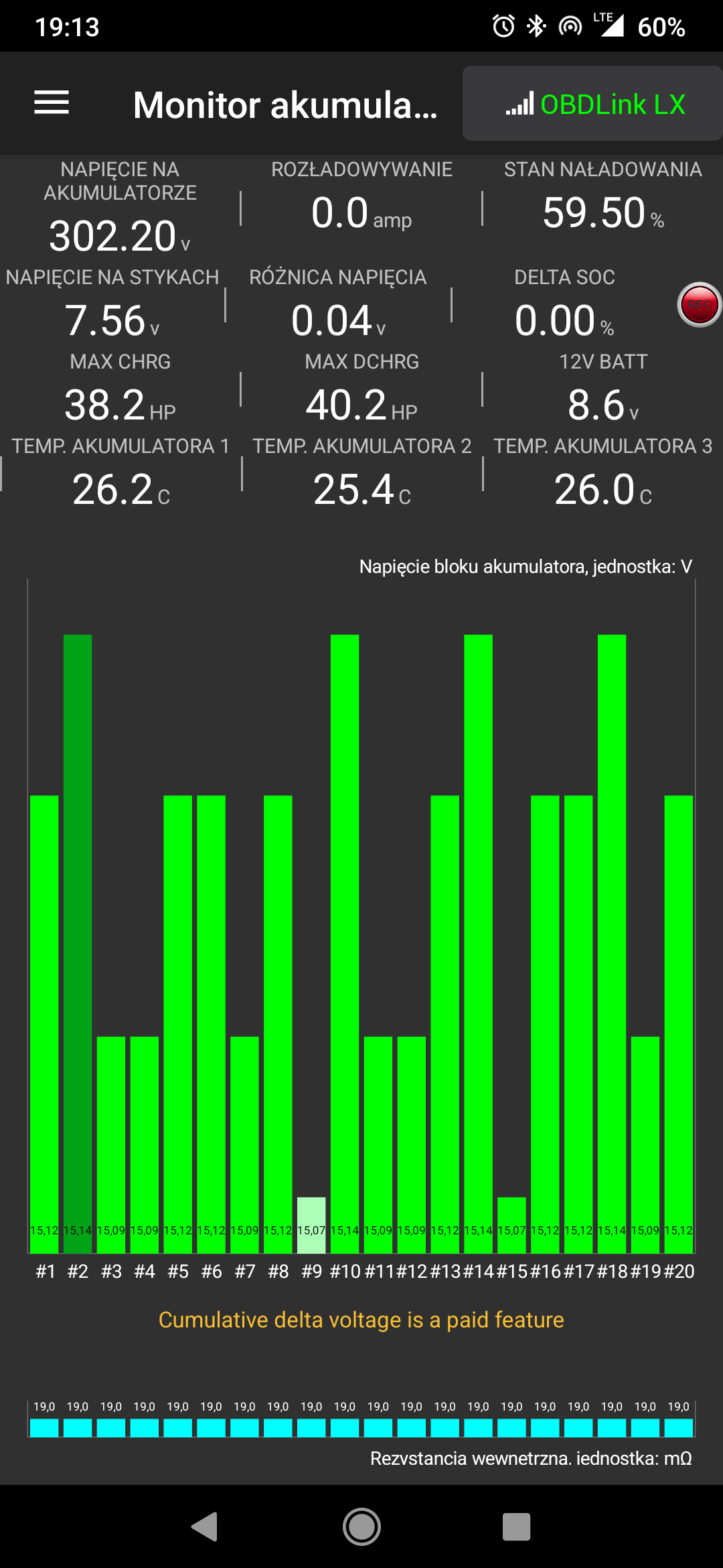

Changing any byte makes most values go default. Apart from max chrg and max dchrg, soc, 12v bat. Have to find a checksum to progress.
Picture with 8.6v12 bat corresponds to 12.52 picture. Car even goes into ready with "check hybrid system" message. Engine running. All values stables and nothing changes. Although I'm afraid of damaging my car. Engine sounded odd. Perhaps something to do with real HV voltage being off from truth.

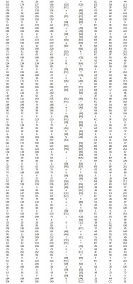

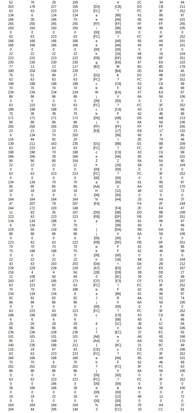

Edit: When exported to 8 column by 12 rows grid, data gives a lot of hints. It is useless for now until checksum is figured out.
Edit: Tried this data set.
38 217 255 105 107 255 105 0 255 107 108 0 104 255 103 215 39 216 255 107 108 87 106 0 255 107 108 213 106 255 232 138 40 215 255 107 108 0 104 0 255 0 108 110 72 0 37 126 41 214 255 105 107 93 106 0 255 106 107 0 104 191 102 244 42 213 255 108 105 154 106 0 255 107 106 161 106 156 167 242 43 212 255 107 106 138 106 0 255 0 108 0 72 0 37 154
11813 byte sum
95+96
lsb+lsb
37+154
value = (MSB * 256) + LSB
= (0x9A * 256) + 0x25
= (154 * 256) + 37
= 39424 + 37
= 39461
way off.
Now I am going to take a break from all of this. My brain is fried. But if you need aa single absurdly big data sniffing log, let me know so i can help.
Resuming the struggle (decimal):
byte 1: counter. rolling over 32, 38, 44, 50, 56
byte 6: always 255
byte 8: always 0
byte 12: always 0
byte 22: always 87
byte 28: always 213
byte 30: always 255
byte 38: always 0 (went 88 at 50%SOC)
byte 40: always 0
byte 42: always 0
byte 46: always 0
byte 56: always 0
byte 60: always 0
byte 72: always 0
byte 88: always 0
byte 92: always 0
byte 94: always 0
Last two bytes are not a checksum because there are packets with equal last 2 bytes but unequal sum of other bytes. There are bytes that were same at first 2 captures and went up in third. Bytes 7, 13, 15, 23, 29, 39, 45, 55, 61, 71, 77, 87. This doesn't make sense since none of the values at the screenshots correspond to this upward change.
To be honest values above might not be invariable since I didn't try making huge changes in real time. Will try to make chatgpt write a script for arduino with the rolling byte code and more strict timing of data stream to make DTC errors go away. But it all seems pointless without having battery on a workbench :( If any of you have proprietary software that could write graphs from my captured data and would share it privately in exchange for NDA or something, then im up for it.

- Have a working MiTM device with code that can alter single bytes coming out from battery to hybrid ECU.
My target right now is to make a MiTM device between battery and hybrid (Arduino + chatgpt code). This way one can alter single bytes and see what happens. No need for pulling anything apart. But the problem is that it doesn't work so far. While disconnecting BTH and sending a single message/frame from Arduino kinda works although with DTC codes, it stops working with my MiTM device made out of an Arduino and two Waveshare RS485 Board (3.3V). Arduino's terminal and oscilloscope do not show any signal on TTL/serial side of rs485 board. Im kinda busy lately so that's where my research have stopped.
Device works? Great. Time to alter bytes.
Device doesn't work? Bad. Time to figure out why.
While physically changing battery parameters is one way to decipher BTH data, a working MiTM device would STILL be the next step needed to move forward with this project.

Re: can we replicate BTH data gs450h/prius?... Unlocking the PHEV
Post by maciek16c »
Looks like you have 120 ohm termination on rs485 transceiver, try removing it. I had the same problem when trying to read data using can transceiver connected to uart and after removing it signal amplitude was better. What data can you read? Are you sure it's 19200 baud? When i looked at oscilloscope with decoding function, the best fitting setings were 9600 7N1. There were no uart frame errors and decoding was stable - 96 byte packets.

God damn it all to hell. Another obstacle. Output signal is shorter in time than input signal. Using 120ohmresistor doesn't change nothing. Below is arduino code for Leonardo with two rs485/serial dongles. 45us down to 16us bit time. Although output data seems to be totally wrong. Frame errors and totally different bits and less of them, than on the input side.

I made it work. But there are still problems. Something about parameters of this signal upsets the car. UART data is proper good. 2 attached pics are a/gnd and b/gnd. Attached .sr is AB output (one acts as GND) from trensceiver. Bridging AB with resistor made signal analyser dead silent/no data at all / car won't start.
transceiver output ab.7z
(4.65 KiB) Downloaded 39 times

I used max485 (cheapest one) and just powered it from 3.3V (it might be below recommended minimum, i haven't checked datasheet, but it works). On receiving one i removed 120 ohm termination. I tried using crc calculator with different algorithms but couldn't find fitting one if crc is in last bytes.
I have no easy access to battery interior and also there is some noise in voltage measurements so there is too much data changing all the time
