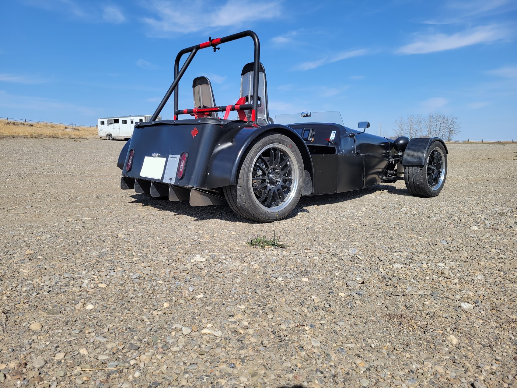

I also went out for a little drive since the weather was really nice, and while I was out I remembered that there was an EV public outreach program of sorts happening today. It's a trailer that they bring around, staff with 'EV ambassadors' and have cars available for people to test drive. I stopped in and I think I was very well received! Turns out one of them also used to autocross a Leaf until the ban, and another called a friend who was nearby and came down to see the car and chat. From him I found out there are some others in town who have done conversions and even a shop that I was previously unaware of. So, that was great to meet them and it was nice to be able to show off the car a bit.

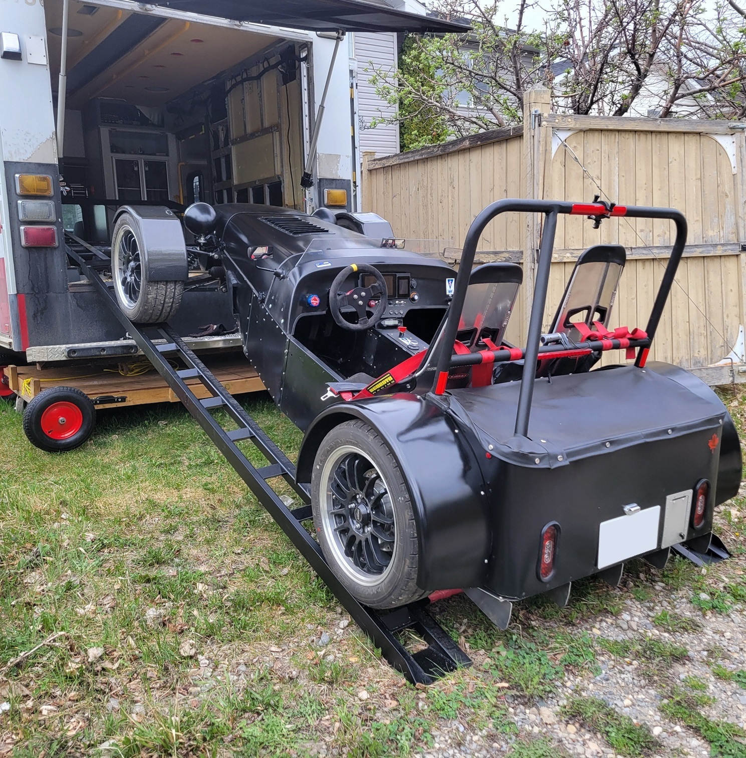

Also stopped for some quick updated photos. I repainted the rear fenders and covered the leading edge with a flat black-colored paint protection film. Also 3d-printed a cover/air extractor for the hole in the side where the exhaust came out. New side mirrors that are smaller (less drag I guess?) and convex so the view is better. Added a small convex rear view mirror too. In the rear you can see the diffuser, and the door for the CCS charge port. Preliminary tests are showing at least a 1kw drop in power draw at 100kph, so that's great!

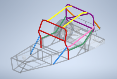

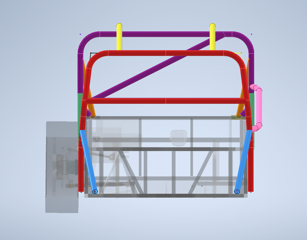

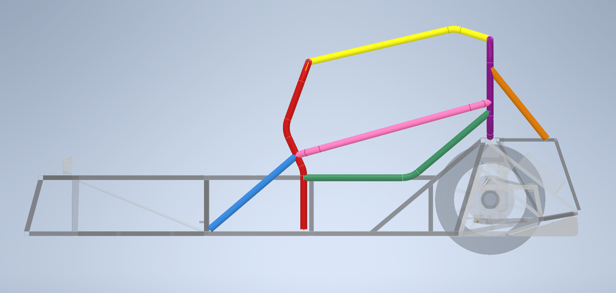

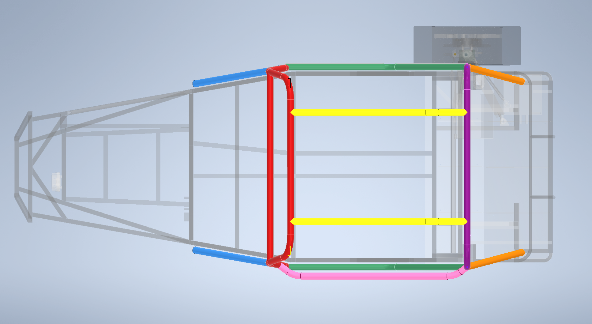

Re: [Driving] Homebuilt Locost 7 - from Motorcycle engine to Leaf power!
Okay, so after some more discussions with various people it has come to light that the BC rulebook requires a roll cage and a fire system for any EV with a bespoke battery. If that's what it takes to finally be able to race, I'm willing to do it. I contacted the one remaining BC club to ask if everything else is sorted out on their end but no reply yet. I would hate to spend all the time and money to add the cage and fire system only to be told I still can't race. It's going to cost thousands.
I've never designed a cage before and I don't want to mess it up, so I got put in touch with a scrutineer so I can hopefully get some clarifications on the rules before I start building anything. In the mean time, I have come up with a rough preliminary design that I hope will pass muster. This follows some examples I've been shown, with some changes made for this specific rule set. Looks like the preferred way of doing it is to have the cage on the outside of the frame and the whole thing can be unbolted and removed to work on the car. There will be an attachment point at the bottom of the red tube, another at the end of the blue tube and possibly a third where the green side bars meet the red tube. The rear stays will also meet a plate that I'll have to weld to the rear frame and brace downward. The pink tube is only required on the driver side.
See how many points of the cage they require first. Insuring the car can get tricky with a cage. You'll want sfi padding if you want to drive it with a cage and ever consider not wearing a helmet. Head to cage impacts are ugly.
You might be able to just do back stays and a diagonal on your roll hoop and skip the rest. Or maybe they will want door bars too.
There is a minimum gap between the door bars for each end as well as a height for the shoulder area. Just make sure those are in spec. This might force the roll hoop to terminate lower into the chassis.
Your roll hoop looks to connect in pretty high up. Be ready to explain how that's tied into a very strong area of the chassis. They may want that continuous to the ground tube with a horizontal tube of similar strength at the chassis bottom.
You may be able to skip the front section of the cage if you can prove you wouldn't be crushed in a rollover without it. This is a line drawn from the top of the roll hoop to the top of the front of the chassis that shows clearance to your helmet.
As you start getting into full cages with no roof they also usually require wrist straps so your hands don't flail outside the cage on a rollover.
For the fire system (if you care) see if they have any that are pfas free.
I see this as a very different conversation with this part,
From there you could have the conversation if a firewall is required on top of the battery that's already in a box and what size square tubing would be required for the battery weight around the battery.
Then, is your square tube chassis strong enough to meet their alternate designs specs in your linked rules while considering vehicle and battery weight,
Basically I'd try to avoid the roll cage and try to focus the discussion on a safety cell around the battery.
In a crash you don't want the battery crushing you so that should be part of the consideration / simulation / design. They will want to see this too.
Sfi / fia has roll cage rules that scca and others reference. This is where you would find door bar spacing specs, number of bends allowed, angles, main hoop height, etc. if you reference this while designing the cage and decide to do a road course someday you'll have considered at least what they would want to see for a roll cage to allow you to run a road course. And realize these are rules for full race cars so it's easy to get really sucked into doing a crazy cage, just realize you're not building a full rally spec cage unless that's something you'd want to do.
It's been 14 years since I built a cage so I don't want to give you any outdated info.
Thanks for the rulebook you linked, but as you said it's light on details. This is good they didn't try to get nit picky but you'll have to make a good case for why your setup is safe.
There's a lot I didn't get to answer on the cage side of things. If you're going that way definitely check out sfi / fia rules for some deeper clarity. You might find some battery safety cell info too.
I'd try to have the conversation that the battery should be viewed similar to a fuel cell and would require similar safety features around it.Zieg wrote: ↑Sat May 03, 2025 5:34 pm Sadly they want the full cage, just because the car has a bespoke battery. The battery must also be 'in the roll structure' so I will also have to run a couple tubes under the hood. It's really not even for MY safety since the class rules don't require it on its own. It's just for the battery.
You could likely do a simulation of the cage with those forces acting on it with your weights. That way maybe you need to add some gussets or maybe a tube here or there to your existing chassis.1.5 G lateral 5.5 G fore/aft 7.5 G vertical

The SCCA SCREV rules keep repeating if a cage is required. I haven't seen where the cage required / not required wording is specifically in the ev specific section of the rules. My assumption is still that the inspectors cage requirement is because your car has no roof, but not positive.Zieg wrote: ↑Sun May 04, 2025 12:52 am
You're right though, the GCR rules apply to all disciplines of racing. Usually they'll specify things like "for autocross you need this and for road racing you need that"... But the EV section doesn't differentiate in its roll cage rules. So yeah, I need a full roll cage to go 100kph alone in a parking lot. Heh.
If the no roof is driving the cage, then it compounds further to the battery in the rules,
Does your chassis meet this where the battery is located? If so the battery safety should be covered cage wise. There's still the battery impact protections and upside down mounting pieces.Vehicles with roll cages installed should add additional bracing to protect the RESS/Battery Pack from side or rear impact. Brace(s) should be equal diameter and thickness as the main hoop.
No, it shouldn't have anything to do with the roof. I believe what would drive the cage requirement is the class regulations. So for instance, any car used for wheel to wheel racing must have a cage, so now all the cage-dependant rules from the SCREV also apply.
I think I could pretty easily argue that the tube chassis of the car serves as the impact protection. But if I had to add a couple extra cage-sized tubes just around the battery, I'd do it in a heartbeat. Even the fire suppression system, fine - whatever. I'm willing to buy one for whatever good it might do. I guess if the battery catches fire and that causes the paint to catch fire, then the fire system could give me an extra few seconds to get out of the car. Or if there's some kind of electrical fire from the 12v system, the fire system could put it out before it reaches the HV battery.
I.. just sent a message to someone selling a cheap formula car. I can't bring myself to sell this car, but what I might do is sell the battery, enclosure, and BMS. That should help offset the cost of the formula car (a bit, anyway), and in a couple years when regulations hopefully catch up, I can sell the formula car, re-buy the battery and be ready to rock.
- Posts: 567
- Has thanked: 199 times
- Been thanked: 165 times
For wheel to wheel, no question, you'd need a cage. I meant from the research I did I couldn't find where it said you needed a cage.
Do you know where the specific wording is or did the inspector quote it? Or is it that the SCREV doesn't call out autocross?
The rules seem pretty poorly worded for EVs currently.
I really hope you find a way to work through this. The ice route is good to keep you in competition, it's just disappointing.
Oh, sorry, I should have linked that part too. There's an appendix right at the end of the CACC general competition regulations that resembles the SCREV, except that some of the wording seems to match the draft SCREV rather than the version that was actually adopted.
https://www.caccautosport.org/wp-conten ... ations.pdf
Thanks, I hope I can find a way through this too. Sitting on the car and getting an ICE is definitely not ideal but in my weaker moments I feel desperate enough that I might do it. I'm glad the CACC as a whole is pushing for a path forward to race EVs in Canada, too bad the club in Kelowna still doesn't want to play.
Interestingly, the SCREV has extra requirements for the thickness of the battery enclosure and a few other things which are absent from these rules.22.2.5.1 Custom Battery Packs, or OEM battery packs that have been modified in any way, may
only be installed in vehicles with a roll cage. The complete battery pack must be inside
the roll structure. Battery packs must utilize commercially available cells/modules. It is
prohibited to modify individual cells except for the tab connections to enable
connection. Individual cells/modules must be securely fastened together and mounted
in a protective enclosure. The enclosure mounting system must be able to contain the
battery pack in a vehicle crash, and the cell/module retaining system should prevent
shorting of any High Voltage components

Alright, I'm planning a trip to the USA. I know I said I was nervous about crossing the border but after some more thought and research it seems like regular old Canadians aren't having problems. I contacted the organizers and they were perfectly fine with the car as it sits, since it meets the SCCA rules*. They didn't know about the supplemental EV rules since all their EV entrants have been stock production cars, so they said they might have me give a little briefing on EV safety so they can learn. Awesome! From watching some videos, it seems like they have some very interesting course layouts too, since they have a large area to run on.
*After some extra digging and discussions it looks like I have to run the car in the A-mod class, which is the fastest available. Cars get classed according to performance and modifications so that in theory, the same person could drive a well-prepped car from any class and after the class multiplier (PAX) is applied, the lap time would come out the same. This is how you have civics with good drivers beating Ferraris with bad drivers. The funny thing is it appears as though the thing that takes me from E-mod to A-mod is the fact that the motor is in the back of the car instead of the front like a real Lotus 7. lol. I told them I really didn't care about that at this point so A-mod is fine. There's one tiny snag that my seat belt doesn't comply with the stricter A-mod harness requirements, but $400 and an hour of my time should solve that.
Now I need to do a bunch of prep work! My hauler needs an oil change and a once-over before making the journey, and I have to go get some supplies. I'm planning to stay in an RV campground and sleep in the back. I am NOT a camping person so this will be.. interesting. The camp site I want to book has 120V so I can power a space heater, and it has a restroom/shower facility. I'm planning to bring a hot plate so I can cook, a cooler with food, water for drinking/washing, and a hammock. I have never slept in a hammock before but I believe there will be room to string it up in the back, over the car. Backup plan would be to sleep in the front of the truck or in the passenger seat of the car itself, since the seats are actually pretty comfortable. If I need to recline a bit I suppose I could jack up the front of the car. LOL.
So yeah, lots of unknowns here and I'm going to be outside my comfort zone in several ways, but hopefully it all works out. I also couldn't help noticing there are more CCS stations within 20 miles of this place than there are in my entire city. Was worried I'd have to L1 charge over night at the camp site, but I guess I don't have to worry about that now!
Did a test run with the new ramps I made, worked like a charm!
