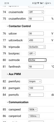

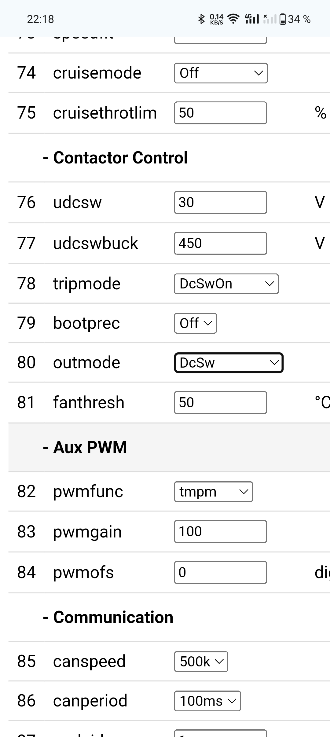

I noticed the appearance of a new feature (80, 81).
do I understand correctly that this can control the cooling fan!? if so, at which exit will it be +12 or gnd?evil neodymium
- Posts: 6709
- Has thanked: 368 times
- Been thanked: 1536 times
Re: Inverter Firmware 5.35.R
This can be used on the DcSw positive contactor output. So only when you have other means to control the latter
