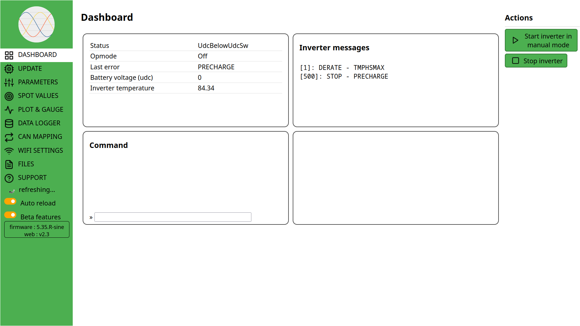

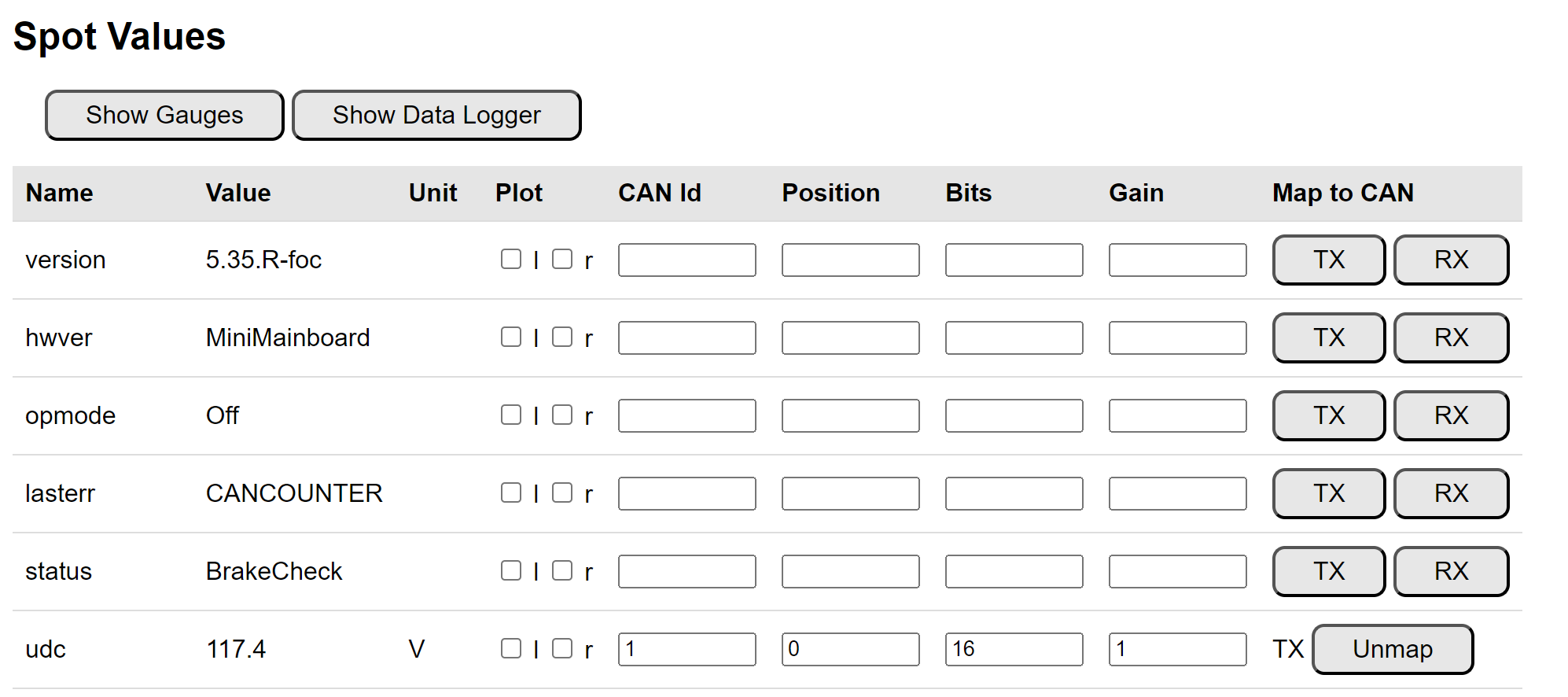

Upgraded directly from 5.27. What does 'BrakeCheck' state mean? Currently attempting to send brake over CAN, though I would think there should still be a way to use the physical brake input without using the CAN messaging.
Also, how should I implement the CAN crc, given that the example is given for a 32 bit calculation, but our input value here is 64 bit? Here's the example from the wiki, should I just change it to run for 64 bit values and then still use the lowest 8 bits or is there more to it?
static uint32_t crc32_word(uint32_t Crc, uint32_t Data)
  int i;
  Crc = Crc ^ Data;
  for(i=0; i<32; i++)
    if (Crc & 0x80000000)
      Crc = (Crc << 1) ^ 0x04C11DB7; // Polynomial used in STM32
    else
      Crc = (Crc << 1);
  return(Crc);
params (1).json
(1.56 KiB) Downloaded 678 times
Been thanked: 1918 times
Re: Inverter Firmware 5.35.R
BrakeCheck means it wants to see the brake input go high once.
For CRC you fill your 8 bytes/2 words and leave the CRC byte at 0. Then take CRC of the 2 words, mask it with FF and put it in the last byte. Like here https://github.com/jsphuebner/stm32-car ... r.cpp#L471
You still need to implement a 2-bit counter to get rid of the CANCOUNTER message

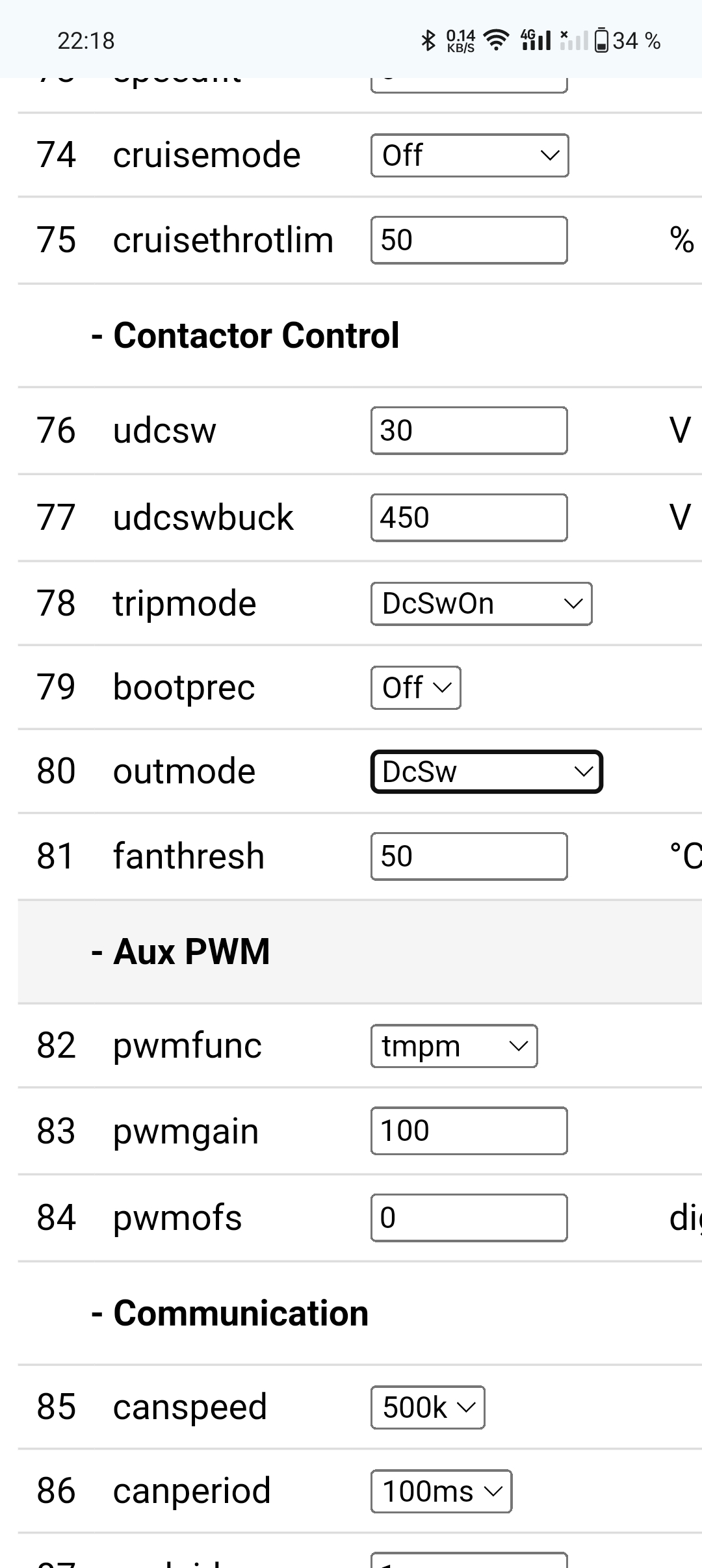

Hi, for FOC implementation, only way to tweak field weakening seems to be fwcurmax since ffwstart is deprecated. I would really like to have some way to control the startup as I'm using field weakening to get higher RPM on my boat propeller. Now field weakining kicks in pretty much from start, so going from 0 RPM to MAX RPM within only a couple 100s difference in Pot. If I carefully find the lowest Pot that will spin the motor, it has a lot of oscillation. For the SINE implementation there is parameter fweakstrt with description "Fweak value at potnom < 35%. Can improve low speed stability and reduce oscillation when set higher than fweak. Set equal to fweak to disable." Something like this for FOC would be great. Or is there a way to do it with the current implementation?
Have you tried "boat mode"?
I'm currently away but I think it's activated by setting cruisemode to Pot. Then set speedflt=0 or maybe 1 and tweak speedkp until you have stable rotation. Would love to hear back from that

Thanks. Will test, but not at the boat ATM. If I do not apply field weakening, RPM increases linearly with POT up to max RPM (about 850 on 48V), so I'm also thinking about setting fwcurmax over CAN when I want more RPM than 850, but haven't tested if this will take effect immediately or if it requires a reboot.
It will take effect immediately so you should increase it slowly
