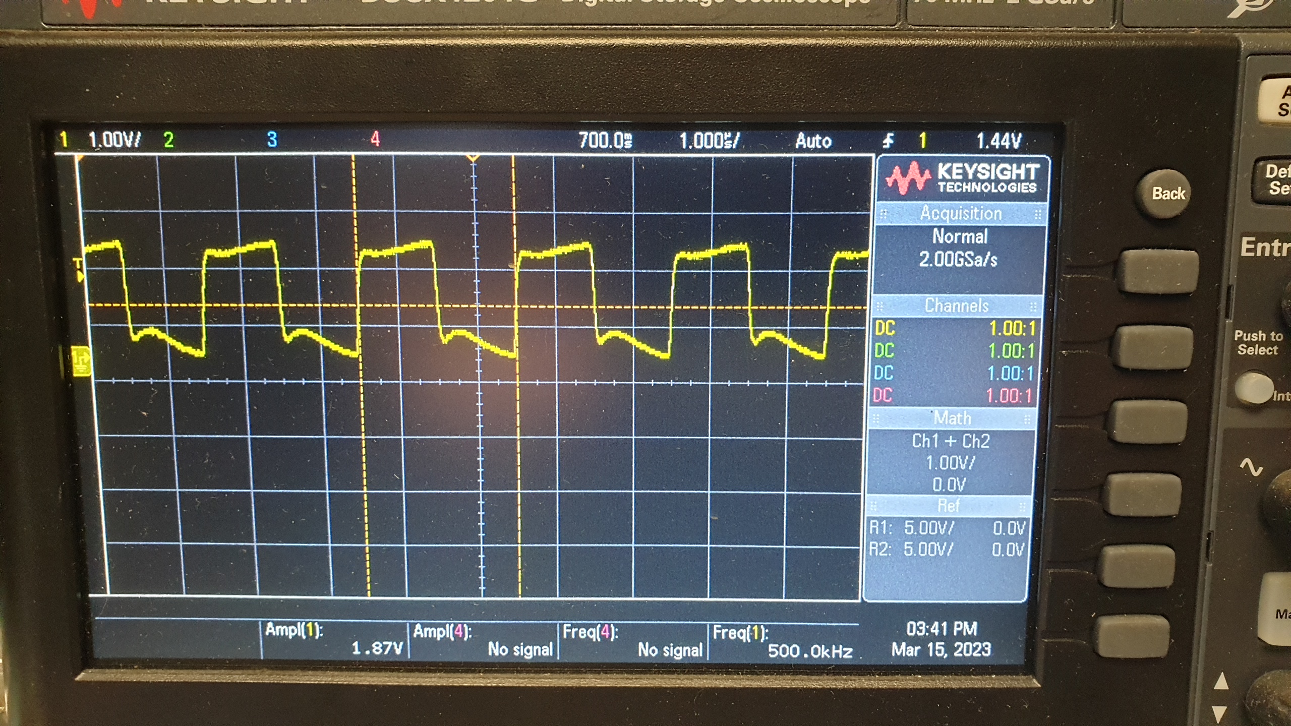

It would be good if you could.
The difference is best seen when looking at the differential signal between the two conductors. If it's unipolar (returns to zero) then it's CAN, if it's bipolar then it's RS422/485.
Edit - that's assuming that they haven't added extra non standard pull ups/downs at either end!

Re: Communicating with the Lexus GS450h Inverter/Converter
Damien did a differential measurement (attached). Looks like it's 2V differential and returns to zero, which seems awful, but if that's what it is and it works, great! I would prefer to see the individual signals with reference to GND to confirm, so will do my own measurements too. It does seem like it might be CAN though.
I based my assumption on the IC pinout and the logic levels as well. Could easily be another type of transceiver.
The fact that CAN transceivers at the other end seem to work perfectly to communicate with this unit is another thing in favour of the theory that it's CAN transceivers in there.
