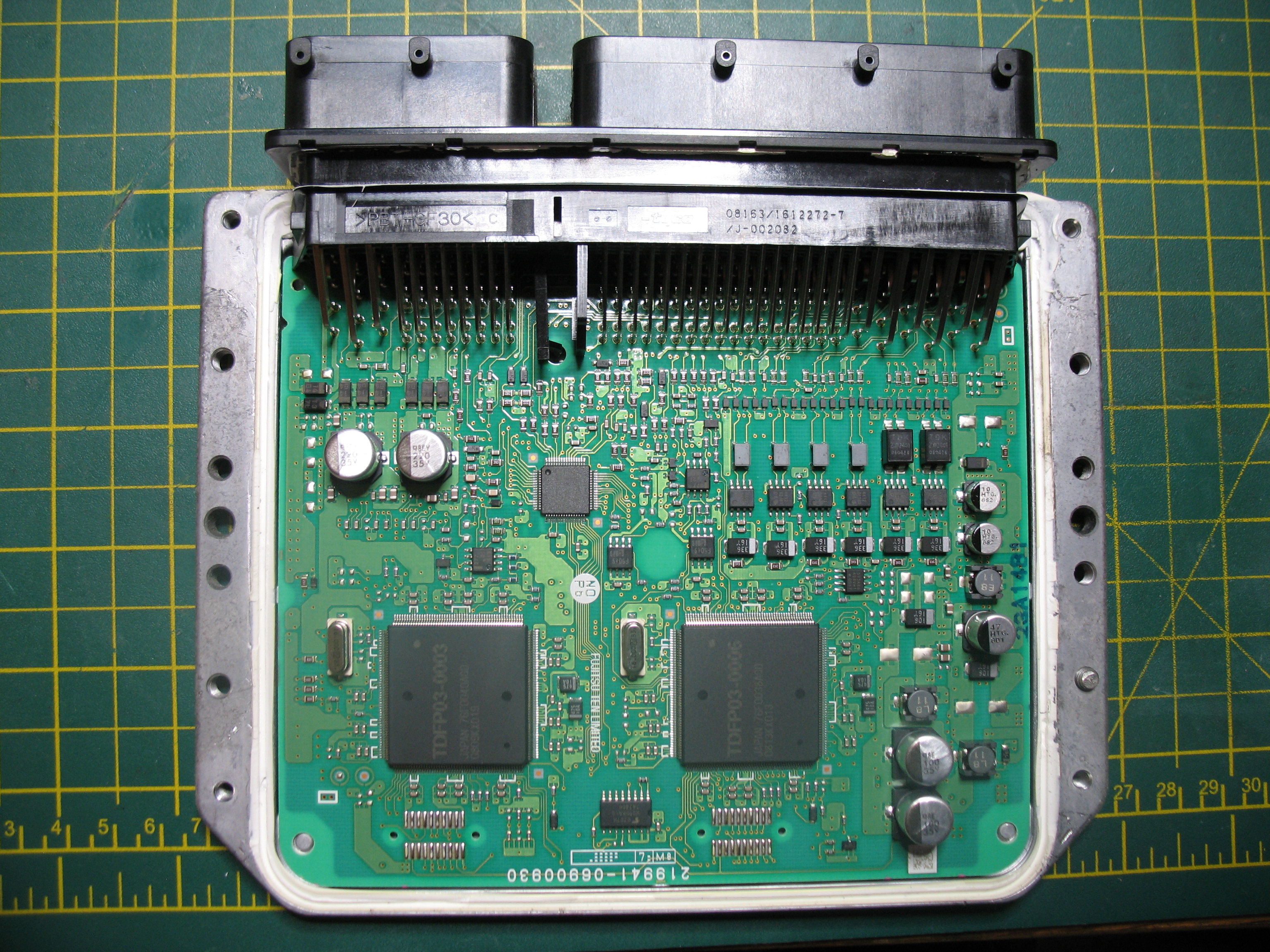

I pulled the unit apart to inspect the board. I drew a brief schematic for the relevant parts:
The board appears to use a proprietary transceiver, a DENSO SE617. There is no datasheet for this unit. I guessed the pin names from examination of the board.
A pair of 62R resistors with a capacitor to ground, and a common mode choke (actual part number is ZJY2401) provides the only protection and noise suppression.
The microcontroller used is a NEC 76F0080GC. Again, no datasheet or specs for this.
The 5V rail for the transceivers is shared with the microcontroller, the resolver-to-digital converters, and some other parts, here's a brief look at it, I didn't examine too far, I guess it's a buck converter from the 12v input. Not much in the way of noise suppression?
I'll likely piggyback off of this 5V supply for my own controller.

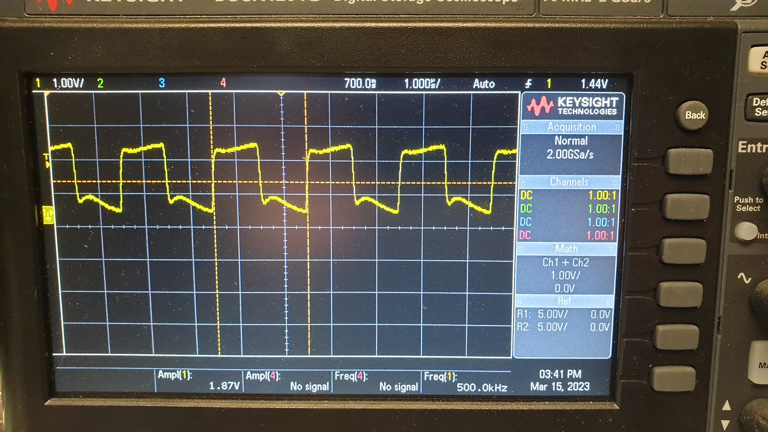

  • 250KHz square wave to CLK+ and -
  • 250Hz square wave at 25% duty cycle to REQ+ and -.
  • Logic analyser to CLK, REQ and MTH. All 3 of the - line are tied together by this, they don't seem to mind (they really do mind if you do this on the car, however!)

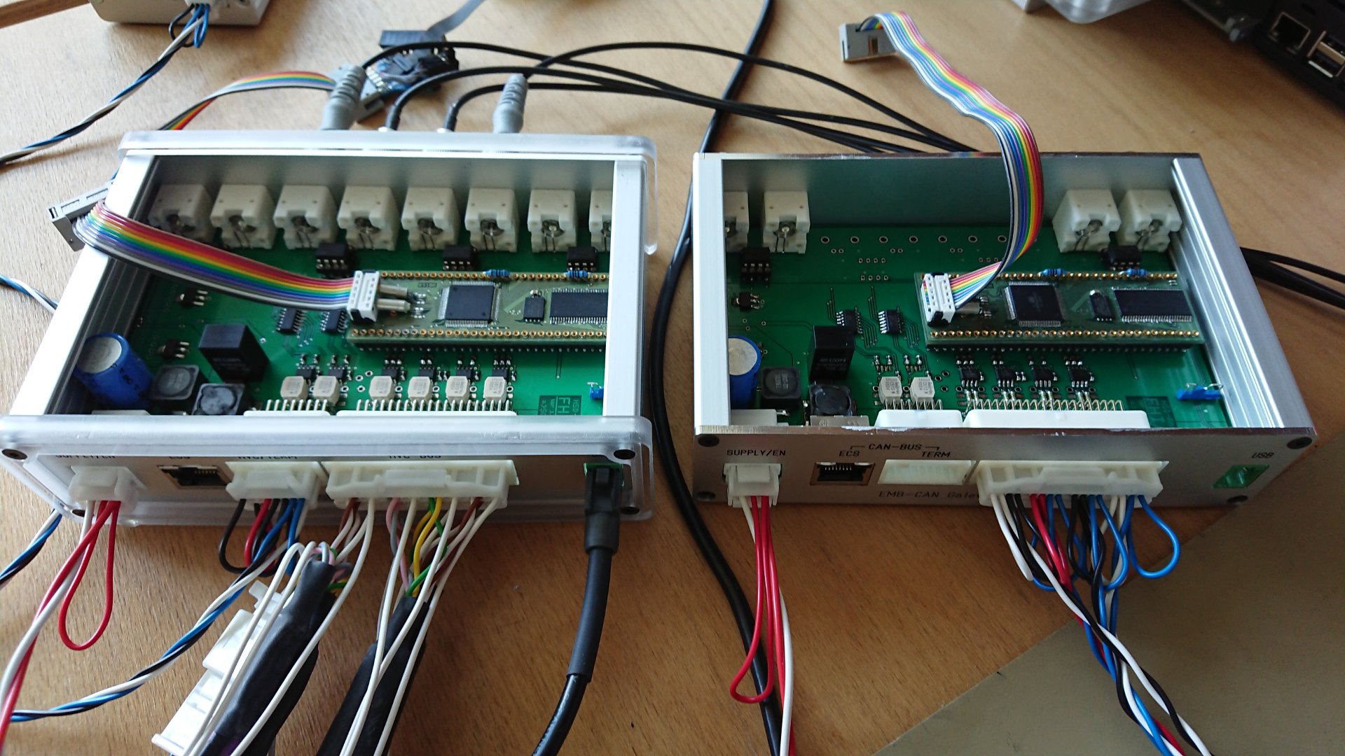

Hi @all,

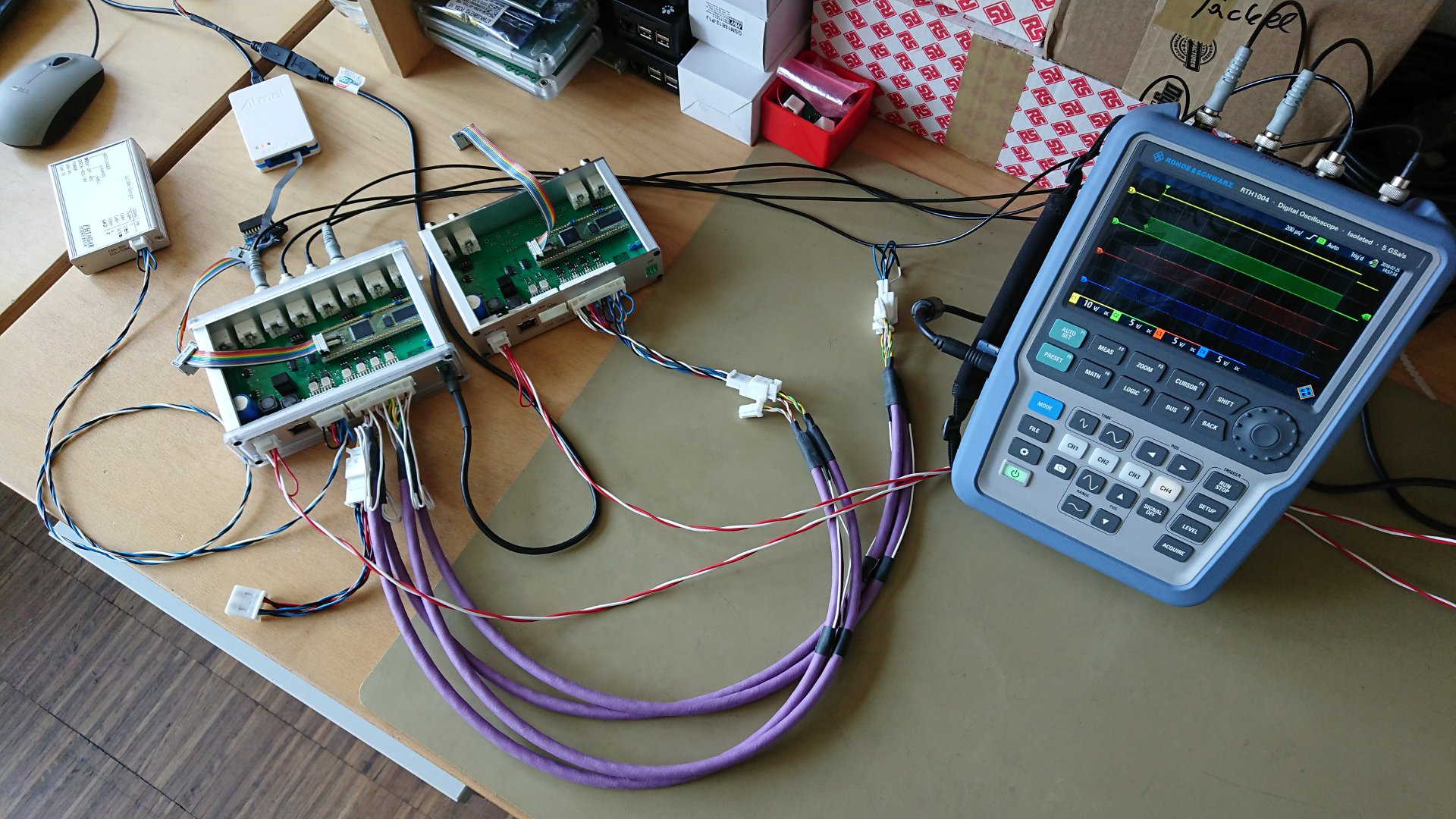

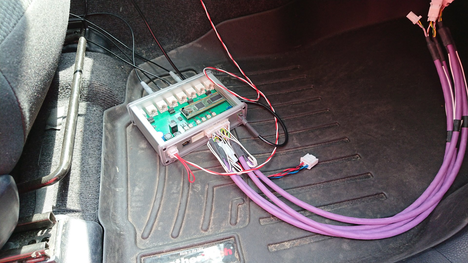

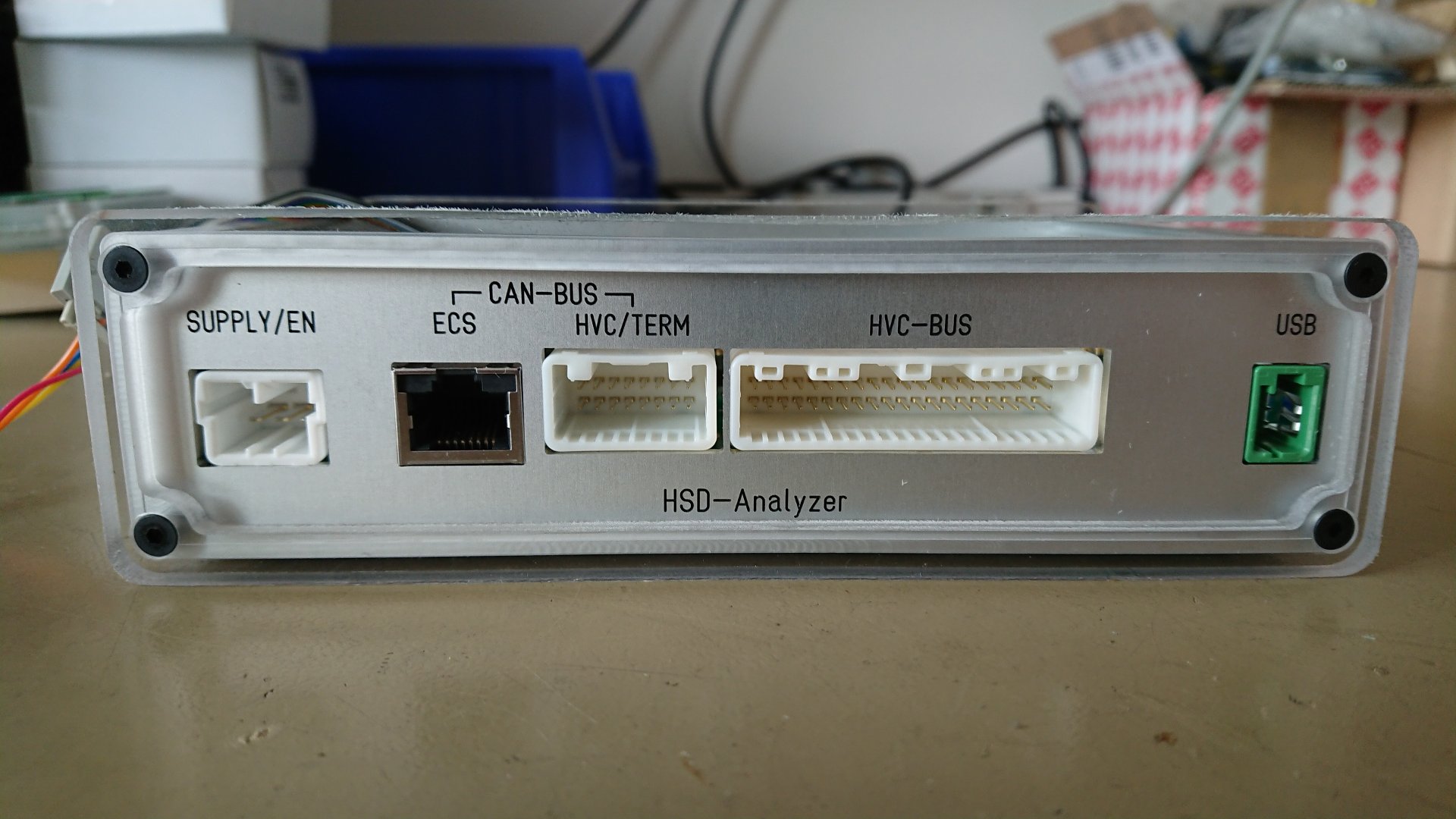

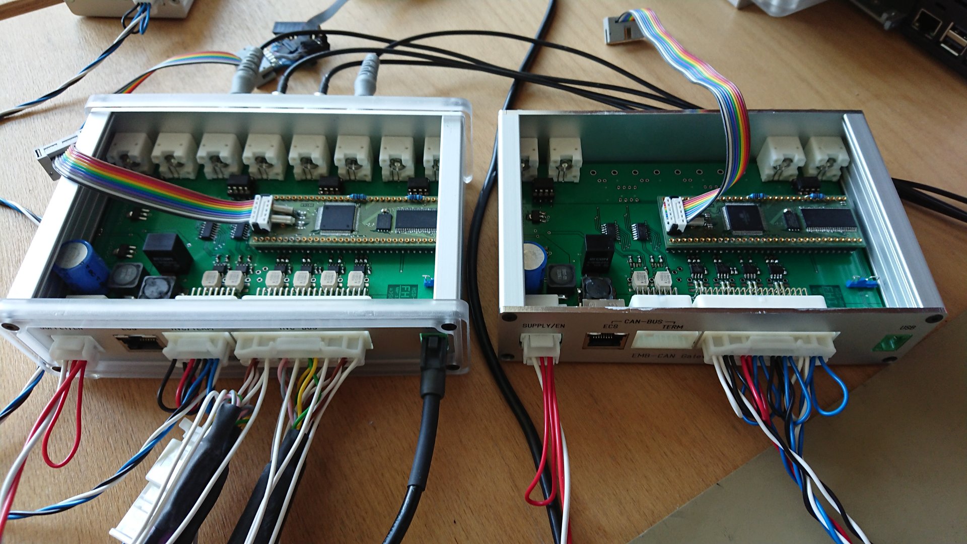

that's great that someone else is working on the GS450h/LS600h system. With Bigmouse his help we got the transmission / inverter running with our own control module.
It's not SPI, it's a synchronous serial communication. You have to use a micro-controller with USART for that. So the Teensy doesn't work, but a Arduino Due does.
CLK is continues 500kHz regardless of transmission. Transmission and reception is not aligned. transmission starts on falling edge of REQ and reception some time after rising edge of REQ. It doesn't matter how narrow or long the REQ pulse is.
You can use basically any 5V CAN transceiver for that (4 of course, one for each signal). Because most transceivers have a dominant time out detection after 1ms, you REQ pulse can not be longer than this 1ms. That's like the OEM Lexus/Toyota timing. You can make it much shorter, if you want.
I used an ATxmega128A1U with external SDRAM for testing and capturing the HVC-Bus datastream. The USARTs with connected DMA channels work really great for the HVC-Bus.
Transmission data are 80 bytes, reception 100 as far as I remember for the GS450h/LS600h. The last 2 bytes are the checksum over all data bytes.

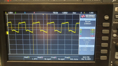

Transmission data are 100 bytes, reception 80 as far as I remember for the GS450h/LS600h. The last 2 bytes are the checksum over all data bytes.
A big problem is enabling and controlling the internal HV DC/DC converter. Up to now we didn't get this working. But would be helpful for supply 288V to the 12V DC/DC converter, AC compressor and heater. A lower voltage battery charger could be used for charging the HV battery pack if this is working.

synchronous full duplex USART communication
one start bit - 8 data bits, LSB first - one stop bit
checksum = byte80*256 + byte79 (most significant byte: 80, should be little endian)
checksum calculation = byte1+byte2+...+byte77+byte78
Use a 5V CAN transceivers (like in your schematic of the inverter) which have 3.3V IO levels. For me the Microchip MCP2562FD-E/SN (separate IO supply pin) works great. It's an CAN-FD transceiver, but that doesn't matter.
Arduino doesn't support synchronous USART configuration, but it's easy to enable this (for DUE):

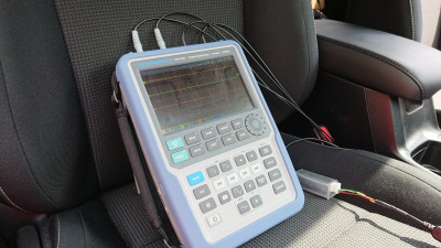

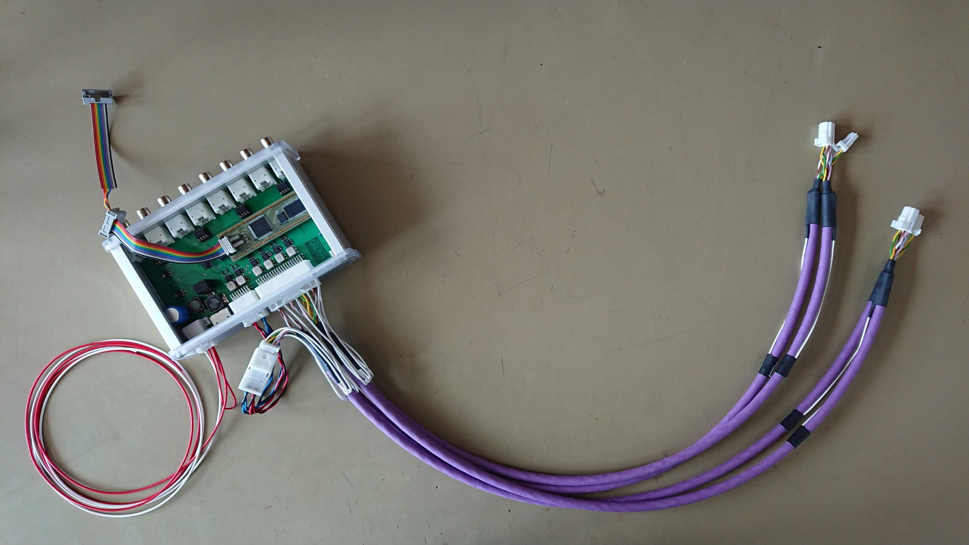

HSD-Analyzer for monitoring and simulating the HVC-Bus. Uses an ATxmega128A1U with 4MB SDRAM attached and USB serial port connection for capturing/transmitting/receiving data. Can act as Sniffer for both HTM and MTH, as master (HVC-ECU) and as slave (INVERTER):

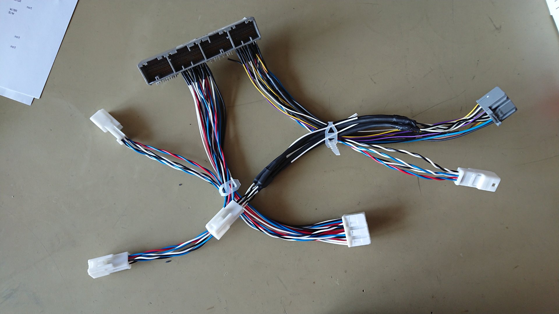

Adapter for the OEM wire harness for sniffing the HVC-Bus datastreams. Works for the Toyota RAV4h (Gen. 4) and the Lexus LS600h (basically the same system as the GS450h):

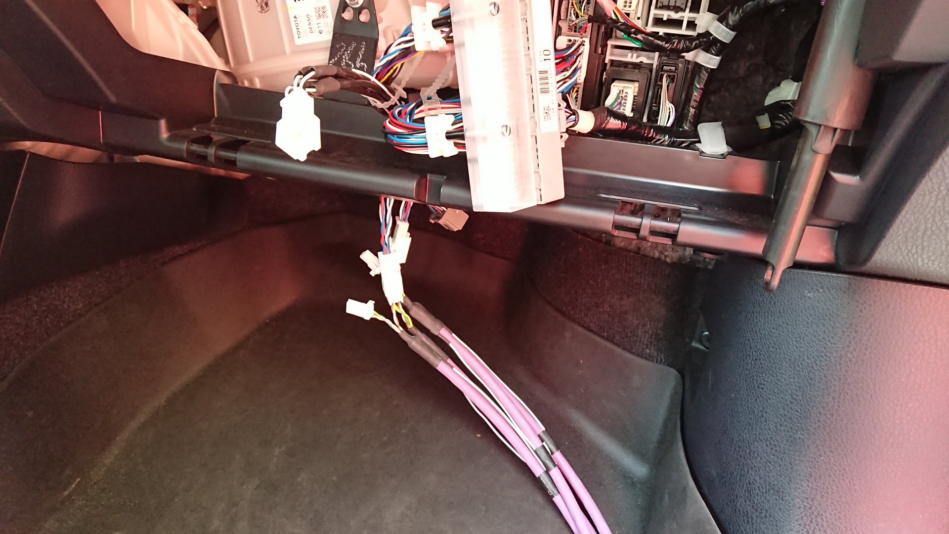

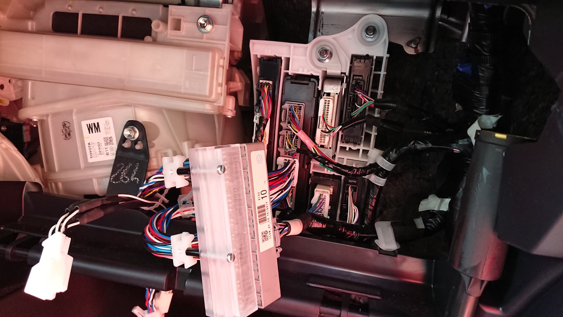

Sniffing data in my RAV4h:
2004 Toyota Hilux KDN165 Double Cab conversion - using Lexus LS600h transmission and inverter.

Data stream is different for the RAV4h because it has 3 inverters, one additional for the rear axle motor and a built-in 12V DC/DC converter.
HTM data bytes: 105
MTH data bytes: 140
But I have access to a LS600h from a Toyota dealer if necessary.

Great job on this! One question, is the connector you used the same as the one on the inverter PCB? I have been trying to find the part for this. I believe that it's a TE TH025 series. I have ordered a single female pin, TE part 1123343, in the hope that it fits the housing (the dimensions seem to match an existing pin).
I need to extend the original wiring from the inverter logic board to the external connector (which I will replace with a more common connector, currently looking at a 31-pin Deustch connector as Ampseals in that pin count seem a little large).
