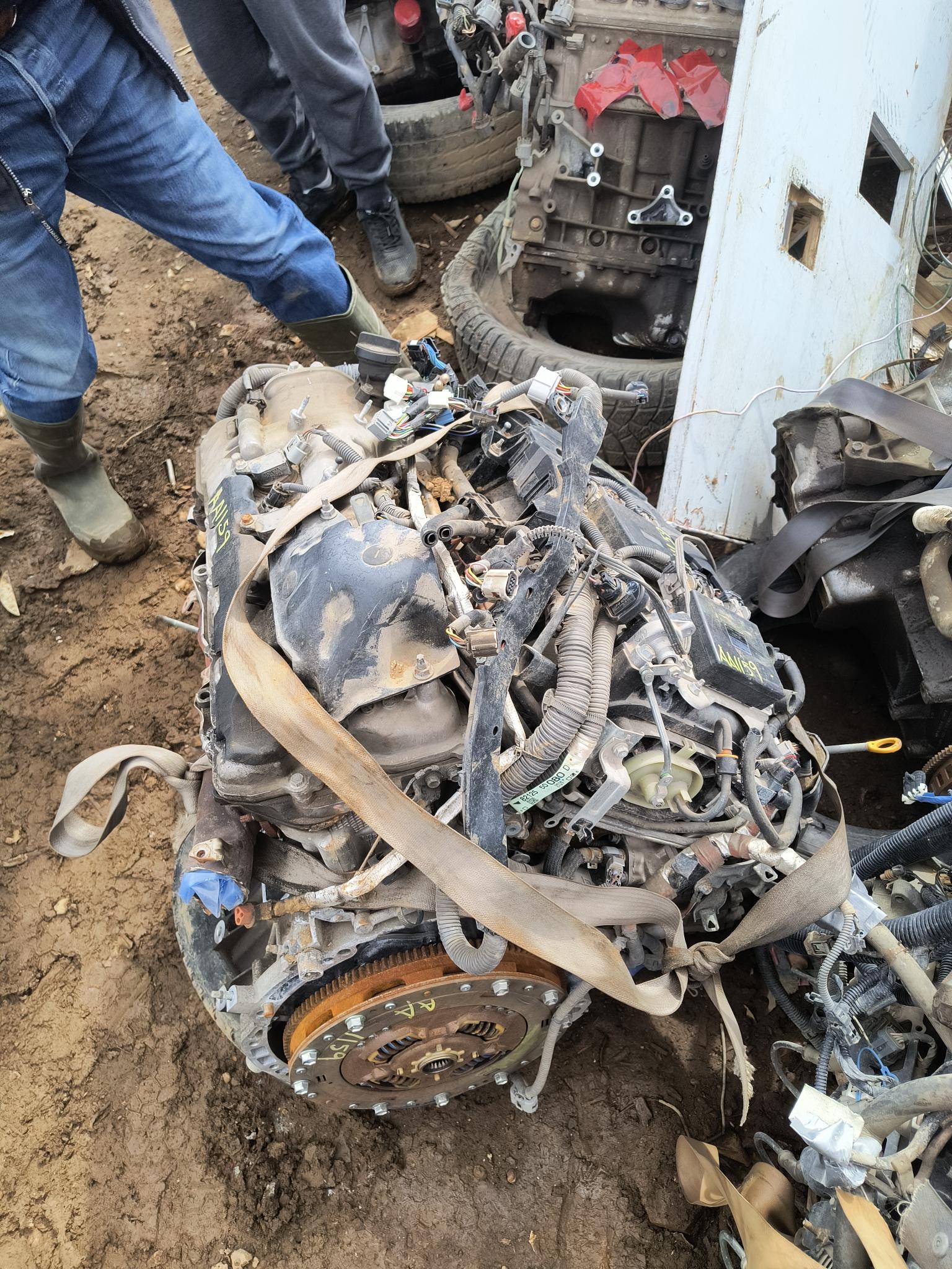

He has the engine separated with its own wiring loom and whatever else. He doesn't seem to want to break up the 'engine' component and wants to sell it whole. So the damper might be part of that. I'll have to see if my son took a picture of that end of the engine. These are the ones I took.

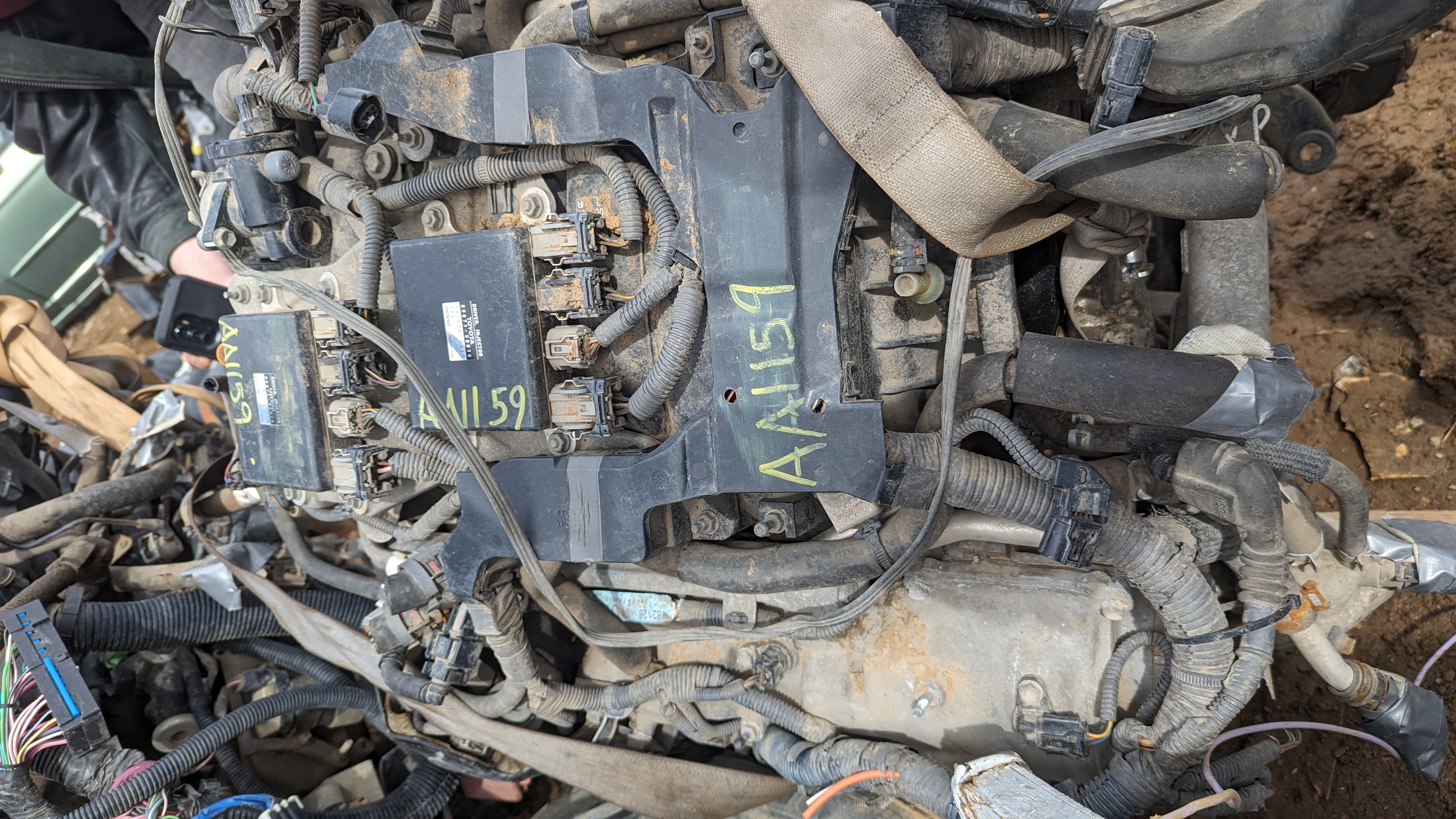

My son's photos show the damper assy bolted to the back of the engine. I've added it to the list of things I want from the wrecker but I'm doubtful he'll separate it. I'm also afraid there's wiring on the engine that I'm going to want.
@robertwa, this photo from your thread:
shows a harness that looks identical to the one I see at the top of the motor in my son's photo. It looks like you combined it with the harness that has the resolver runs? I can only read some of the masking tape in this photo:
Edit4: ok. After comparing Greg's photos, it looks that's a critical harness. Crap. This wrecker guy is going to make me buy the whole motor. I just know it.

It's for sure much easier to get the 2 full harnesses if you can. Although you can get them elsewhere if your guy won't cut you a deal. The GS450H harnesses share all the same critical connectors, they just have a couple differences - 1) the main inverter plug is the same part, but pinned differently, and 2) the connector between the two harnesses is different, but not a big deal as most end up changing the length anyway.
Here is a LS600H transmission harness currently for sale with resolver connectors:

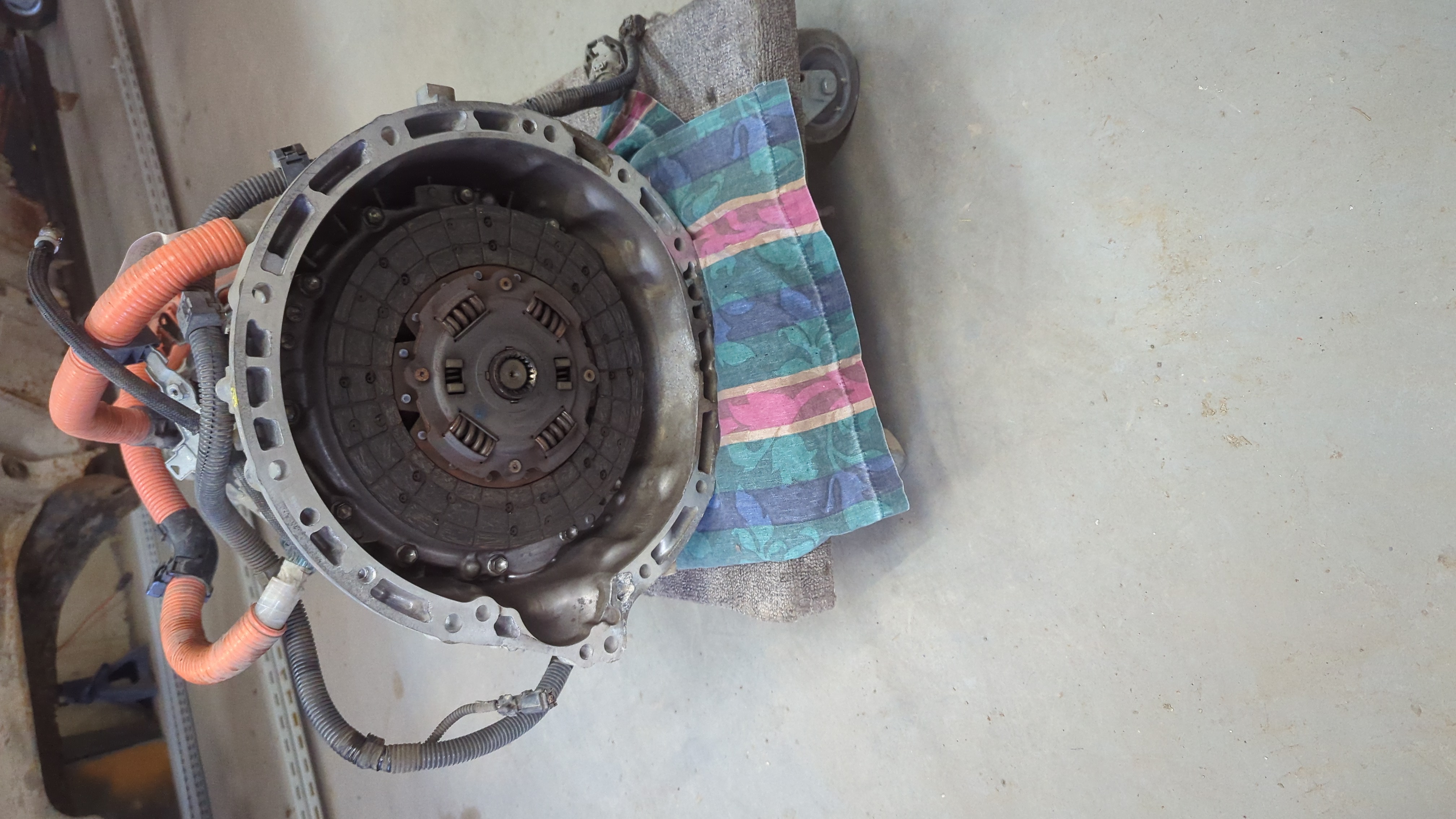

Thanks. I tried to measure my old H55F clutch plate yesterday but it's still attached to an engine in a pressure plate. I'll be dismantling that today.
I went down to the wrecker yesterday and picked up the transmission. He wants $900CAD (around $650USD) for the Inverter which he came up with by checking eBay. So $900CAD is cheaper than what I'm seeing on eBay before shipping. There's probably some value getting the inverter from the same vehicle that the transmission came from. I'll have to put that off for a bit (hobby budget).
I also grabbed the Ford Escape battery.
He definitely wouldn't separate the wiring harness from the engine so $200 (plus $100 international shipping yikes!) seems the way to go. He also wouldn 't separate the damper assy. Wants $2000 for the engine.

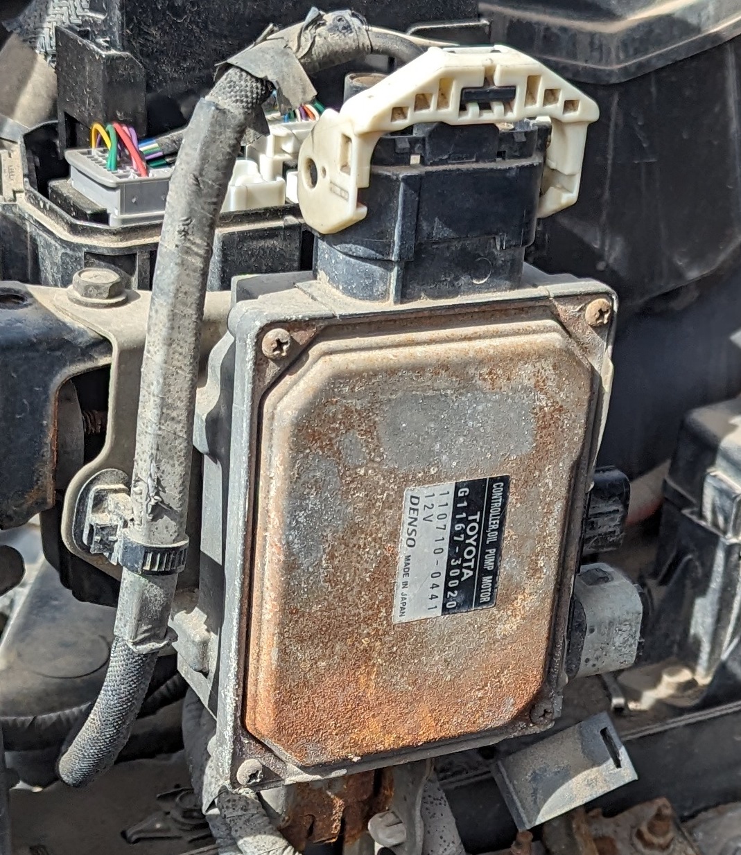

I found the oil pump controller. Nice and accessible but has a lot more connectors than I would expect from something that probably just generates a PWM signal. There must be more going on in there then I imagine.

So this makes my day... This is the clutch disc from a 1980's Land Cruiser BJ60 (in case some future Google searcher is looking for this). The 3B diesel manual transmission have an input shaft that seems to be a perfect match for the LS600HL input shaft. There is no discernible play.

Re: the oil pump controller it doest have many connections (5-6 wires from memory) and you only use a few of them also. Are you sure you were looking at the oil pump controller?
ok. I've put it on the Wiki on the GS450H page. There are a handful of crosses to other Denso applications as well like Isuzu etc.
This is what I was looking at.
I didn't remove the large connector though, which seemed overkill for what I imagine the thing does. I see now (while editing the Wiki) there's actually good section on the oil pump controller.

https://photos.app.goo.gl/TPJhsGkttbBnSQpf7
Now I just need to 3D print an adapter plate (just kidding, I'm going to make it out of Maple).
