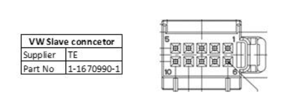

Looks like this family:
check for the correct key (altough you can cut some tabs to make them fit)

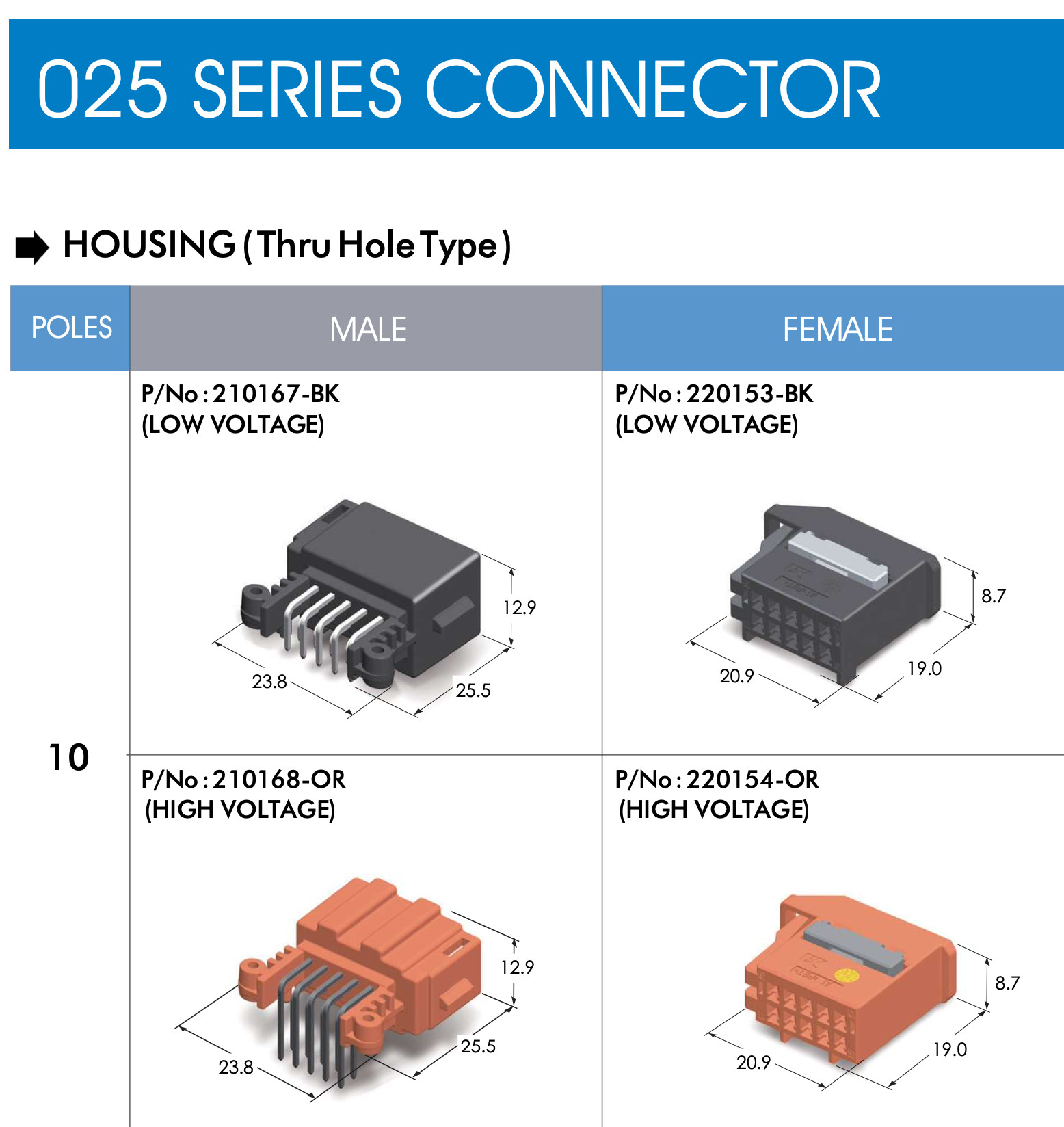

Stumbled across this while looking for the same thing.
Manufacture: YURA
Source: https://www.diyelectriccar.com/threads/ ... ry.208274/
