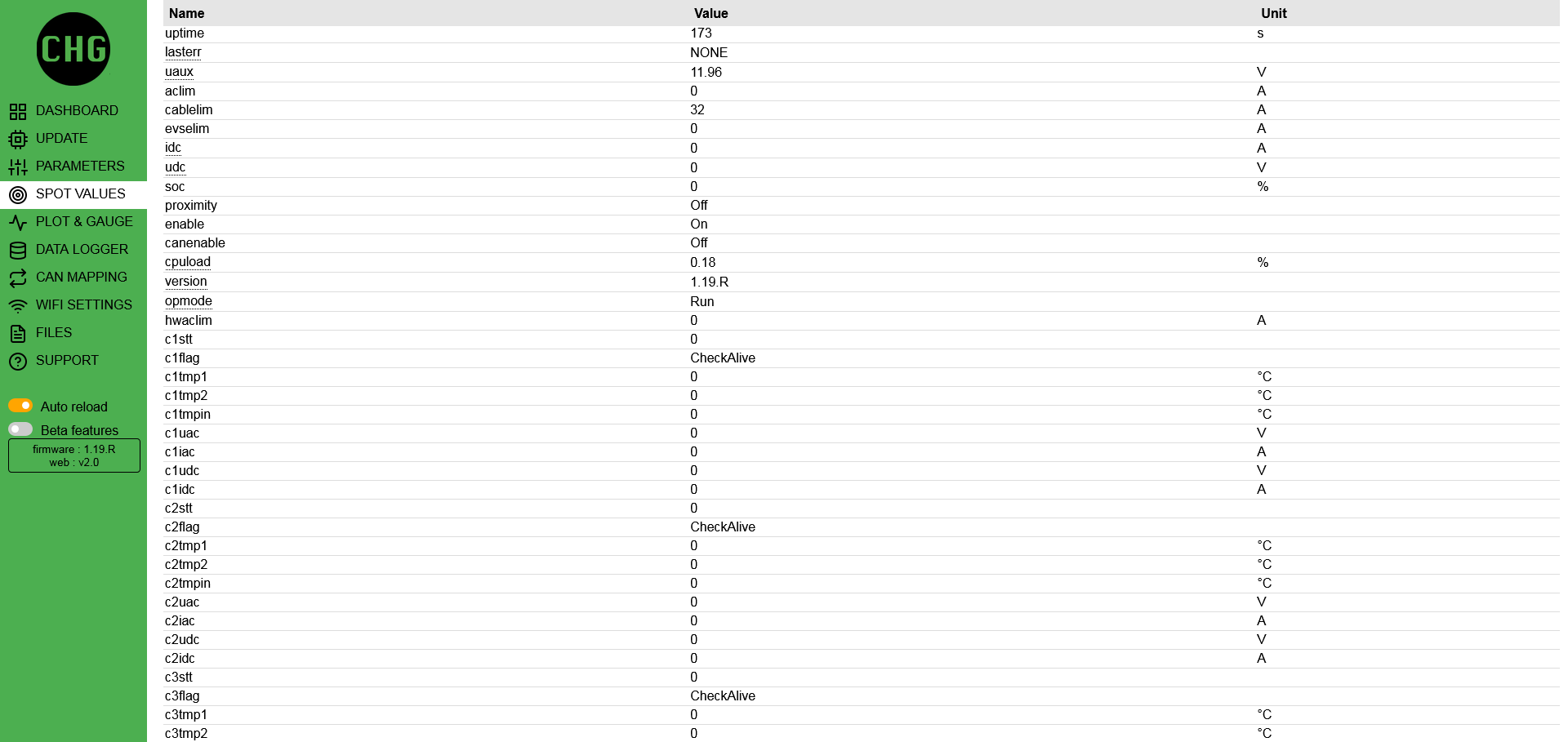

medo wrote: Sat Feb 15, 2025 1:56 pm o CAN messages come from the modules
You make a CAN log or just relying on the controller telling you?

yes, in the web interface I only see check alive if it is active, but no values, also in savvycan, I only see can messages that come from the controller, but not from the individual modules

I still can't get the Gen3 to work, now I suspect that a battery must be connected, without it I don't get any values ​​displayed, is that right?
medo
Posts: 207
Joined: Thu Dec 07, 2023 9:32 pm
Location: Kosova
Has thanked: 21 times
Re: Tesla Charger Support thread gen2/gen3
Post by medo »
I investigated further. If I only connect the 12-pin connector to the control unit, I measure exactly 120 ohms on the module between pins 5 and 6. If I then connect the 20-pin connector to the control unit, I only have half that, i.e. 60 ohms. When I then switch it on, the resistance jumps between 60 and 400 ohms, and the module immediately goes into run mode. I've now measured the pins on the module. Pin 3 on the module has 5V and pin 4 has 0V. If I now switch the control unit to run mode, pin 3 on the module has 5V and pin 4 has 3.3V. I get this 5V from the module pin 3 to the control unit pin 6. It seems to me as if that's too much. Something isn't right here. Does anyone have a solution or what I can look for?
