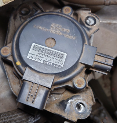

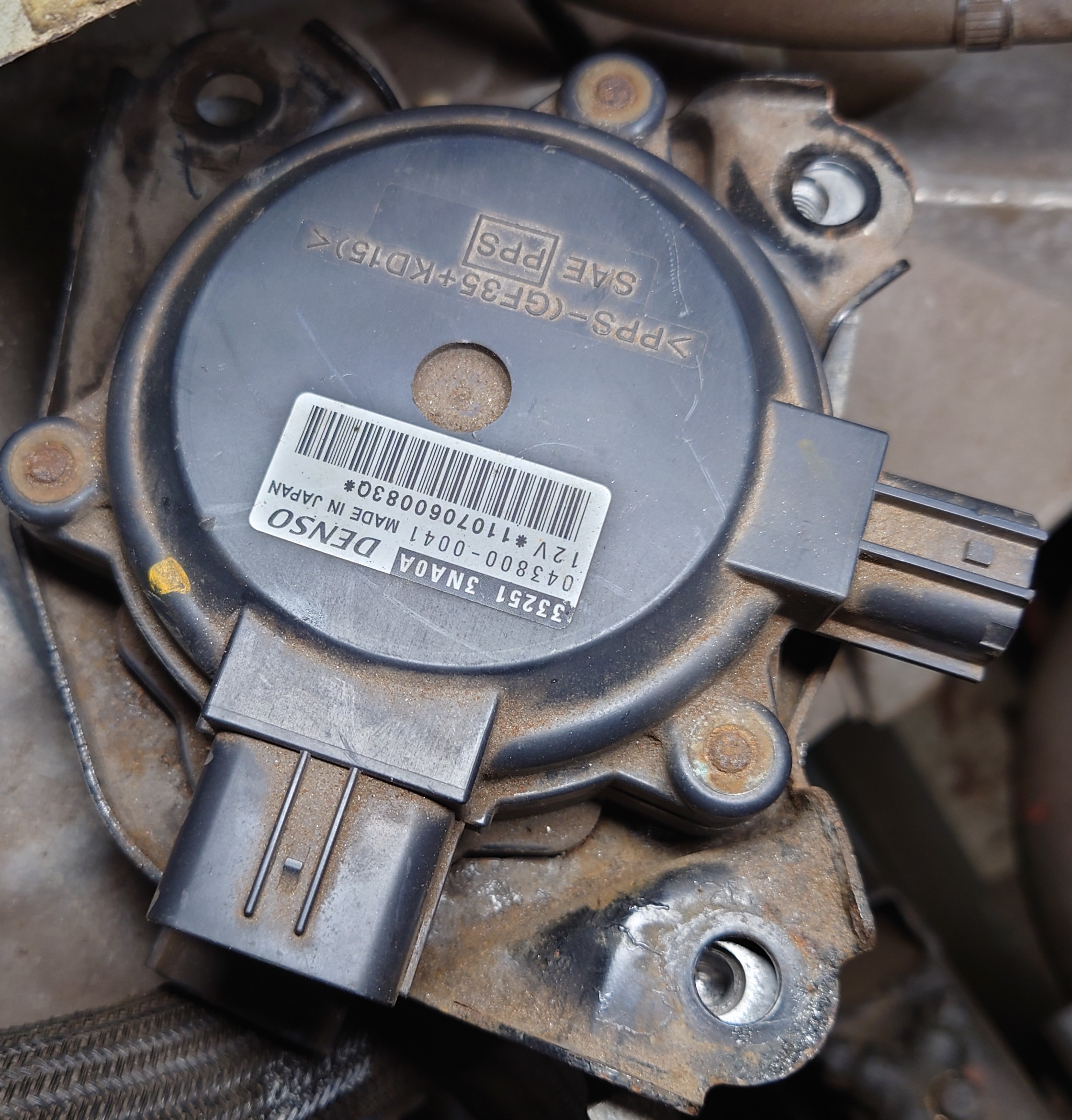

This is a fast and easy way to get EM61 motor out from PARK. (Maybe works just the same with em57)

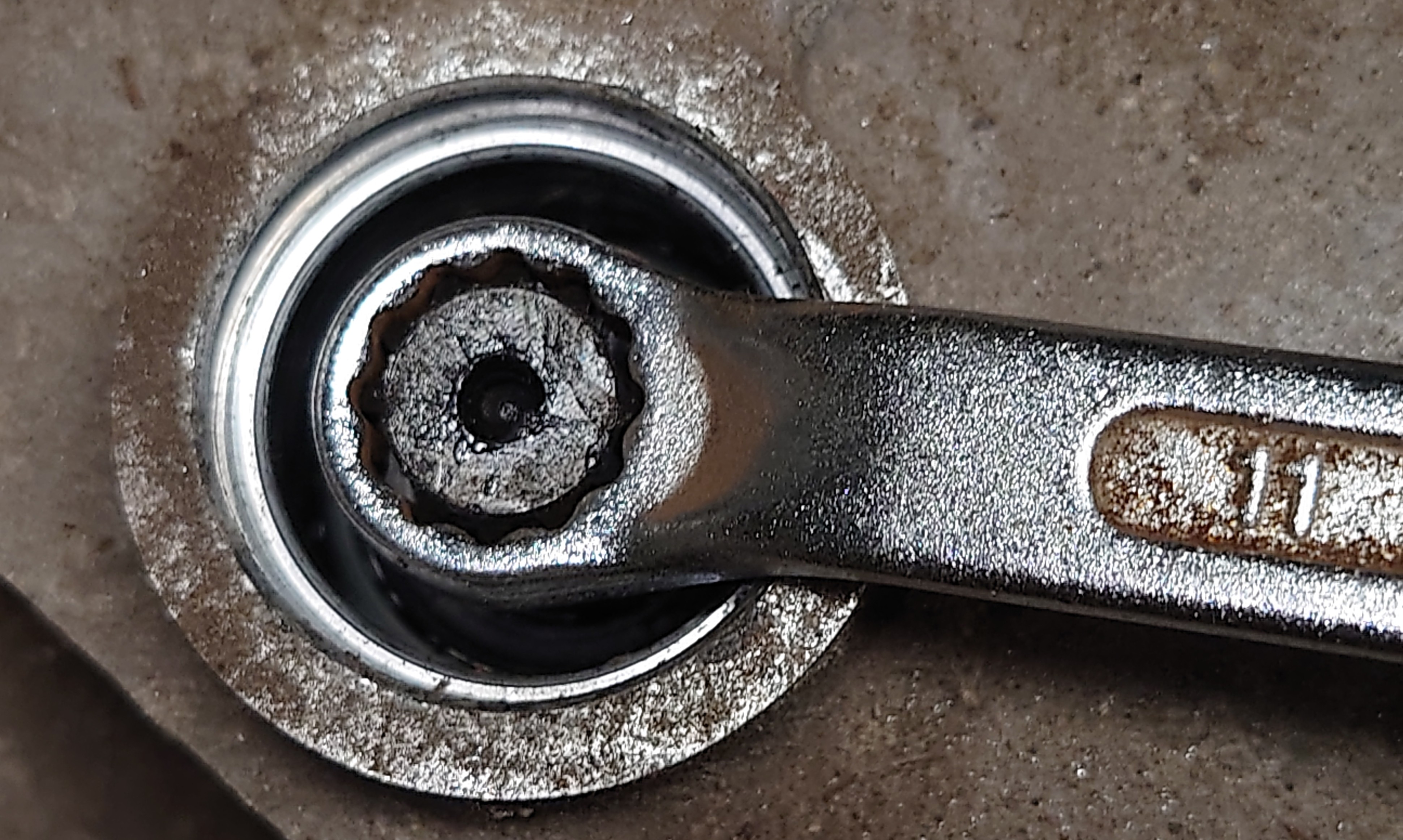

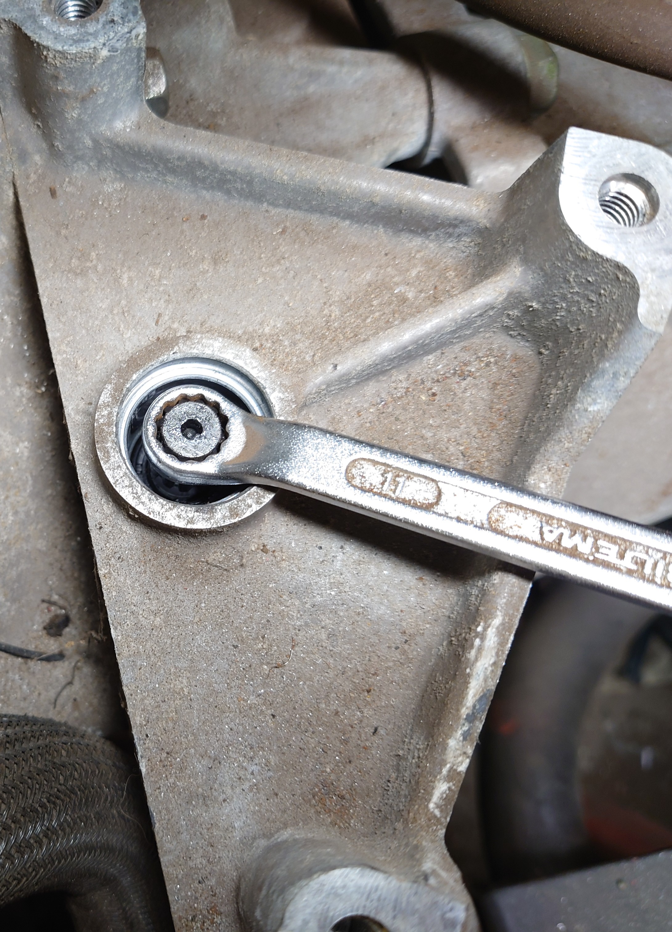

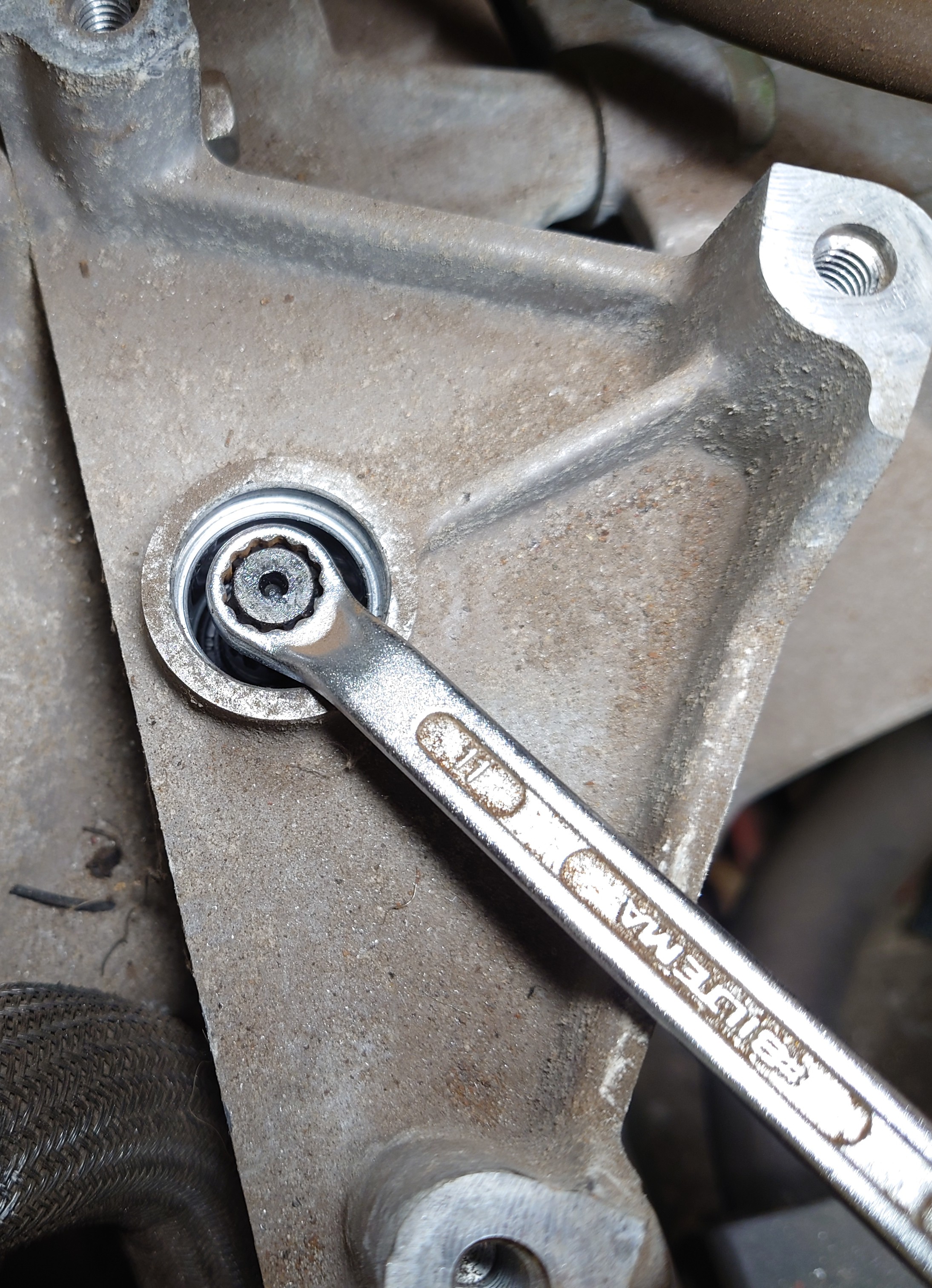

When removing the nissan assembly, it is possible to just change The P lock with a 11mm spanner.
Here is pictures of the 2 positions it goes to:
D = DRIVE _-_-_-_-_-_-_
-_-_-_-_-_-_-_
P = PARK
-_-_-_-_-_-_-_
P = PARK
