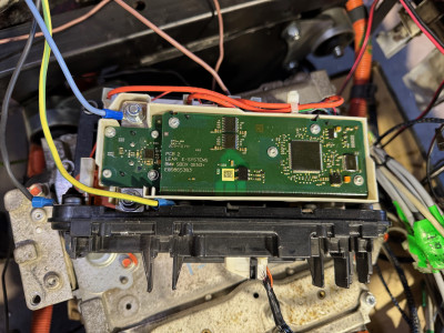

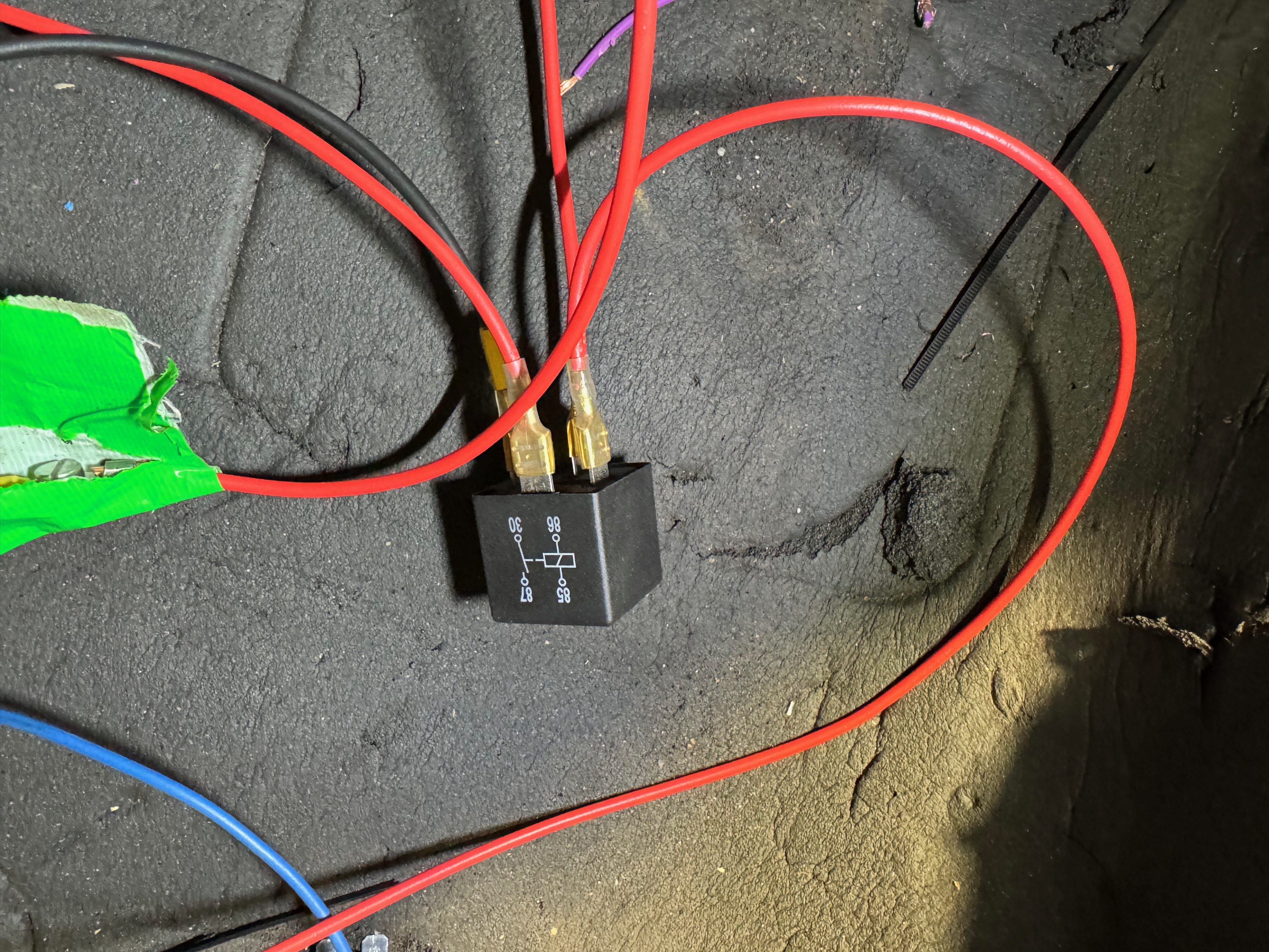

Hi all,
I have been checking all my connections and parameters the last days and yet I have no success to get to INVStatus "on". I even switched inverters to rule that one out. All other things like the Relay for 12V+, direction Switch, Sbox are working as they should. Is someone able to point me into a possible direction? I hope the attached documents and the WebUI make my mistake apparent.
Thanks in advance for the support.
Best Marvin

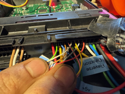

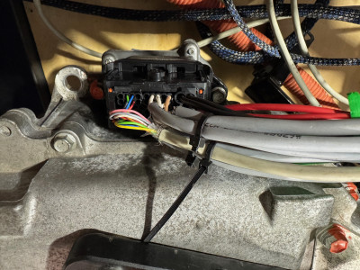

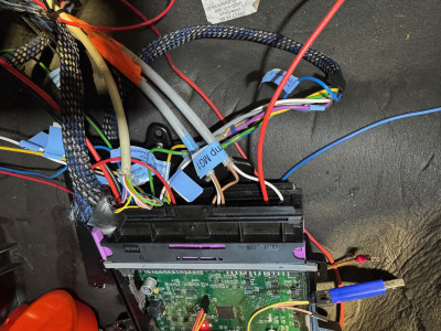

I am using a thin gauge wire 0,14mm2 it is shielded but currently the cable is about 5m long

The Wiring diagram is also what I have in real life.

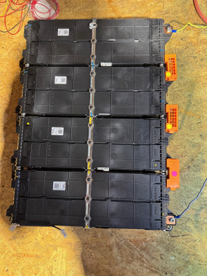

Very much not permanent but it works

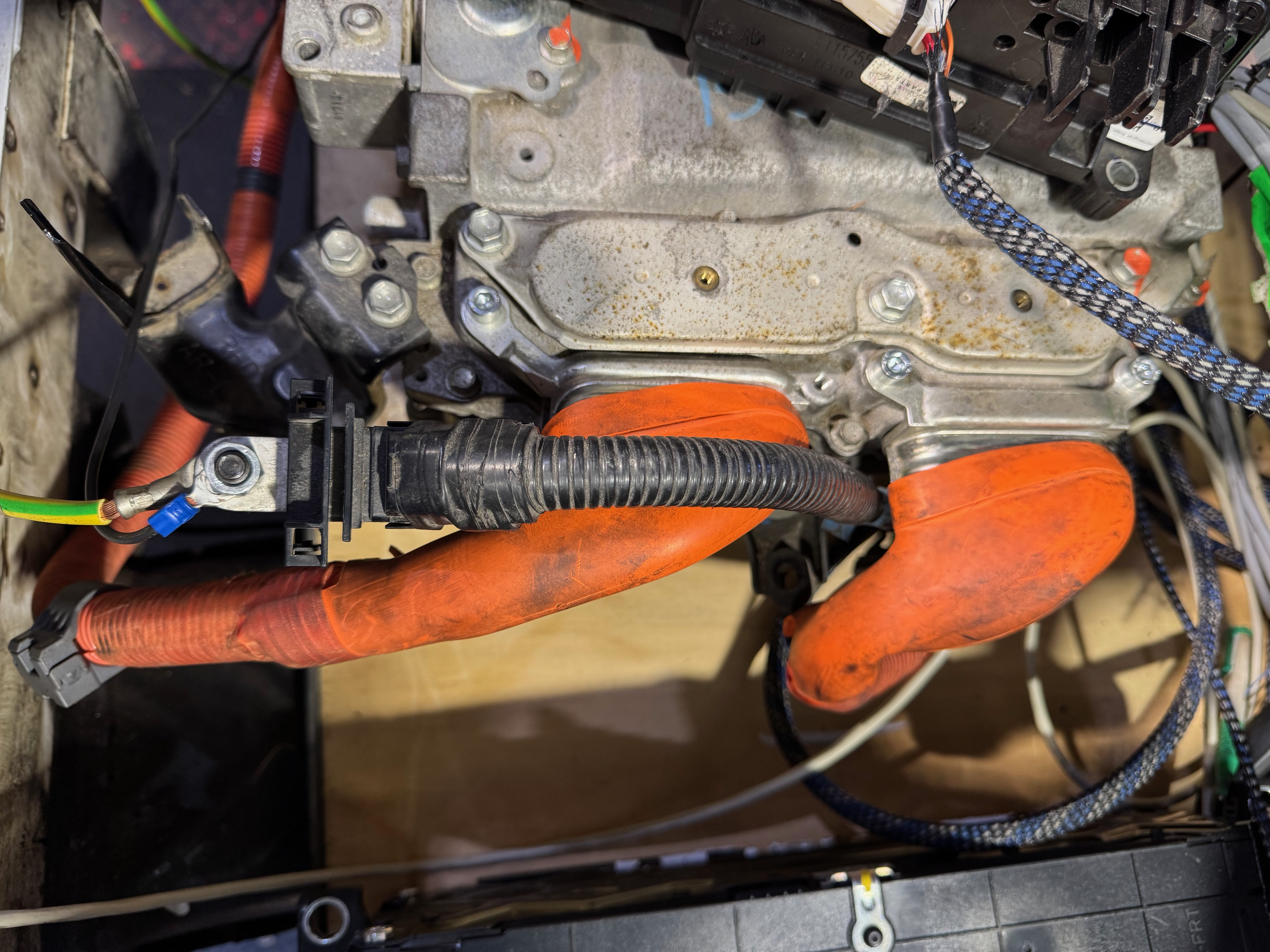

Re: Zombie + GS300H Inverter Communication
As in powercycle the setup. It is key the inverter relay is used so that the Zombie starts comms and provides 12V power to the inverter in the right sequence.

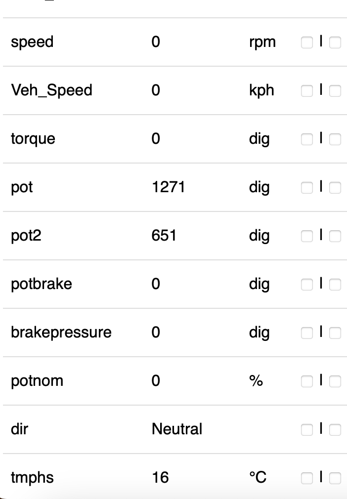

Hi again,
after flashing the newest V2.22A today and setting UDCmin to 0. + Reterminating the connection I am getting succesfull inveter whine. But I believe I am stuck at no potnom change (as so many) but all tips have to far not changed. If I start the inverter with drive direction already enabled I sometimes get some slight motor movement. Can someone pinpoint me towards a solution? I also referenced the example setting and they did not change anything.
Motor and Inverter are grounded to the Battery directly. Battery voltage is at 87V
12V Batt is connected to a charger so should be fine.
Pot 1 & 2 are changing values when pedal is pressed.
Best Marvin
params (e-LT35)20250402.json
(2.14 KiB) Downloaded 880 times

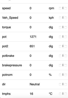

Please show your spot values too.
Get the inverter into RUN opmode and dir as fwd then grab screenshots of the spot values please.
Marvin
Posts: 25
Joined: Sat Jul 29, 2023 5:06 pm
Post by Marvin »

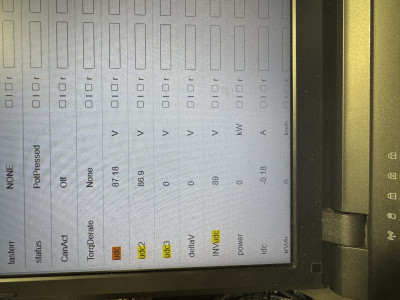

Hi Tom, Please find them below. ONCE with Pedal pressed and once without.
Spot values Pressed - eLt35 - 20250402.pdf
(563.56 KiB) Downloaded 848 times
Spot Values Not pressed eLT35 20250402.pdf
(566.54 KiB) Downloaded 834 times
Does it show a potnom with throttle in single potmode?

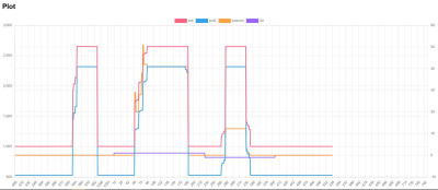

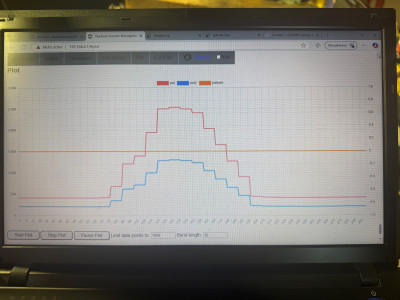

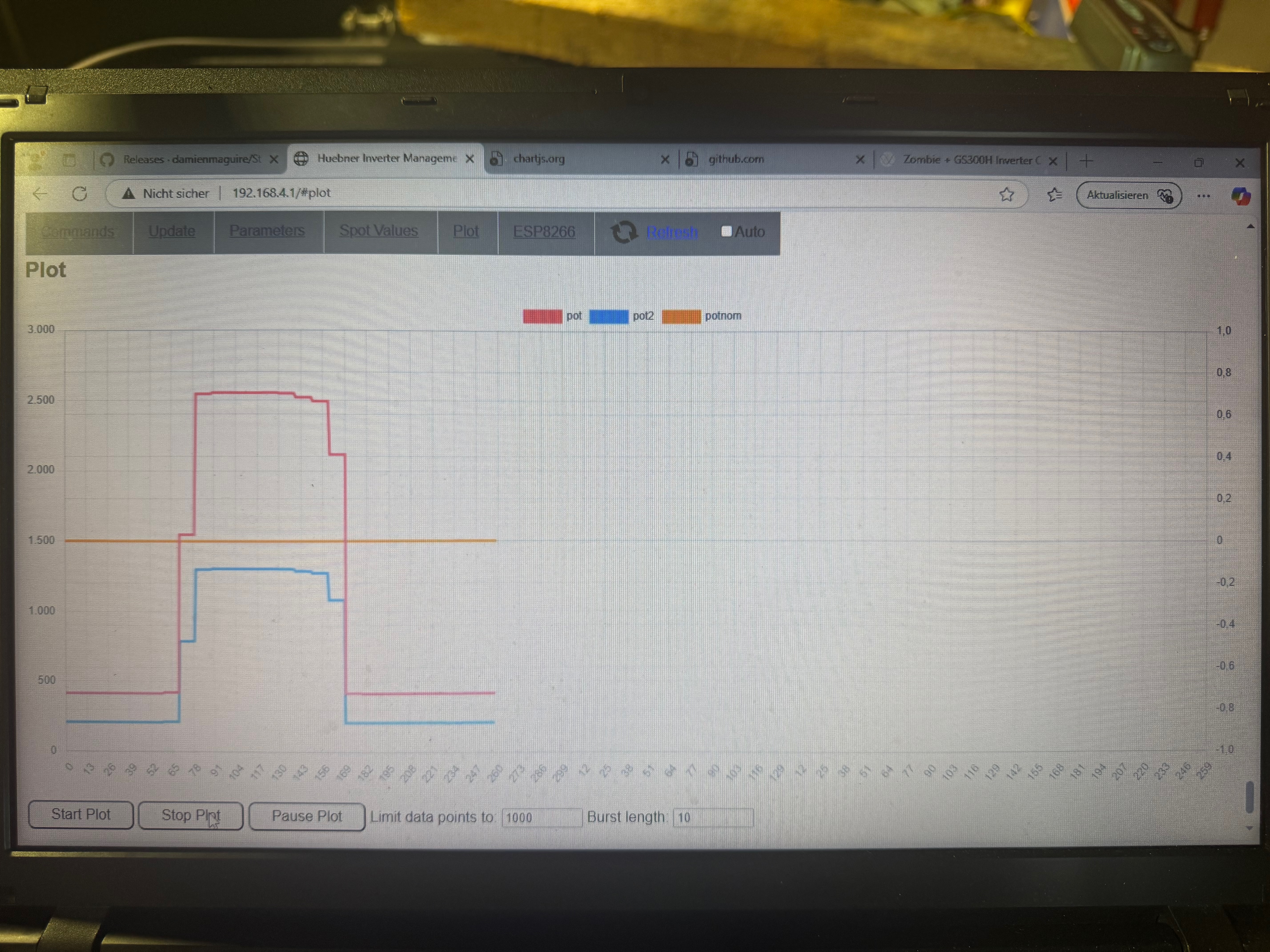

Does it show a potnom with forward direction selected?
Please plot pot and pot 1 on left and potnom on right.
Marvin
Posts: 25
Post by Marvin »
Hi Tom,
as requested.
... it feels like I am so close :D thanks for the help.
Inverter on pedal pressed
With Inverter off pedal pressed
please set udcmin to like 30. Does anything change?
None of this seems to make alot of sense since I done a bunch of bench testing and have not run into this behaviour. Something is forcing it to o.
Marvin

Post by Marvin »
Just tested it unfortunately no change.
I guess tomorrow I will do the following:
- Re-check wiring Inverter to Resolvers,
- try with the second inverter I have
- re-flash an apply Damians e46 file for parameters (is there a new loader for V2.22A?)
- pray to the ev gods
anything else I should consider? Motor three-phase wiring can be ruled out as an error source or? Could I manually apply a potnom value somehow for testing purposes?
No this is nothing to do with the inverter.
The throttle pedal should be converter to the potnom regardless.
I can check on my bench to see if I can replicate it.

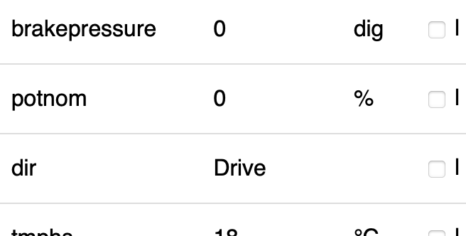

My Benchtest findings:
1. Potnom only plots with direction selected - probally due to all the new features it no longer works before selecting a direction
2. udcsw needs to be 0 to go into run on the bench without voltage
3. udcmin needs to be 0 to get any potnom with direction selected
4. single or dual channel both work
Attached are a screenshot of my spotvalues and params.
A picture of a plot including direction
Params from my benchtest

Thanks Tom,
Alright i tried the following and get an interesting error. First i applied all parameters manually but UDCsw always jumps from 0 to 66,… V somwhere 20v below UDC.
I reset and flashed the Hex. Earlier i updated to V2.22 via the bin.
But same result. Fresh flash, apply parameters file only adjustment Pot min and max.
I assume UDCsw should not just jump around to a different value? Looks like a live value it is referencing.
Marvin wrote: Thu Apr 03, 2025 12:58 pm UDCsw always jumps from 0 to 66
Yes because you are putting 86V into your Sbox, I am not running an Sbox.
Please check all your params against mine.
Leave the inverter connector removed for now, it is not needed to get potnom working.
You should get into run mode, without errors. then map:
L- pot & pot2
R- dir & potnom
Plot
Select drive
Press pedal.
literally what I did on the bench using the HEX file from the release. (I am not using the Sbox, but only have it configured)
