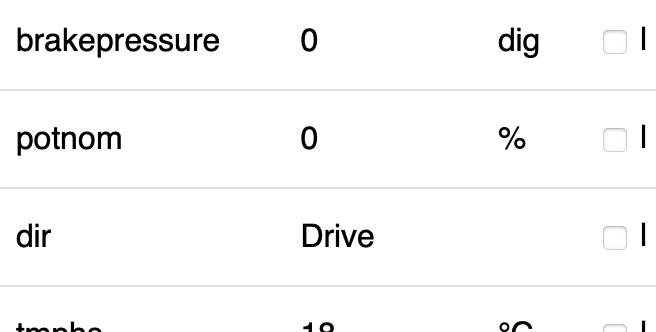

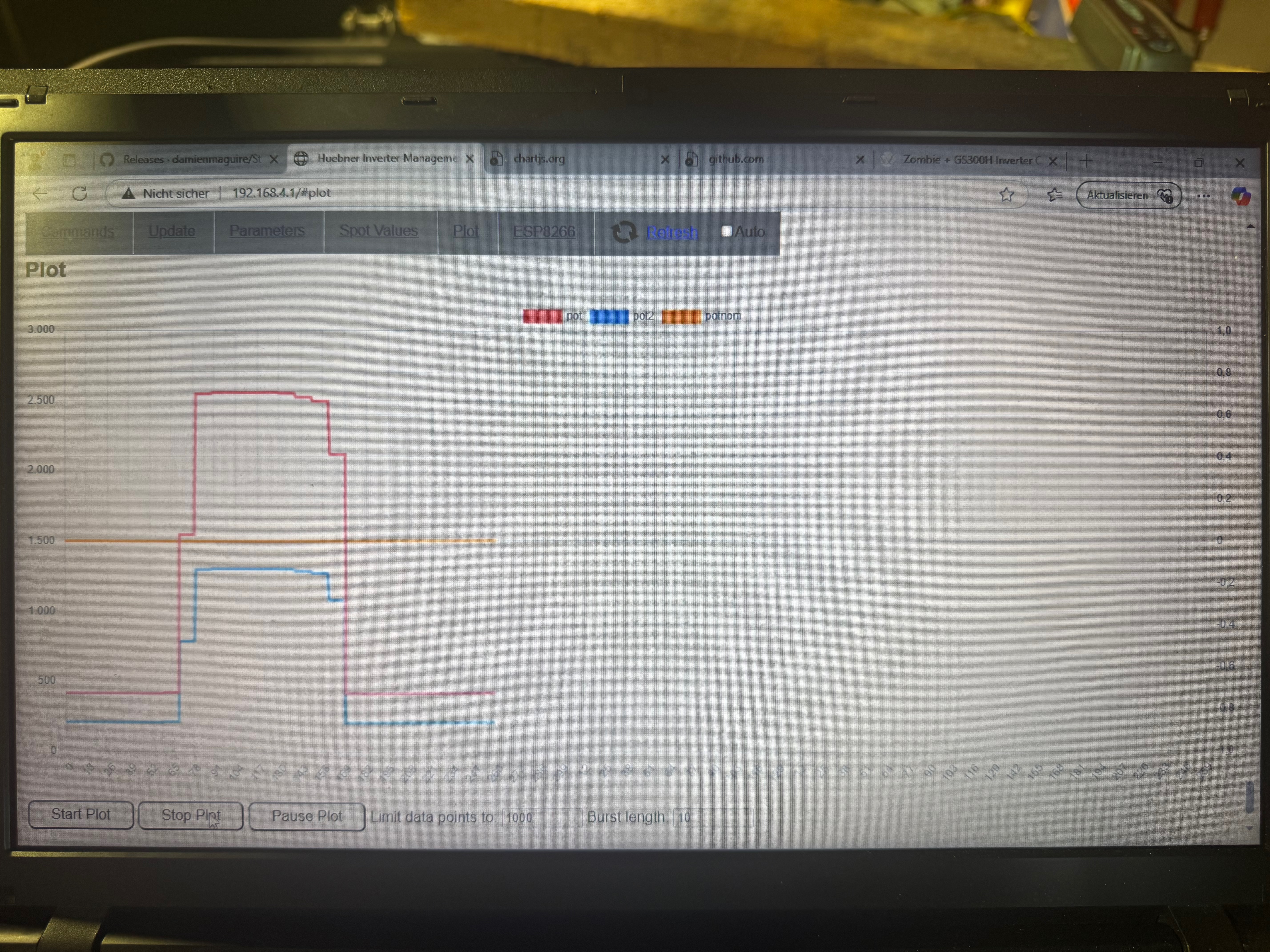

Marvin
Posts: 30
Joined: Sat Jul 29, 2023 5:06 pm
Been thanked: 8 times
Re: Zombie + GS300H Inverter Communication
Post by Marvin »
Hi Tom,
as requested.
... it feels like I am so close :D thanks for the help.
Inverter on pedal pressed
With Inverter off pedal pressed
Posts: 2754
Location: Bristol
Has thanked: 264 times
Been thanked: 717 times
please set udcmin to like 30. Does anything change?
None of this seems to make alot of sense since I done a bunch of bench testing and have not run into this behaviour. Something is forcing it to o.

Posts: 2754
Location: Bristol
My Benchtest findings:
1. Potnom only plots with direction selected - probally due to all the new features it no longer works before selecting a direction
2. udcsw needs to be 0 to go into run on the bench without voltage
3. udcmin needs to be 0 to get any potnom with direction selected
4. single or dual channel both work
Attached are a screenshot of my spotvalues and params.
A picture of a plot including direction
Params from my benchtest
Note:
Bench test Zombie is only connected to 12V supply, a bench test button setup (start/ign ect) and a dual hall throttle. Nothing else is connected.
I also wiped my Zombie and flashed the CAN bootloader and 2.22A release HEXs fresh
Marvin wrote: Thu Apr 03, 2025 12:58 pm UDCsw always jumps from 0 to 66
Yes because you are putting 86V into your Sbox, I am not running an Sbox.
Please check all your params against mine.
Leave the inverter connector removed for now, it is not needed to get potnom working.
You should get into run mode, without errors. then map:
L- pot & pot2
R- dir & potnom
Plot
Select drive
Press pedal.
literally what I did on the bench using the HEX file from the release. (I am not using the Sbox, but only have it configured)
