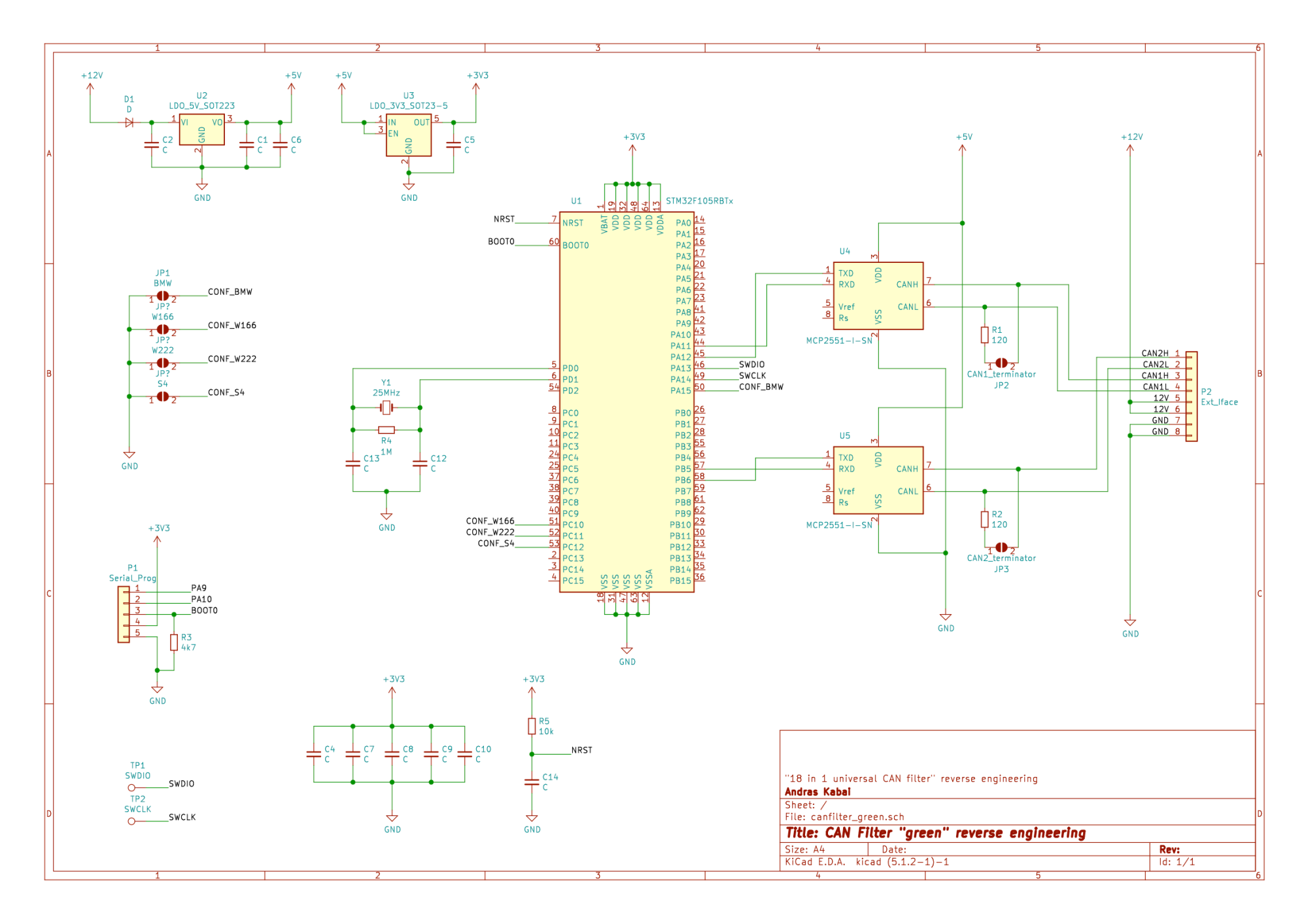

It would then work pretty well for a fake... In the schematic it seems like nothing is connected to the Rs pin of the transceivers so it would essentially be disabled. Which it isn't but maybe it doesn't work well like that? Try grounding Rs (Pin 8)

The schematic above is for the "green board" and it looks like pin 8 is actually connected to 0V. The blue board uses TJA1042, pin 8 is standby and also appears to be connected to 0V on the board.

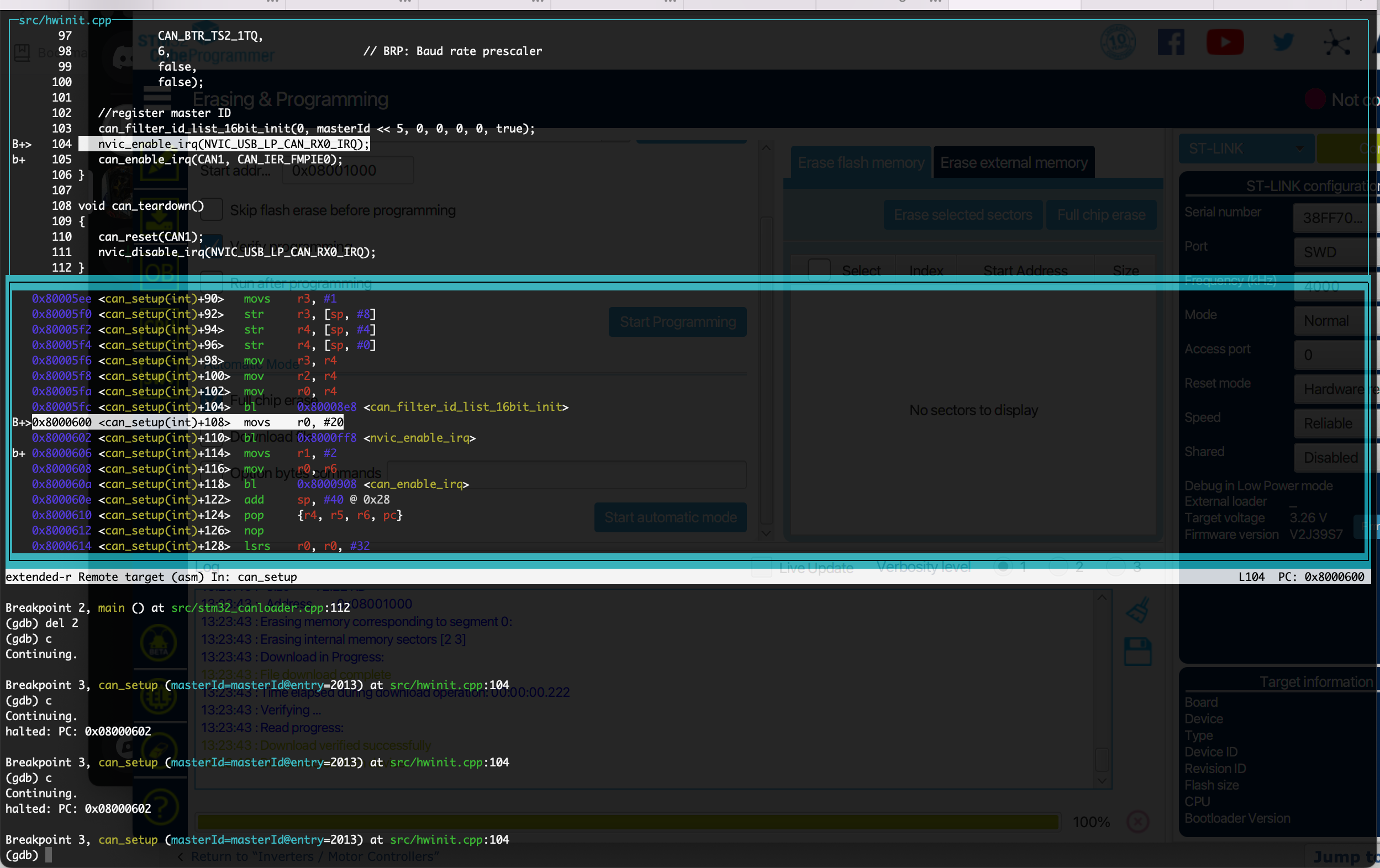

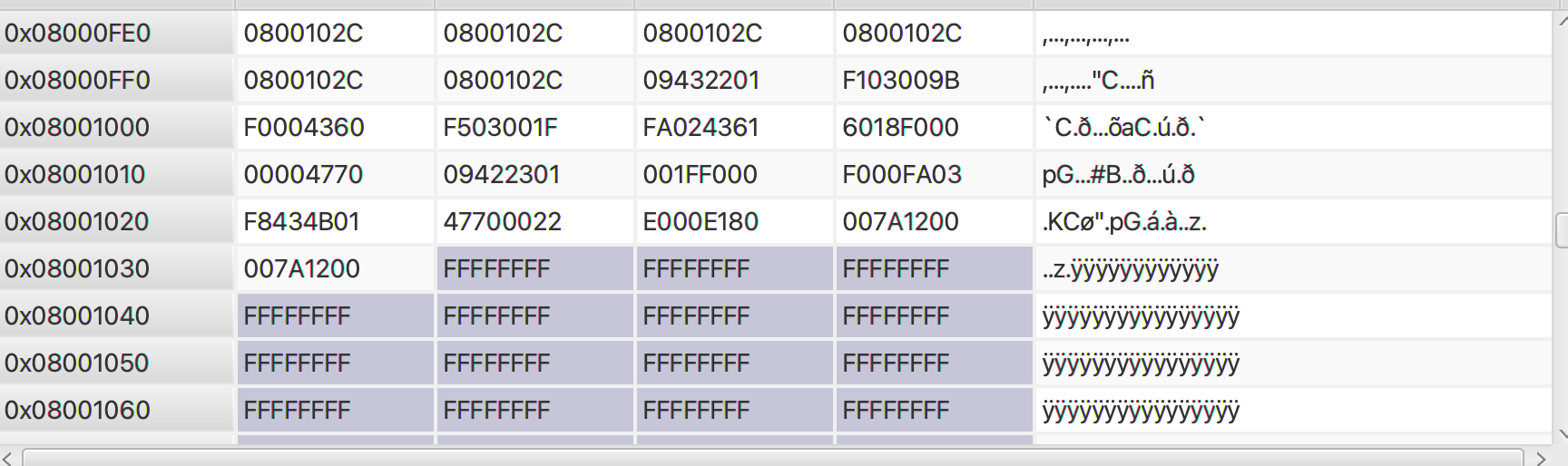

Still digging at this,
So if I've got just the bootloader on using openocd/gdb to step though, everything executes as expected.
If theres any firmware, then in the bootloader hwinit.cpp in can_setup() on the line nvic_enable_irq(NVIC_USB_LP_CAN_RX0_IRQ); it seems reboots.
And this is without firmware

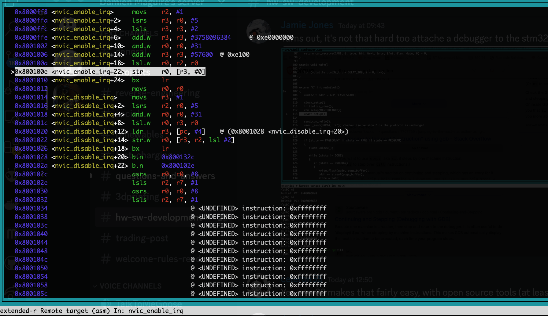

Posts: 1845
Has thanked: 89 times
Been thanked: 481 times
Re: Writing application for Stm32F105 @ 25 MHz
Ok so the bootloader is too large.
Need to shrink it.
