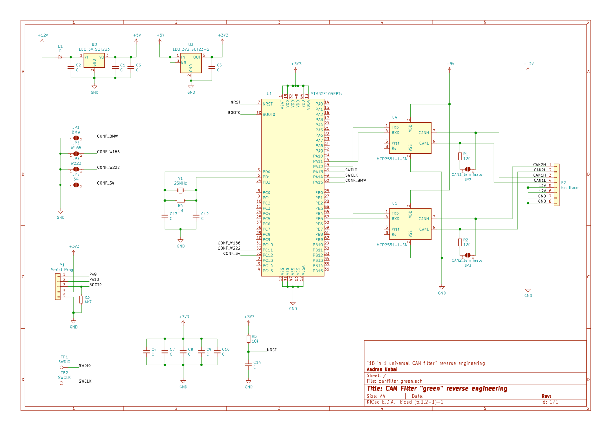

It would then work pretty well for a fake... In the schematic it seems like nothing is connected to the Rs pin of the transceivers so it would essentially be disabled. Which it isn't but maybe it doesn't work well like that? Try grounding Rs (Pin 8)

The schematic above is for the "green board" and it looks like pin 8 is actually connected to 0V. The blue board uses TJA1042, pin 8 is standby and also appears to be connected to 0V on the board.

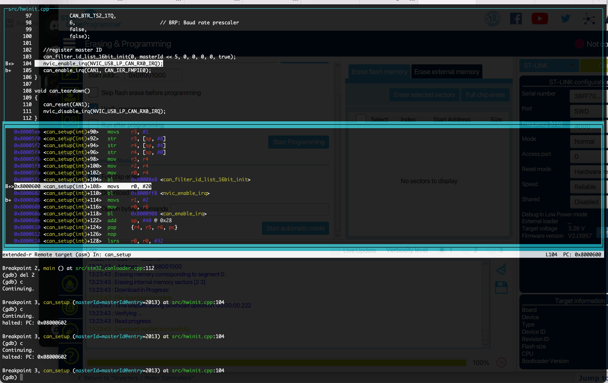

Still digging at this,
So if I've got just the bootloader on using openocd/gdb to step though, everything executes as expected.
If theres any firmware, then in the bootloader hwinit.cpp in can_setup() on the line nvic_enable_irq(NVIC_USB_LP_CAN_RX0_IRQ); it seems reboots.
And this is without firmware

Re: Writing application for Stm32F105 @ 25 MHz
Ok so the bootloader is too large.
Need to shrink it.

- Built the bootloader from https://github.com/jamiejones85/stm32-C ... /BlueBoard
- uploaded to blue board using an stlink v2 (a bit of faffing there, but with combination of stm32cube & blackmagic debug app got it flashed using the SWD connection)
- bootloader as built was sub 4k (3988 bytes) so didn't experience the issues above.
- built Jamies CANBridge demo app at https://github.com/jamiejones85/stm32-CANBridge (just need a couple of missing git submodules to build)
- uploaded to blueboard over CAN using the esp32 webui on lilygo (https://github.com/jamiejones85/esp32-w ... ilygo_tcan)
- success - CAN messages on each blueboard interface, persists through power cycles,
i've still a lot to learn about the OI ecosystems, and not really figured out how nodeIds are assigned yet.
Fantastic work Jamie, think this will be a really useful and very cost-effective little board for CAN bridge /filter/ MITM.
