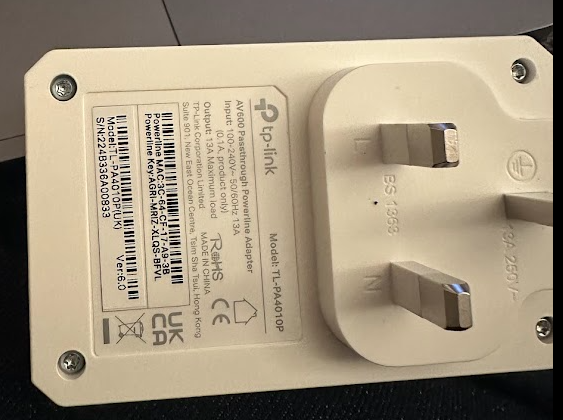

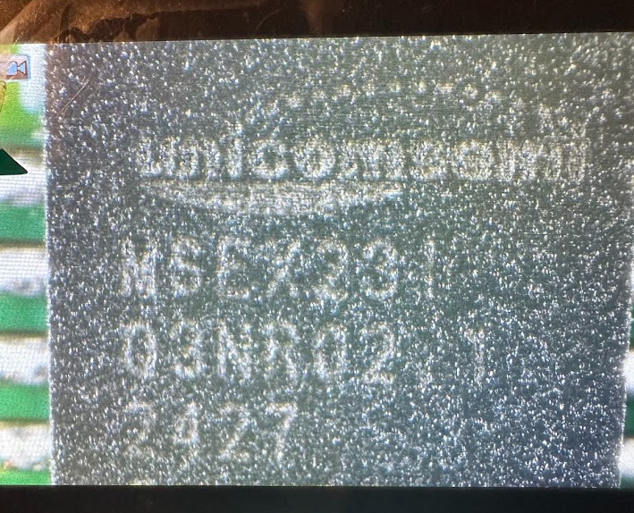

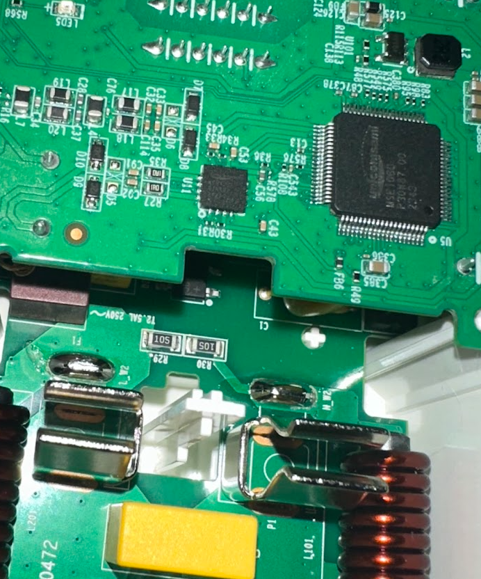

Hi All,
I have bought 2 x TL-PA4010P (UK) devices but it looks like TP link has switched IC's over to unicom semi.
Has anyone had any experience with these?
Main processor is MSE 1060 and the transformer interface is MSEX231.
Regards
Nick
Regards
Nick

Could you share a photo of the name plate, please? There was a similar finding some time ago, cannot find it at the moment.
- uhi22
- Posts: 1143
- Has thanked: 231 times
- Been thanked: 638 times
So for the moment the conclusion is: The version 6 of the TL PA4010 does not fit our needs.
Nevertheless it would be interesting whether it still talks to the Qualcomm tool, or whether it has other possibilities to configure.

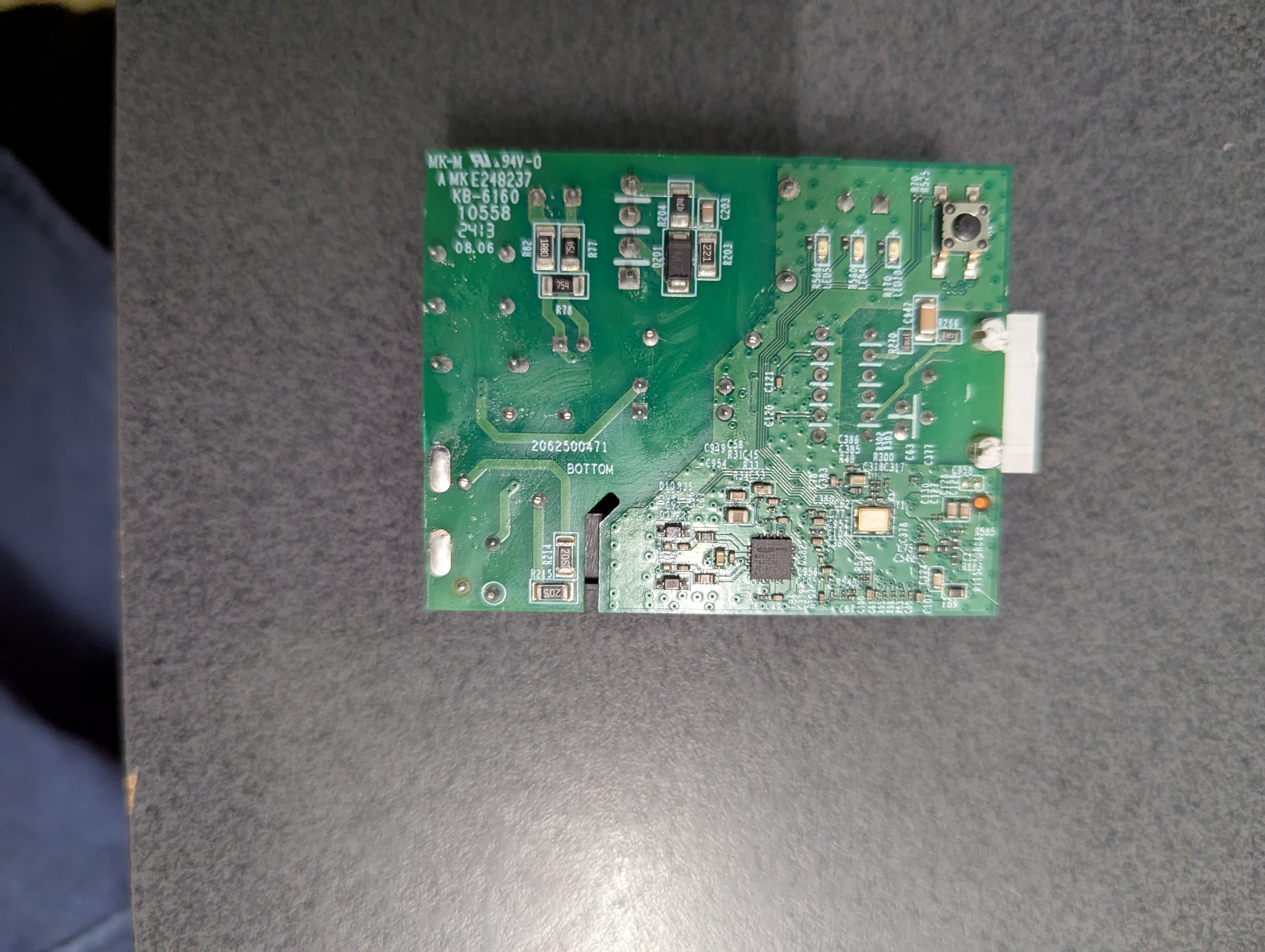

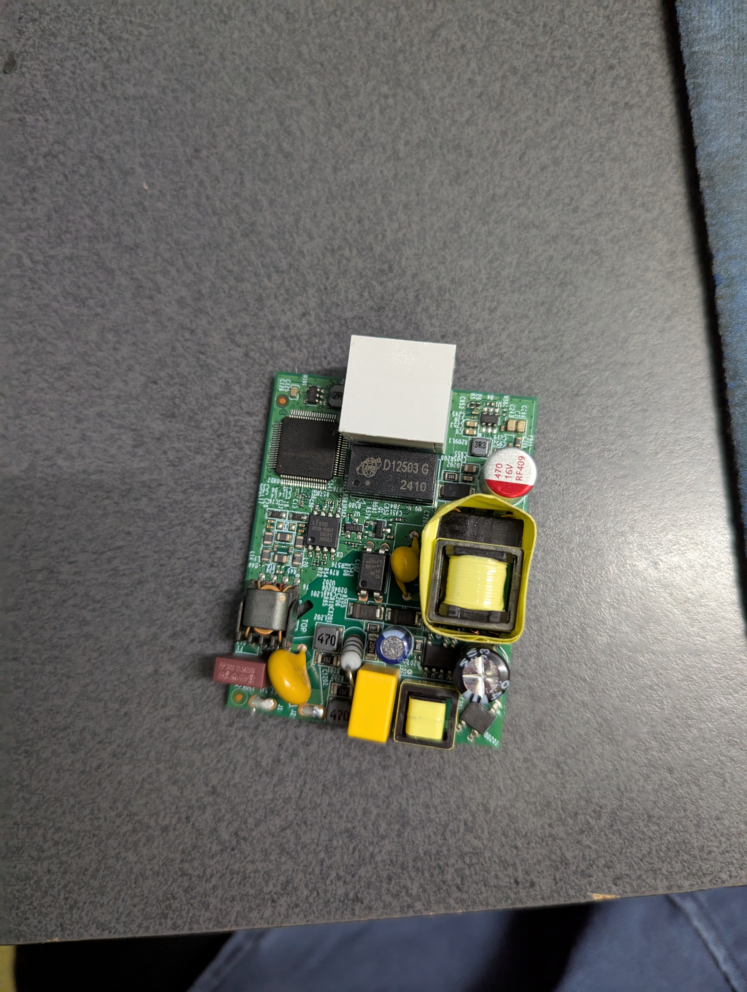

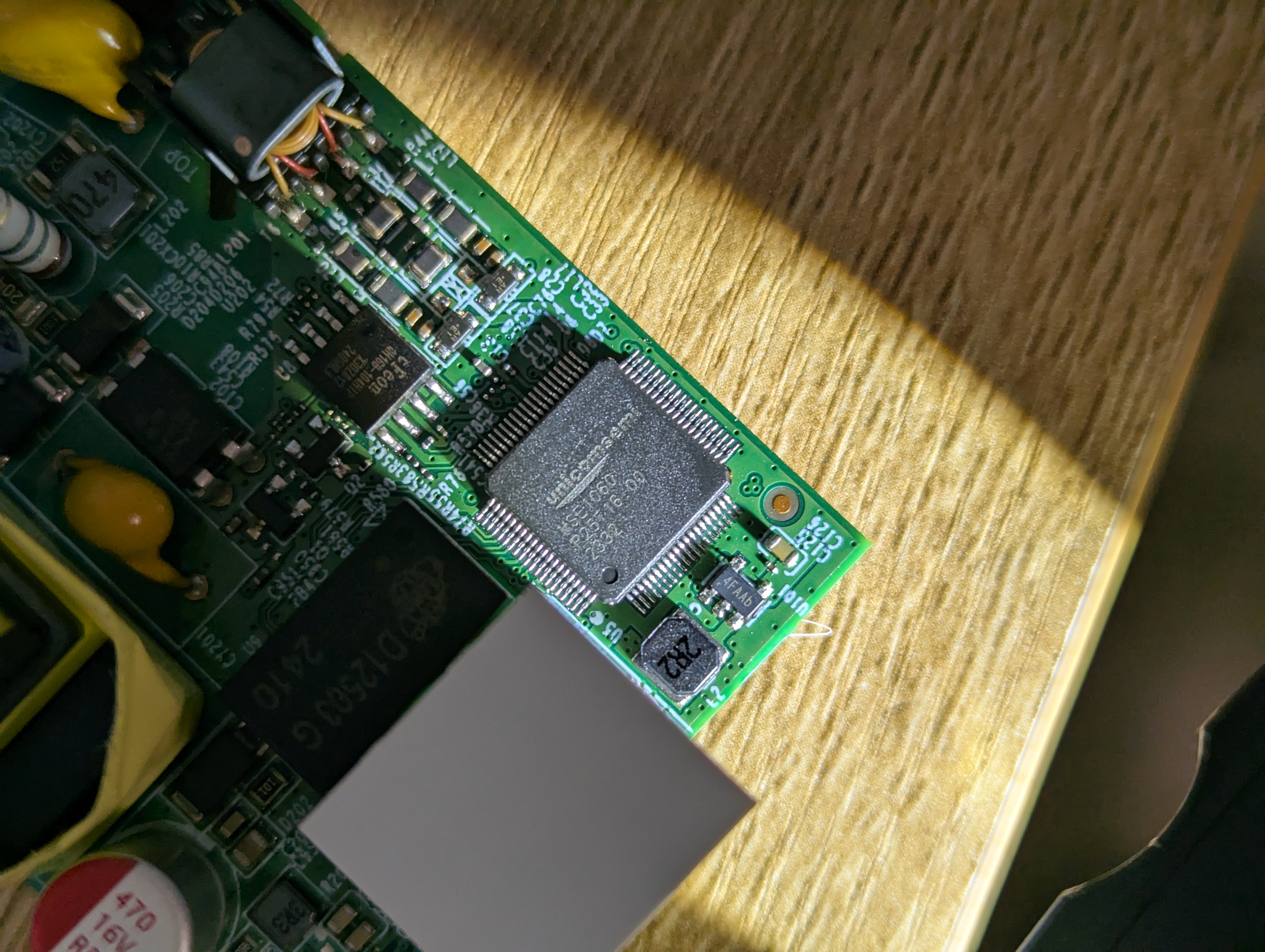

Hi all,
So I tried this on a known device with the atheros processor. and I get this.
Before this works though, I need to
sudo ip link set eth1 down
then
sudo ip link set eth1 up
then enter:
~/open-plc-utils-master $ plcstat -t -i eth1
P/L NET TEI ------ MAC ------ ------ BDA ------ TX RX CHIPSET FIRMWARE
LOC CCO 001 C0:4A:00:C6:D8:4C 3C:18:A0:0D:2A:48 n/a n/a QCA7420 MAC-QCA7420-1.1.0.844-01-20120919-FINAL
When I try this on the unicomsemi equipped plug i get nothing returned:
~/open-plc-utils-master $ sudo ip link set eth1 down
~/open-plc-utils-master $ sudo ip link set eth1 up
then
then enter:

Summary: The version 6 of the TL-PA4010 does not fit our needs. It is not configurable via the Qualcom open-plc-utils.
Added this hint to the description on github, https://github.com/uhi22/pyPLC/blob/mas ... a4010p-v60
Thanks for the investigation.

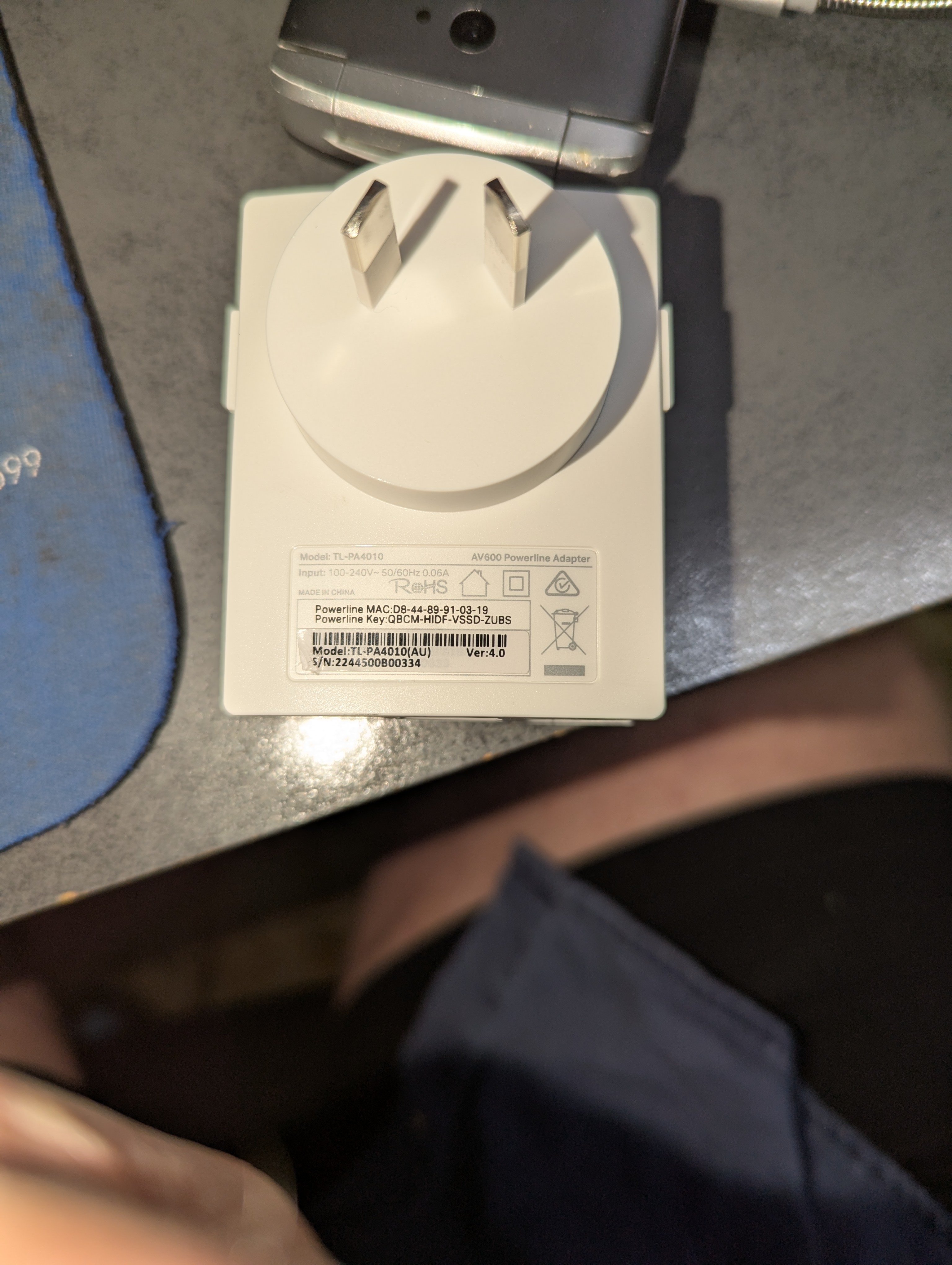

- mackoffgrid
- Posts: 94
- Joined: Thu Jan 02, 2020 10:18 am
- Location: Brisbane Australia
- Has thanked: 6 times
Wanting to join in on this experiment I bought the Australian TL-PL4010 version 4.
It appears to have the same chip set as the UK version 6.
yes, I have mentioned this problem in the issues on pyPLC github. So the EU version (V6) comes with Vertexcom (unicomsemi) MSE 1060 chip. You cannot find any information about these chip, becuse it is designed for a specific customer (maybe this is TP-Link) and NDA is required to get more information. I stopped the process here, I haven't signed any NDA.
But it would be interesting to check how can we communicate with this module.

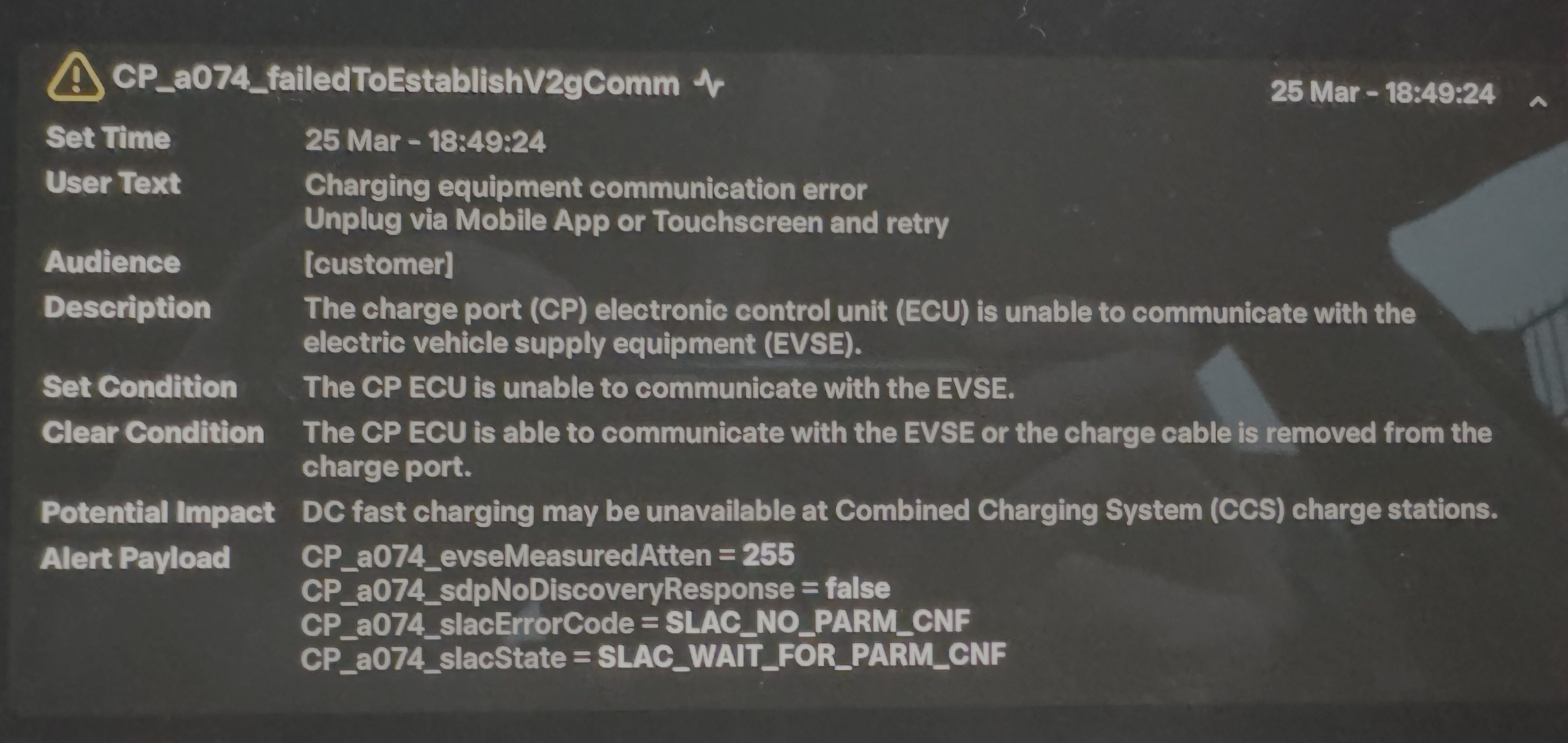

Hi all,
I'm making my first experiments with pyPLC in EVSE mode using a converted TP Link PLC modem with an AR7420.
My goal is to talk to my Tesla Model 3 from 2019 and eventually make it close its contactors.
Unfortunately, I'm stuck at an early stage: I'm unable to get any communication over PLC to the car.
In pyPLC this is at the "modem isrestarting" message. The log is attached.
My current hardware setup is an Arduino constantly outputting a 1kHz 5% PWM square via a TL072 op amp that is configured to output +/-12V via the 1k resistor. The rest is the same as found in the hardware docs of the pyPLC github.
I verified the setup using an oscilloscope (without the connection to the car) and it looks good to me. The only thing I don't know is the amplitude of the modem signal. It seems to be around +/- 2V in my case.
I also did the EVSE configuration of the modem via the open plc tools.
The only idea I have left currently is to check the signal with the oscilloscope while being connected to the car. But I doubt that it will look bad.
Thanks for anyone who has an idea.

The car gives me the following error code in service mode wich lets me believe that it is now a pure PLC error: I'm using a TL-PA4010 AV600 EU/3.0. I did all the EVSE patching.

That attenuation of 255 (=0xff) is a bit weird, as pyPLC is sending a hardcoded value of 9. https://github.com/uhi22/pyPLC/blob/761 ... #L471-L474
