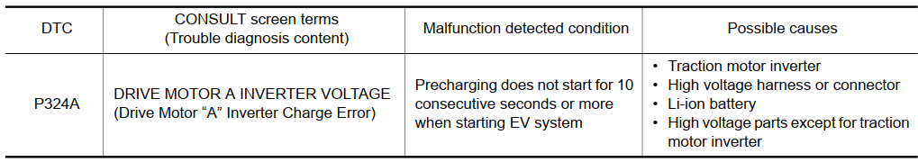

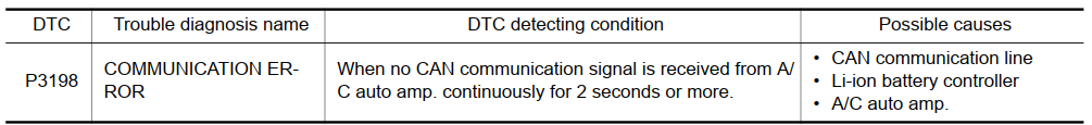

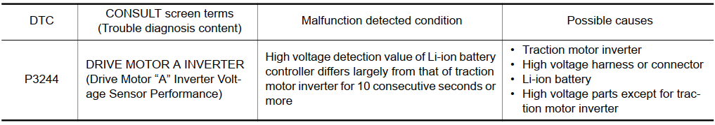

Marat
Posts: 29
Joined: Wed Nov 16, 2022 6:24 pm
Been thanked: 12 times
Re: Leaf full stack not reversing properly
Post by Marat »
P318E CAN ERROR
(CAN data error)
Traction motor inverter is unable to receive the EV system
CAN signal from VCM
P3193 CAN ERROR
(CAN data error)
EV system CAN signal from Li-ion battery controller
continuously for 2 seconds or more
P3244
DRIVE MOTOR A INVERTER
(Drive Motor “A” Inverter Voltage
Sensor Performance)
High voltage detection value of Li-ion battery
controller differs largely from that of traction
motor inverter for 10 consecutive seconds or
more
P324A DRIVE MOTOR A INVERTER VOLTAGE
(Drive Motor “A” Inverter Charge Error)
Precharging does not start for 10
consecutive seconds or more
when starting EV system
The errors may be old and need to be cleared and recalculated.

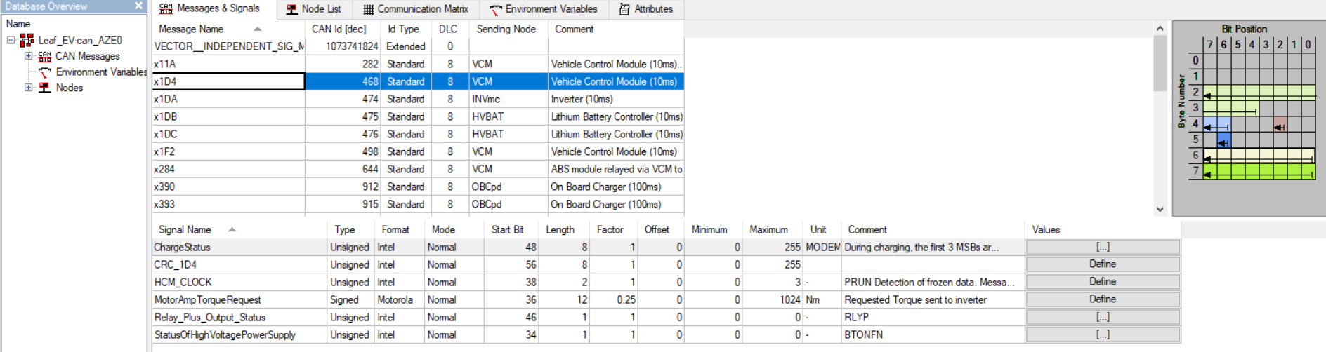

id11A id1d4 revers bit ?
Marat
Posts: 29
Post by Marat »
id1F2 bit0 chrge ?
id1D4 bit0 x88 bit1 x88 (GEN2 GEN3) ... bit5 x44 dr x42 rev
dit0,bit1 Torque control, torque limitation - not yet studied.
Taken from the log GEN4

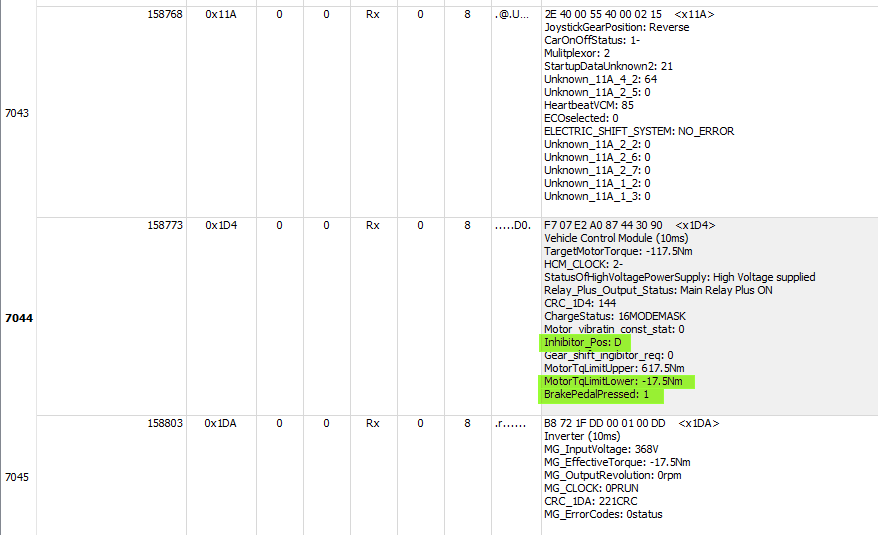

J0hannes
Posts: 147
Has thanked: 19 times
Been thanked: 168 times
1D4 message error found -->Leaf full stack not reversing properly
Post by J0hannes »
Well, I think I found out, why the inverter gives only -17.5Nm out...
Because Zombieverter tells the inverter to give only that :D
What I did was update my DBC from Dala's Github, my previous one was from over a year ago. New signals here :geek: No wonder finding out the issue felt difficult and now the problem is clear as the sky on a freezing day :D
Also, I guess the Inhibitor pos and brake pedal pressed statuses would be a good idea to change so they follow actual brake pedal and drive direction selected states
I think with this 1D4 getting fixed, Leaf reversing will work like it should :)
