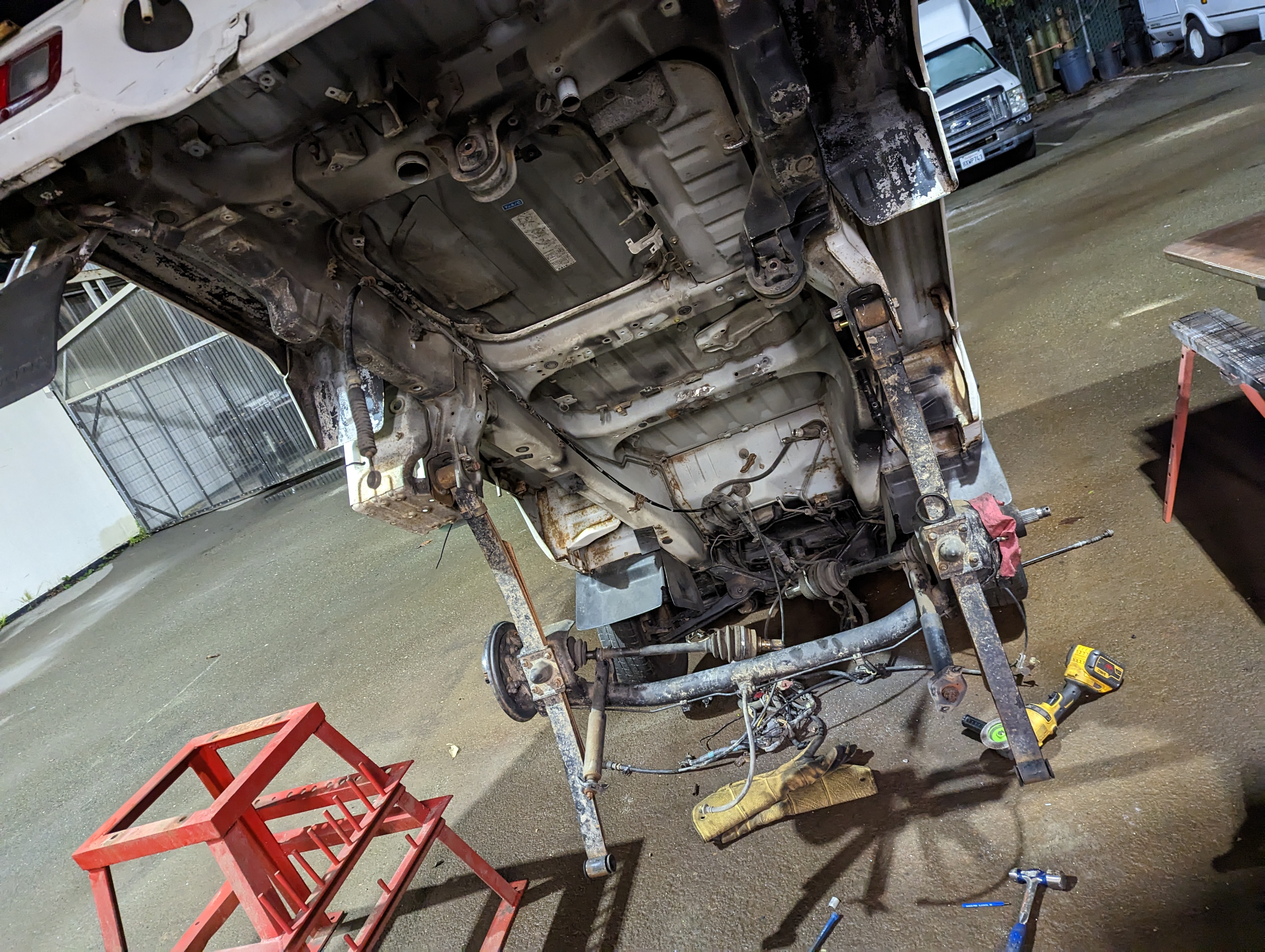

Hi guys! My project is coming along and I'm at a place where I feel good about sharing my project, lessons-learned, and to try this out as sounding board.
My project is an HA3 Honda Acty with a busted motor. I've been a fan of kei trucks ever since a trip to Japan. When the opportunity came to get one that had been registered for road use but was being sold as a "mechanic's special" I decided another project couldn't hurt. The Acty has a rear wheel drive, mid-engine layout with an option for AWD. The motor (roughly the size of a large motorcycle engie) is mounted in a transverse configuration over the trans-axle.
My donor car is an EM57 2013 Nissan Leaf with tree damage and a good battery (10 bars).
I've decided on using the Nissan inverter, motor, and trans-axle. I'm also using the Leaf's 24 kWh battery, which will fit nicely between the frame rails. My first choice was to use the Resolve system to minimize my development burden on the electrical side, but I just could not find a place to stick the Nissan Leaf's PDM. It certainly won't fit on top of the original power-train stack under the truck bed, and even with all the ICE components removed, there isn't a location I can remote mount it without creating ground clearance issues. To that point, I will need to figure out how I'm going to do the high-voltage switching and charging without the original PDM.
To control the power-train, I've already installed the open-inverter Nissan-Leaf Gen2 solution, and have gotten as far as energizing the board with 12v and communicating through the web-interface. I have not done any configuring yet.
The most sensible option seems to be to use a lobotomized Tesla Gen2 charger with Damien's board https://evbmw.com/index.php/evbmw-websh ... ogic-board. I like this option for how compact the charger is and how cheap used Gen2 chargers seem to be right now. While the chargers seem cheap, I never see them sold with their pigtailsI'm not sure if there's a better/more mature option that uses transplanted OEM parts. Gen3 chargers seem to cost significantly more, but I don't know how hard it is to accommodate the interconnects on either option.
It doesn't seem impossible to reuse the original Leaf BMS, but I haven't seen any documented examples of EM57 BMS transplants, and I have to wonder if it's just not a great choice for other reasons.
The Orion BMS is attractive since it's a commercial-off-shelf-item and would enable the Chademo receptacle I already have from the Leaf. The major drag is that it's at least $1500.
I'm leaning towards reusing the Leaf's high-power switching module and keeping it packaged with the battery and BMS inside a single custom waterproof enclosure, but I've seen some of the Tesla High Voltage Junction Boxes and they look like they bolt right up to the gen2 chargers and take care of much of the interconnect issues. In any case, they will have to mounted to the exterior of the vehicle, so any solution needs to be IP rated or enclosed later.
For the suspension, I'm building a custom DeDion axle to replace the original sub-frame piece. The upgrade will facilitate current gen Honda Civic rear brake calipers (equipped with electronic parking brake) and retain the original 4x100 wheel bolt pitch pattern. This solution eliminates the more difficult to source Kei truck parts and allows for cheap and widely available Civic parts. Unfortunately, the half-shafts represent a significant fabrication burden where I will have to make some stub adapters similar to what Brat Industries sells to accommodate Porsche 930 CV joints and adapters.

Welcome! Did I see something about this project posted elsewhere? Seems familiar in some respects.
Couple thoughts:
-The Tesla charger isn't sealed around its perimeter FYI, so you'd have to do something so nothing gets under the lid. I designed a printable part that fits on the HV end of the charger and accepts cable glands. It has a groove so you can silicone it to the lid if you wish.. I verified it fits the contour but never actually used it before selling the charger. Can send a stl if you want. Also you don't need pigtails, the connector part numbers are all listed in the wiki so you can make your own harness without having to splice and solder stuff.
-Keep in mind if you ditch the PDM you will need a DC-DC converter as well as the charger.
-Does the Zombieverter work with the OEM BMS? Could be an option. Or you could use the Thunderstruck MCU/BMS satellites. That's what I have. It's a decent system, though not as programmable as one might like. You are limited to which chargers and DC converters you can use, unless you control them from something else. It CAN do chademo though.
-Axles, is there a way you can adapt the leaf axles to the Honda outer CV joints? If the shafts are longer and sufficient diameter you might be able to have them cut to length and new splines machined to match the Civic outer CV joints. Or, you could send a sample of each axle out and have a place make you a new set of axles to your spec. Not the absolute cheapest method, but IMO the most reliable.

I have not posted anything about this project before. I've had it for a long time, but I'm only now making headway to the point that I'm reaching out for advice and sharing.
So it sounds like the Tesla charger can be waterproofed. That's great to know. I would definitely be interested in your weatherproofing part file.
The Thunderstruck BMS option doesn't seem to attractive, given it look like I would need a master controller and three satellite modules to control the whole system, which would approach the cost of the Orion BMS.

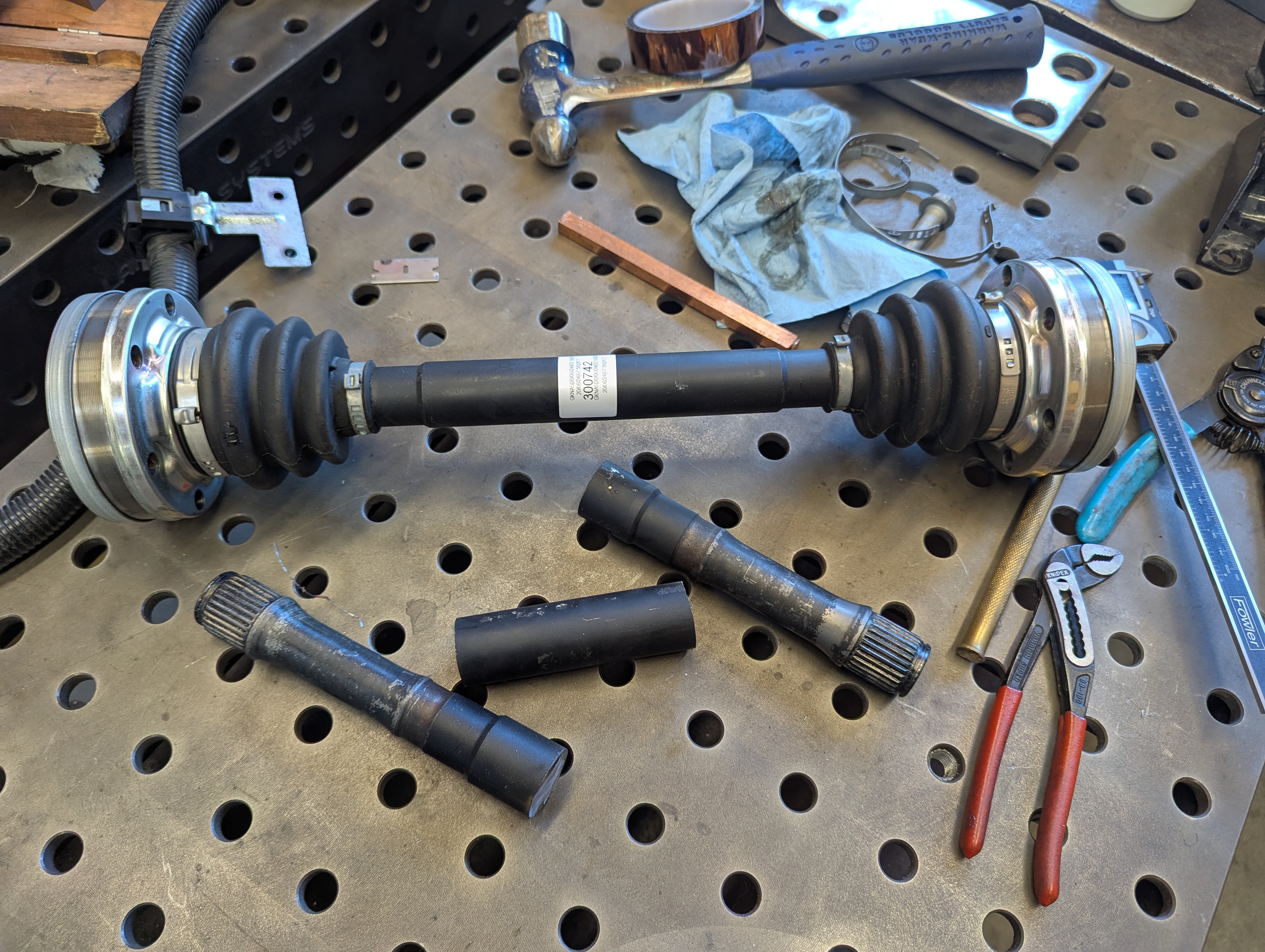

The axles have been a very difficult development exercise. My original plan was to simply graft the leaf half-shaft to an appropriate half-shaft at the other end. The problem with this design (beyond the dubious practice of welded half-shafts) is installation and removal. The DeDion component is rigid and I'm not confident I can shift the motor over enough with one CV axle installed, to get the other in. This is a major reason I've moved towards Porsche/VW CV joints since they can be bolted/unbolted without requiring a significant amount of lateral movement to free the stub axle. Custom half shafts are definitely the most reliable option, but if I can build the tooling to quickly manufacture my own splined shafts, that would be a huge lift for this and future projects.

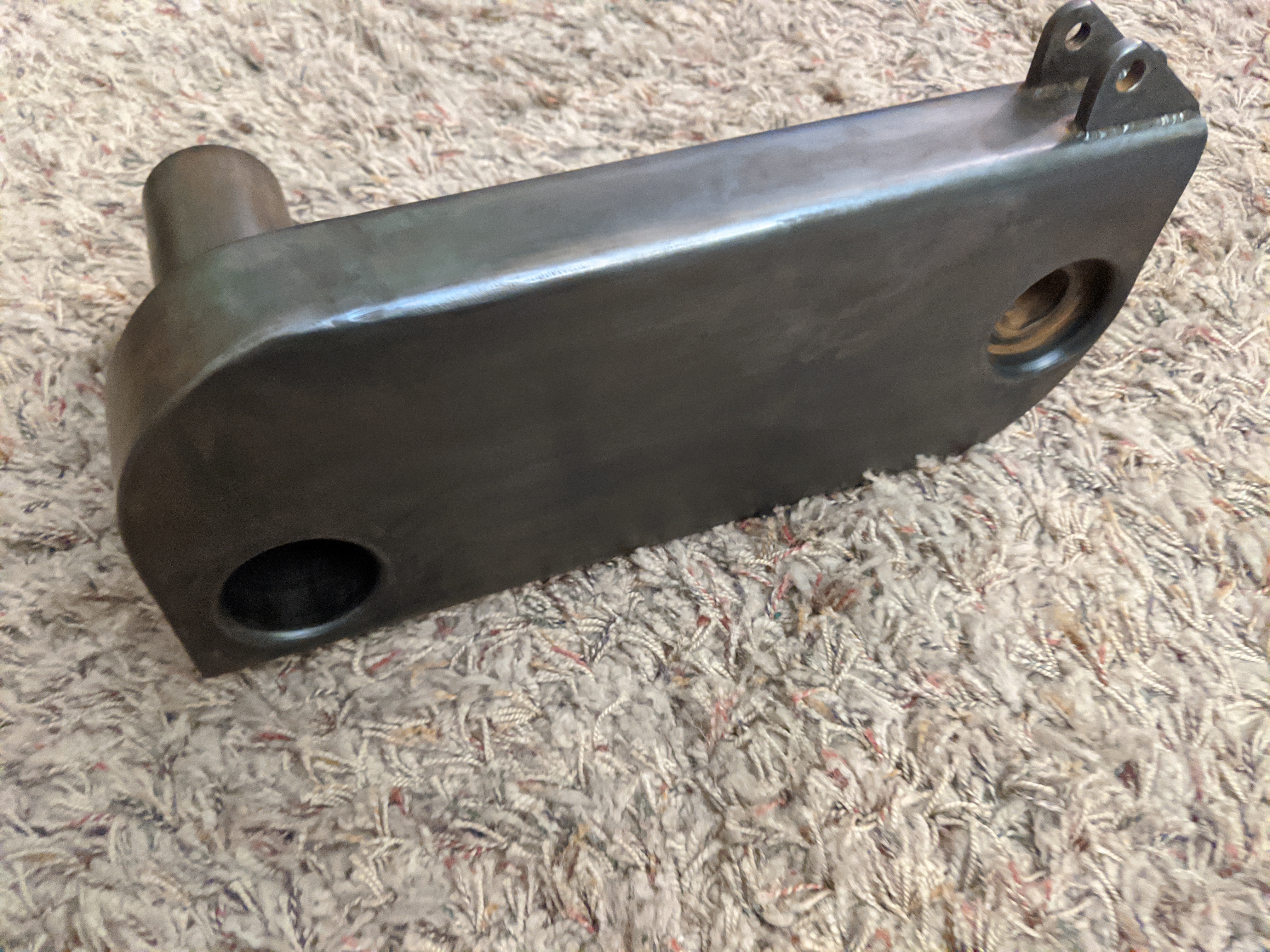

Ok here's the part I made for the gen2 tesla charger. It was intended to accept a 20mm (hole size) cable gland with a 24mm nut. I was going to put a bit of silicone in the groove around the perimeter to help it seal, but I never got past the test fitment stage before selling the charger. The idea was to take out the plastic tray inside that holds the AC and DC connectors, remove the connectors and connect directly to new wires coming in through the glands. Removing said internal parts also frees up some longer M4 screws that would then be used to hold the part to the charger using existing screw holes. I also put 2 holes in the top that I was considering drilling through the charger's lid to add more screws for a secure fit. Use at your own discretion/risk.

https://openinverter.org/wiki/Nissan_Leaf_BMStrashman wrote: ↑Thu Feb 27, 2025 3:45 pm
many of use re-use the leaf bms. why go through the hassle of rewiring what is already there?
there is a junction point at cell tap 48-49. if you need to have 2 separate battery boxes, you can split it evenly.
we are very supportive of reusing the oem bms's. less to mess up.
zombieverter will do chademo, and supports the leaf bms out of the box.
and handle all your state logic. tom and the team are re-working the OI board integration atm, so zombie-leaf board will be a 1 click set up
but stock leaf dose run very smooth over can
nice motor mounts
i have drive shaft adapter for the leaf gearbox that allow 90, 100, 108mm wv cv joints on the gearbox fyi

Thanks! I got a real hank for counterbores and raw steel in my designs. I finished welding them up this weekend. I experimented with similar aesthetics when I built the swing arm for my electric scooter build.
I'm definitely sold on the zombieVerter and placed one on order, and I think I'm going to go with the Mitsubishi Outlander for the charger/DCDC solution. It looks like it's not hard to get them with pigtails and harness intact.
Man! I wish I'd seen your site first! I've already started making my own stub axles. When I first started planning the project, I realized I could save a pretty huge chunk if I made my own splined shafts, so I tooled up. I am not enjoying this part of the process so far, but getting setup to make my own splined shafts would be a huge lift for future projects.
In your design, you eliminated the larger boss that I assumed was necessary to match the oil seal on the differential; is that part not important?

Doing it where you put the seal on the stub just puts the flanges further outboard. Not ideal. My design just uses the seal face on the flanges and replace the seals to match the new od.trashman wrote: ↑Tue Mar 04, 2025 6:00 am

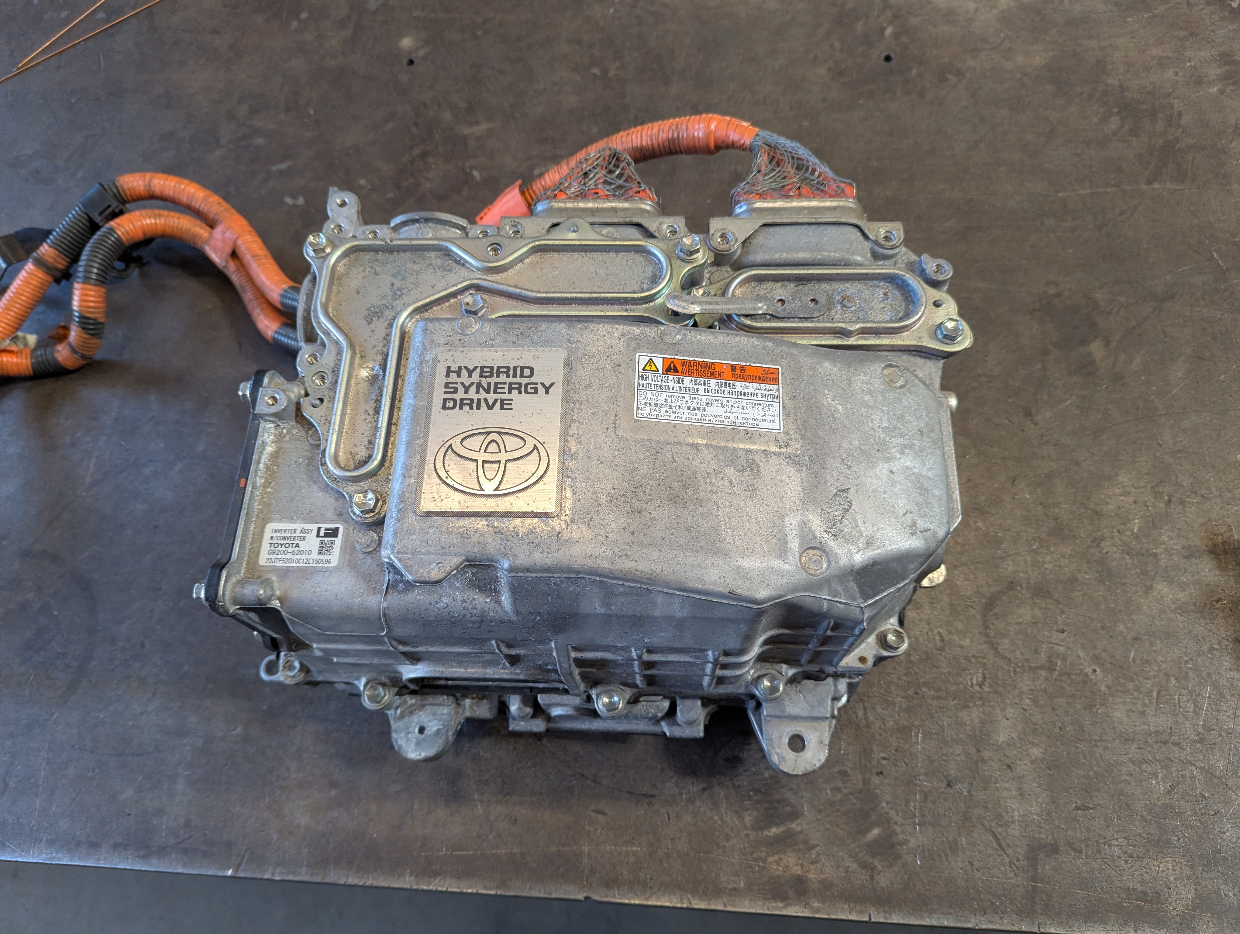

I'm pivoting to a mounting the motor behind the rear axle, in order to solve a problem where the brake caliper sits way too close to the ground for my comfort (6th picture). If I flip the axle and rotate it around, the caliper gets tucked behind the tube of the DeDion weldment (4th picture). The only problem is that the frame of the truck now interferes with the inverter when it's mounted in its stock location on top of the EM57 motor.
Along with the EM57 stack, I have a Gen3 Prius Inverter siting on a shelf. The EM57 inverter is pretty big and kind of difficult to shoe-horn in to the space I have left. The Gen3 Prius is attractive for how small it is, but am I missing any integration headaches that aren't obvious? It seems too good to be true.
It's not clear to me if I need to get the Open-Inverter board for the Prius Gen3 Inverter, or if the Zombieverter VCU will do the whole job through the sync-serial connection. To be clear, I'd like to connect both power stages of the Prius Inverter in parallel to the EM57 motor.

Re: [WIP] A Build Thread for my Honda Acty Kei Truck Conversion
trashman wrote: ↑Tue Mar 18, 2025 5:03 am
Don’t do this. This is a head ache. Just stick with the leaf inverter and controlling it over can via zombie. Much smoother and simpler.
using. Prius inverter will require the oi board, and then you will need to tune the inverter to run the motor. And very unlikely you will achieve a tune similar smoothness as the stock leaf inverter.
The project will very quickly spin out of control in complexity.
an outlander rear drive unit is definitely the ideal choice here.

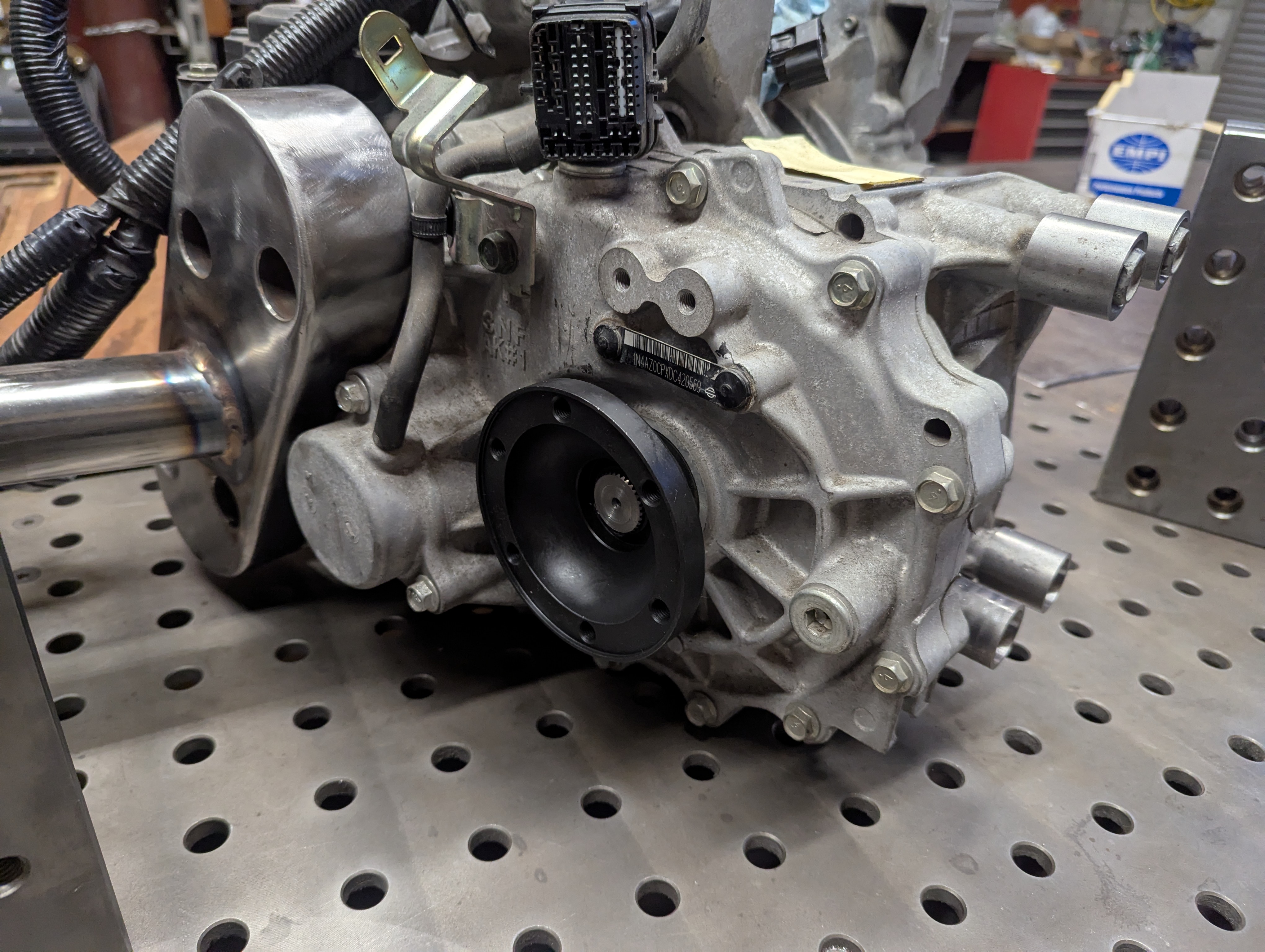

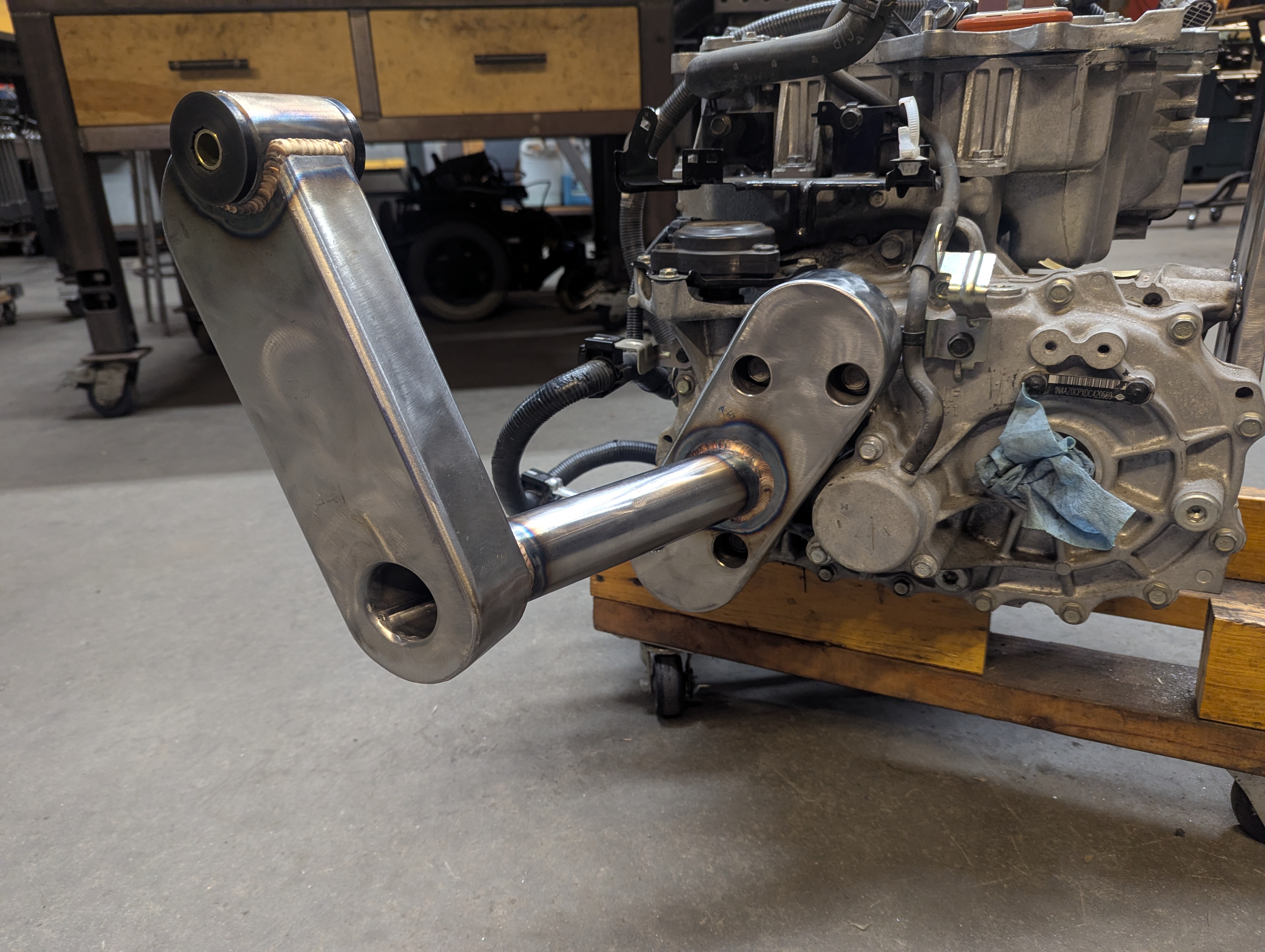

Okay, so I have the cv axle adapters mostly finished. The side that interfaces with the EM57 drivetrain still needs the oil grooves (do they need to be helical?). I also need to heat treat them (4130), but otherwise they fit pretty great and have all the features I think I'll need.
On to mounting the drivetrain. I had to abandon all the motor mounts I already made since the drivetrain has been reoriented to facilitate a rear engine layout. I measured 14.125" "flange-to-flange" and haven't ruled out having them made somewhere like Dutchman Axles.
What I'm struggling with now is deciding how high to mount the motor into the frame. I want to mount the motor as high as possible for ground clearance reasons, but I just don't know how bad that will be for the CV joints.
I suppose the next step is to load the bed up with all the weight it will have once the conversion is complete (batteries, motor, etc) and use that as the reference for how high I *should* mount the motor (and maybe cheat it slightly higher). Happy to hear thoughts on how to negotiate these trade-offs.
CVs are usually good for running at high angles as they do in fwd. How much angle do you think they will have at their normal ride height?

Front CV joints are only at high angles in turns. Most of their life is spent near zero angle.

Type 2 joints can take a lot of angle, there’s also lots of aftermarket high angle 100mm joints.
With the amount of travel that you have(not much), I’d just tuck that motor up there.
