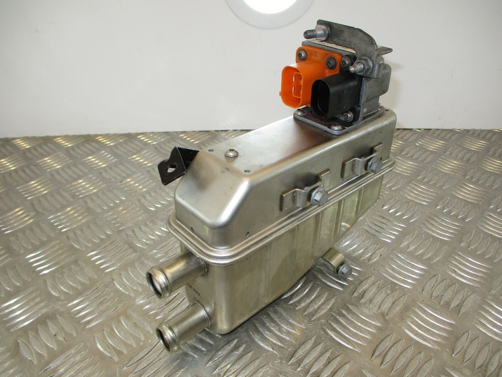

This is the manufacturer. On the picture it looks a bit different than the VW part, but the voltage is given as 450V
http://datasheets.dbk-worldwide.com/EN/ ... er_eng.pdf

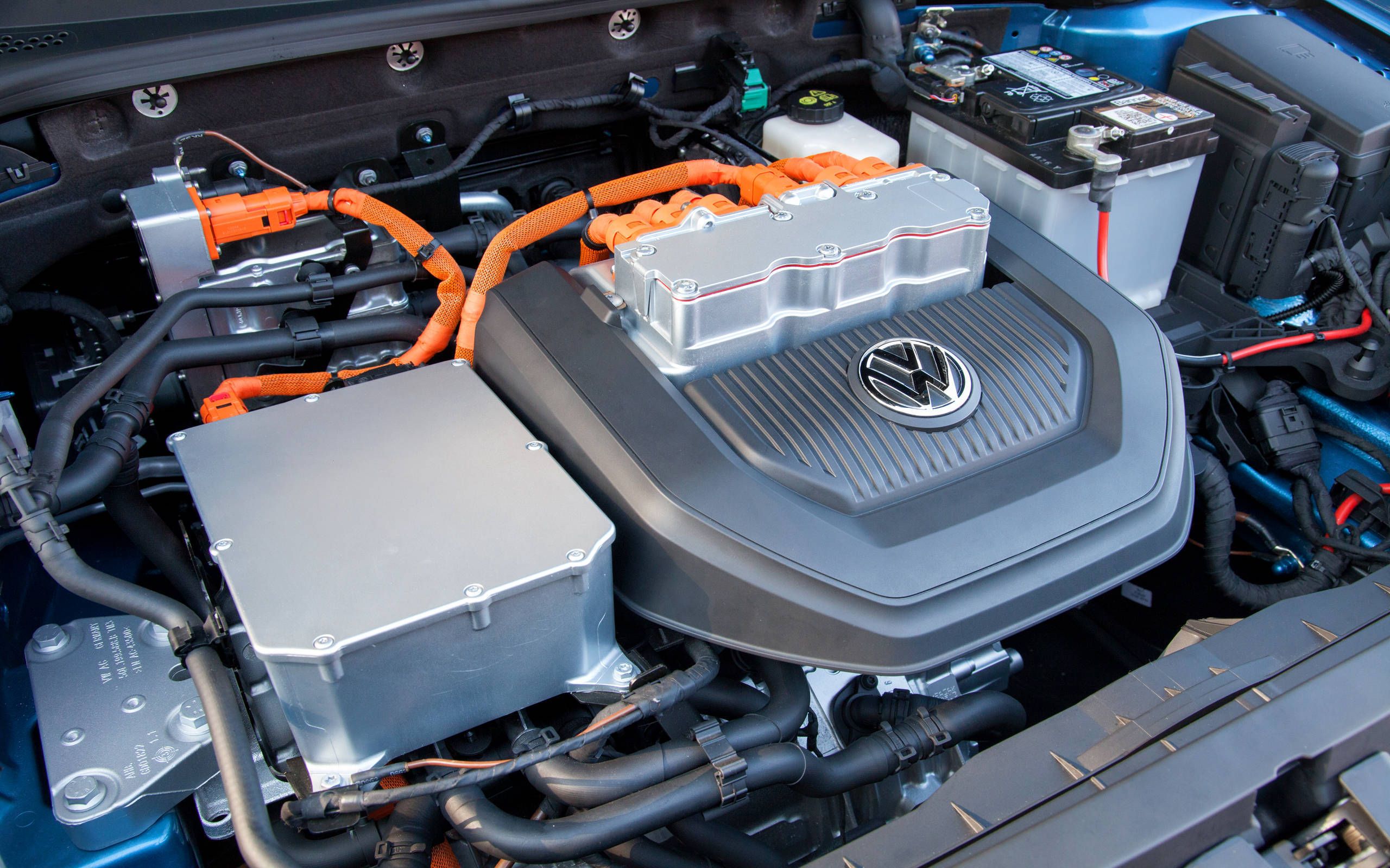

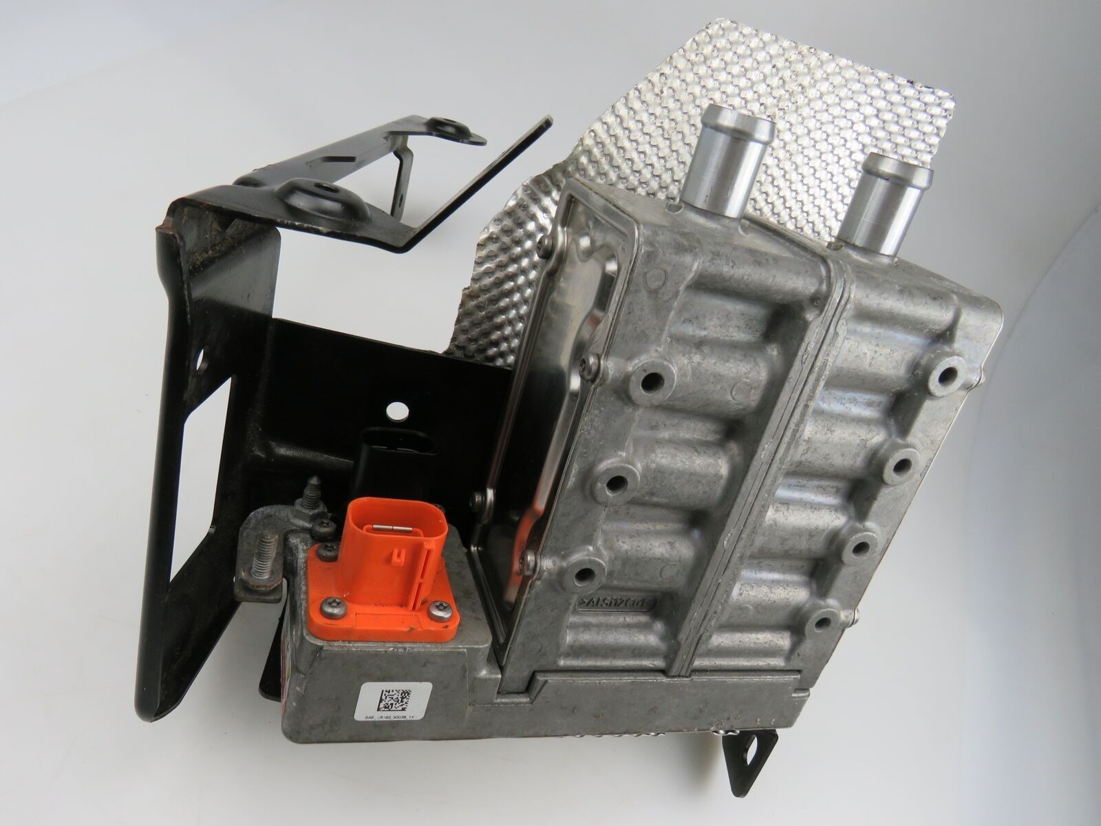

Re: VW electric coolant heater
The Eberspächer heater is installed in my e-Golf. The LV plug is 8 pin. Pin 1 = Red/White, Pin 2 = Brown, Pin 4 = Violet/Yellow, Pin 5 = Green/Violet, Pin 7 = Black/Green. The rest is unoccupied.
The connector appears to be the same as the DBK, but the pinout is definitely different.

Hi, I have a DBK and Ebersprächer heaters side by side here and the pin locations and pin count is the same - both have 5 pins on the LV connector. Did your DBK only had 3 pins or the rest are not used?muehlpower wrote: ↑Tue Jul 04, 2023 2:52 pm The Eberspächer heater is installed in my e-Golf. The LV plug is 8 pin. Pin 1 = Red/White, Pin 2 = Brown, Pin 4 = Violet/Yellow, Pin 5 = Green/Violet, Pin 7 = Black/Green. The rest is unoccupied.

VAG DBK heater Pin1 = 12V, Pin2 = GND, Pin4 = LIN
VAG AC Kompressor Pin2 = LIN, Pin5 = GND, Pin8 = 12V (same connector, different pins)
Eberspächer heater Pin 1 = Red/White, Pin 2 = Brown, Pin 4 = Violet/Yellow, (Pin 5 = Green/Violet, Pin 7 = Black/Green)
Pin2 = Brown = GND -> OK
Pin1 = Red/White = 12V -> probably
Pin4 = Violet/Yellow = LIN -> possible
my DBK also has 5 pins, only 3 are occupied.

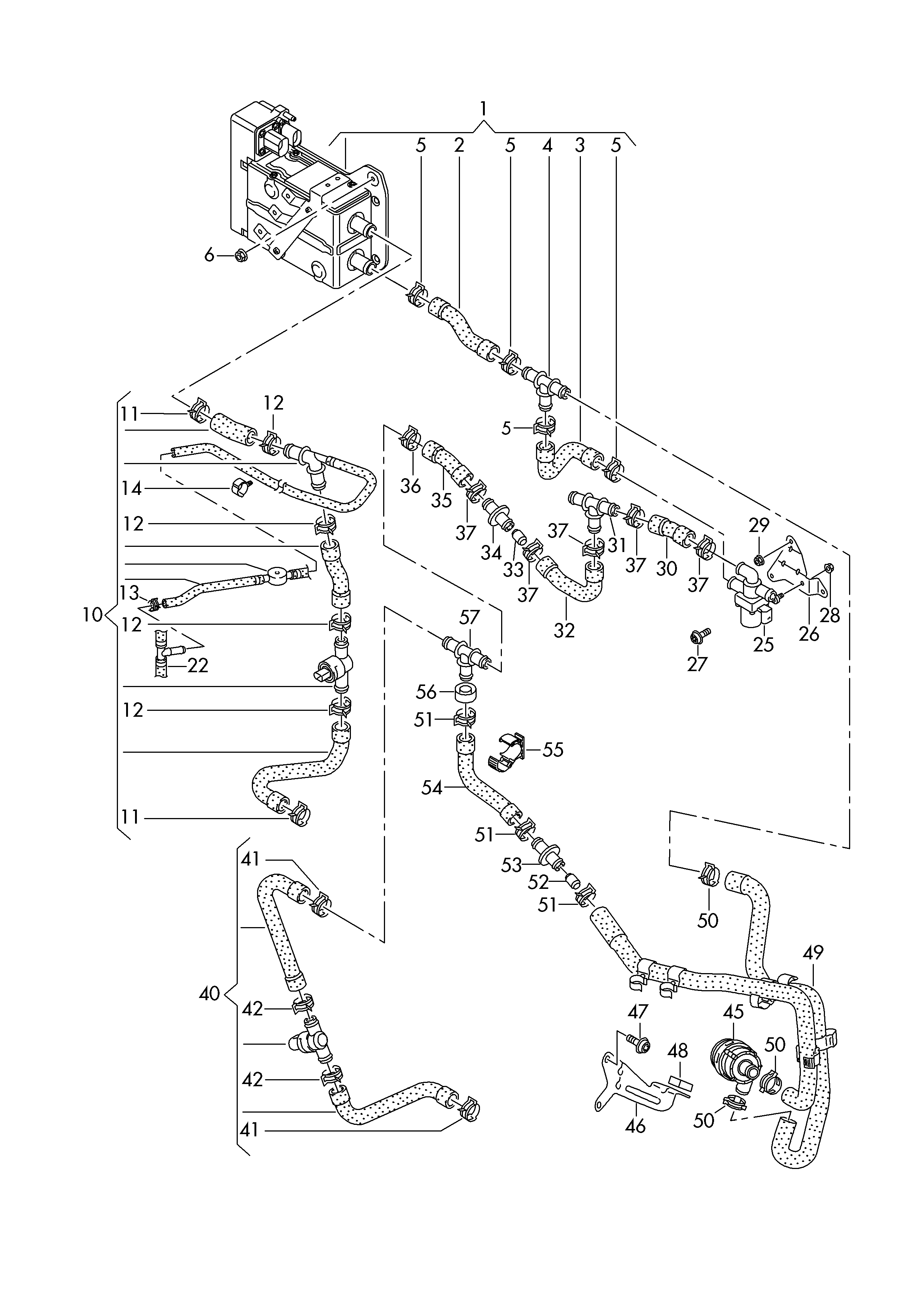

Hi, looks like the coolant to heater is the lower pipe and heater to heater matrix is normally the top, depending on which way you heater is mounted. this is the diagrams from a e-golf and golf gte
E-Golf Golf GTE
E-Golf Golf GTE

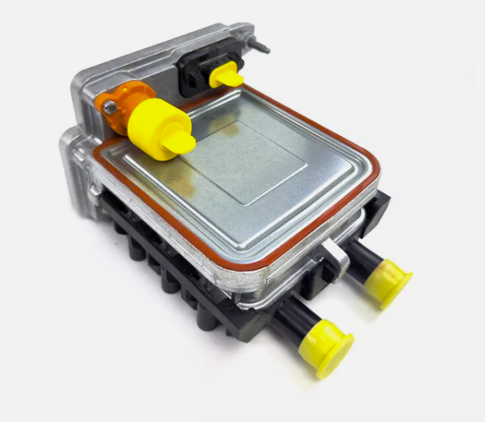

Is anybody familiar with the vw e-caddy ptc coolant heater - 71.0301.37.0200?
Looking for the info on how to control and orientation of install. Thanks in advance.

I got my hands on the same heater model for cheap as well - cheap enough for the risk of not being able to successfully reverse engineer the communication. Worst case I will open the electronics and see what I can find in there. So far I am pretty confident that it is an Eberspächer Titronic CHHV 50 G3 or 50 G3T, communication is via LIN 2.1 protocol from what I can find:alexbeatle wrote: ↑Sat Sep 28, 2024 5:10 pm Is anybody familiar with the vw e-caddy ptc coolant heater - 71.0301.37.0200?
https://www.eberspaecher-emv.com/filead ... eet_DE.pdf
https://www.eberspaecher-climate.com/fi ... 8_2022.pdf
But maybe this should be split into a new topic?
